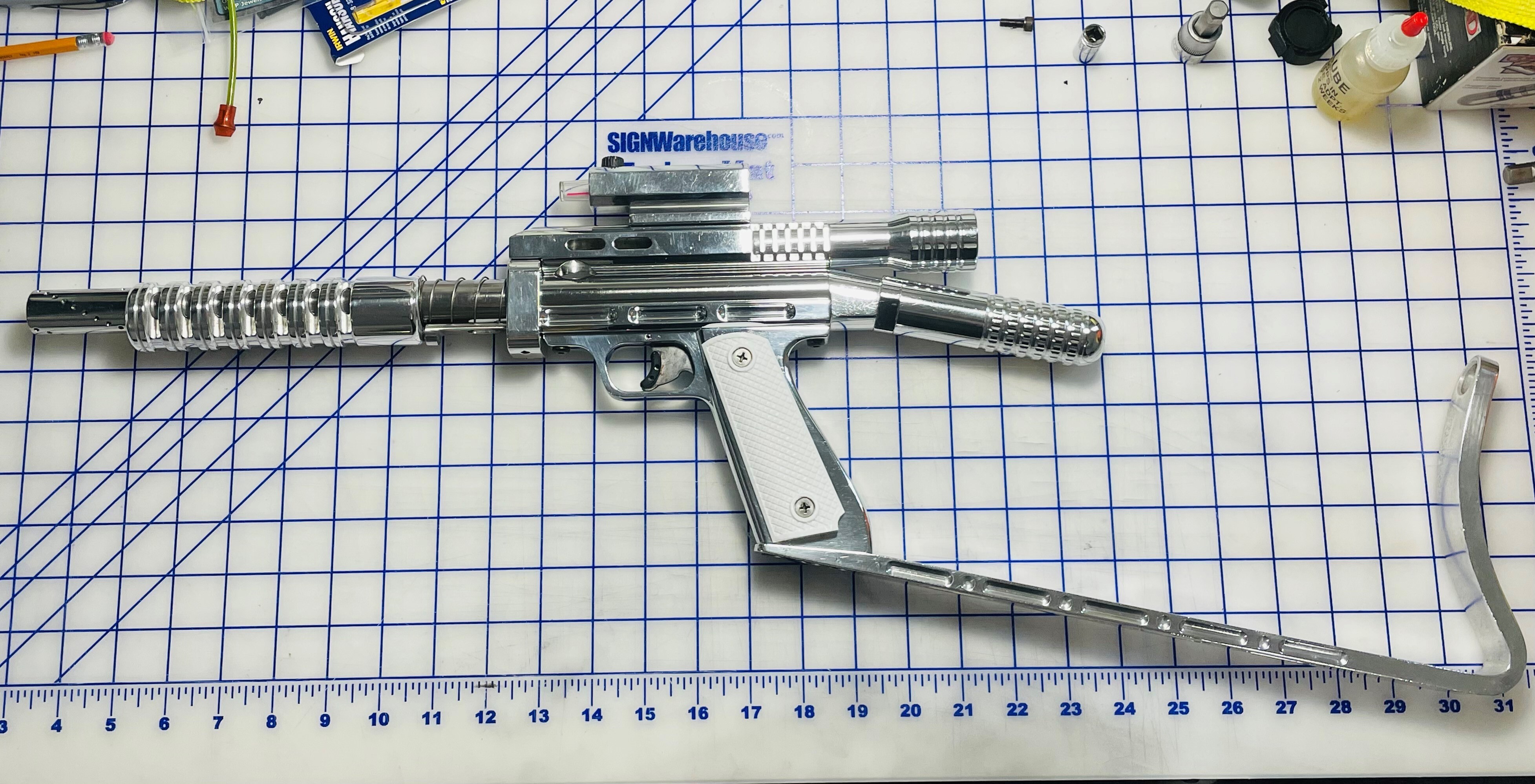

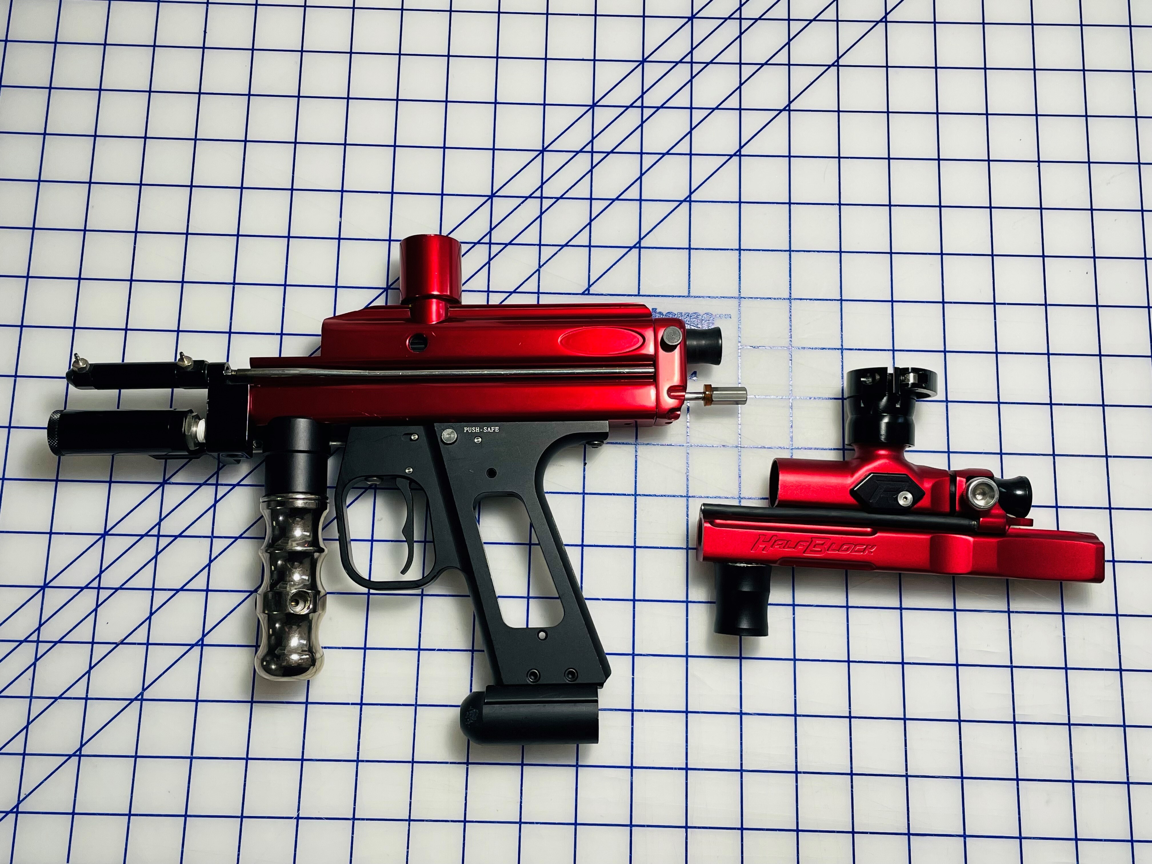

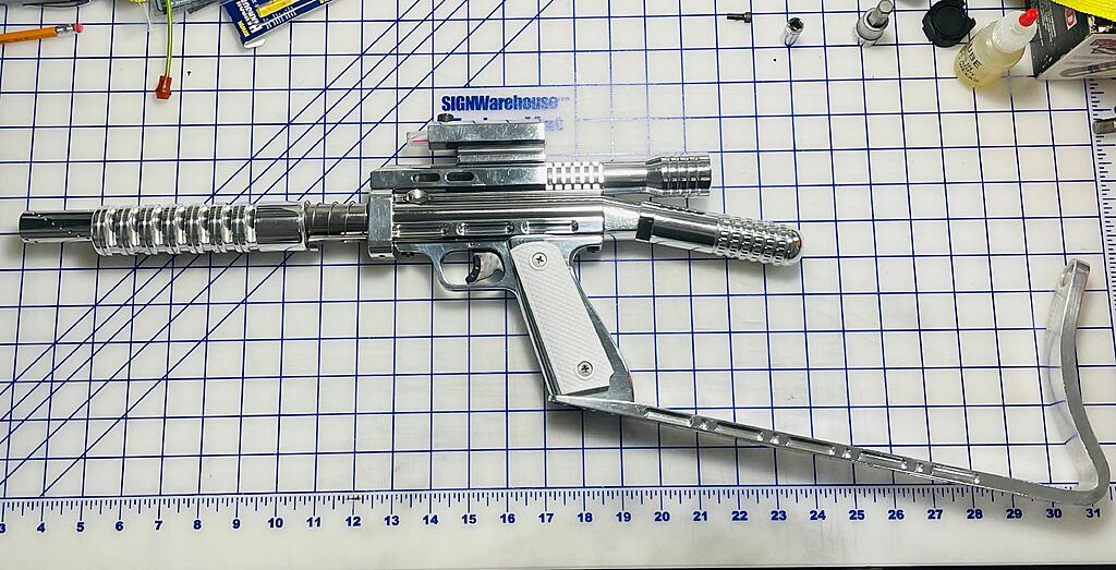

    A center feed 2000+ WGP Autococker, and originally the plan was to use that as the start of the modern Cocker build. But then I scored another body on eBay:
    Won an auction for a RaceGun Halfblock body with full internals. The RaceGun Halfblock body will now be the starting point for the modern mech Cocker build...which left me with what to do with the 2000+ CF Cocker. Best answer...build a Stock Class Sniper!

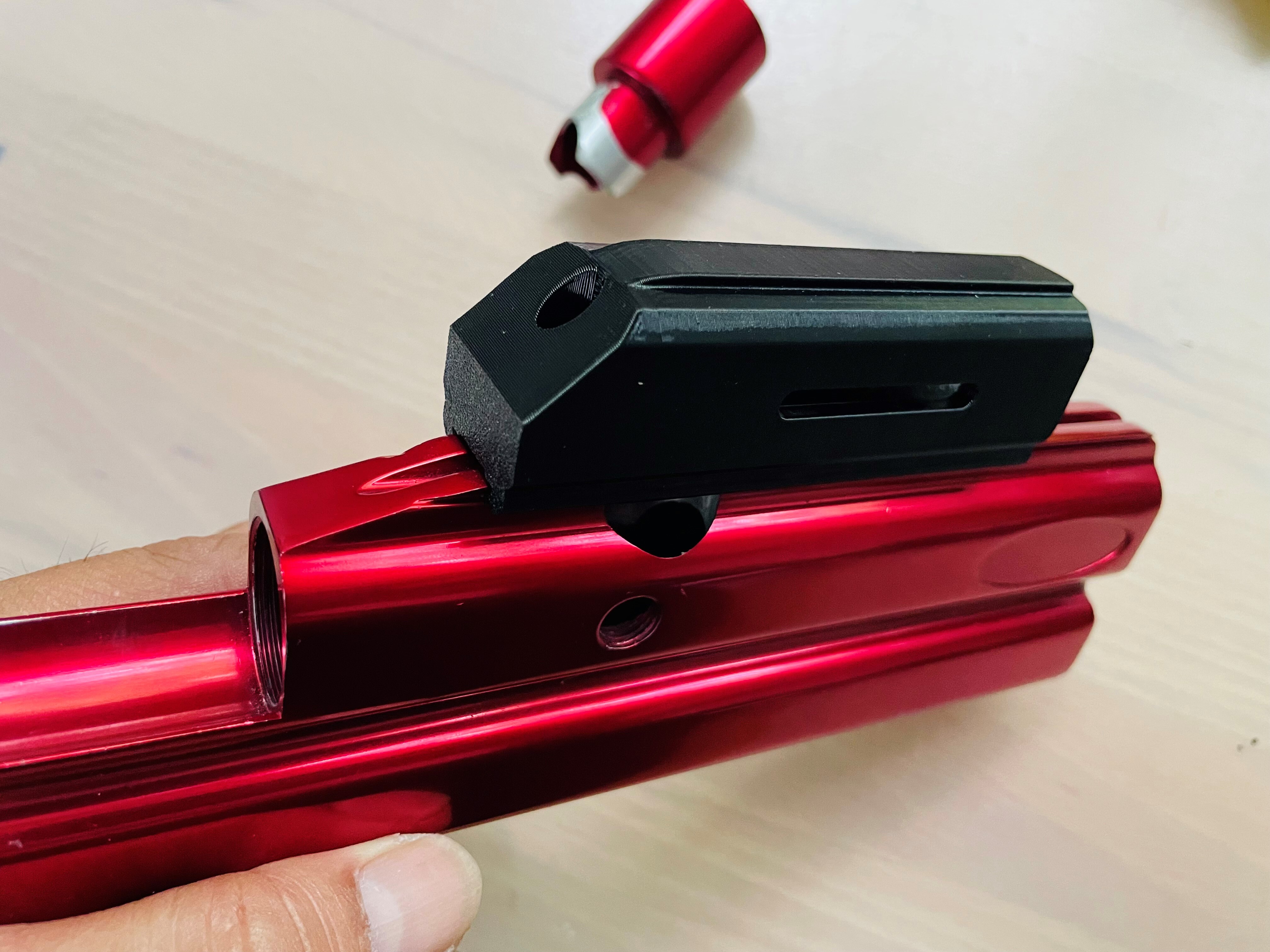

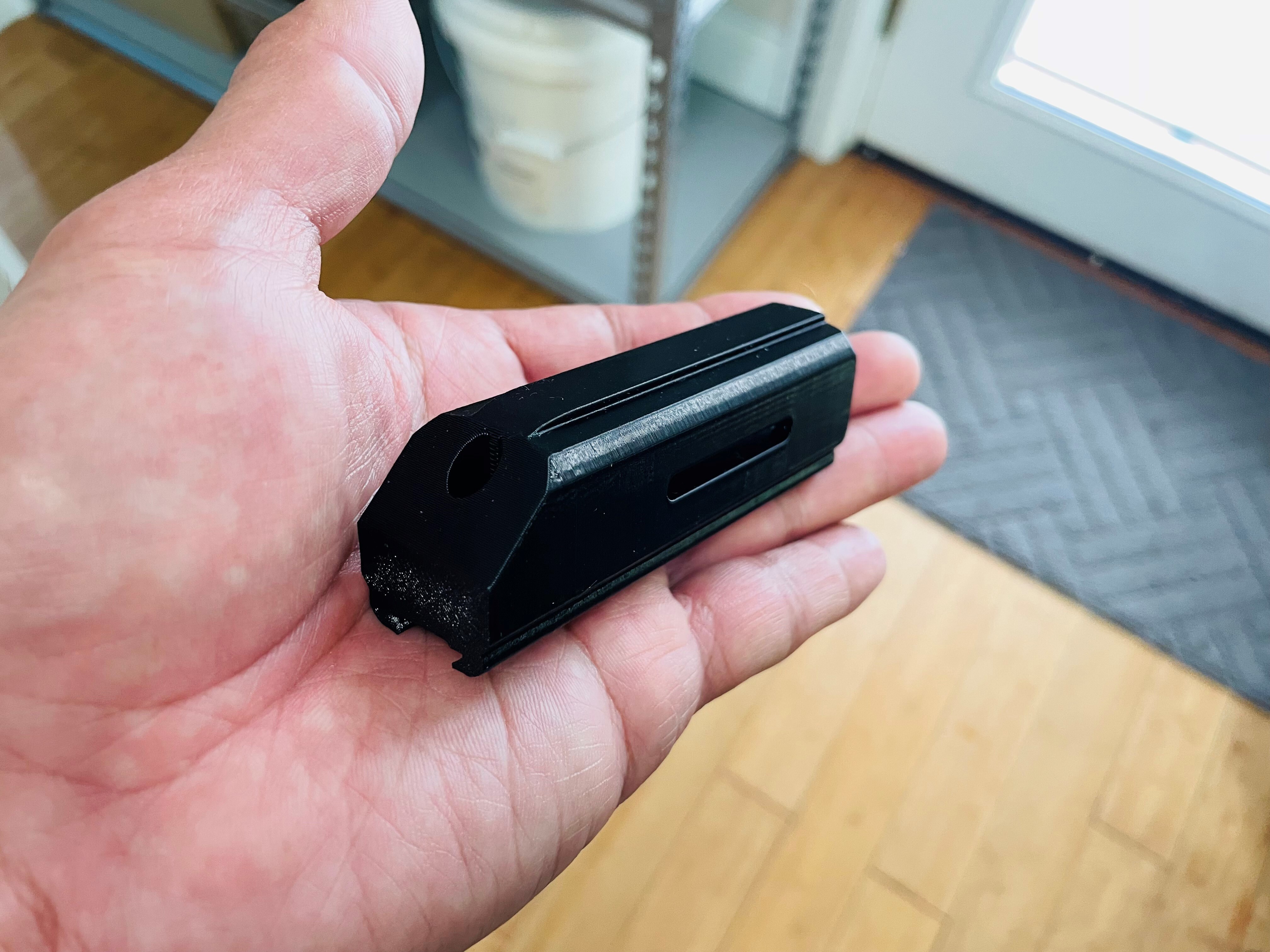

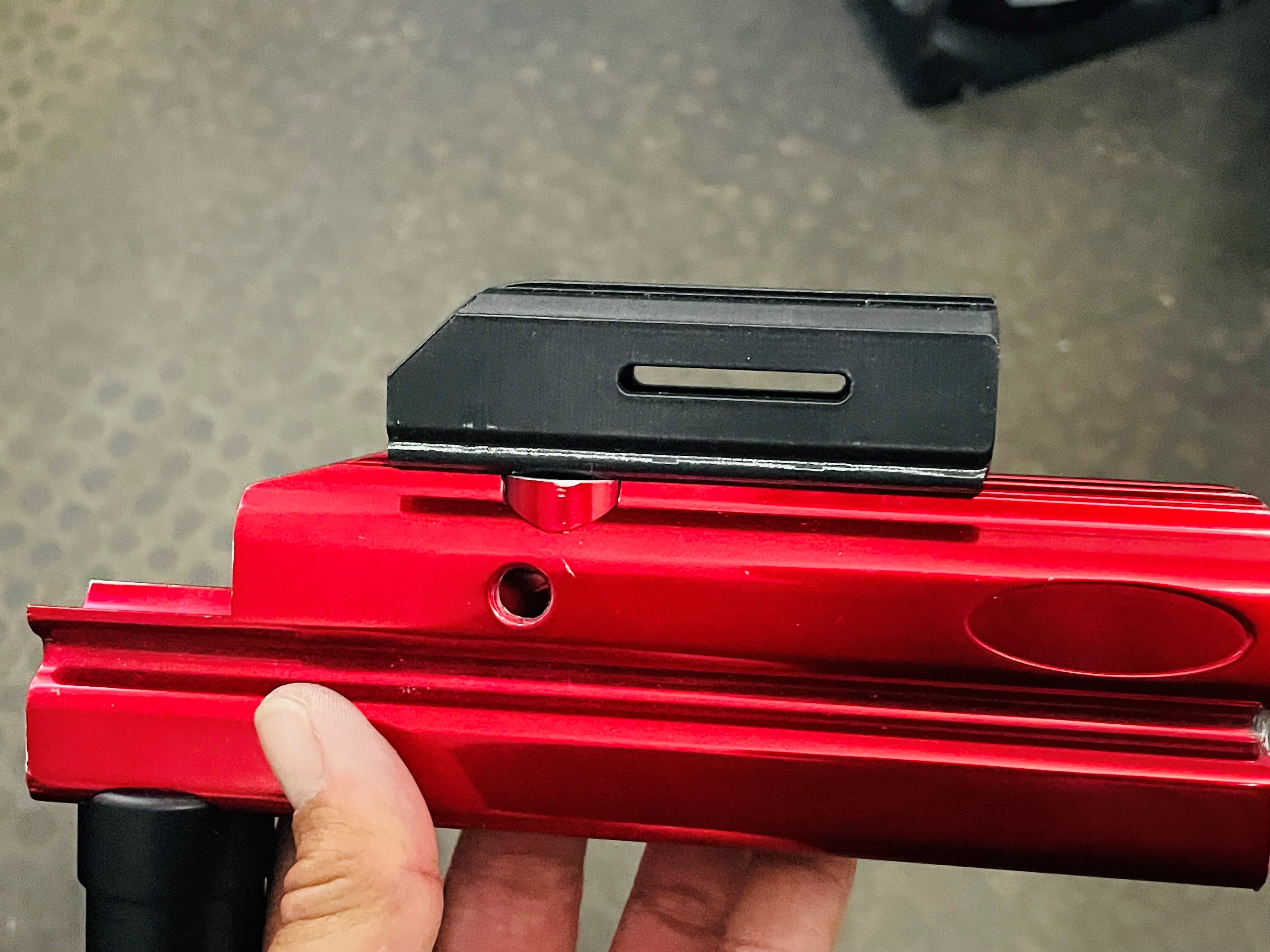

    A Stock Class Sniper conversion just made a lot of sense. Of course, my Carter Comp is one of the most bad-ass stock class markers out there, but the problem with it is the fact that the barrel was originally bored and polished to perfection by Earon for Nelson paintballs. Nelson paint was huge compared to the teeny tiny modern paintballs, so of course roll-out is a problem. Have some ideas for addressing this (hoping to find someone brave enough and skilled enough to make me a barrel for it that matches the original look and feel of the original...but machined for some sort of inserts to adapt to different sized paint), but in the meantime...a stock class sniper will fill the void. Plus, being an OG cocker guy means that i'm already in familiar territory with turning a cocker body into a pump, and still have lots of spares and parts from back in the day.

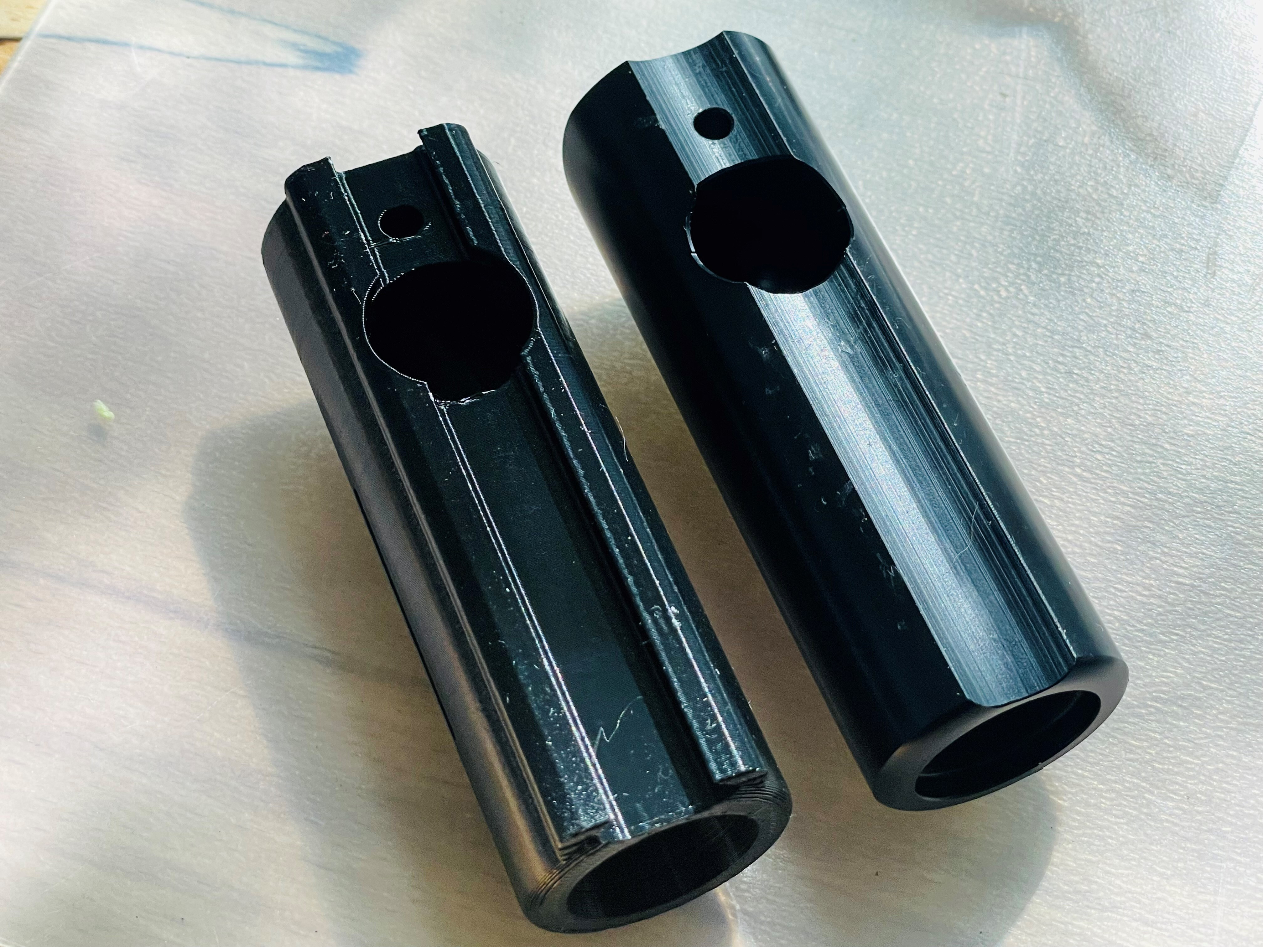

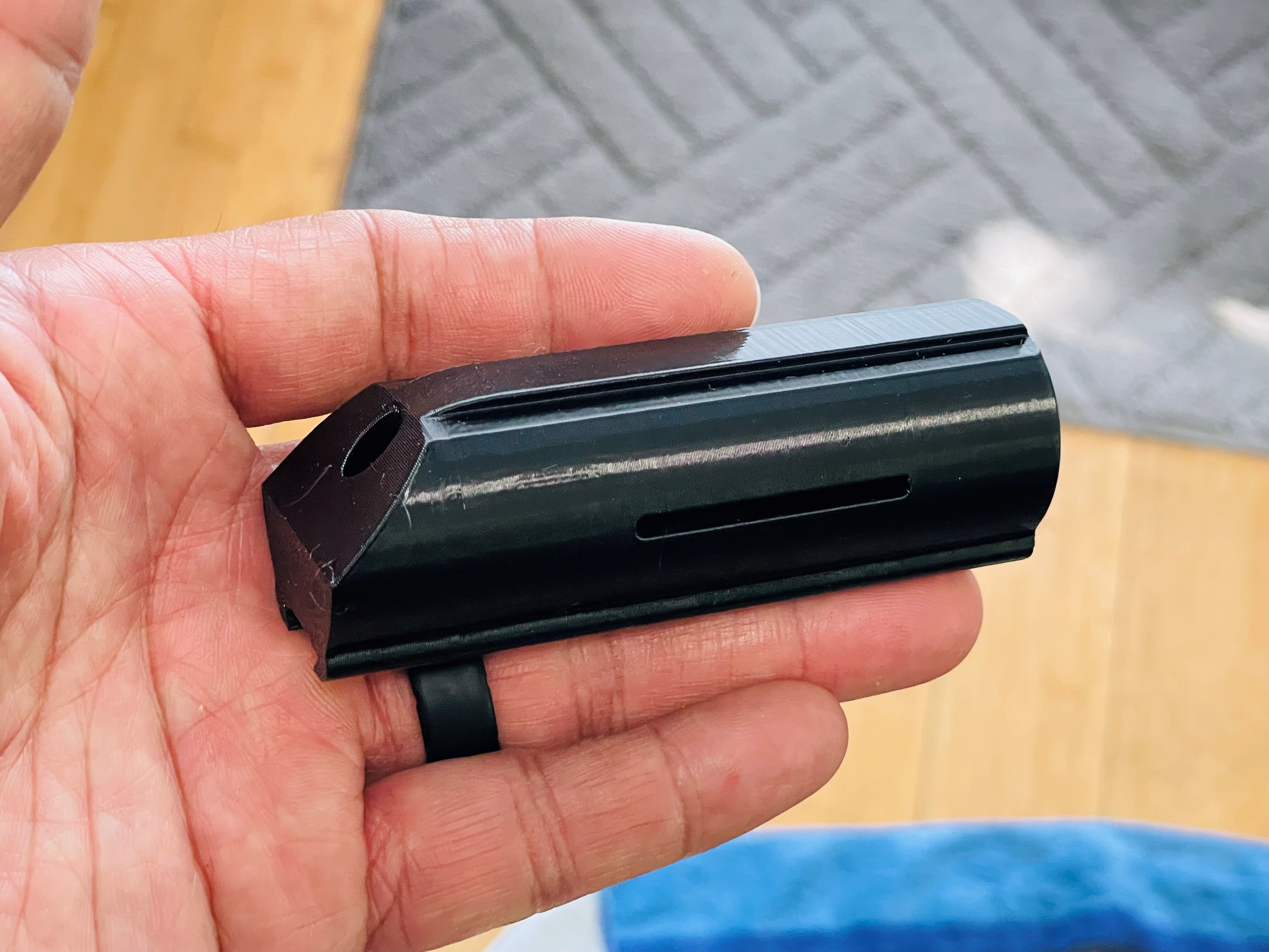

    Since one of the hallmarks of a stock class marker is the horizontal feed tube, I first set out to look for options on doing a stock class feed on a center feed cocker body. Didn't really like the look of the 90 degree adapters with a straight feed tube, and didn't really come across many options out there so I decided to build my own. One of the other hobbies i've gotten into in the last few years is 3D printing so this seemed like a perfect opportunity to blend the 2 and decided I was gonna design and print a stock class feed for it. Something similar to the CCI Phantom's stock class feed, but designed to slide onto the Autococker body's 3/8" dovetail sight rail. I happened to have a CCI Phantom Stock Class Feed and tube that I had picked up for the RF Early 90's Autococker body I was building into my son's stock class marker (that will be covered in it's own build thread), so I initially modeled the feed after the Phantom feed, but with a flat front end instead of it being round, to make it a bit easier to print. Decided to use black PETG for the filament. Should be more than strong enough for this application and is still relatively easy to print. This is what I ended up with:
    Click image for larger version  Name:	StockFeedPrototype1.jpg Views:	75 Size:	1.53 MB ID:	590645
    The underside next to the Phantom feed...
    Click image for larger version  Name:	StockFeedPrototype4.jpg Views:	73 Size:	2.20 MB ID:	590646
    Test fit on the dovetail rail of my son's RF body (because I hadn't yet extracted the feed tube from the CF body):
    Click image for larger version  Name:	StockFeedPrototype2.jpg Views:	71 Size:	2.29 MB ID:	590647

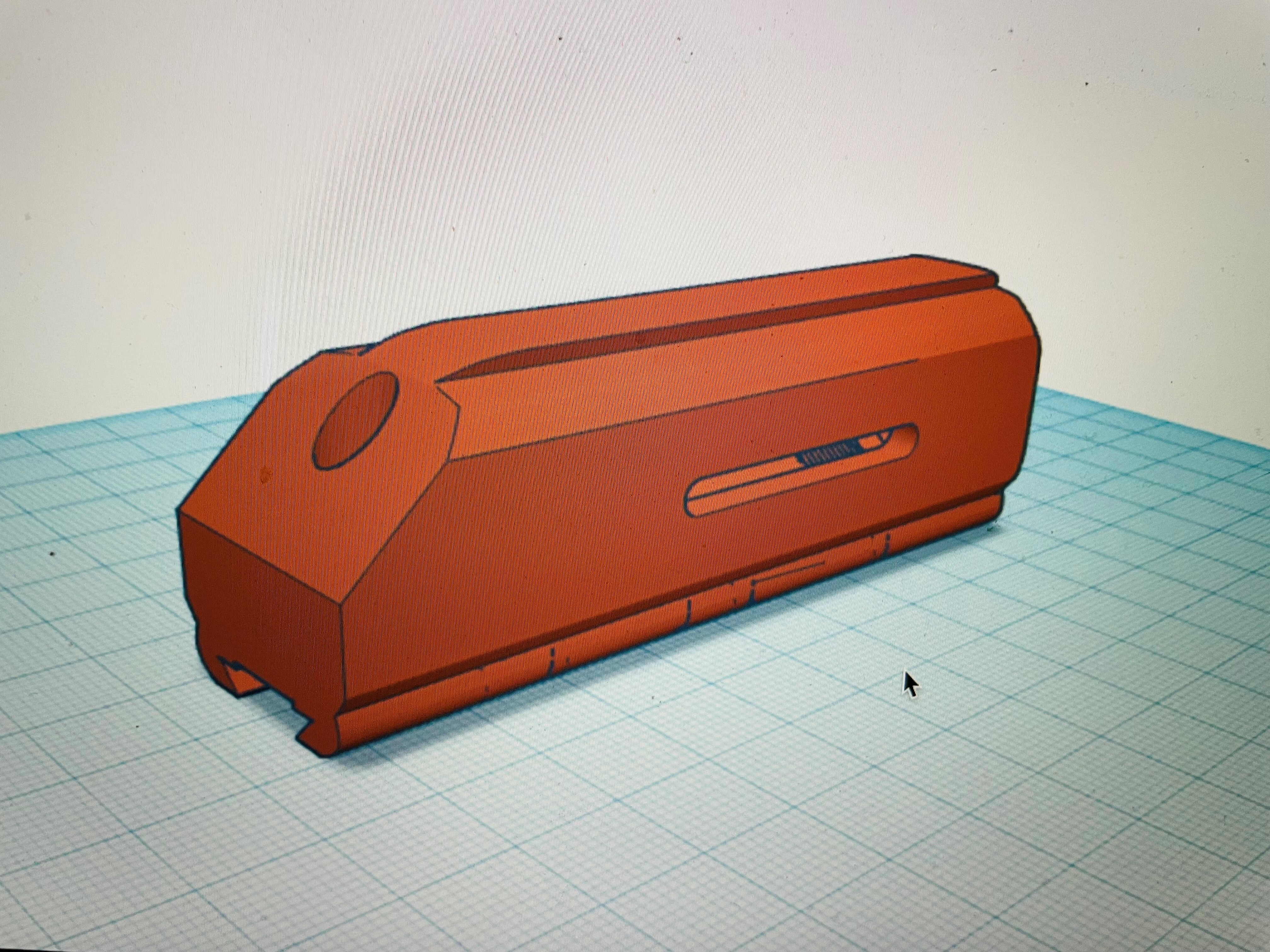

    Fits the dovetail rail perfectly, but wasn't really a fan of the width of the feed in comparison to the Cocker body, so made some modifications to make it slimmer and to match the Cocker body better. Ended up with this:
    Click image for larger version  Name:	StockFeedCAD.jpg Views:	72 Size:	3.41 MB ID:	590648
    Click image for larger version  Name:	StockFeedModded1.jpg Views:	71 Size:	2.07 MB ID:	590649
    Click image for larger version  Name:	StockFeedModded2.jpg Views:	71 Size:	2.39 MB ID:	590650
    The squared sides definitely fit the shape of the Cocker body better. You can also see that I kept the mounting screw hole from the Phantom feed. Designed for an 8-32 socket head cap screw to secure the feed to the body. However, i've found that it isn't 100% necessary. The feed fits pretty tightly onto the rail that it doesn't move. Is unlikely to move during a game, but w'll see how it goes. Next step...to pull the center feed from the 2000+ body....

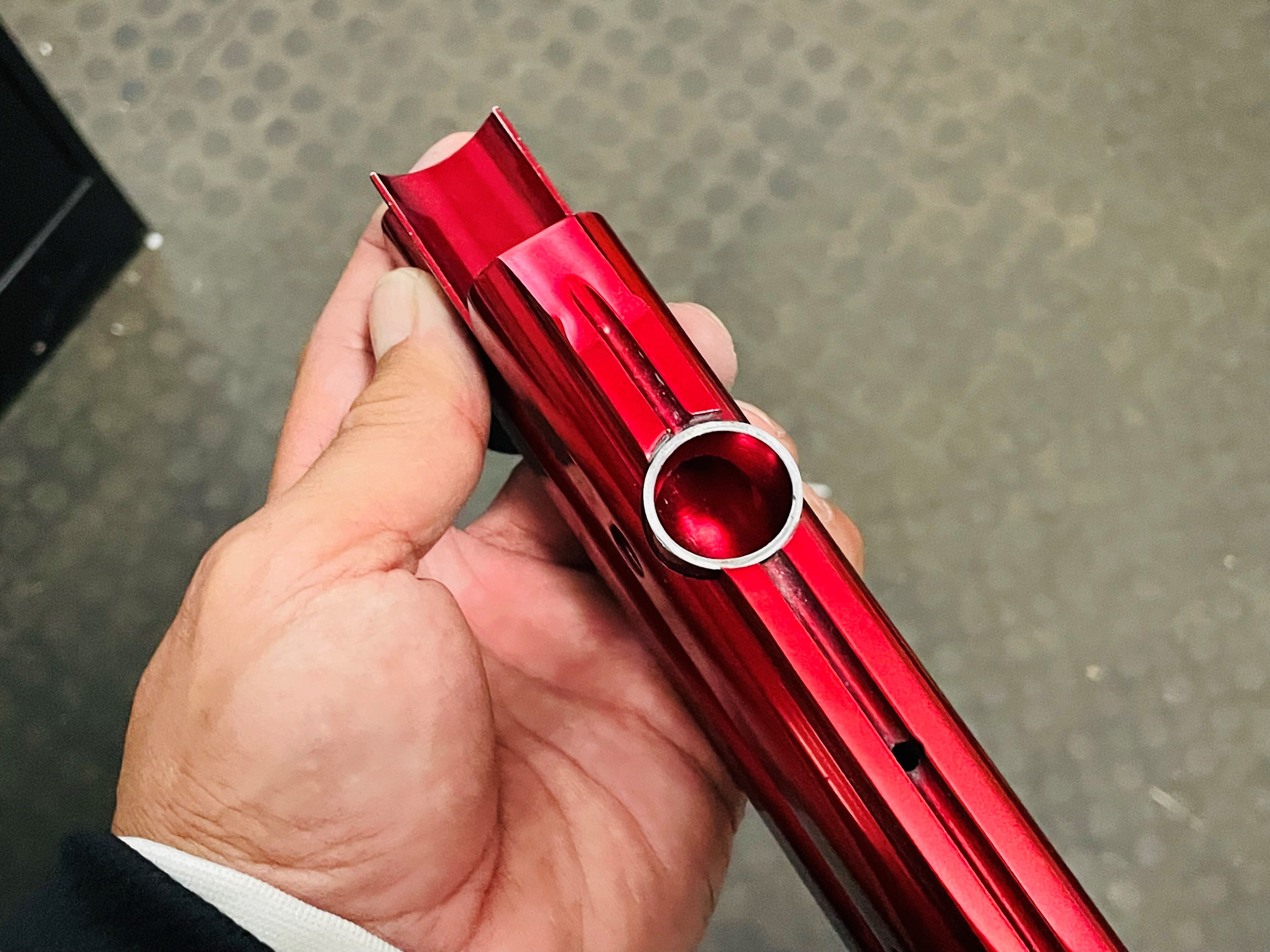

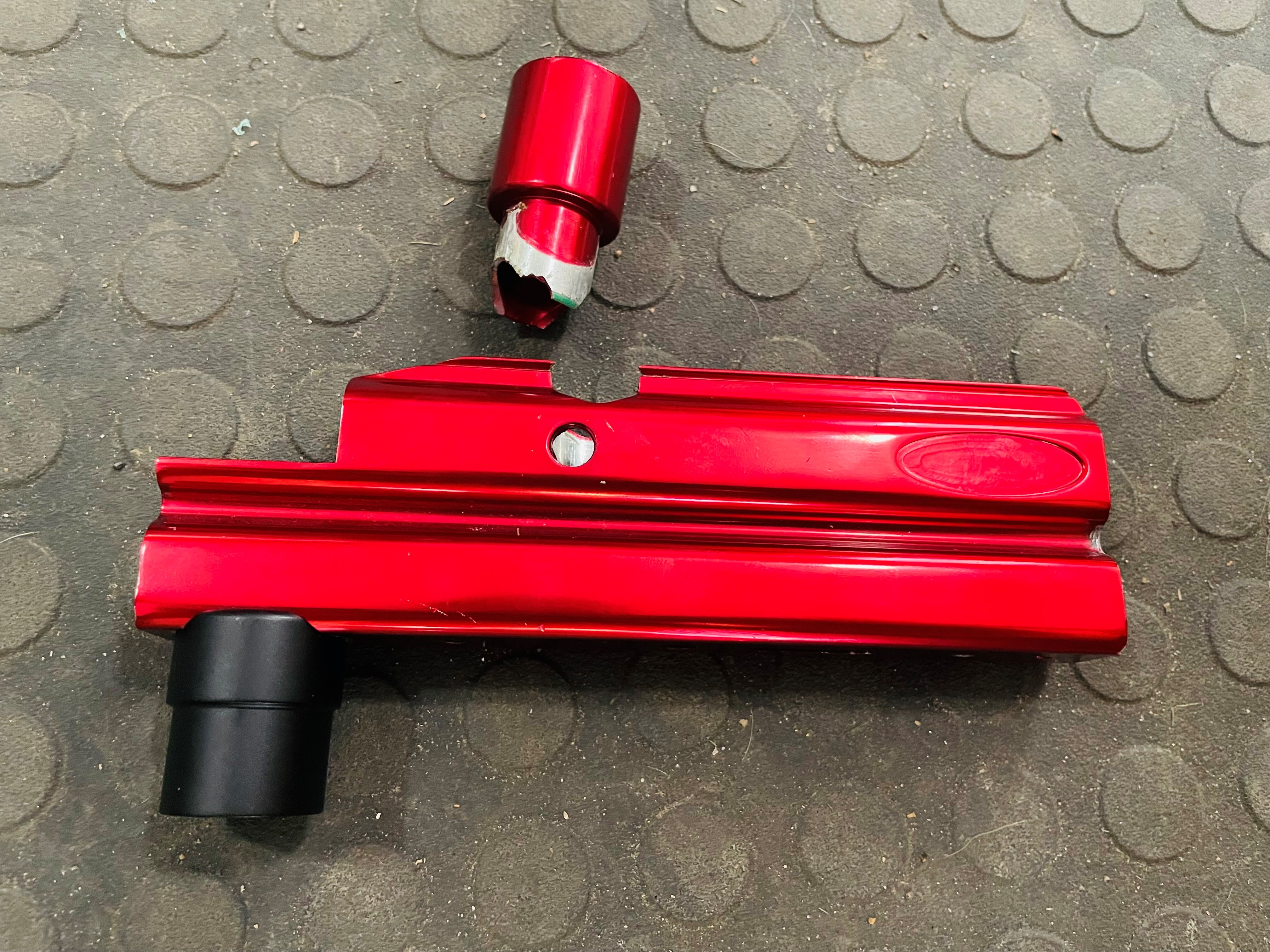

    In order to pull the feed, I first had to disassemble the marker completely. Didn't take any pics of this, but i'm sure you've all seen Autocockers fully disassembled, so i'll leave it at that. On to pulling the feed..

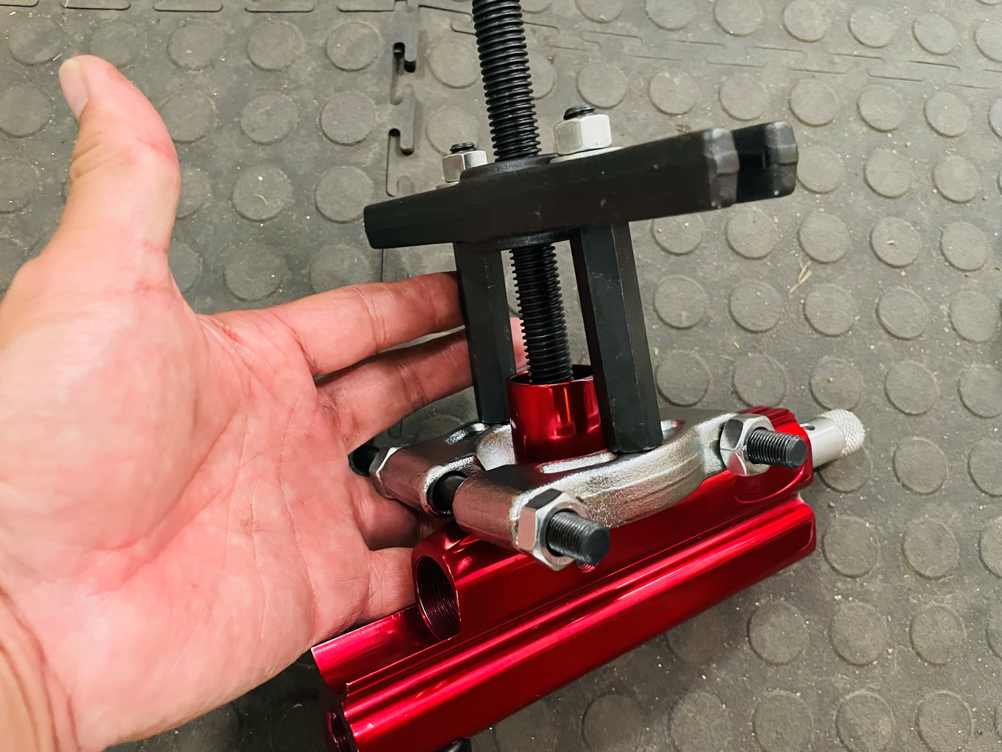

    I'm a BMW Master Technician by profession, so naturally I have a lot of tools and it seemed that a bearing puller would work to pull the feed tube from the body. Set the puller under the lip of the feed tube, placed an old aluminum bolt inside of the bore of the body for the center post of the tool to push on, and proceeded to pull the feed from the body:

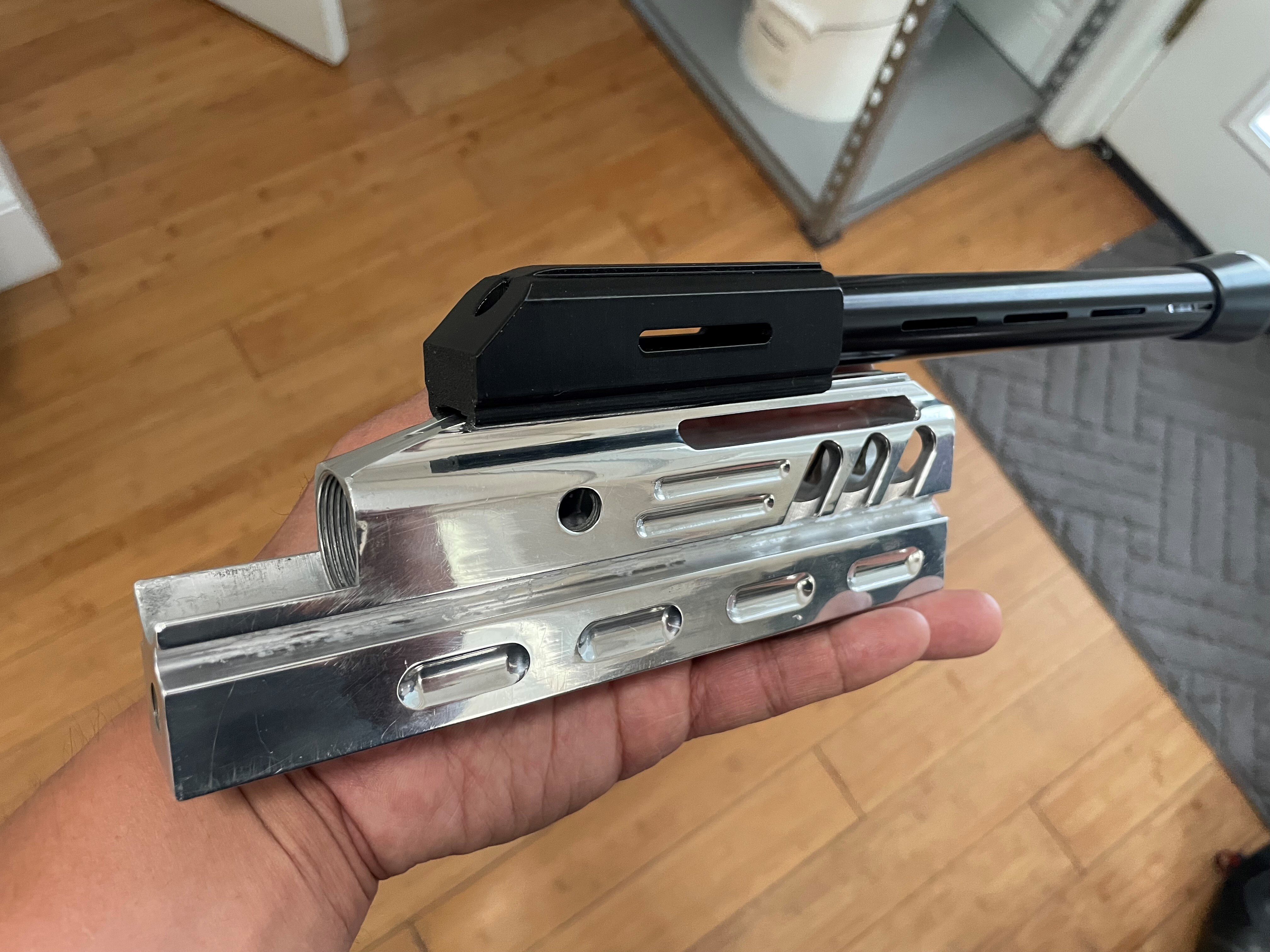

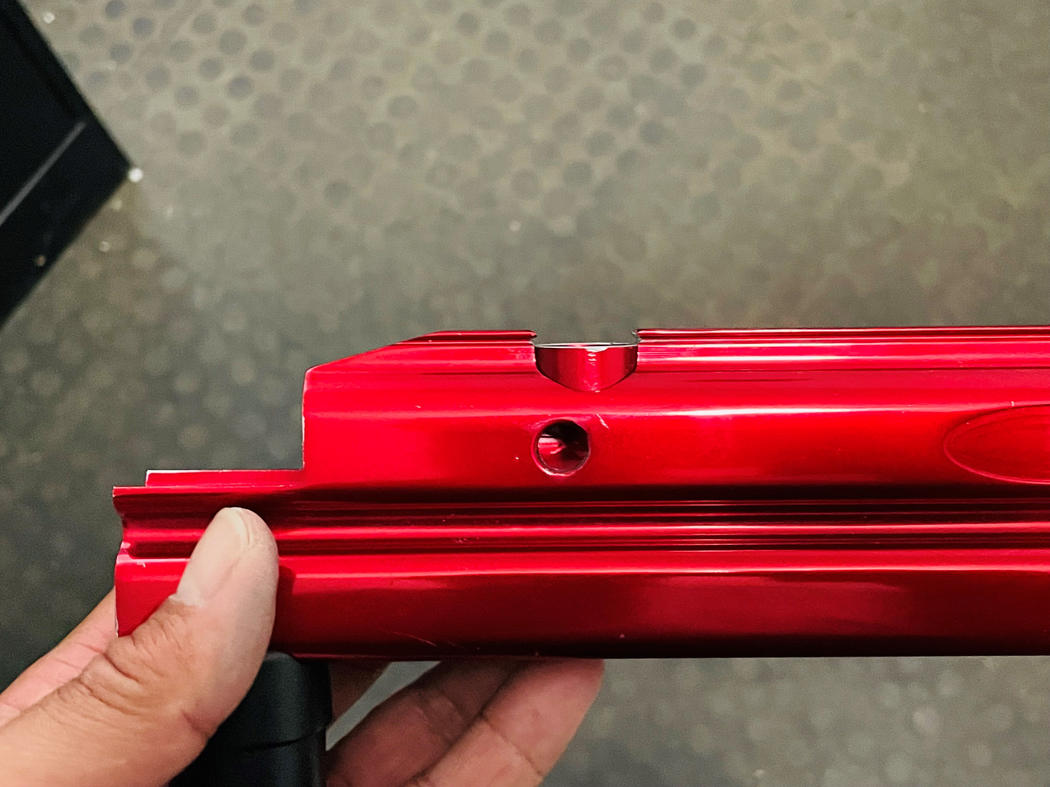

    With the feed neck removed, I could finally test fit the stock class feed on the actual body...

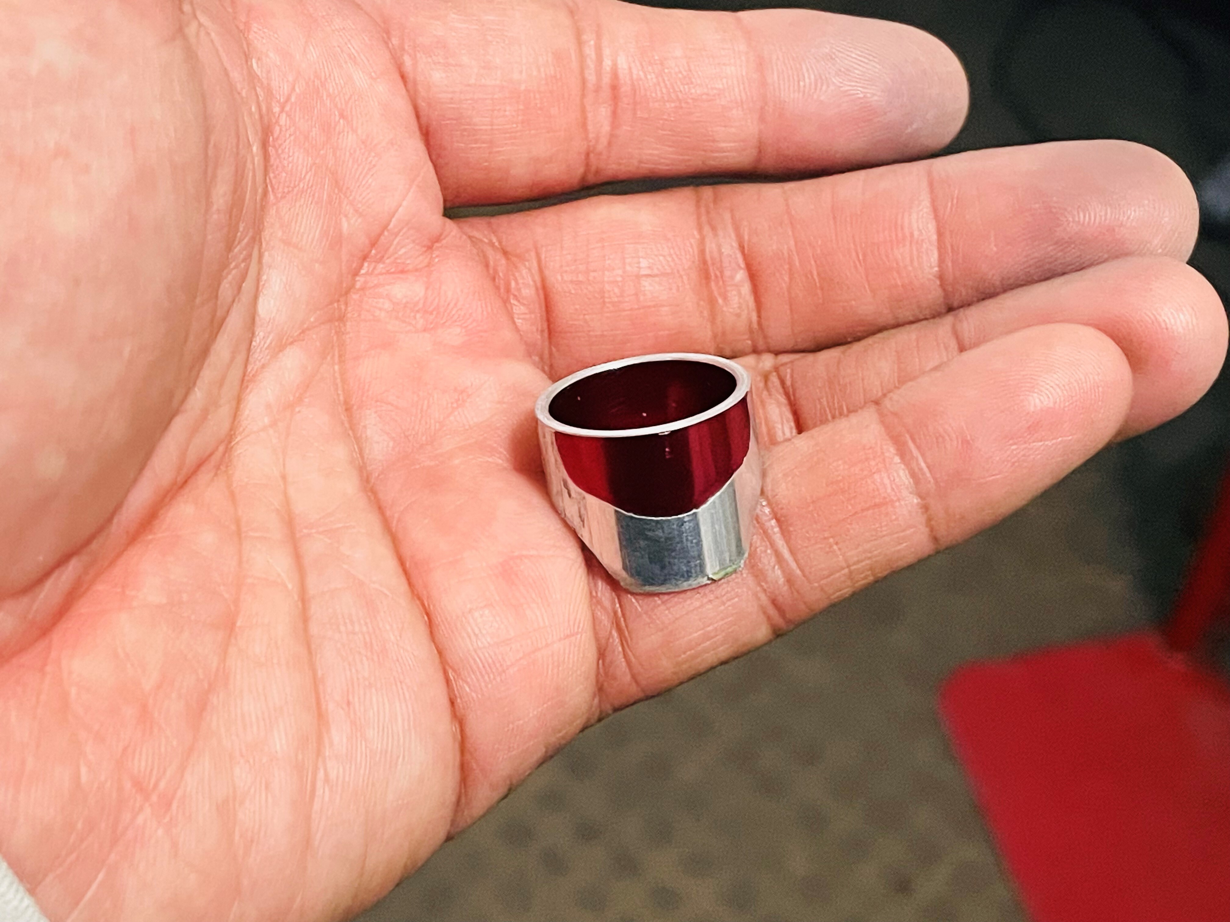

    It fits well, however....I didn't quite like the large gaping hole with sharp edges left behind by the missing feed tube. So, I decided to cut down the feed tube and press it back into the body to fill that opening. Took some careful measurements, made some careful cuts with a Dremel with a cutoff wheel, filed and sanded it smooth and flush and ended up with this:
    Then used an appropriately sized impact socket and a soft blow hammer to seat the shortened feed tube back into the body. I cut it so that it would sit JUST below the dovetail rail so it would cover as much of the hole as possible while still allowing the feed to slide onto the dovetail rail easily:

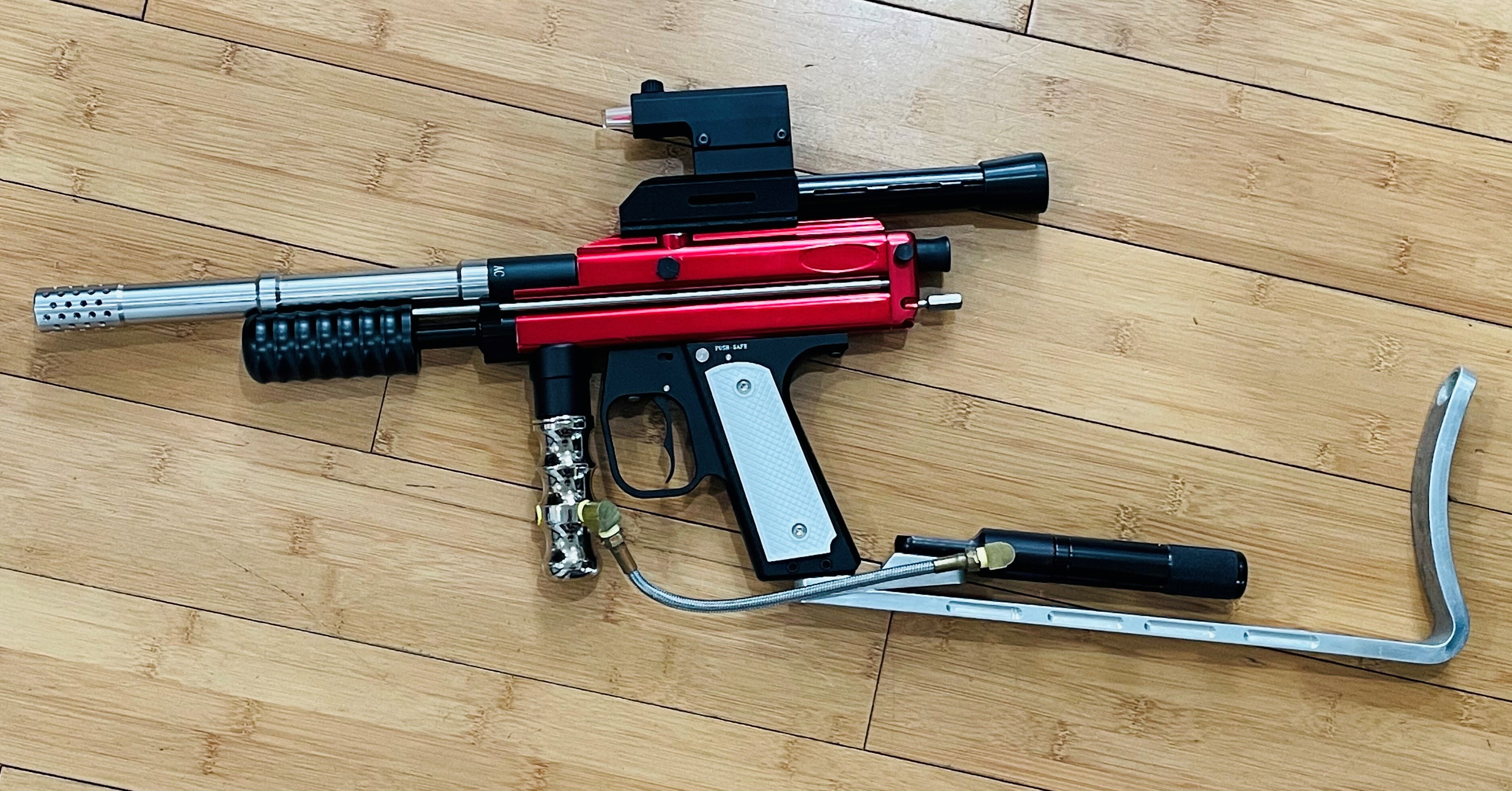

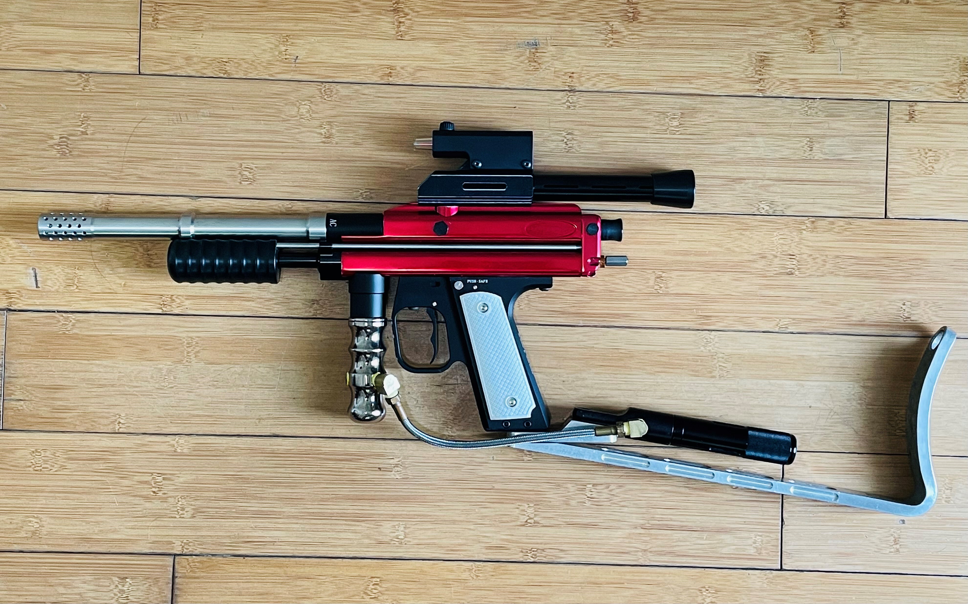

      At this point in the build I was under a bit of a time crunch because I was gonna take my son to play paintball for his first time at the Strockstravaganza event put on by The Timber Ghosts at NR Adventure Park in Taneytown, MD, and the event was coming up quickly. Because of the time crunch, I unfortunately assembled the marker without taking any pics, but the nitty gritty of the build are as follows:
      Stock 2000+ lower tube internals (for now)
      Stock 2000+ bolt
      Inception Designs Genesis Pump kit
      CCI 12 Round Feed tube
      My 3D printed Stock Class Feed (black PETG)
      3D Printed checkered grips (white PETG)
      Carter Machine Stainless Steel Barrel (borrowed from my Carterized Autococker and only temporary until I pick-up a Freak XL Barrel set)
      Carter Machine L-Stock (also borrowed from my Autococker)
      CCI Bucket Changer (mounted on the drop forward I used to run on my Autococker - a temporary setup until I can pick up a lever changer to replace it)

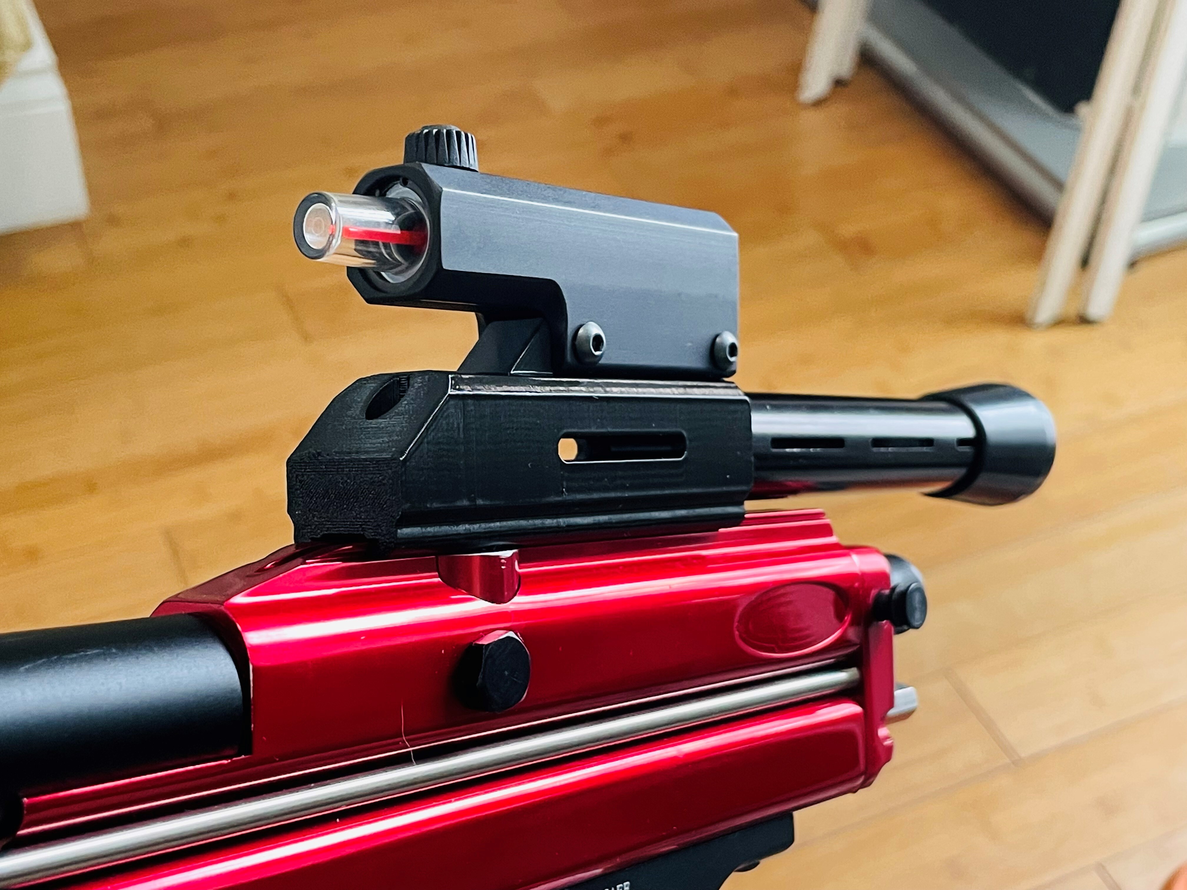

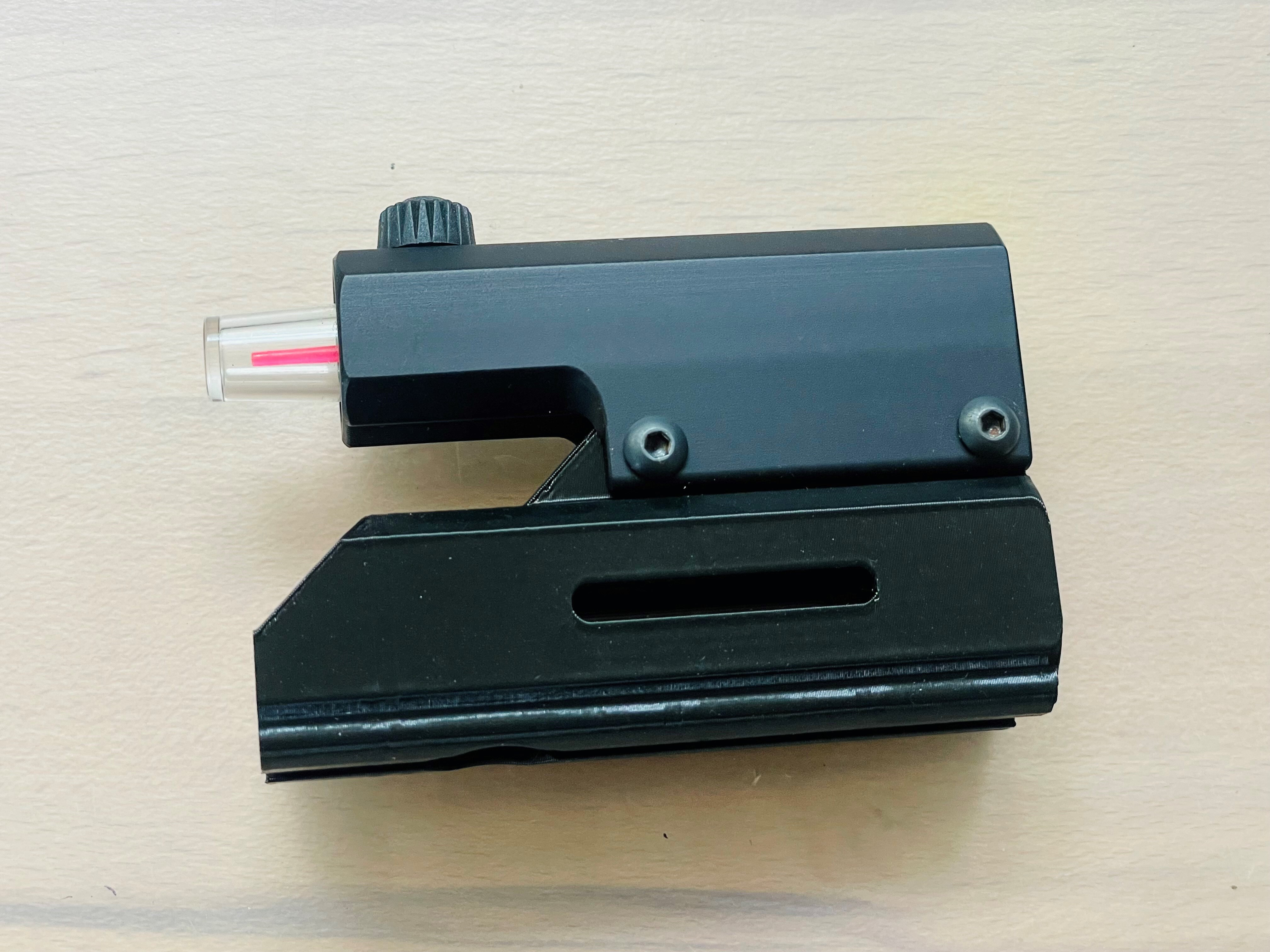

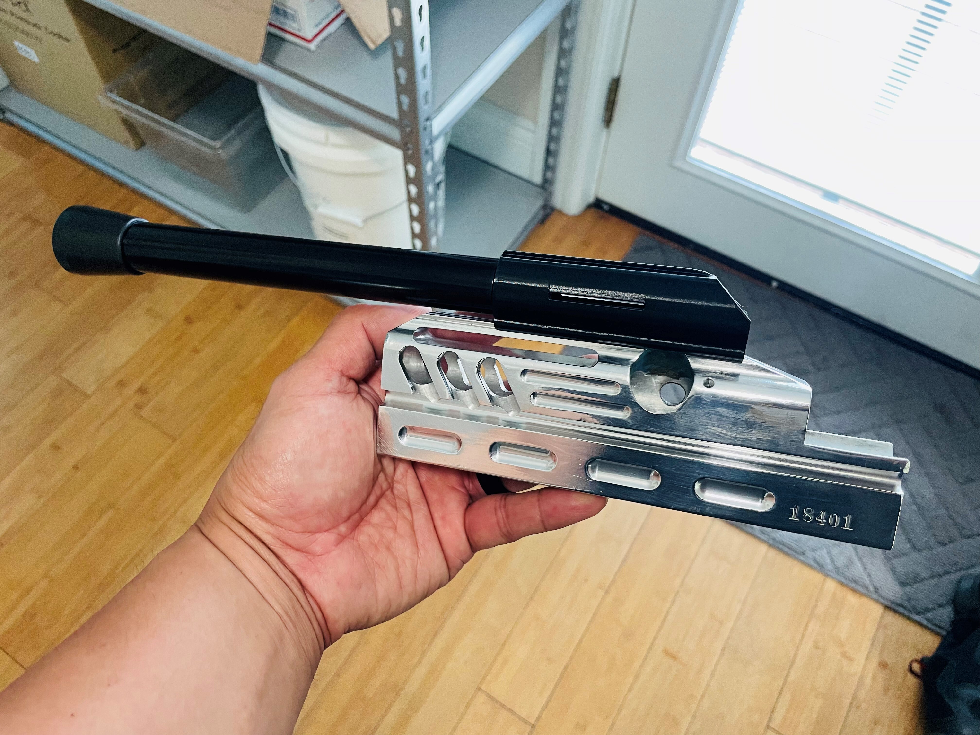

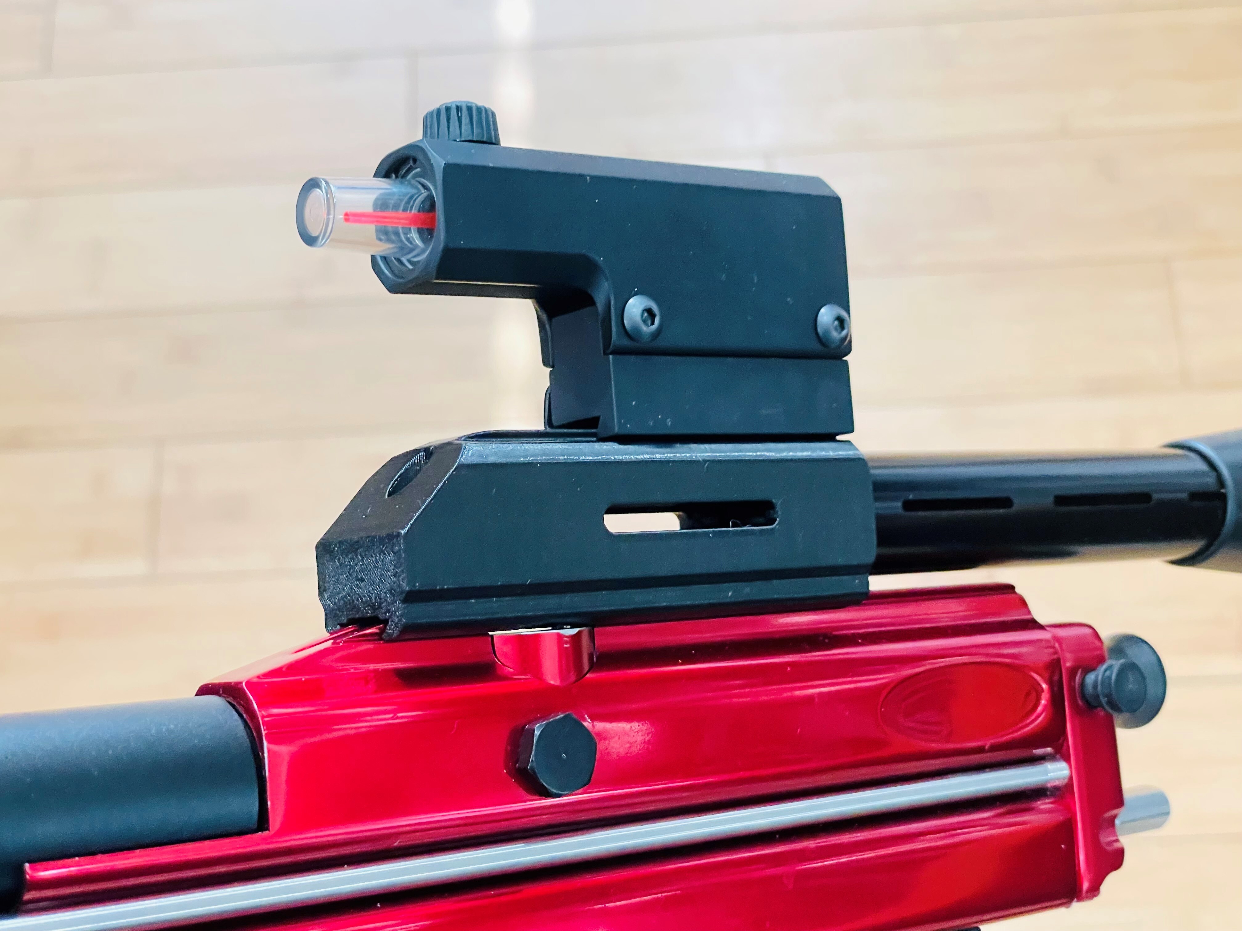

      It was also right around this time that I came across a post from Forrest from Armson/Pro Team Products and realized that Armson sights were still available (I thought they were discontinued). I always loved Armson sights and have run them on both my Autococker and my Carter Comp for a long time. Traded some emails with Forrest and soon had a box at the door with a new sight in it. Mounted it on the newly assembled marker and here's what we ended up with:
      Click image for larger version  Name:	StockSniperLeft1.jpg Views:	0 Size:	1.48 MB ID:	590690
      My only gripe with the new Armson sight is that they changed the mounting design from the one I have on my Carter Comp. The mounting block is kinda tall, so when mounted onto the rail on top of the 3D Printed stock class feed, it sits really high. Looks a bit awkward to me:
      Click image for larger version  Name:	ArmsonDovetail1.jpg Views:	0 Size:	1.27 MB ID:	590691
      According to Forrest, this taller mount works perfectly on most markers with a sight rail and gives good clearance for the facemask, etc. Makes sense. He agreed though that, stacked on top of a 3rd tube like the stock class feed...it does look a bit tall. So, I decided to redesign the stock class feed to incorporate the Armson sight mounting block. For this first version, I just bored the screw holes slighter smaller than the M4 screws that hold the sight to it's mounting base and threaded them right into the plastic. More of a proof-of-concept...with future iterations being designed for M4 heat set inserts. Ended up with this:
      Click image for larger version  Name:	ArmsonFeedMounted.jpg Views:	37 Size:	1.69 MB ID:	590692
      Click image for larger version  Name:	StockFeedArmsonPrototypeCloseup.jpg Views:	0 Size:	1.53 MB ID:	590693
      Much better and more streamlined and lower profile. Also, since the Carter Machine barrel is of course a larger bore, I picked up a Warrior Paintball insert set to add to it to prevent rollouts. That will tie me over until I can pick up a Freak XL barrel kit. And here she is ready for her maiden voyage at Stockstravaganza! Click image for larger version  Name:	StockSniperArmsonPrototypeLeft.jpg Views:	0 Size:	1.88 MB ID:	590694
