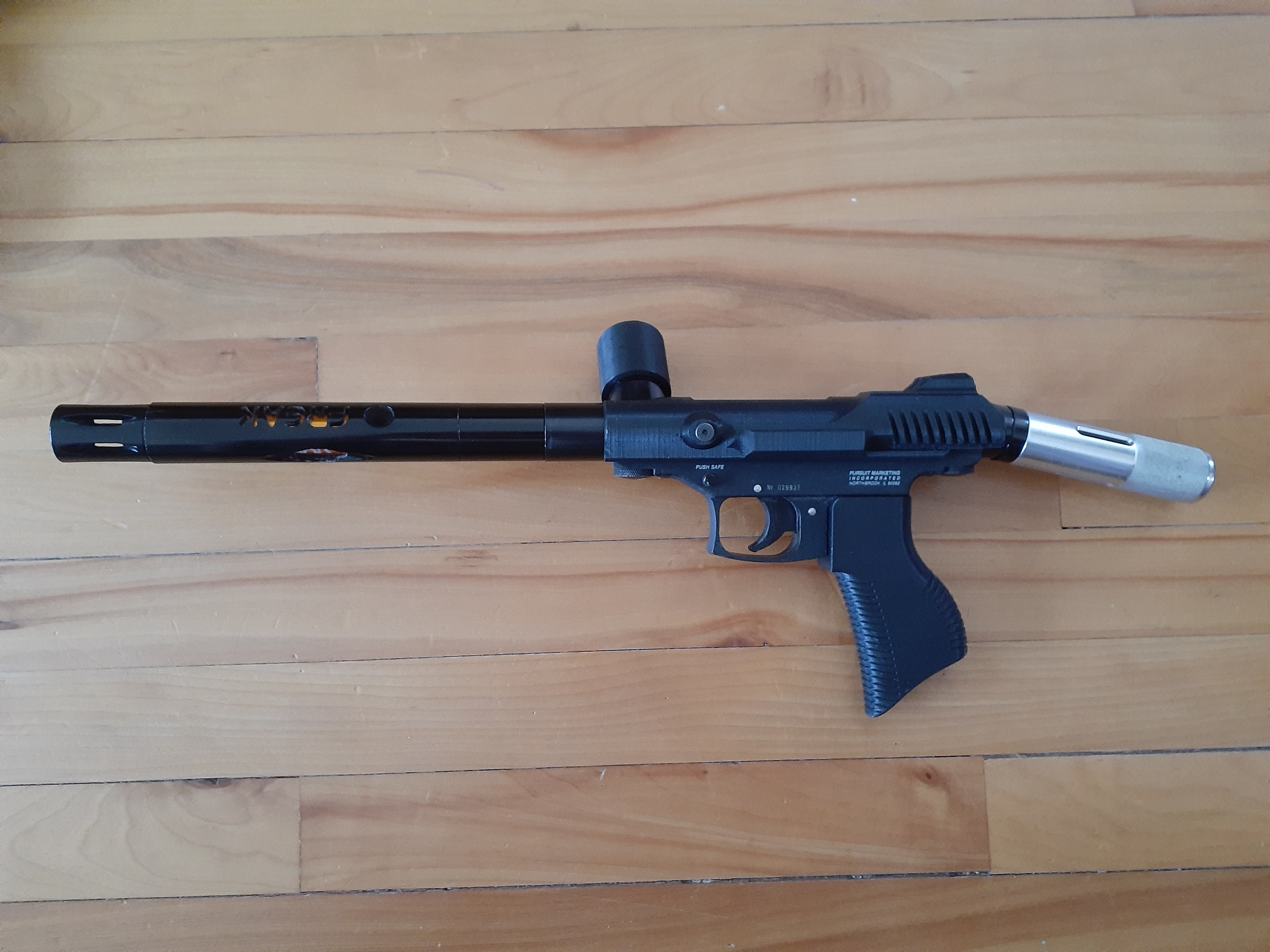

    The most clever Nelson innovation on my Trracer is the feed that allows you to clamp an elbow on it OR use it as a cramandjam since it’s got an o-ring to hold in a 10 round tube.

        I really like the idea behind the design of this body, but I agree it would need some improvement.
        What valve body are you using?
        I guess I will continue to use my 675 sizer trracer to cocker adaptor from SSC.

          oooh is that your backslide one? that's sweet as hell

          Jonnydread yes its the backslide one I was using for a few games last May at Slim stock classic.
