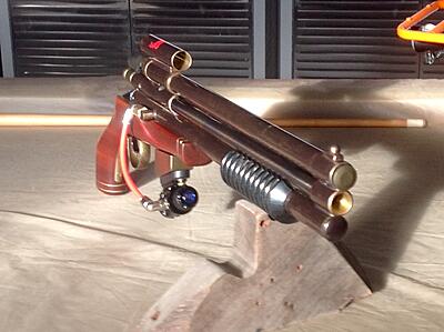

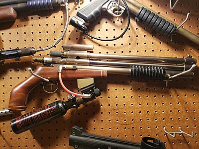

              Well, it's been a bit since i have posted but now I'm back...
              long story short after I tore the right thumb nail off I tangled with a door knob (dogs involved) and fractured two ribs and to top it off three weeks later I slipped on the stairs and bruised my tailbone...

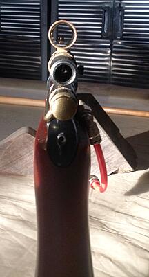

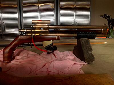

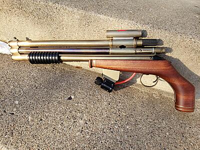

              Now I'm better and just completed this build for my main man Brickhaus...
              i had to make a trigger guard, install a kp trigger housing with modded trigger, drill and tap a rva, install air system, make a angled block for the asa, extended feed plug and a plug for the feed tube end.. also made a new cocking rod for that perfect pump stroke length...
              I originally posted that the powder was black but that is wrong... it's a gold fade powder that really looks good on this gun...
              i powdercoated the asa block, trigger and screws, the cocking rod and the external parts of the bolt also...
              Aired her up and with rva backed out she is shooting 285 using a 7oz. Air tank...
              if you use co2 she will no dought shoot hot..
              Holds twenty one rounds.......
              Here she is and I am thinking your going to like her....
              if you touch the pictures they will expand..

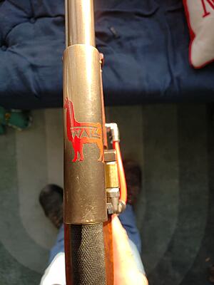

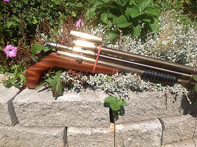

                        Man, this marker needs more attention. Expect a photo shootand shooting or playing videos next spring. I dont think Ive carried a marker around the house like this since I was 16. Im absolutly in love with this shooter. I keep picking it up and just smiling.
                        it holds extremely well in the hands. Seems to naturally point itself at your target.
                        Ive found myself just staring at every detail as I hold it. You find tiny flaws from the handmade aspect of the build that make it uniquly itself in a good way. It just wouldnt be the same if it were perfect in every aspect.
                        my wife doesnt let me test markers in the back yard due to her not wanting to annoy the neighbors. But Wednesday evening I put my 13 cu tank on it to air it up. The macro fittings leaked a bit and i giggled the line to seat em. I racked the pump and dry fired in my basement. This makes that unique thunderous crqck a sheridan is known for, but it sounds crisper? As this point, I was not under control of myself anymore. I loaded 20 rounds into the top tube and went out back.
                        Rocked and fired the first shot and that frigging smile came back. It was dark but I heard the round break on the big silver maple out back.
                        I rocked and cocked through the rest of the tube, and I can say, it seems to shoot straight as an arrow. Where Walz slips the tubes thogeher it creats a step where balls fall down into the breach area, and it seems to help the rock and cock process a lot. Balls accelerate to the feed port, and if careful you can flatten the marker and keep a ball above the bolt for a rapid second shot.
                        I do want to make a few minor mods like swap the pump handle out for something different. Im likely going to snag the cooper t one from bacci. Also considering a venting asa, and or increasing the drop rail length so I can run my 45/45 for big games. I also have a cooper T bolt Im tempted to run, but the matched powder coated bolt is a really nice touch so its not likely.
                        In either case. no changes til I get some Gs with this beast.

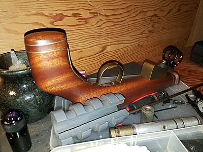

                        Ive been fondling it so much, I let the cocking lug drop behind the hammer like a noob. And now I gotta take the rva off to get it past the hammer. But I wanted to see how it looked with the cooper t bolt installed.
                        Im telling ya Wally. Im smitten. I havent even looked at my new to me pps stroker since last week.
