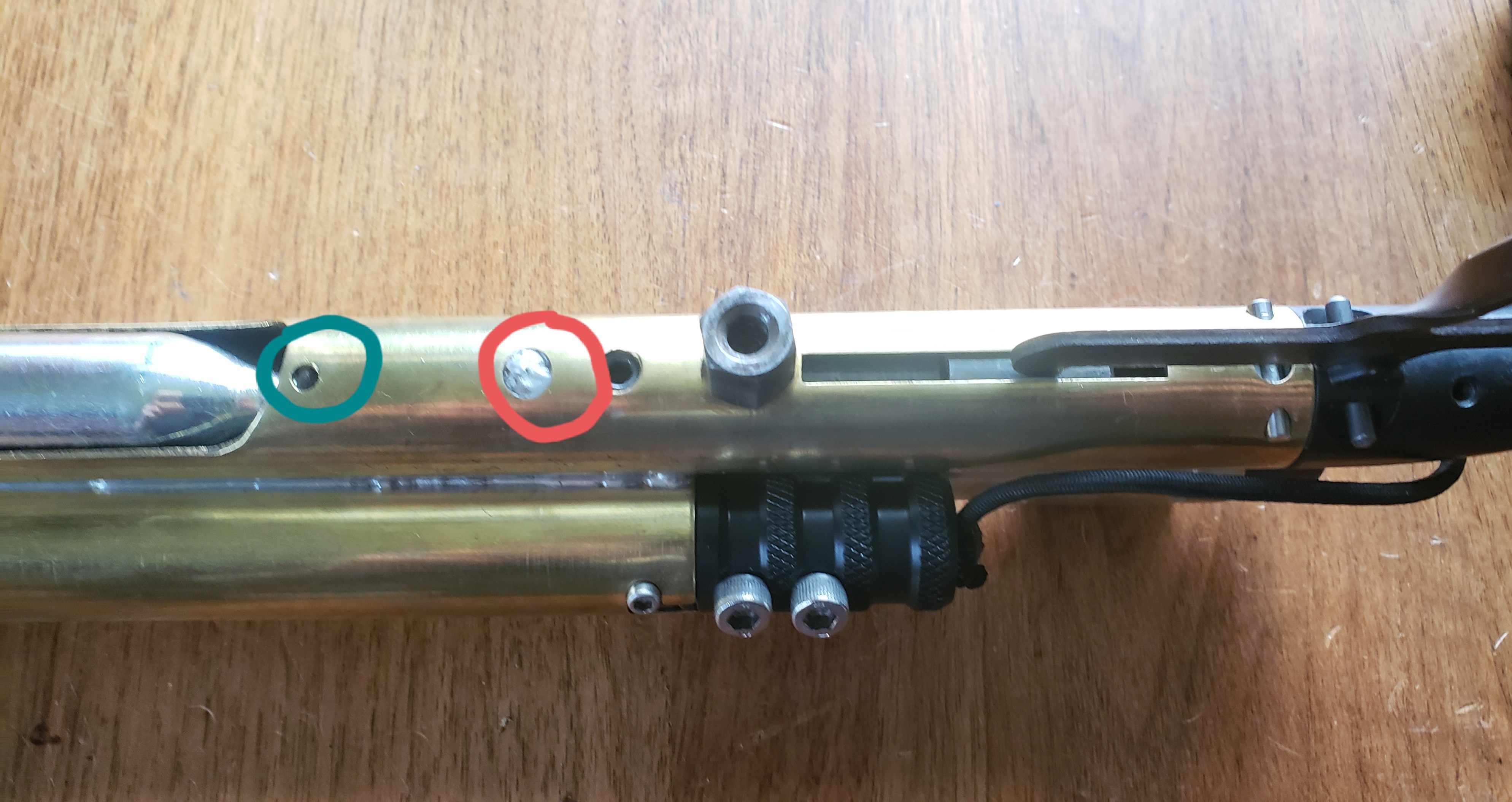

        Ok, so Kseries (KP, KP2, KP3) rifles and scratch-built PPS brass share the same valve core location and hammer travel. Their hammer travel is nearly an inch longer than P-series brass, so the mounting location for the front grip screw is in a different spot, necessary because of the valve positioning.
        The green circle shows where the frame mounts to on a Kseries - the red circle shows where it would be on a P-series. As you can see, the red circle is around a solder location - if you were to drill/tap there, you'd hit the valve chamber.
        If you want to install a K-frame on your Painter, you'll need a Palmer spec frame, and a threadsert (or something with threads) in the area I circled in green.

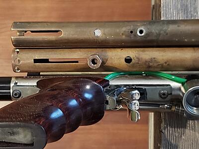

          Jordan nailed it. here's a quick picture side by side, p-series on top, standard k-series in the middle (actually c-series but they're the same), and palmer's (in this case an automated k-series but they're the same). for your front frame screw you'd either have to install a nursert or see if a nursert ring (iirc bacci has them in stock) can squeeze in there.
