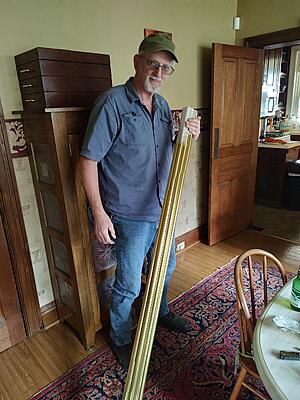

          Find a brass supplier. You may have to make a minimum purchase. In which case selling it off shouldn't be an issue.
