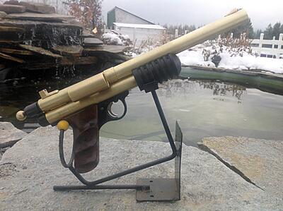

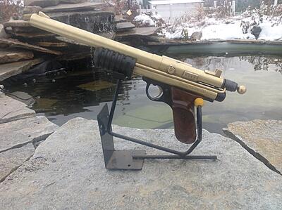

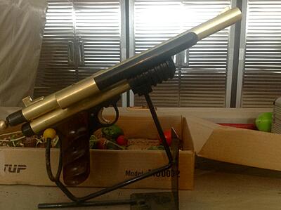

    posted in Walzmas but needs to be here also... a free build..
    started with a pgp pgp single shot his bought from antiarchitic ( killed his name again) and this is what happened..

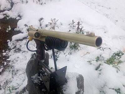

    sleeved titanium barrel at 10+ inches..
    converted to pmi style feed and bolt
    enlarged ports, valve ported, palmers dyna valve, new springs
    made it side tubed to except ten round tubes
    Made a longer brass pump rod to extend pump to front of co2 knob...
    pull knob added for bolt action
    quick strip notch

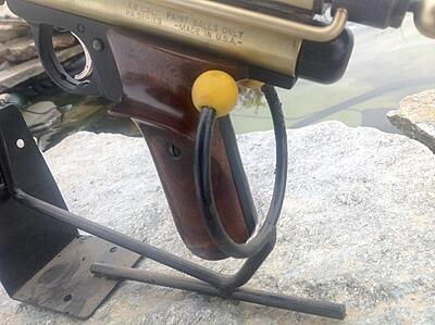

    hand made sites front and rear... made from a stick of half inch brass stock using dremmel, file and sandpaper..
    slipped in a WALZ logo..
    he wanted it plain looking so I polished the whole thing out and then took a used scotch brite to her to give it a bit of distressed look..
    made a pair of grips using black walnut with many coats of boiled linseed oil and hand polished..
    think that it..
    Here she is....
    There are five pics.. hit the blue box with the five in it to see all..
    thanks and merry walzmas and a happy holiday to all..
