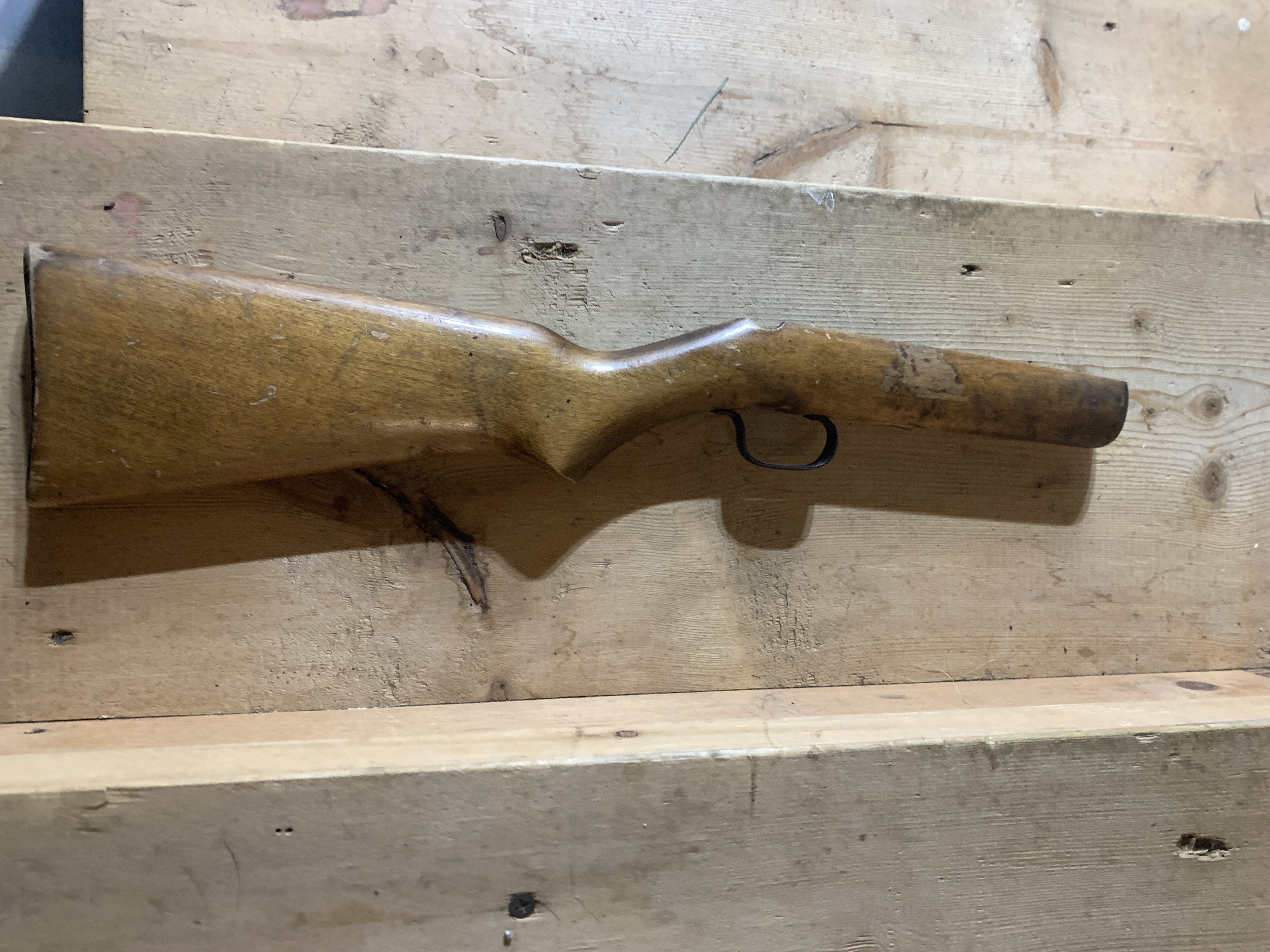

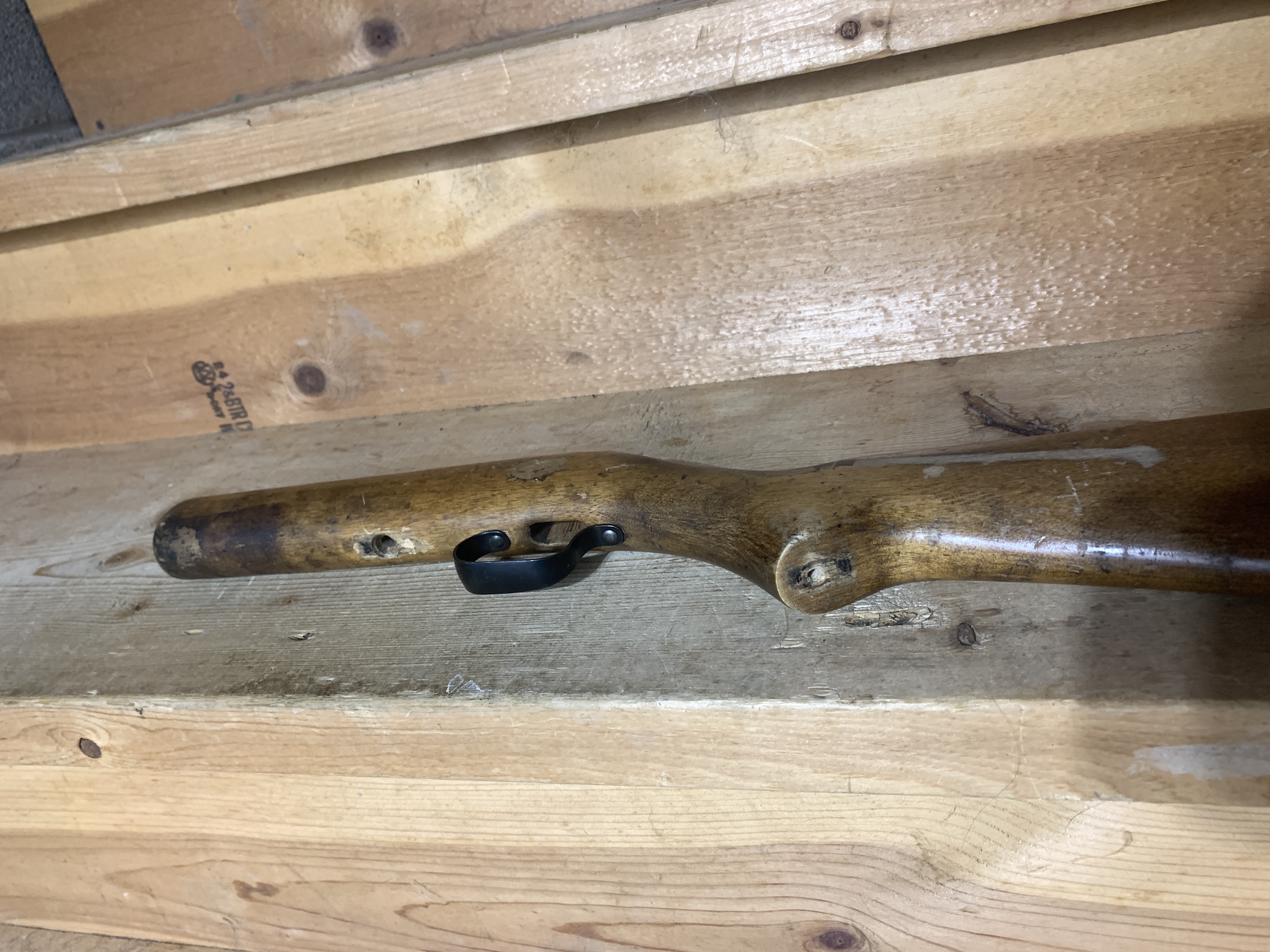

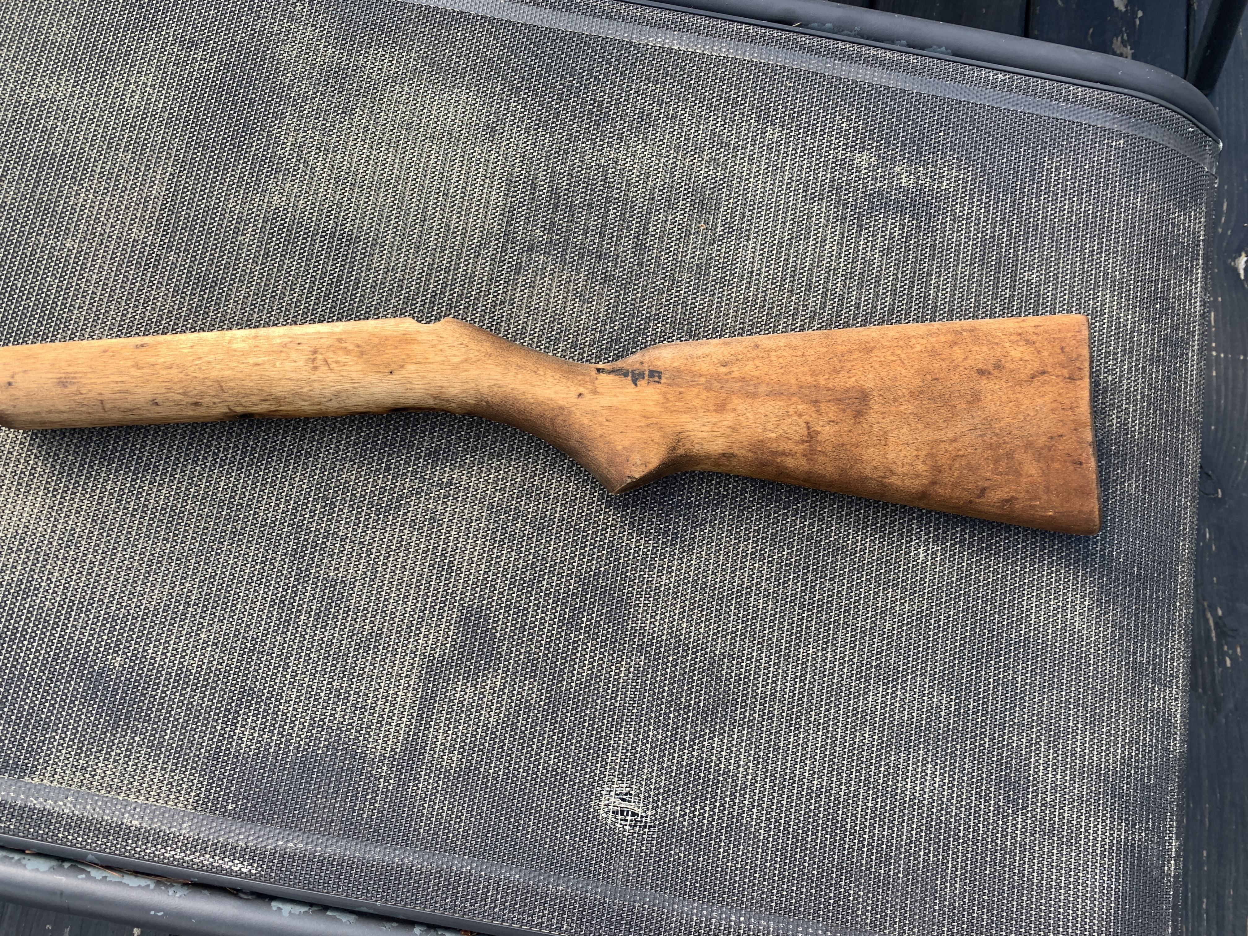

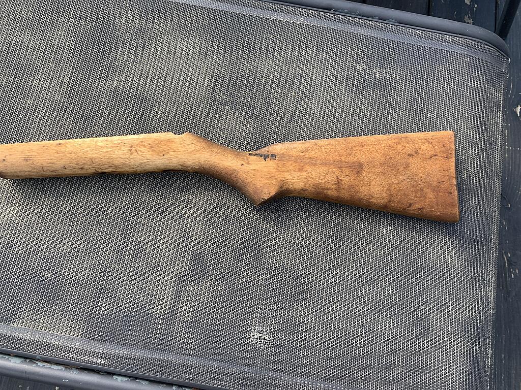

    As you can see, this stock is gross. I tried washing it, and this was the best I got…
    so…I pulled out the big guns and decided to completely refinish it.
    JeepDVLZ45's Feedback
    💀 Team Ragnastock 💀

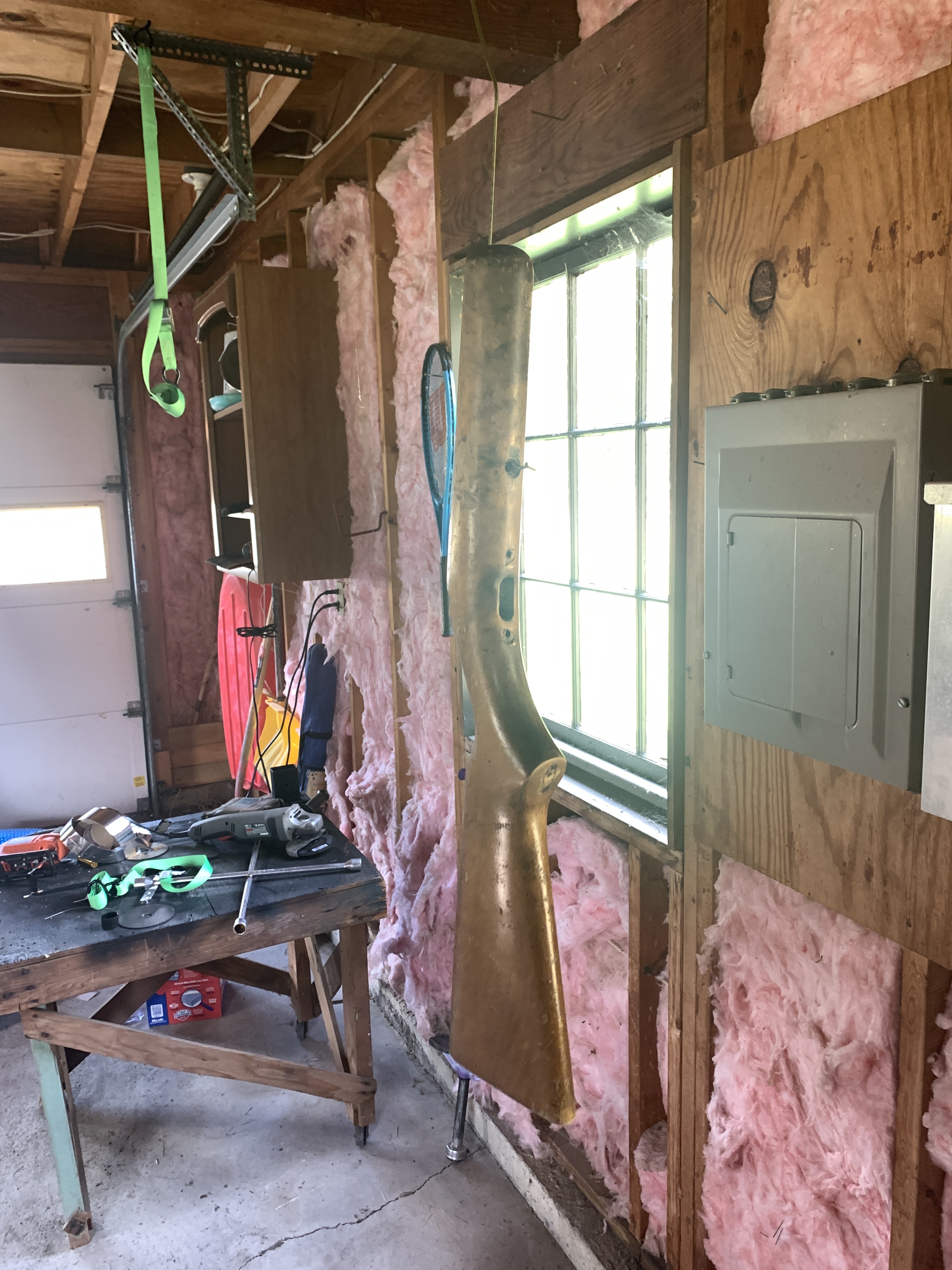

      Started by pulling the trigger guard and then hit the garage with Citristrip
      scraped clean and rinsed off
      all dry

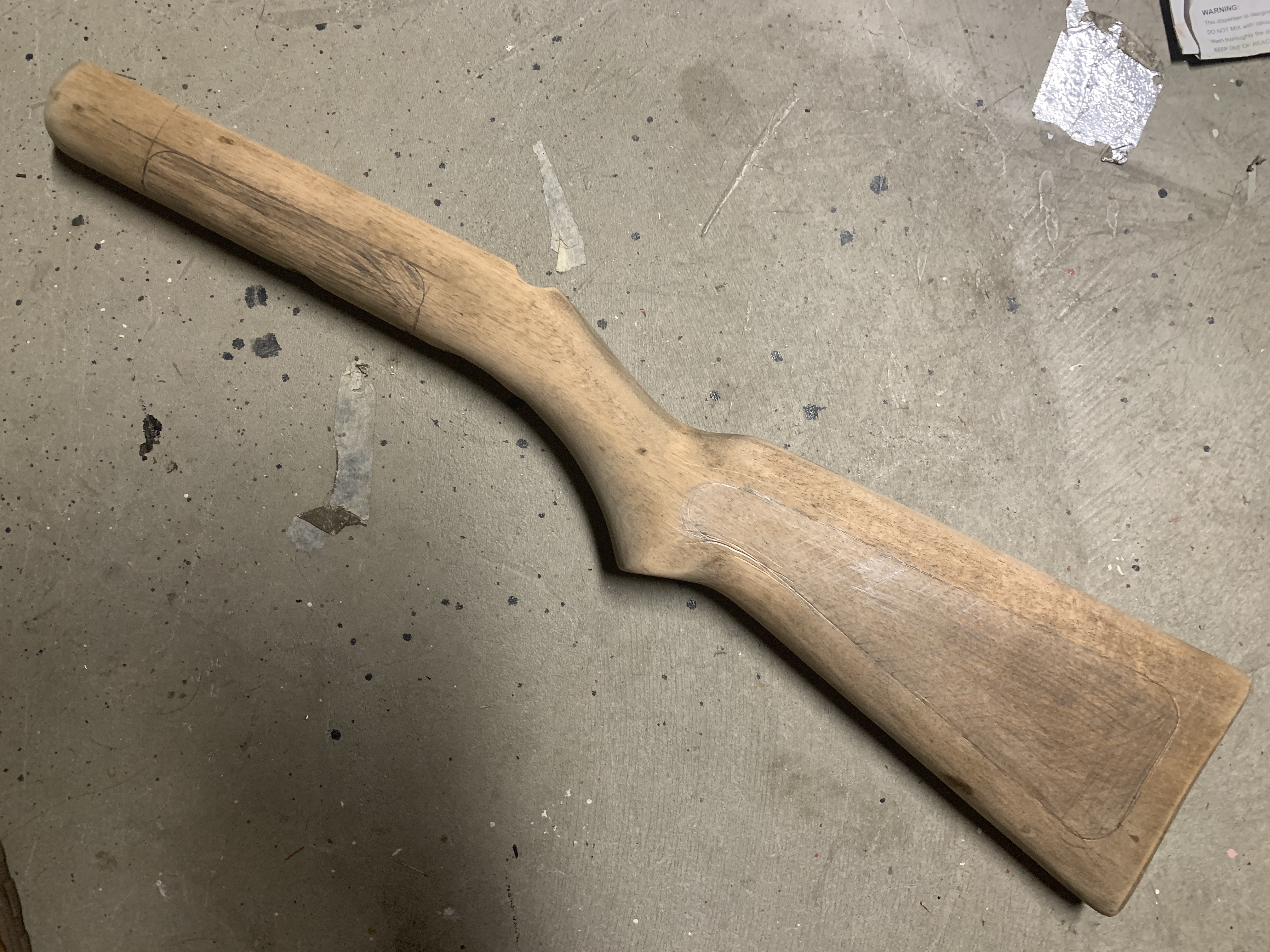

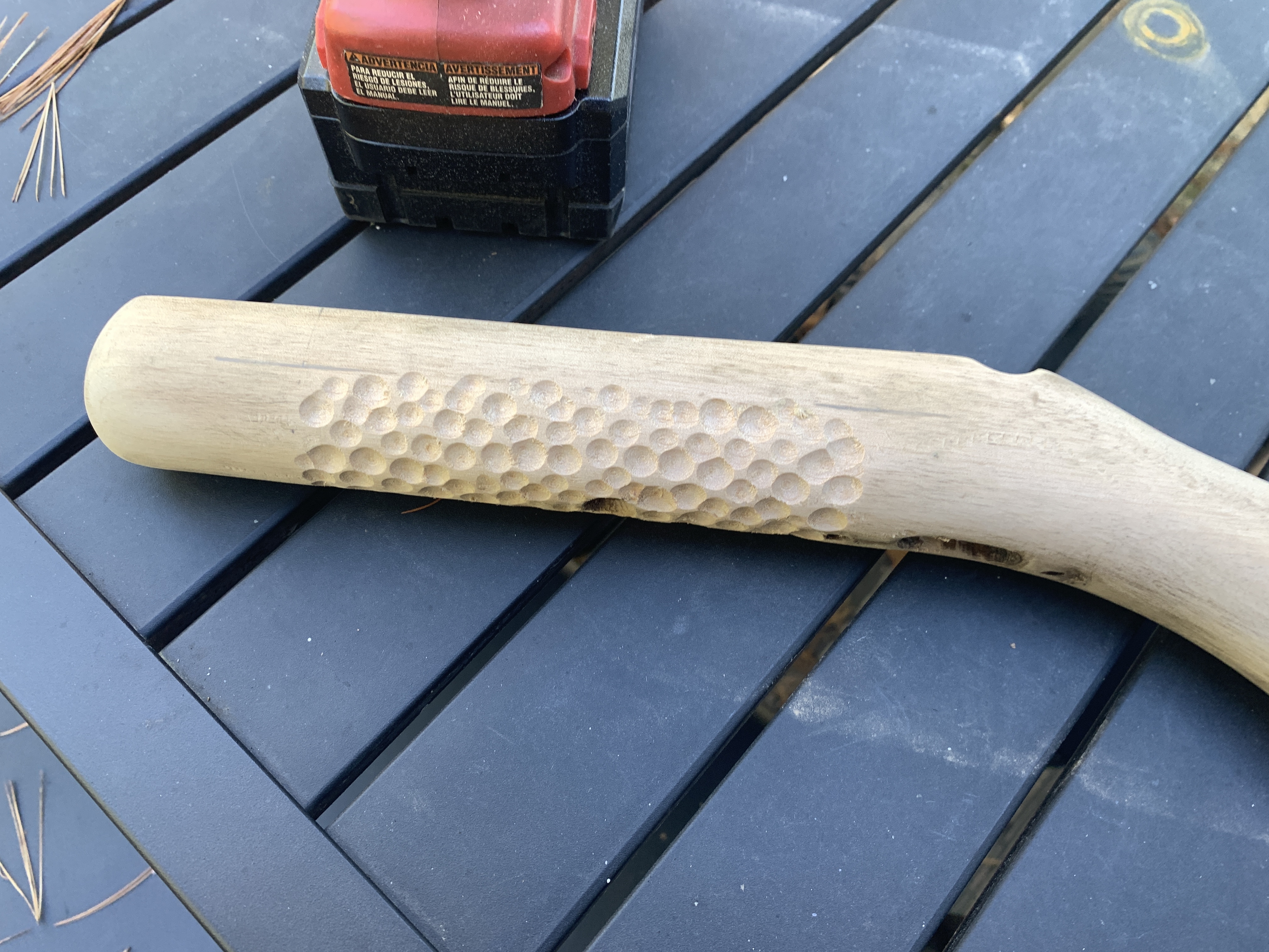

        Sanded her down with some 120 grit, then 220. Taking out some of the gouges.
        Then, down to the basement where I marked the outlines (in pencil) where so planned to start patterning the stock.
        💀 Team Ragnastock 💀

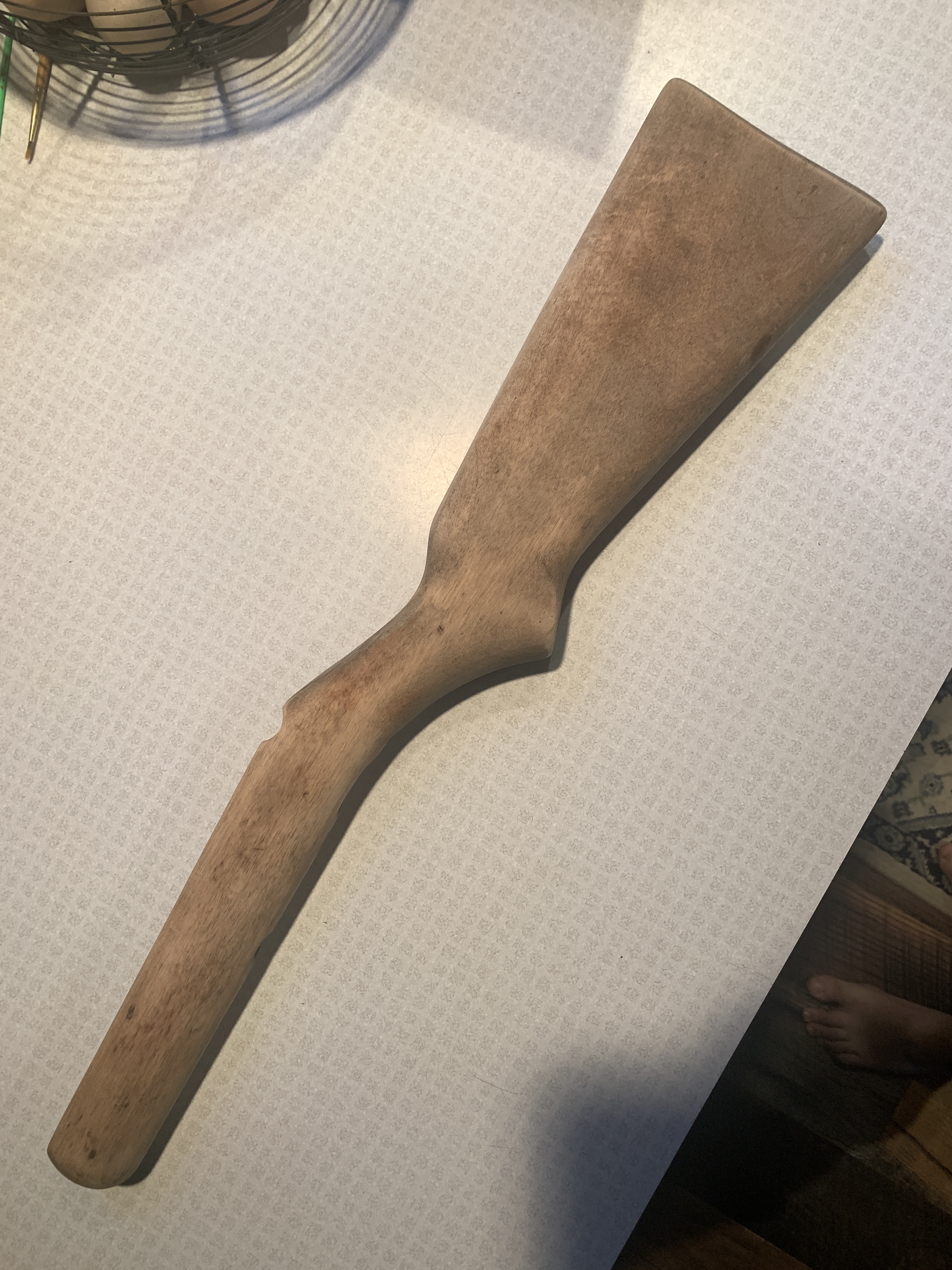

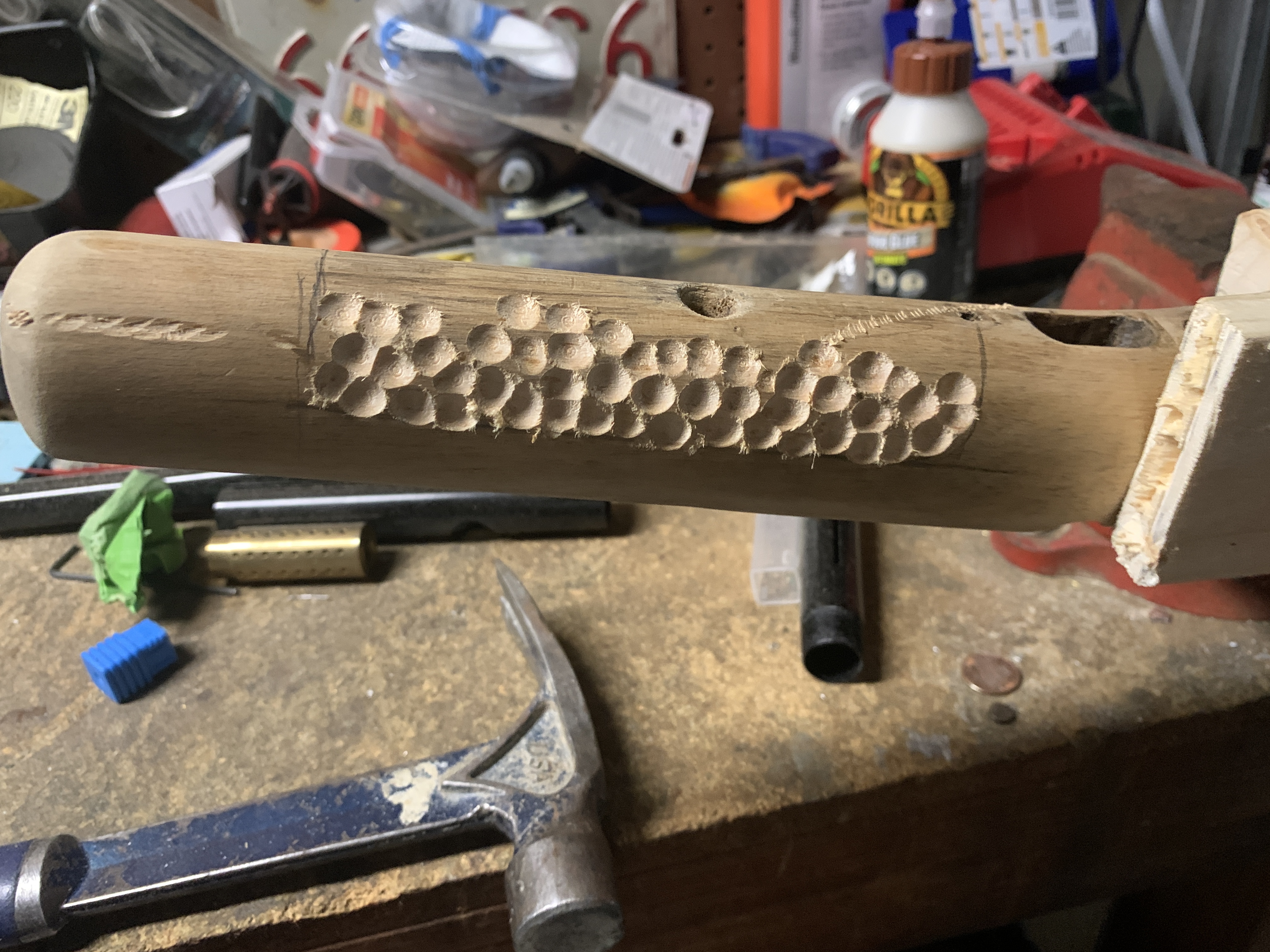

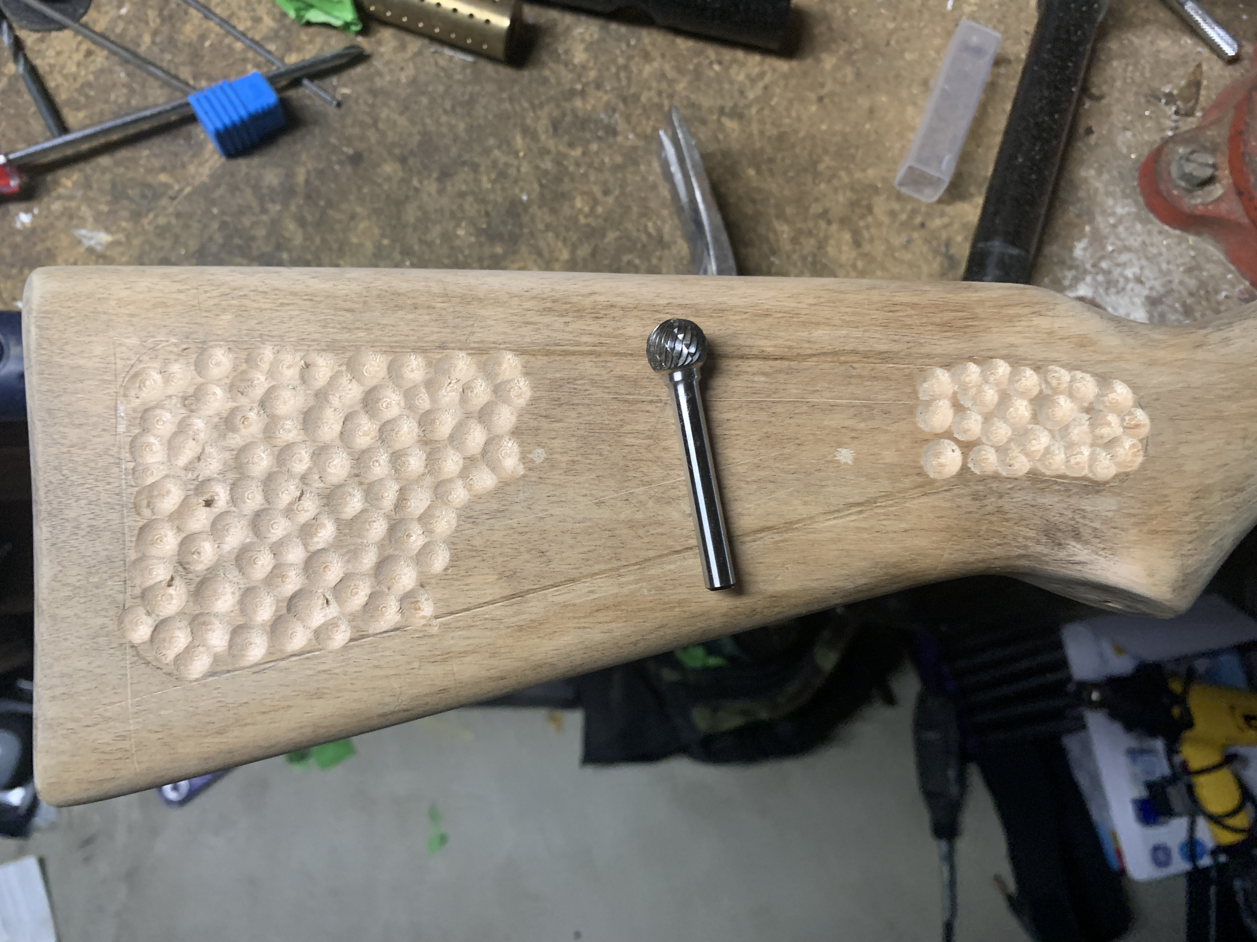

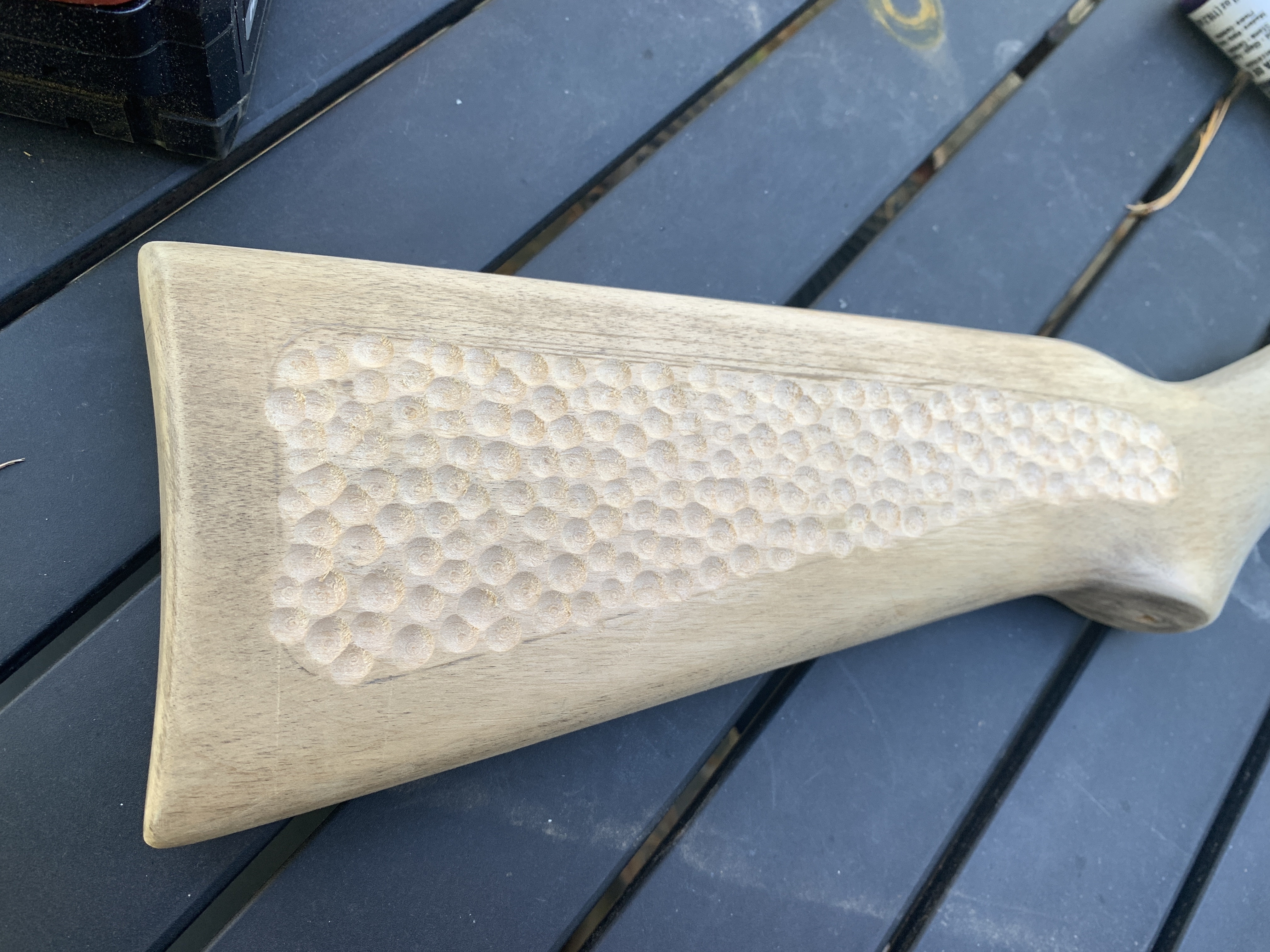

          I picked up a 1/2” spherical bit, chalked it up and went to town on the stock. This took several hours over 3 days to complete, and my hands/arms hurt!
          I missed a few times and gouged the stock a bit, but as I completed areas, I sanded them down with 100 grit to keep everything smooth.
          I really like the way it’s coming along

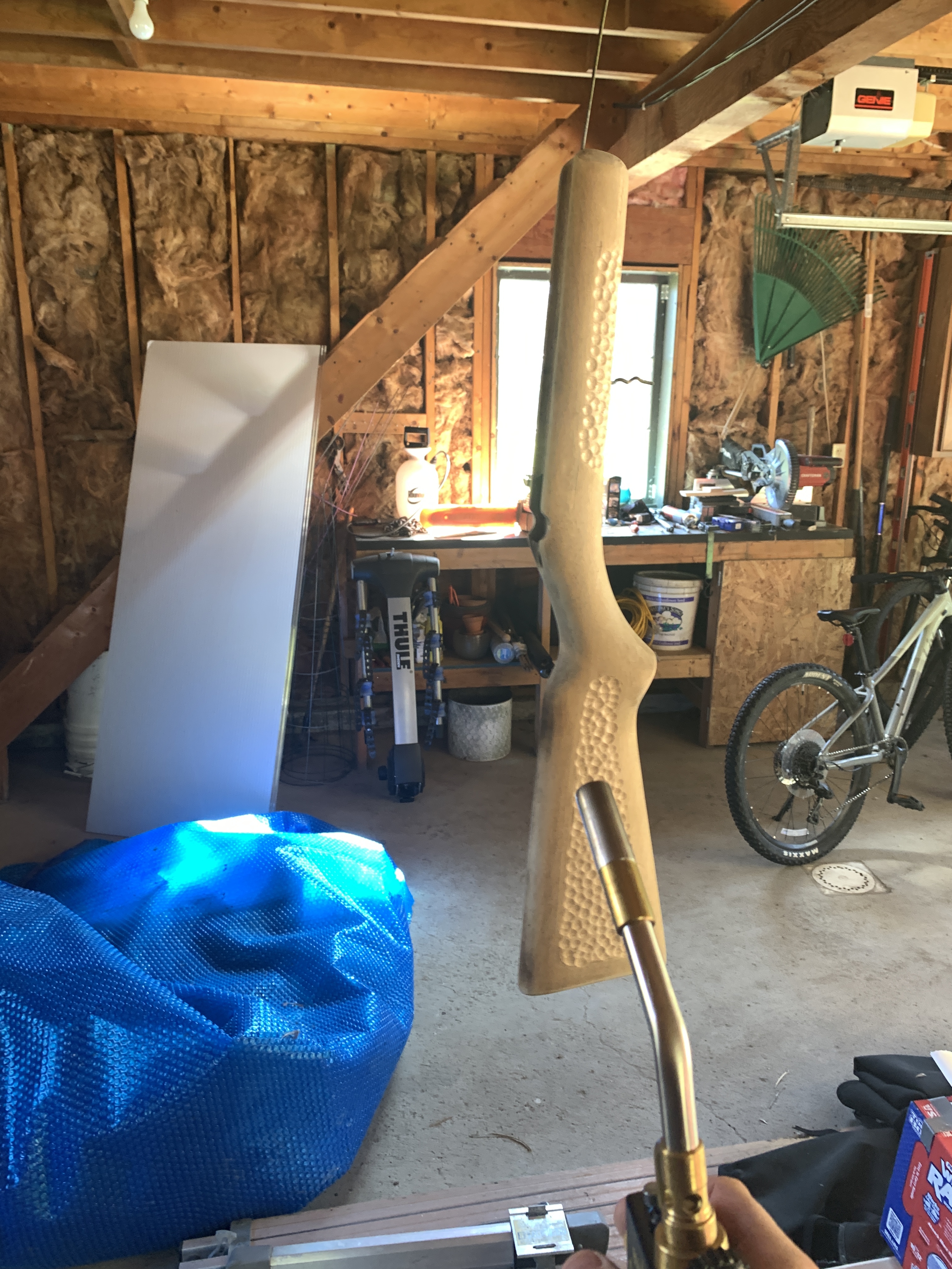

              Now for the fun part….
              FIRE

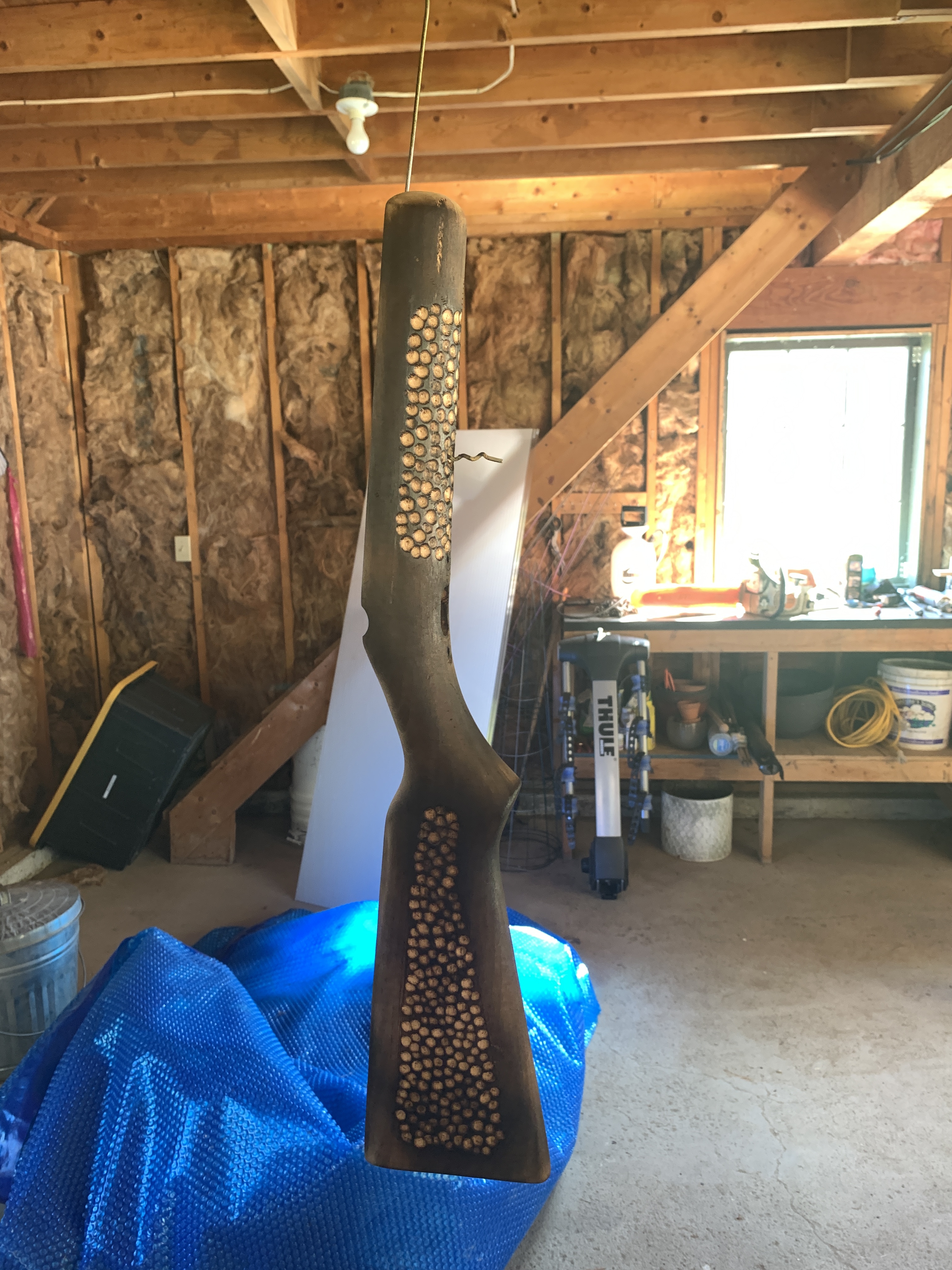

              At this point, the color was a little darker than I wanted, but I have to hit it with steel wool to knock the char off. So it will lighten a bit.
              Now, so REALLY don’t like how spread out the “dimples are”. They seemed much “tighter” before I burned the stock…but the charing shows off the imperfections.
              so…I went back to it and enlarged/deepened the dimples…
              and the I burned it again did a light sanding and blew it out a bit

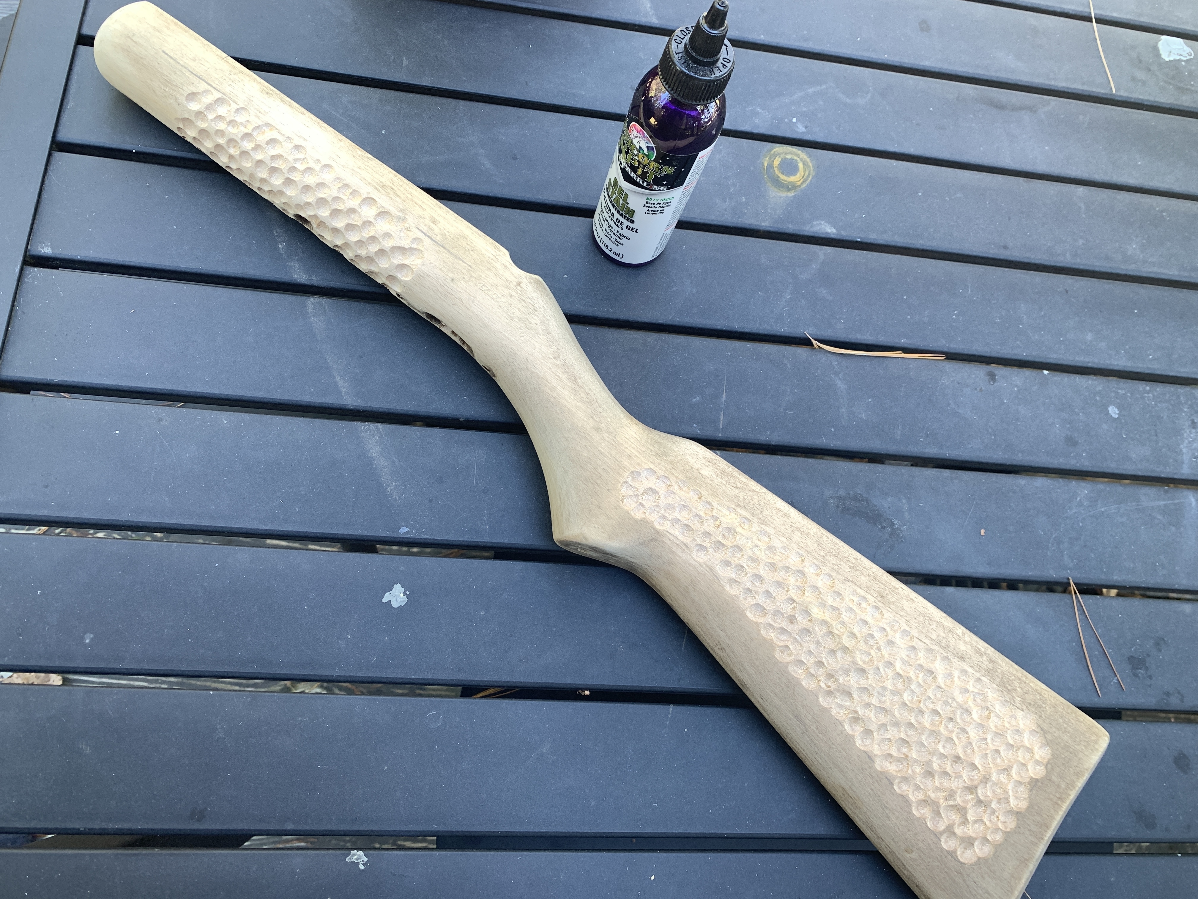

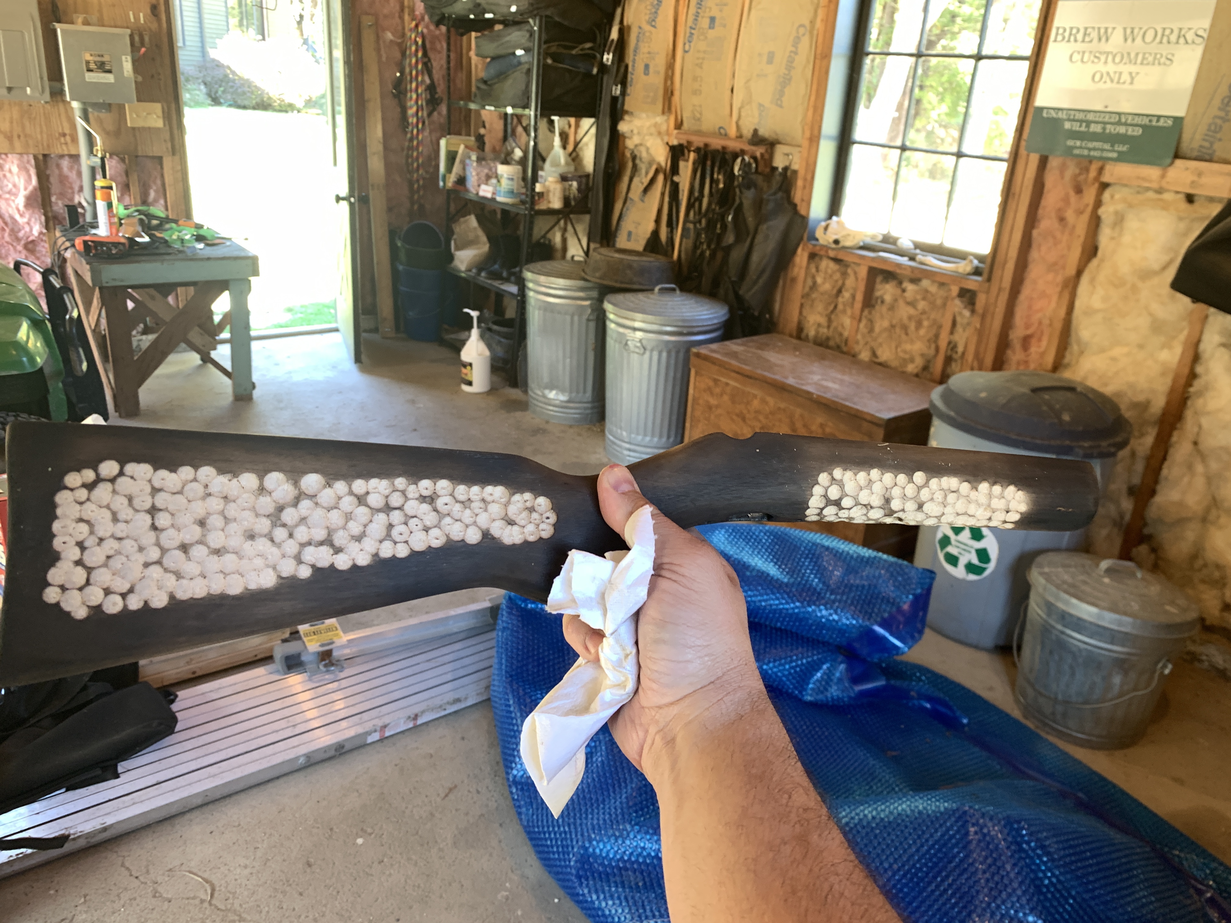

                Finally it’s time to “stain”. I’ve had this stuff for a while now.
                It’s called “unicorn spit” I picked it up in purple with sparkles…this stuff is a little intense for me. I’ll have to tone it down for what I want…

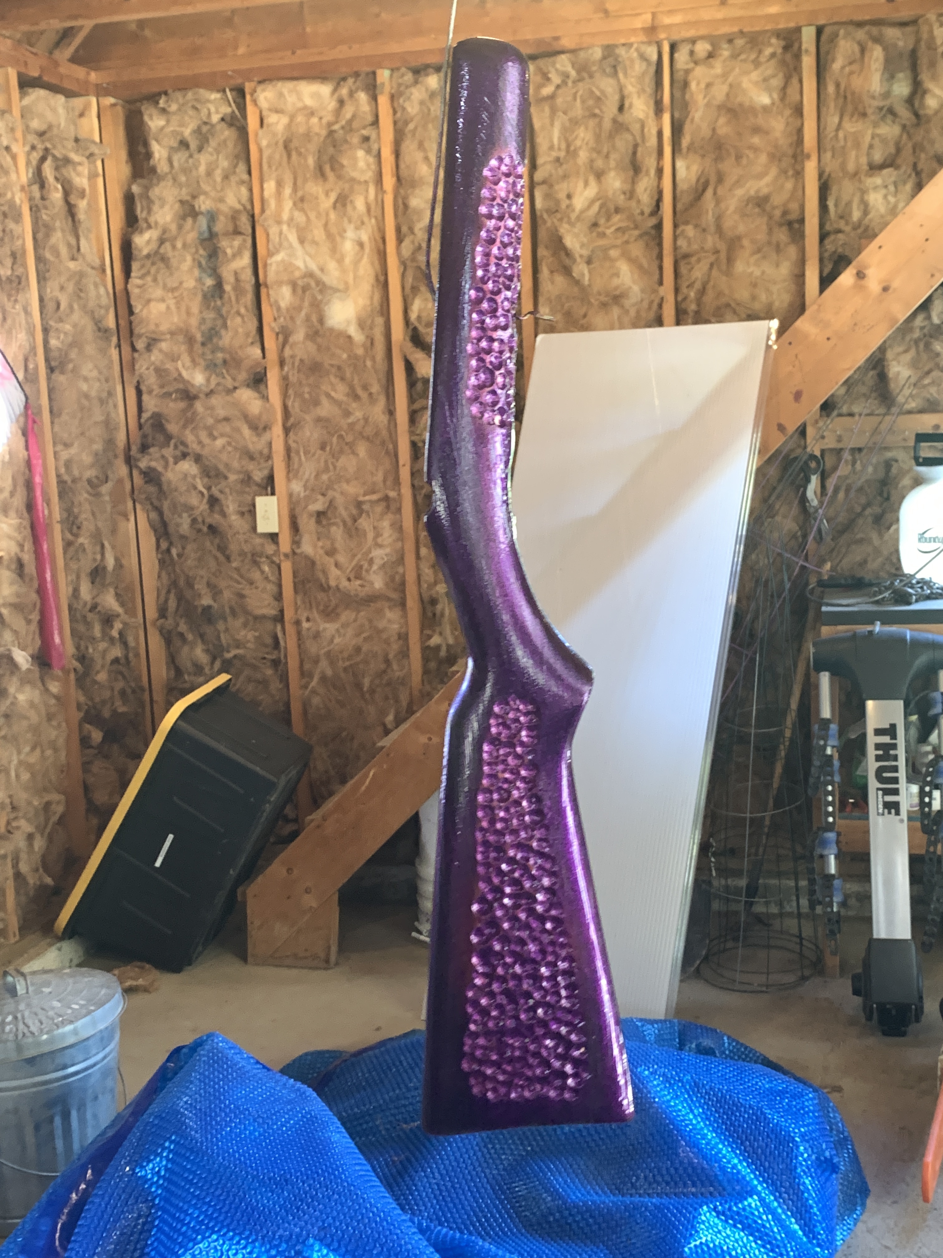

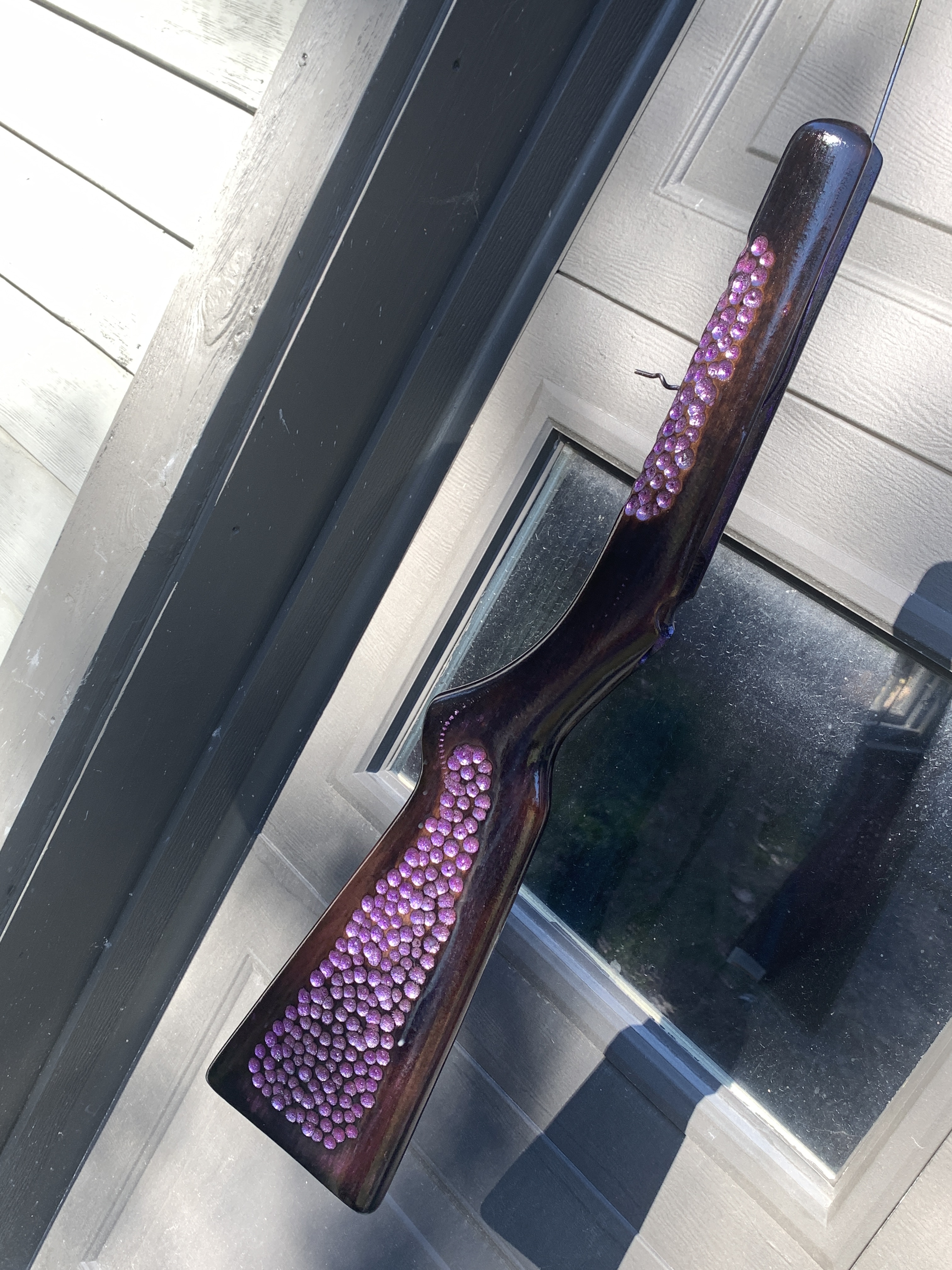

                  After it dried, I sanded it down…again..and removed most of the stain. Then I took the torch to it…again. It looks so much better!! When the light hits it, the charred parts of the stock glisten with a little bit of purple
                  I’ll have to start sealing it in the morning….

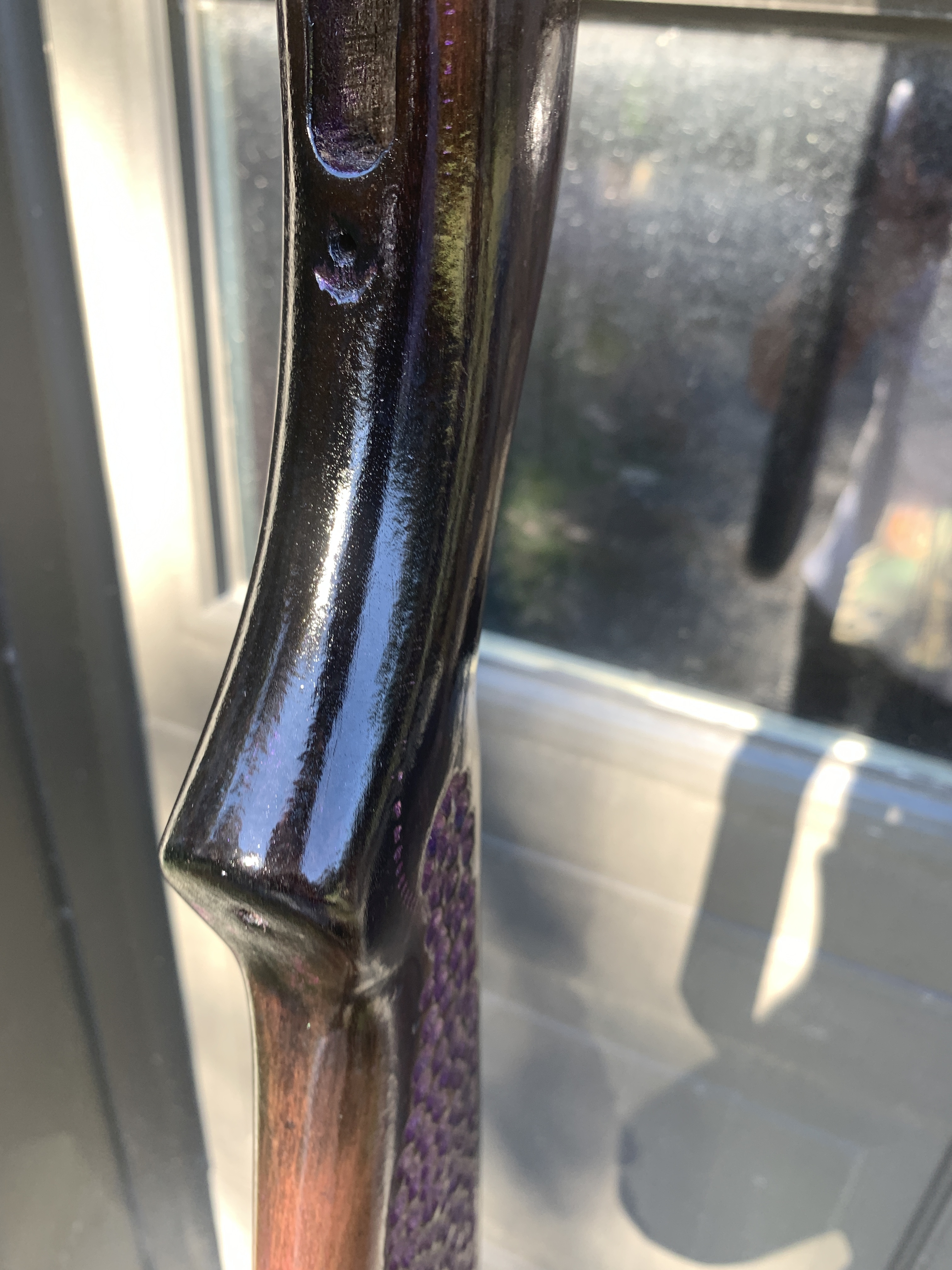

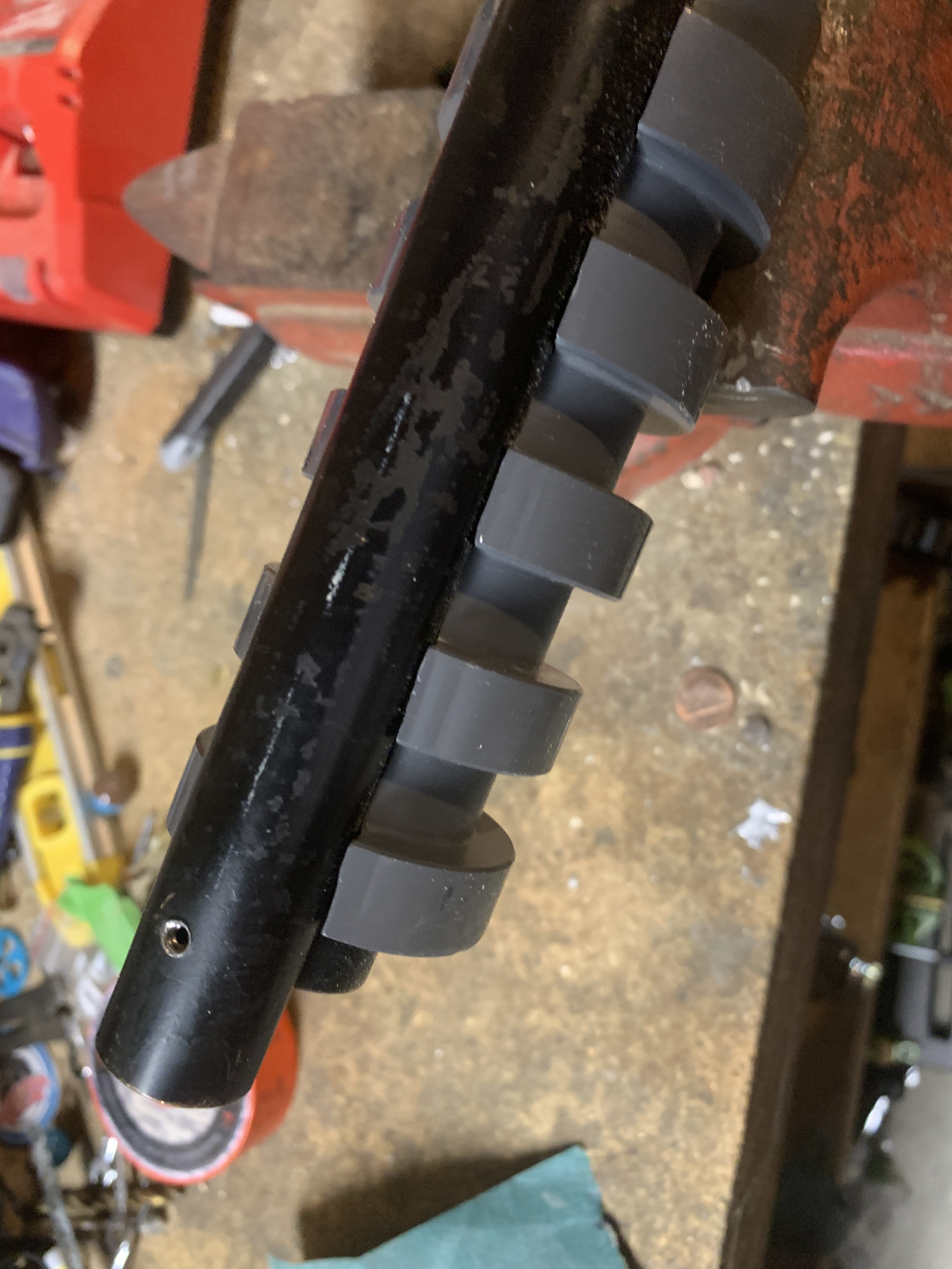

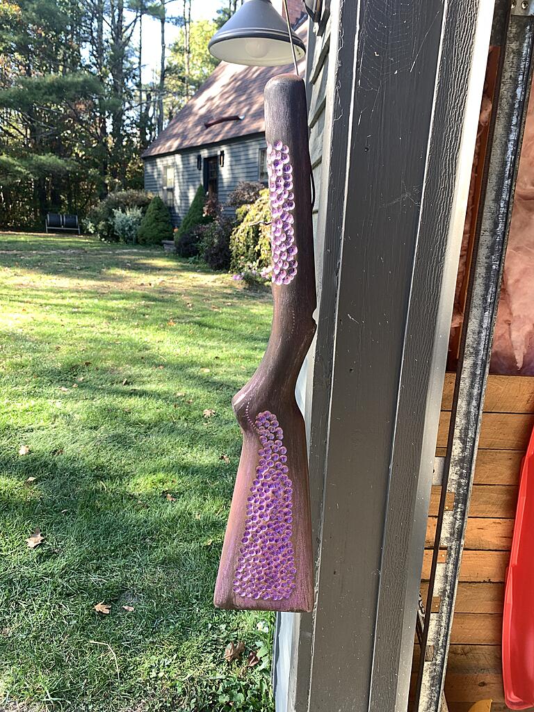

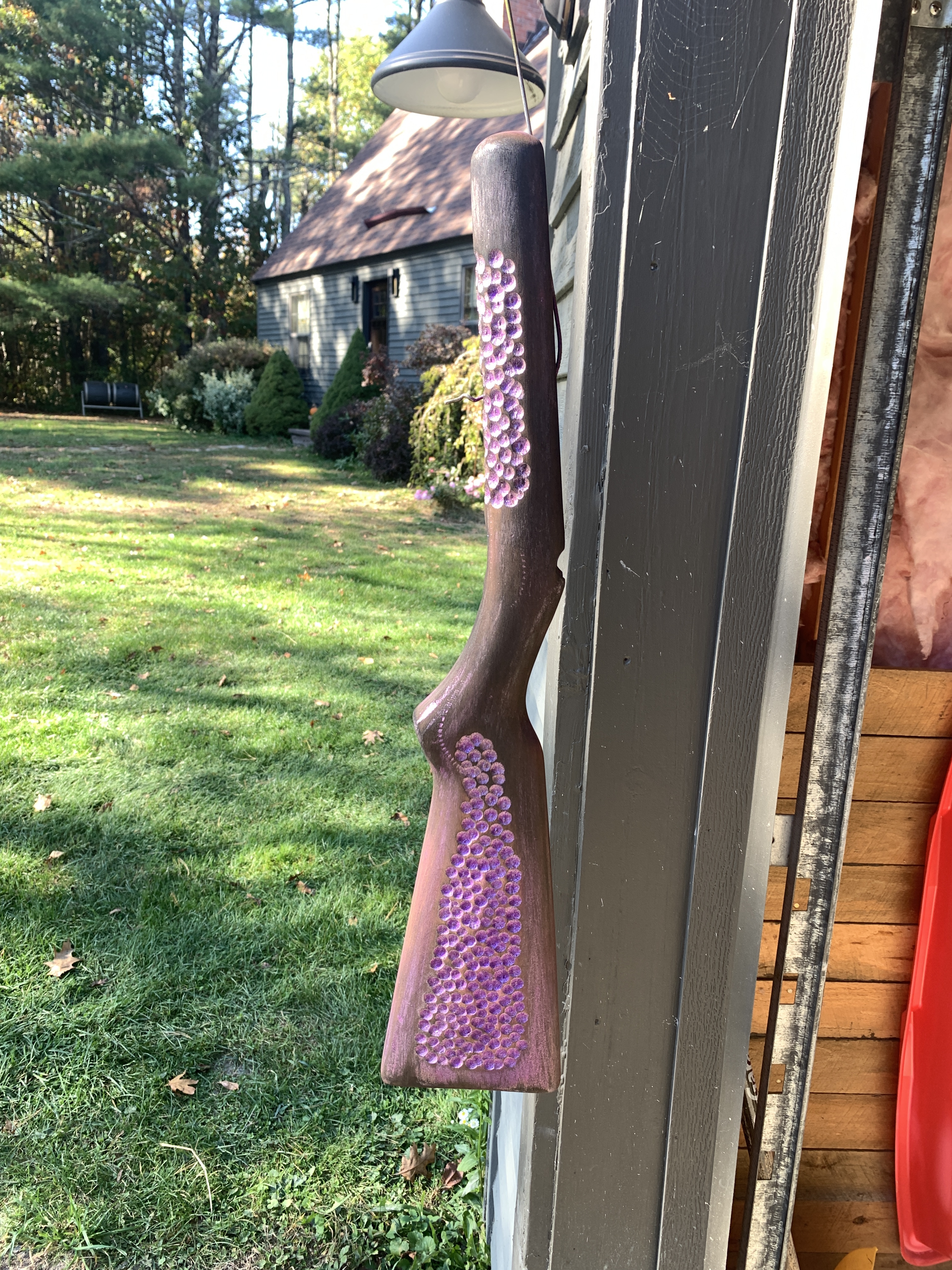

                  Sorry for the lack of updates, I was having a tough time getting the poly to a decent gloss finish.
                  nothing noteworthy on the process….just needed to use enough to build up a decent layer. (I used spray poly cause I’m super lazy) just give it a thin coat, let it dry, buff with “0000” steel wool, repeat. Did that 4 times until to get a decent base layre and then did the same process with 2 thick coats.

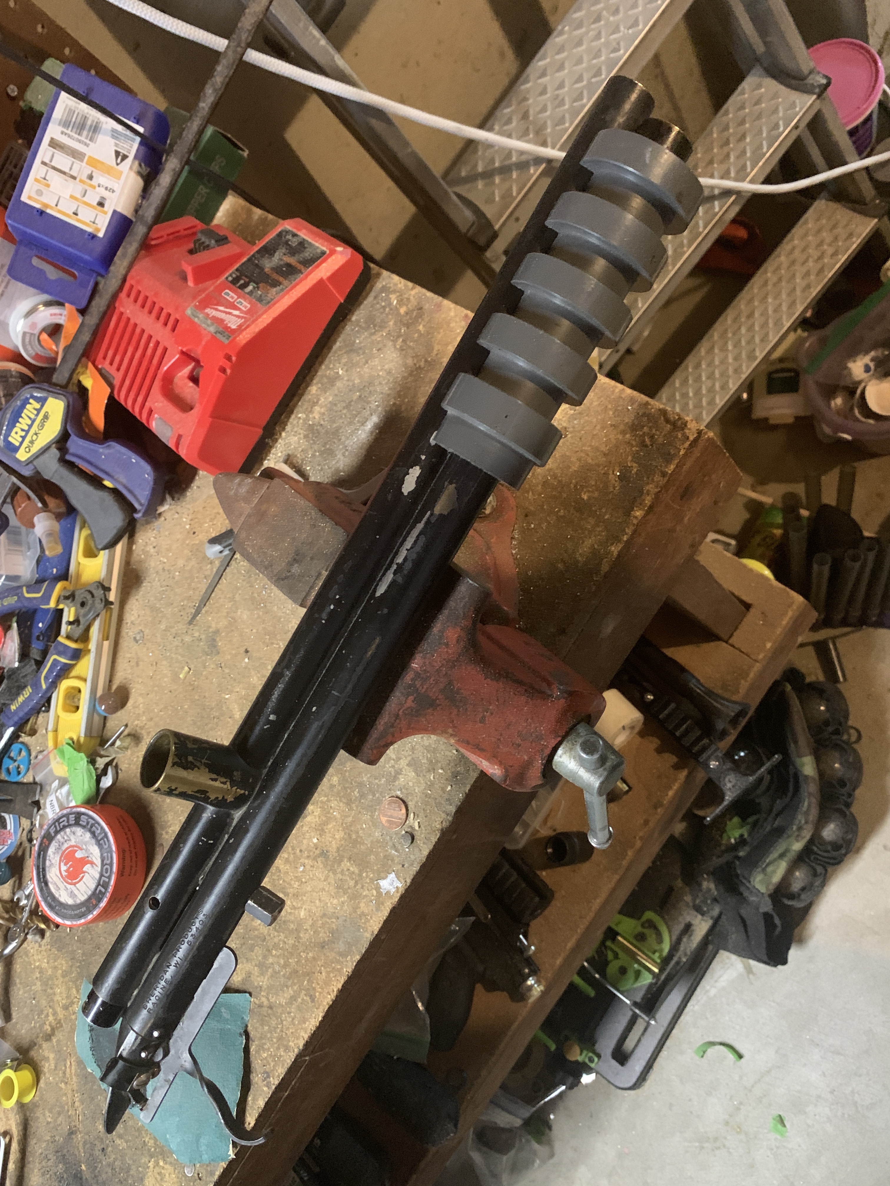

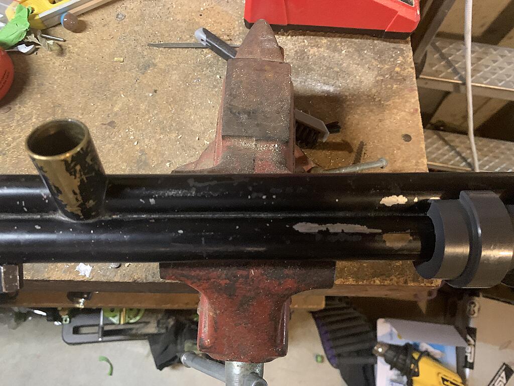

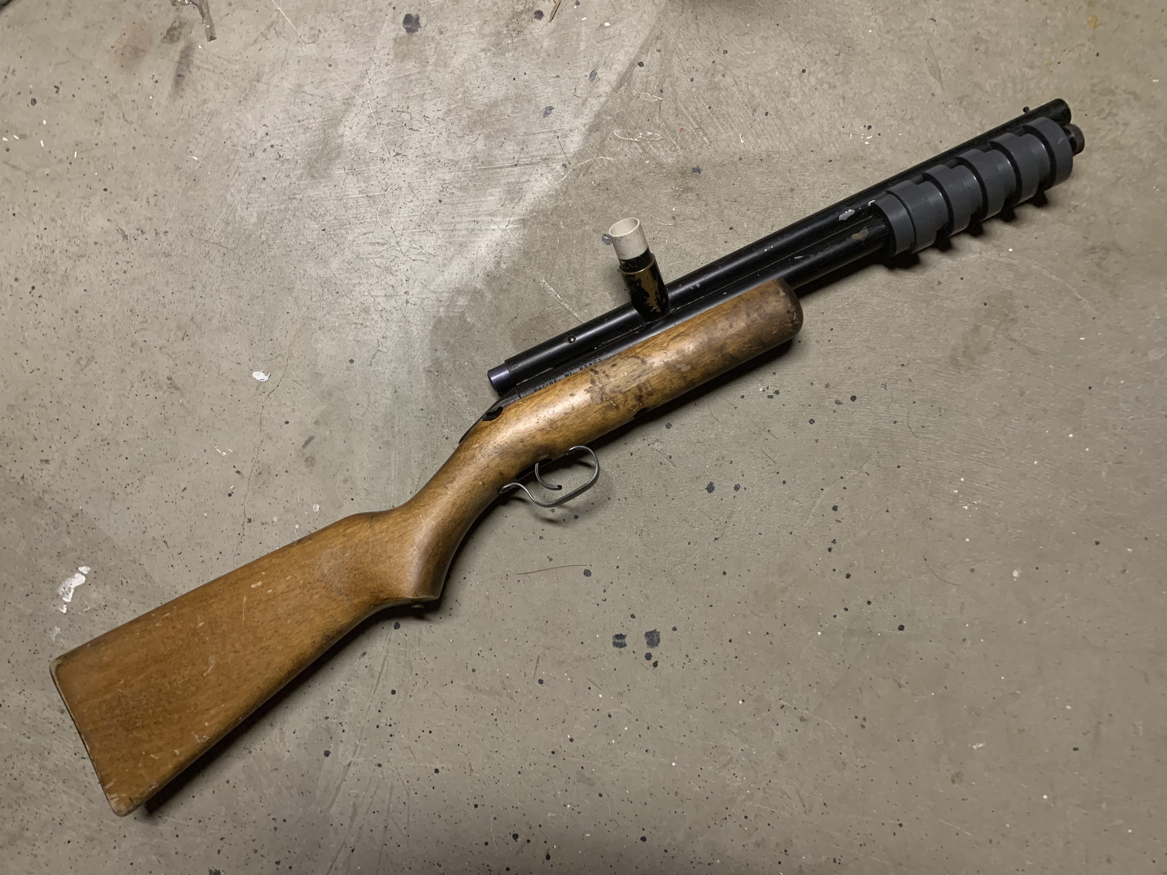

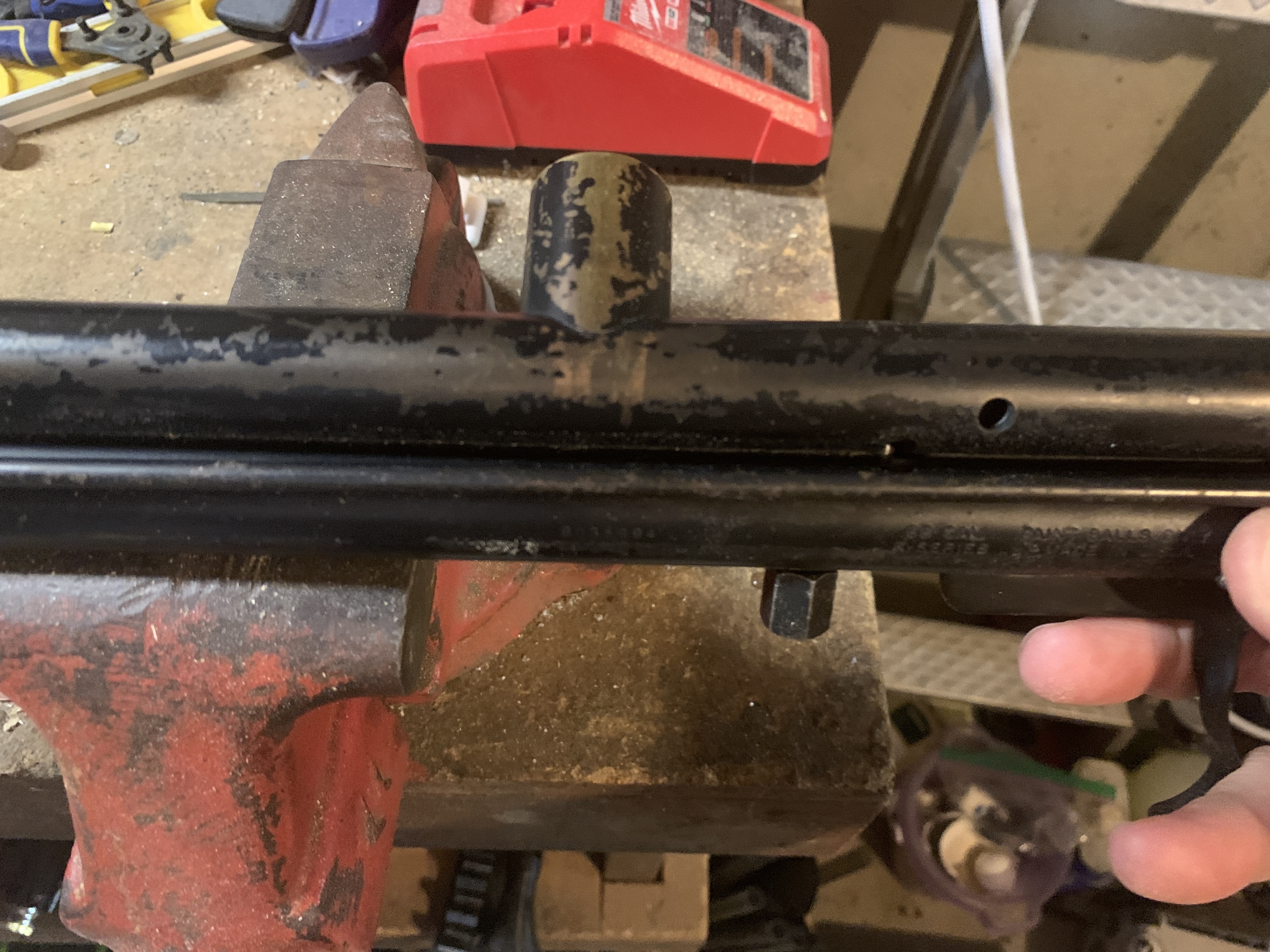

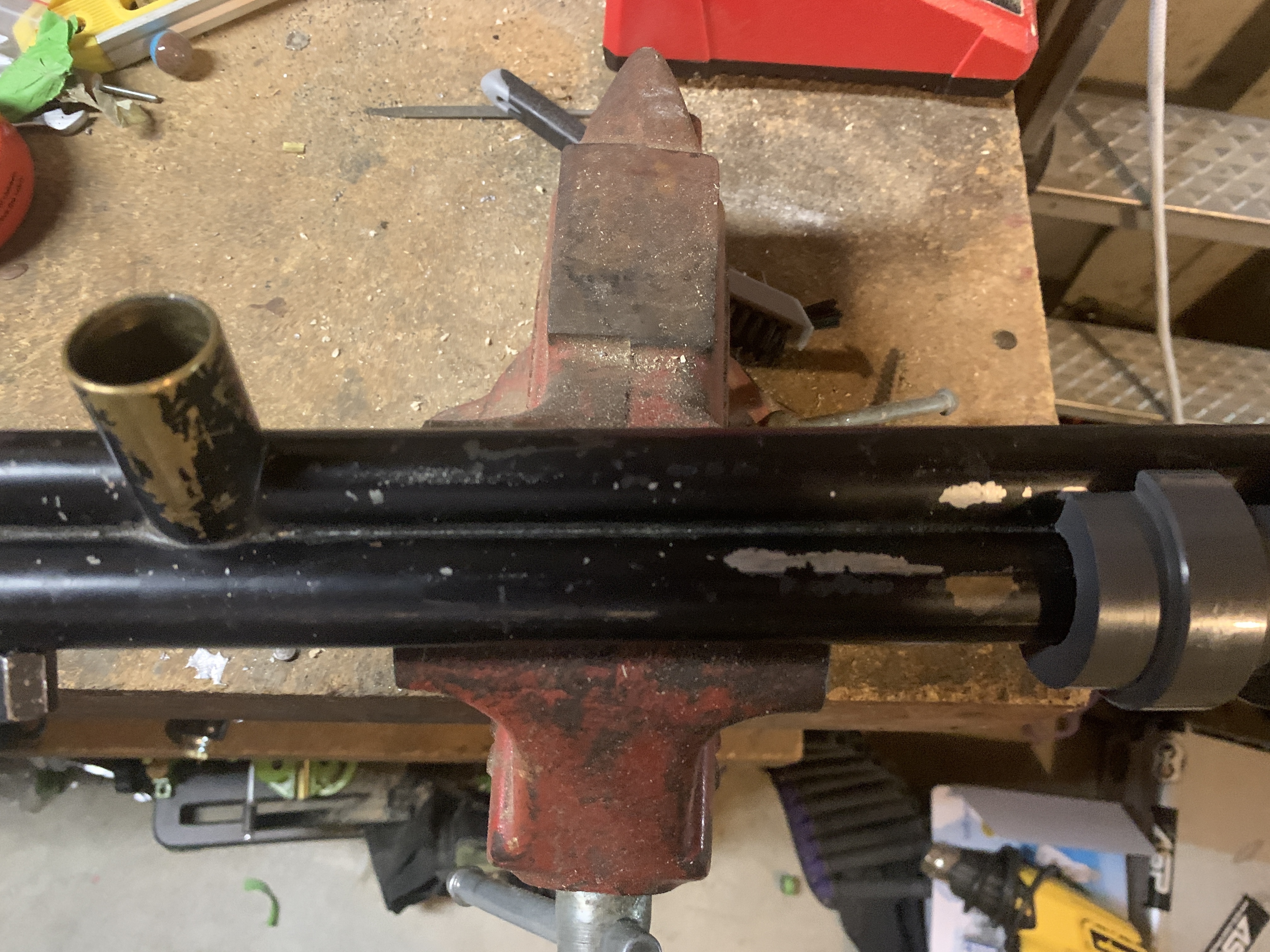

                  Now I have to figure out what the $@&% I’m going to do with this thing….
                  As you can see, its finish is trashed (which I sorta like) but it’s a righty AND a direct feed (Boo!!).
                  💀 Team Ragnastock 💀
                    My initial thoughts…..
                    Say goodby to the feed neck and get a SC feed somewhere on it (either LH, 3/4 LH or center)
                    Keep the pump handle.
                    Add detent(s)…not wedgets.
                    Refinish? Forced patina? Not sure how it’s look with that stock.
                    High Polish….maybe…but a little fancy for me.
                    Add an external bucket changer?
                    Complications, that pump handle will need some severe modification if I want a full length feed
                    If I go to a full LH stock class feed (I’d LOVE this) I will need to re-drill and tap the bolt, and figure out a different way to retain the lug since I won’t be able to “rotate the bolt to get to the lug). 🤔​
                    I don’t plan to go too crazy with it, I don’t want to sleeve (other than to cover up the old breech hole) it or torch the tubes apart for any work if I don’t have to.
                    Input form you guys is welcome…..
