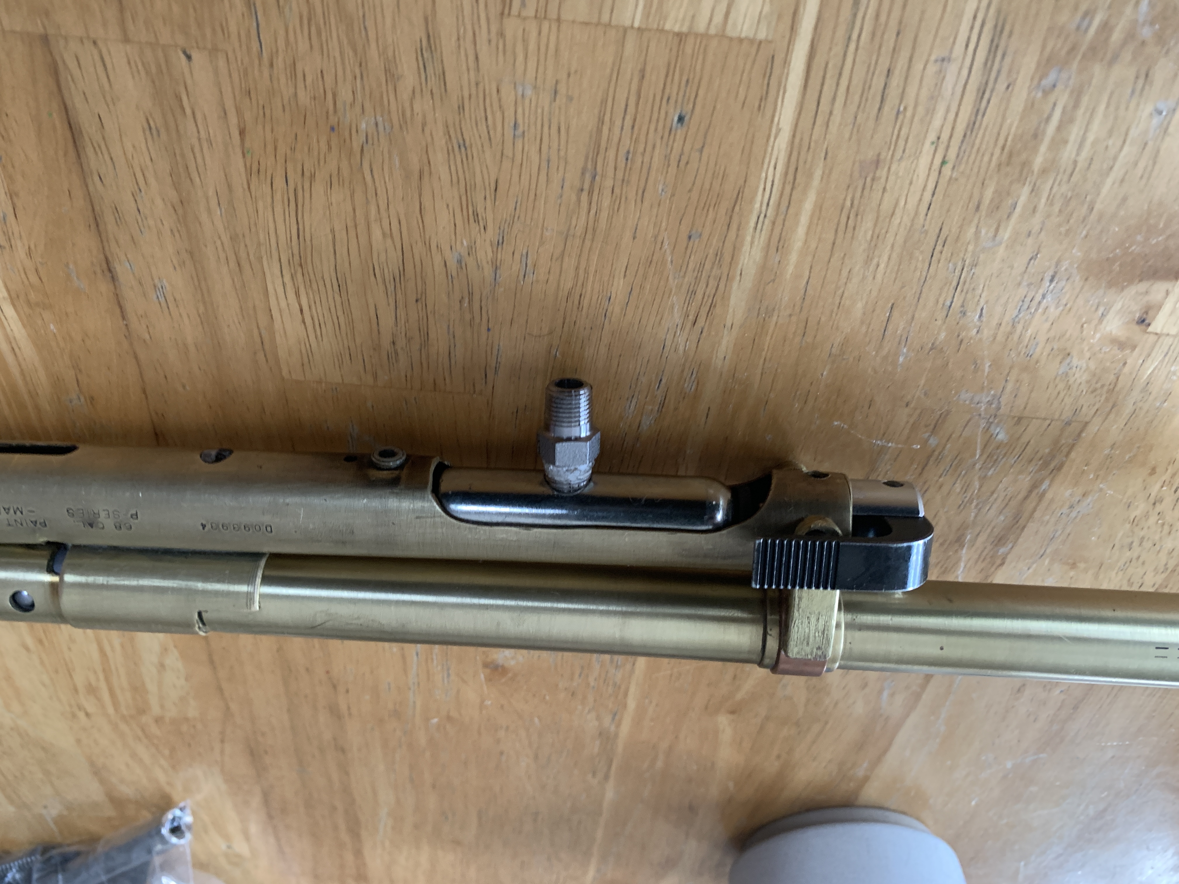

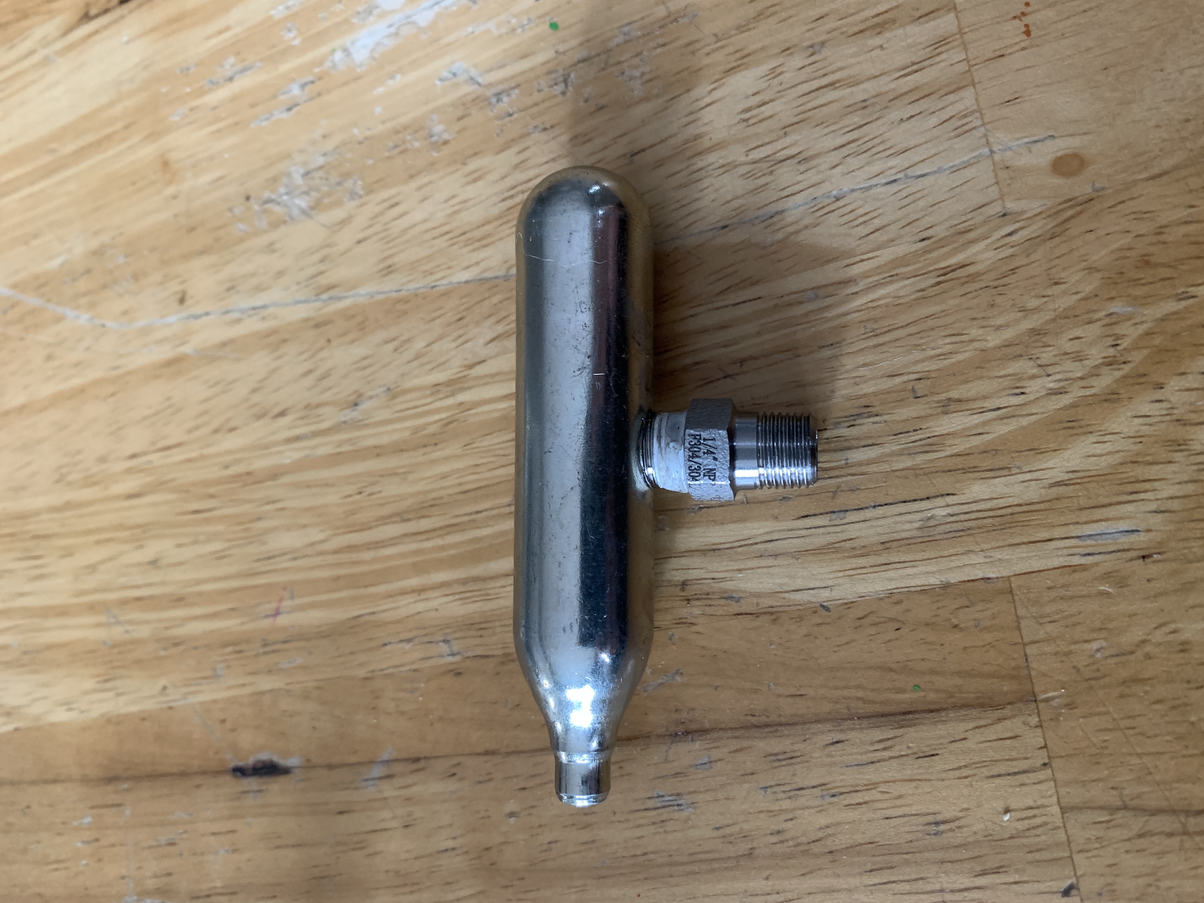

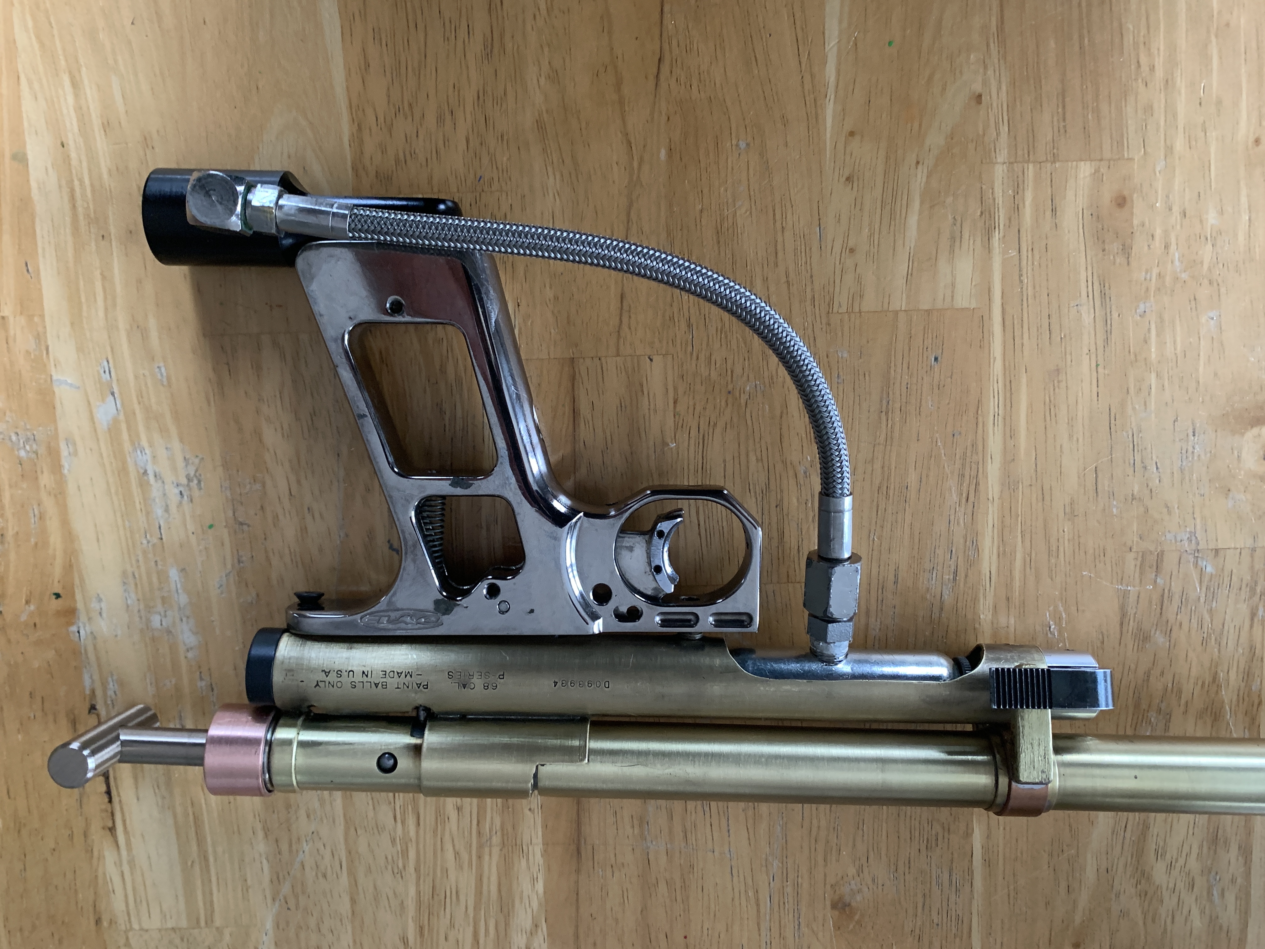

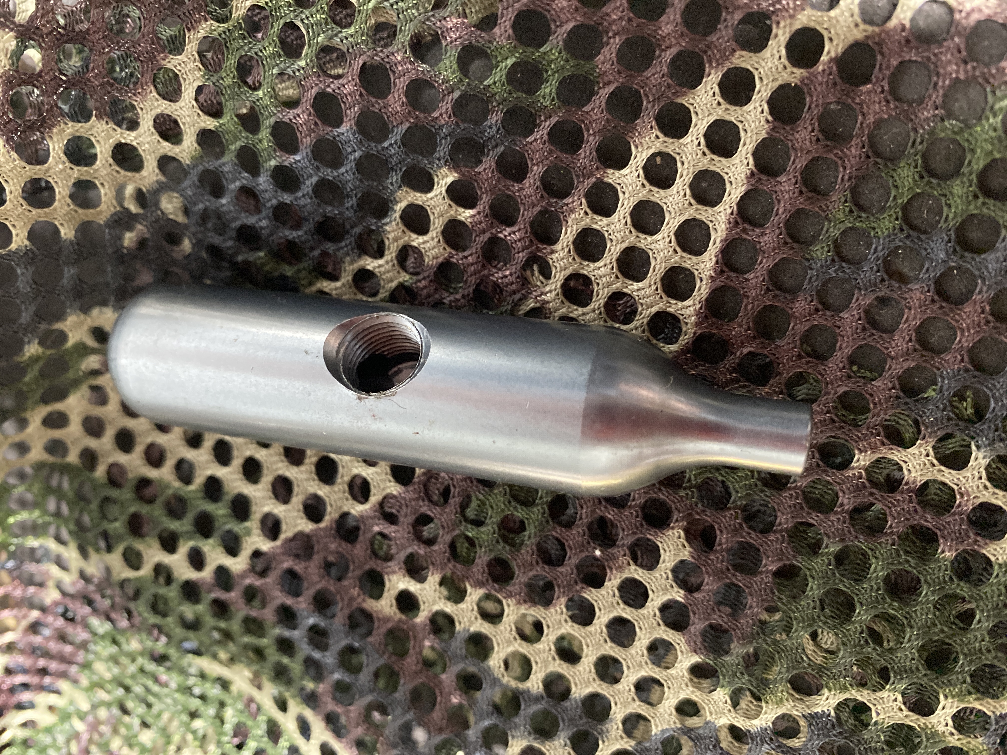

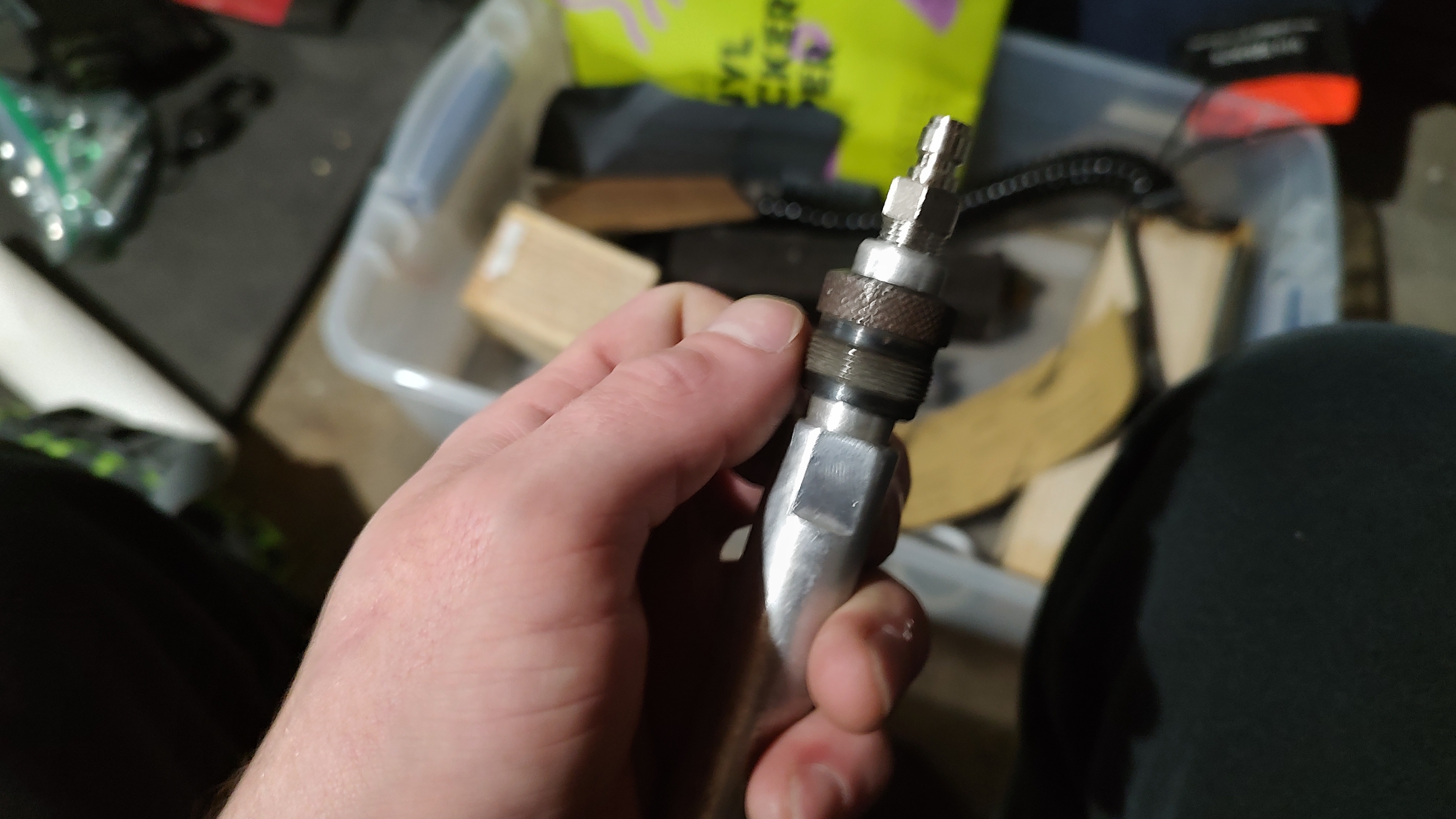

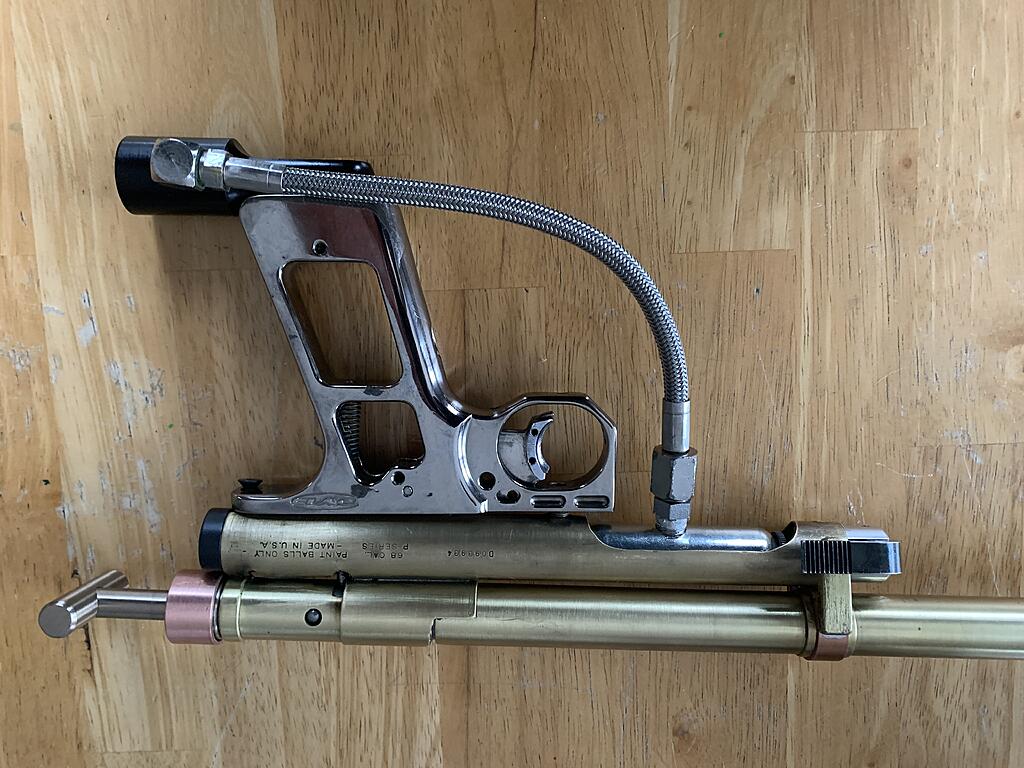

              I wish I has some pictures of my old setup for you. It worked 100%. I had set it up exactly how Magageddon explains it “Option 2”
              it made it so I could run HPA in the winter and 12grams in the warmer weather. Basically, I ran a bottom line of my side tapped dummy CO2 and put a tank on my wire stock when it was real cold. Then just removed the dummy CO2 and ran standard CO2s for the good weather.
              Super similar setup to the marker I’m giving away for Walzmas.
              Edit: ran to the basement and tinkered a few minutes for you….
              Edit edit: I know it’s 2025, but why the hell are all my photos randomly changing their orientation when I post?!??
              1 - drilled and tapped a dead 12gram for NTP fitting
              2 - picture of the drop out cut I had made on the lower tube (you don’t have to go this extreme and cut and actual dropout.)
              3 - installed BottomLine to duckbill ASA. I have a frame adapter in the car but it’s too cold out…I think you get the idea

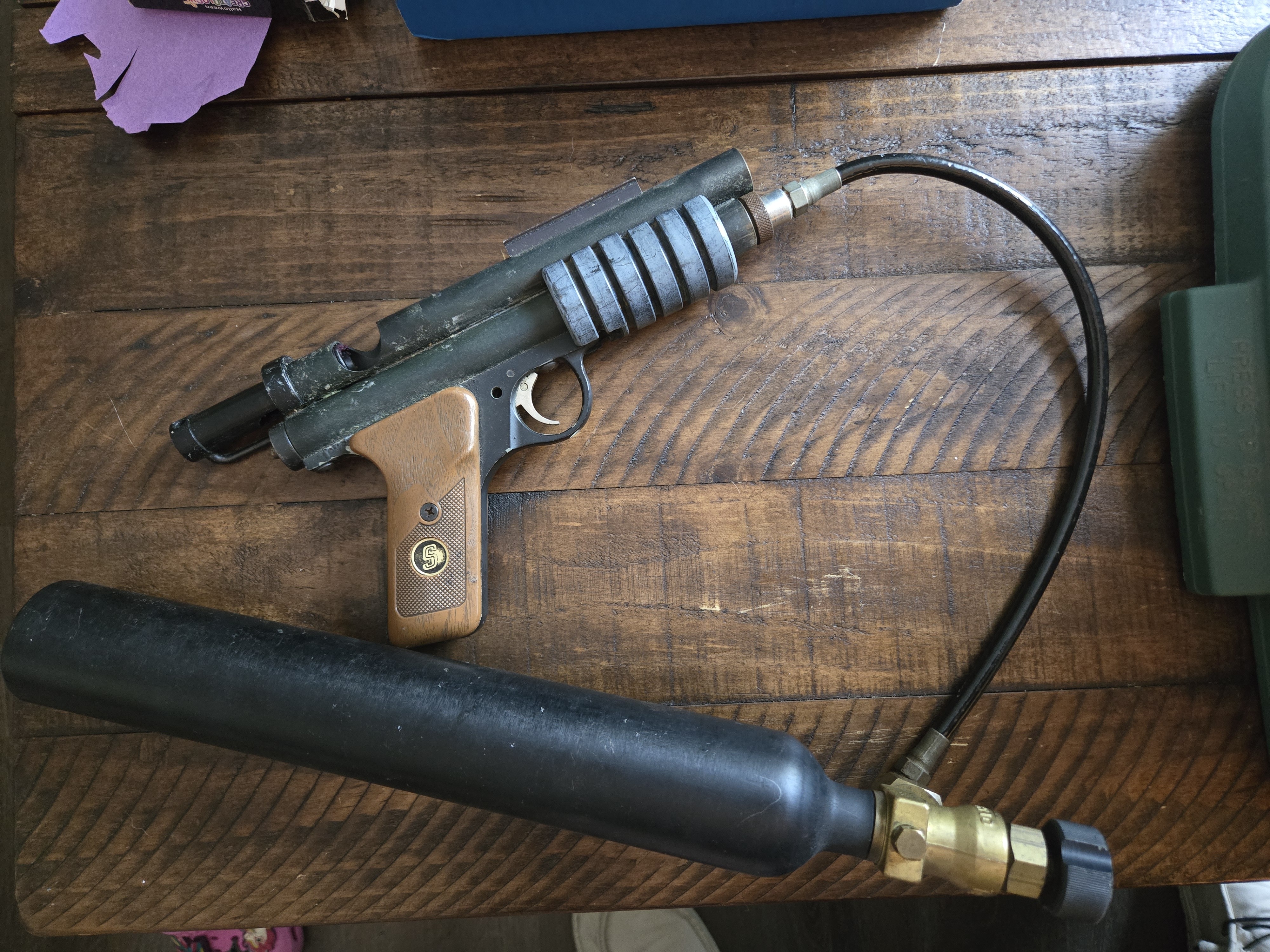

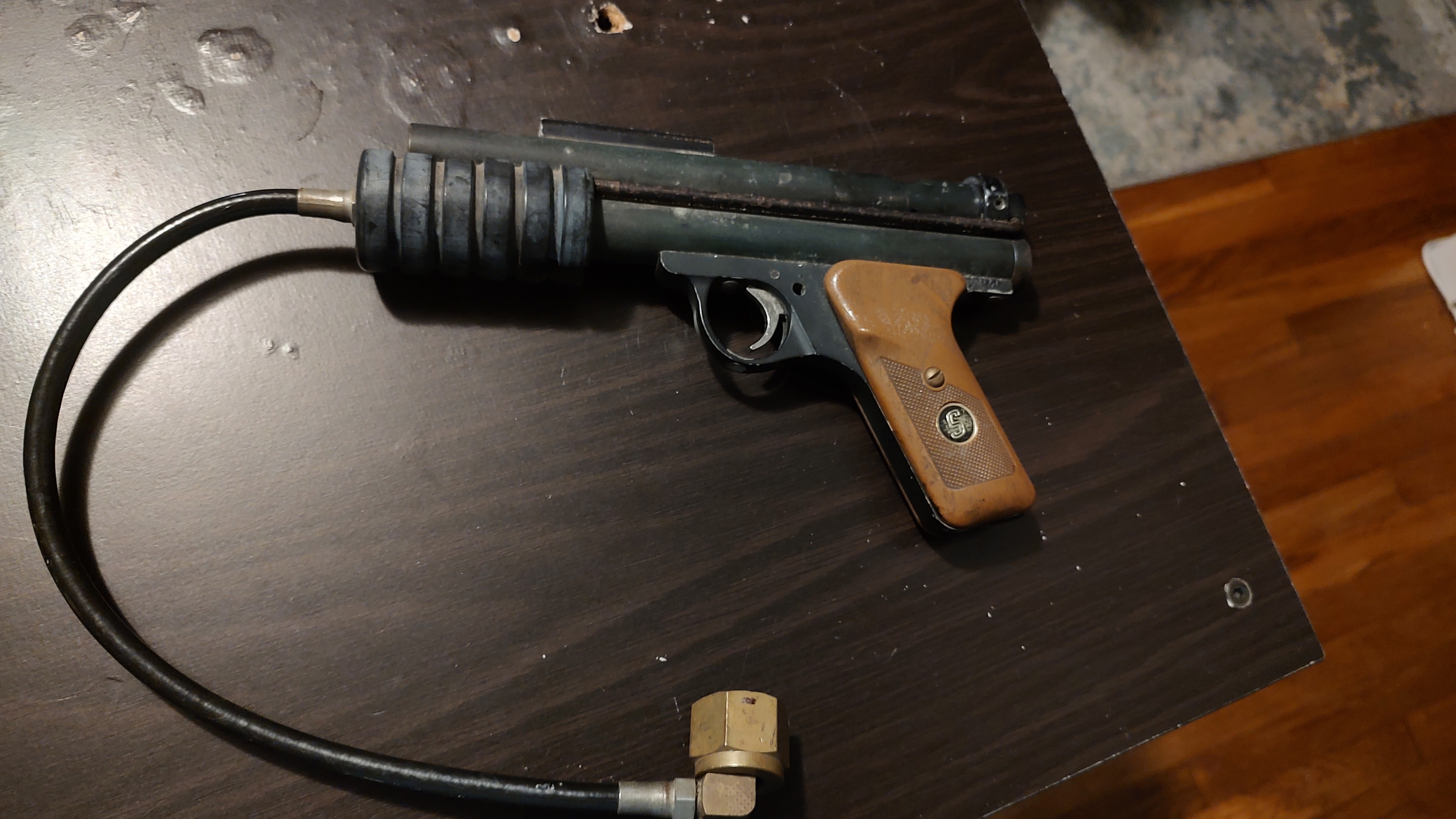

              I got a pgp off Craigslist that came with the c/a adapter pictured below. A similar set up would allow you an hpa tank without having to cut into the body (you may still need to open up the airflow which is a whole different issue others have mentioned).
              If you'd like I can get some closer photos of the adapter itself, but it's relatively simple in it's design

                A lot of air gun places offer these as well. Just a dummy 12g
                • Psycho91
                  Psycho91 commented
                  You would be better off buying one of these instead of drilling and tapping an empty 12 gram as the walls of the 12 gram are thinner and doesmt hold threads very well sometimes, the walls of the dummy 12 gram are thick to accommodate for the threads
                  JeepDVLZ45 commented
                  Psycho91 Oh, definitely. I only drilled/tapped that empty one because I couldn’t find my side tapped dummy 12 gram. I was just trying to get an example in photo for the OP. That 12 gram might have 1-2 threads “holding” the fitting in…definitely not safe

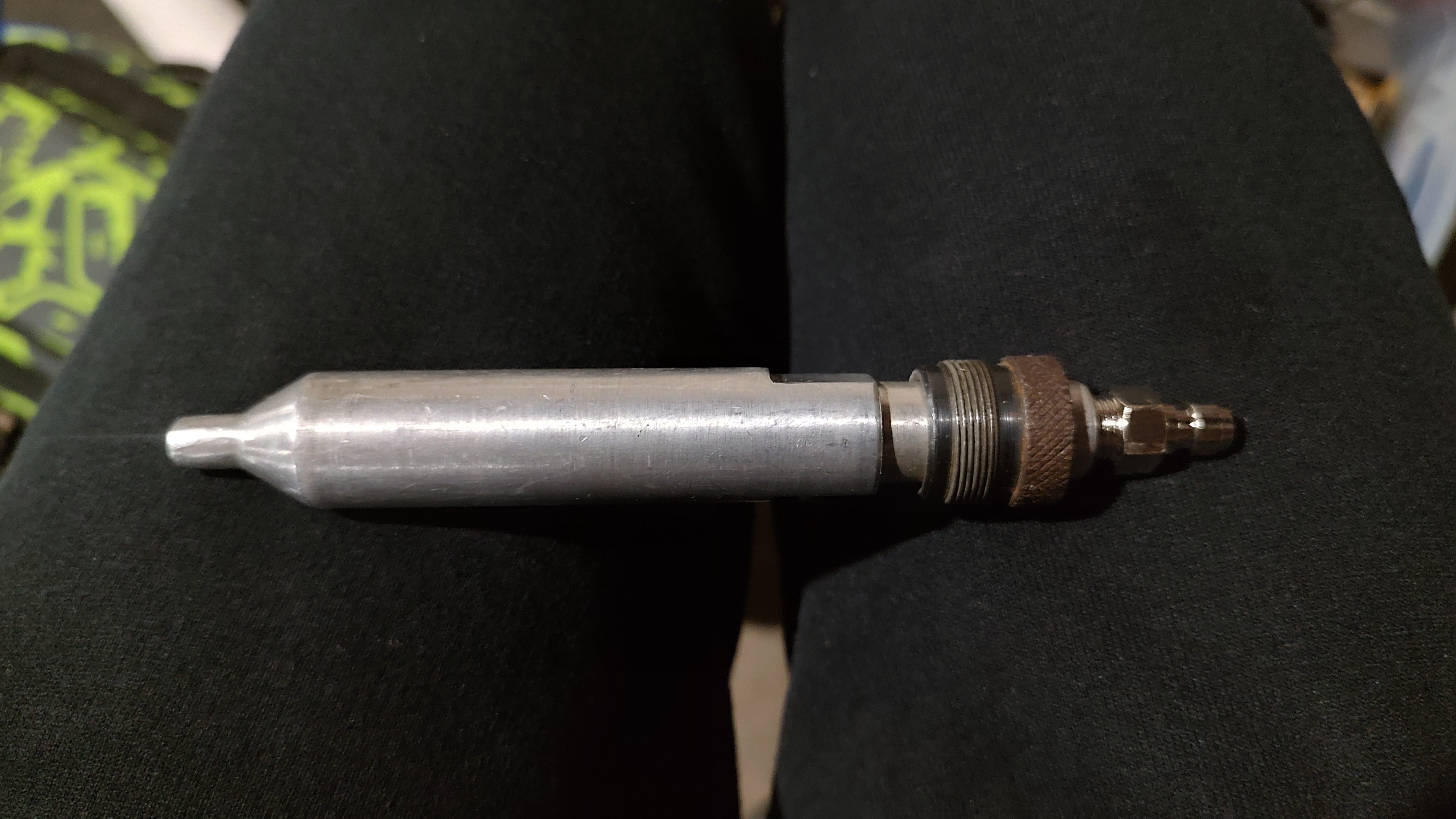

                Here's some closer pics of the setup I've got. Lemme know if you want measurements on any of it

                If you find a adapter without a threaded collar I believe I have a couple of the collars. Ok ,I thought someone would have one but just in case I thought I would offer.
