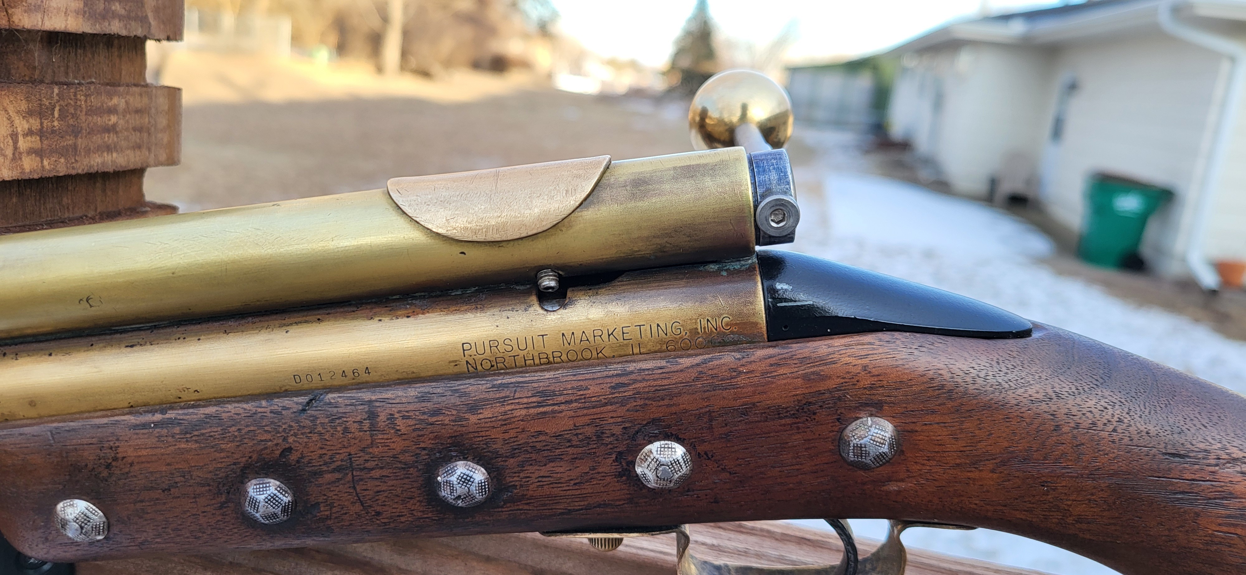

    I saw this awesome side tubed PGP in an appreisal thread from RAZRBAKK a while back, and with the cool pirate grip, I had to have it. It was sold at "just a side tubed pgp with extended feed knob."
    It arrived looking like this:
    I removed the leather grip to clean the wood. I cleaned the wood up with Murphys wood oil soap. I also took some "The Pink Stuff" polishing compount carefully to specific spots to clean up, now not "polish out the character" but I wasnt able to get the leather grip back on after the fact. It did hold air, but you could hear the 12G face seal bleeding air quietly. I figured I wanted to make it right hand cocking anyways as I wanted the realistic action of up, back, forward, down. It makes reloads harder, but makes the cocking action feel more fun, plus if makes you wrist roll the side tube pretty naturally. I went to take The left handed cocking rod out, to find it was JB welded into place. it broke free cleanly luckily. I drilled the cocking rod hole the rest of the way through, but I stayed small until a plan could be decided.
    Yesterday, I got into the guts to fix the face seal. the seal was toast as always, and I installed onf of my personally made red TPU face seals that XEMON desidned. its held air all night.
    Much to my surprise, this "just a pgp" has a pps dyna valve in it!!! I figure I'll be back in here soon, so I simply cleaned, and greased the guts and re assembled. I added a few pics showing this is simply a PGP lower with a KP back cap on it. the back cap has a screw in it to take up spring space, but an RVA should be added. It may not chrono at the end of the day, and there is NO margin for extra space.

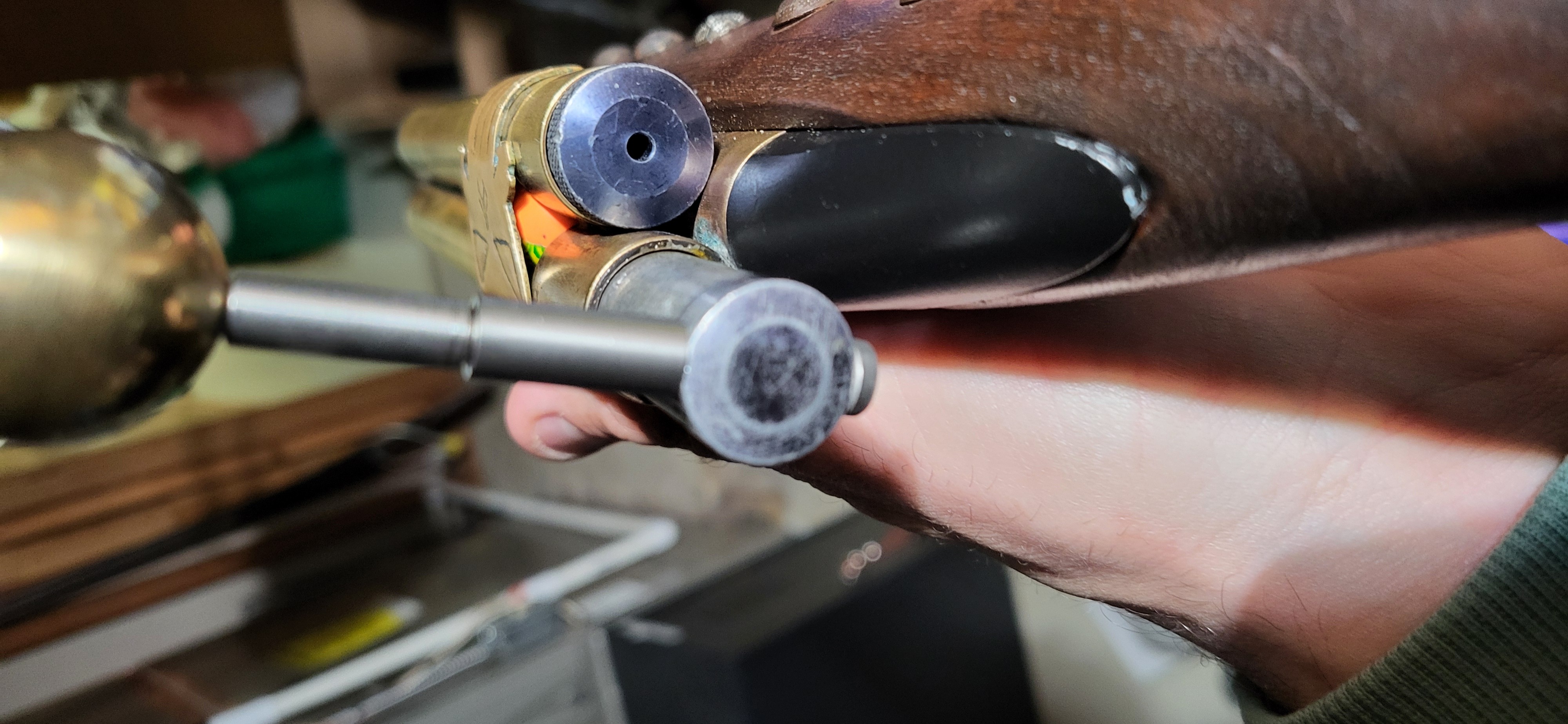

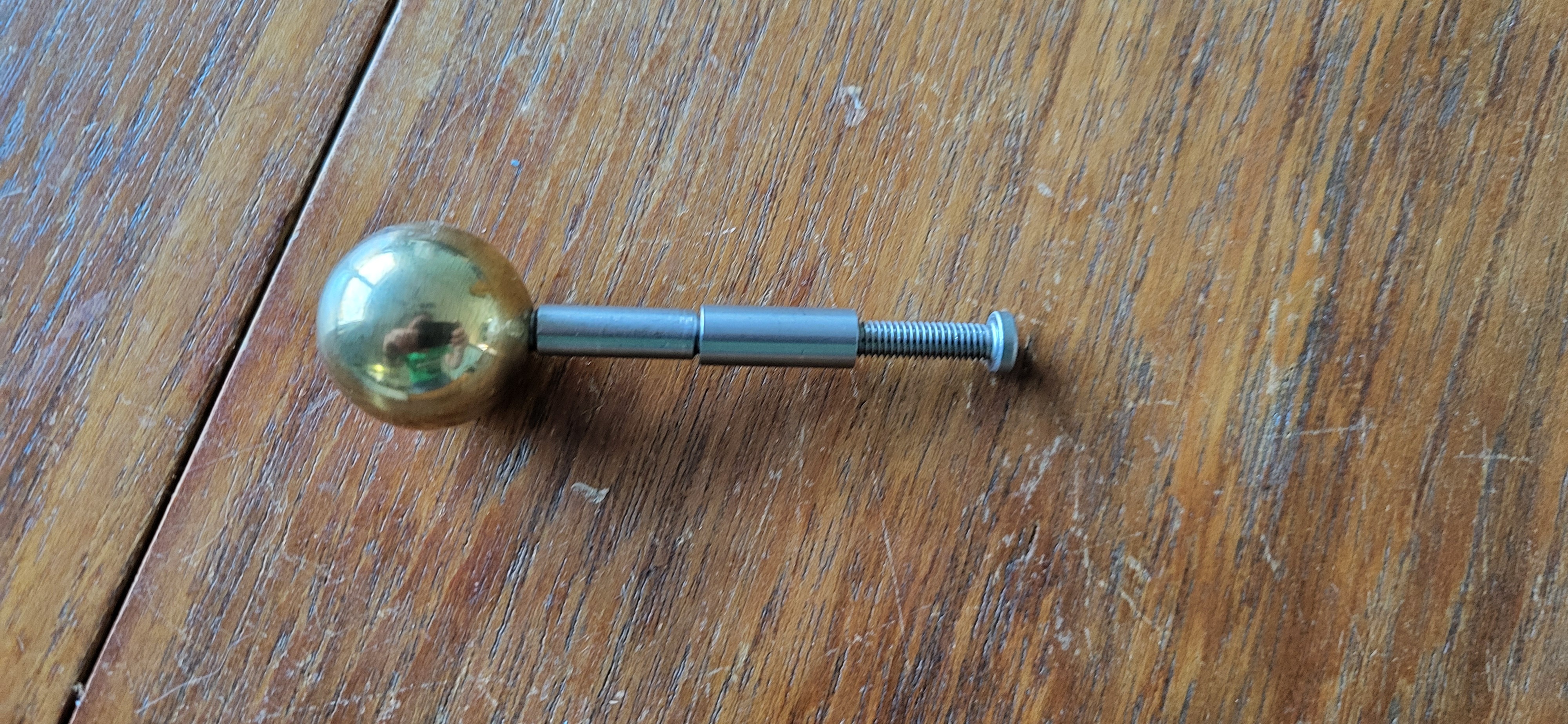

    Now, I have trust issues with those 5 aluminum threads. I could get a 10-32 threaded pull handle and simply thread into the bolt,. I really feel the bolt threads would fail eventually. That being said, I plan on utilizing a through screw, socked tight in the bolt threads. then a female to female coupler to pinch the through screw on the bolt. My theory is that this will make a much more secure bolt handle. Here is my initial temporary handle, followed by another temporary handle with a tough bolt assembly of parts I had laying around..
    That COULD be good enough no?
    Last night I ordered $56 worth of crap from McMaster, which was NOT the cheap route to go with this, hindsight says a Mauser bolt arm would have achieved a nice bolt handle for $15..
    regardless I think its going to look bad ass onse all assembled.
    McMaster-Carr 10-32x1/2 long brass button head bolt for a ball pusher in the bolt face. - 97715A213
    McMaster-Carr​ 10-32 x 1" Stainless Steel low profile socket head cap screw - 93615A390
    McMaster-Carr​ 10-32x 3/4" rounded stainless steel coupling nut - 90202A202
    McMaster-Carr​ 10-32x 3/4" Stainless Steel Ball Lever Shaft - 8384K53
    McMaster-Carr​ 10-32x 1" dia. brass ball handle - 60215K54

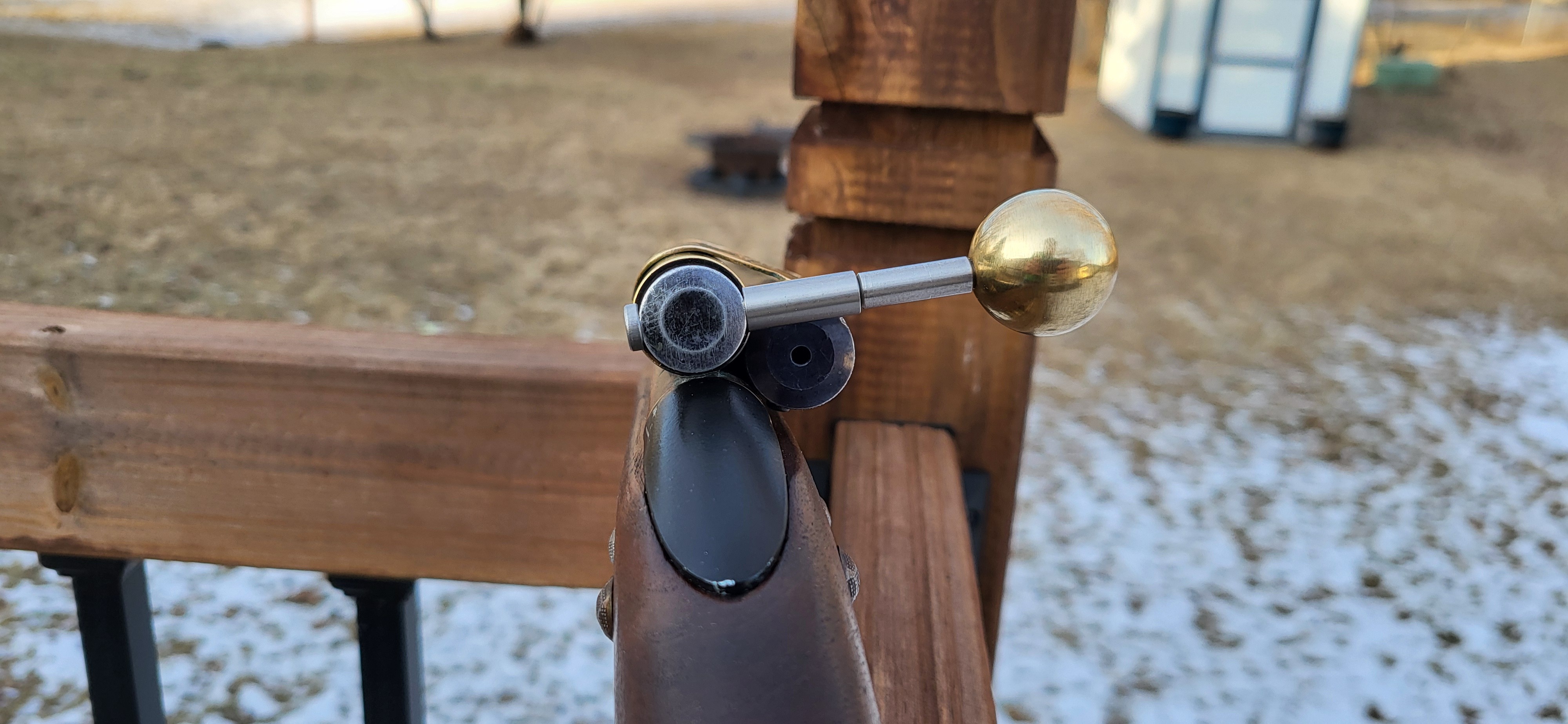

    Got my McMaster order today. Here is what my make shift pump handle looks like. with all that weight, the bolt still jumps when you shoot it.

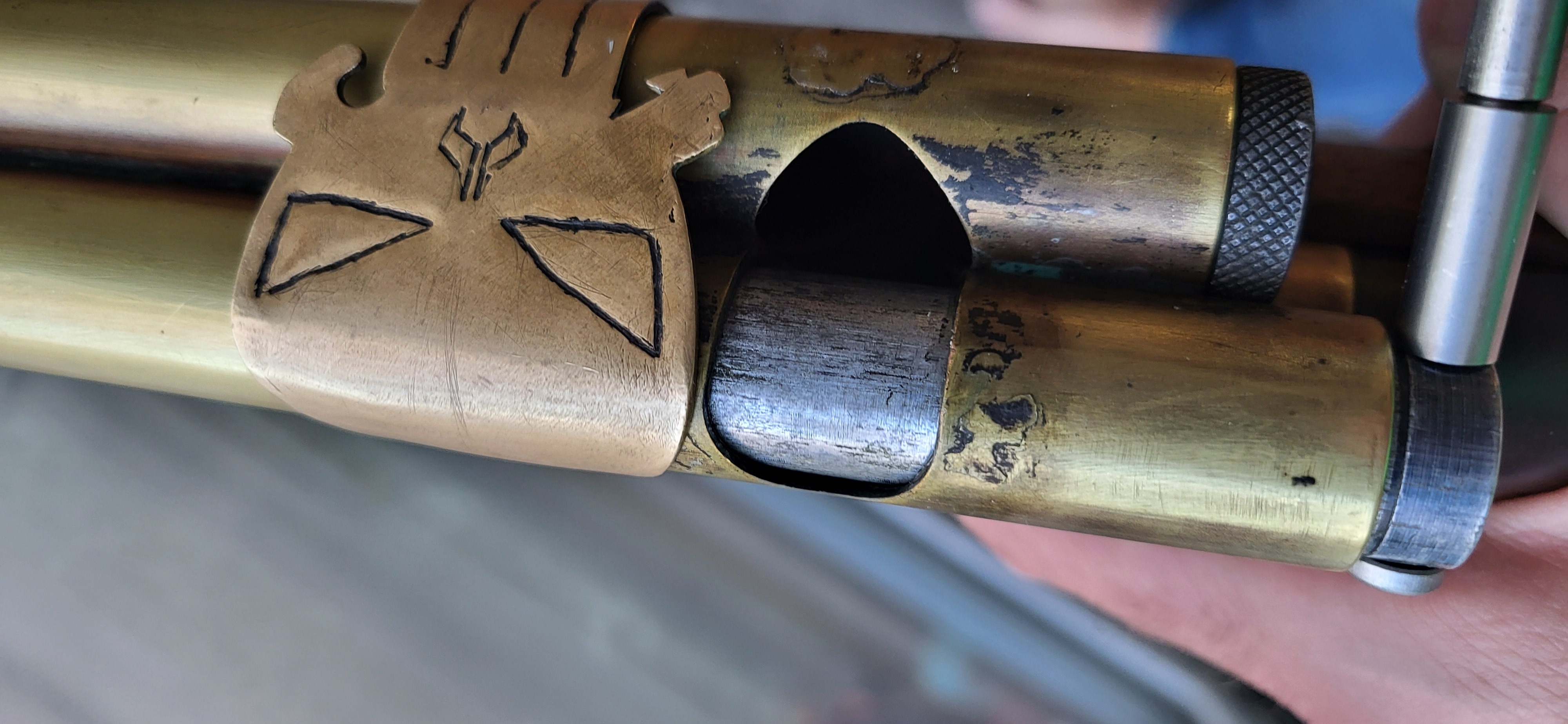

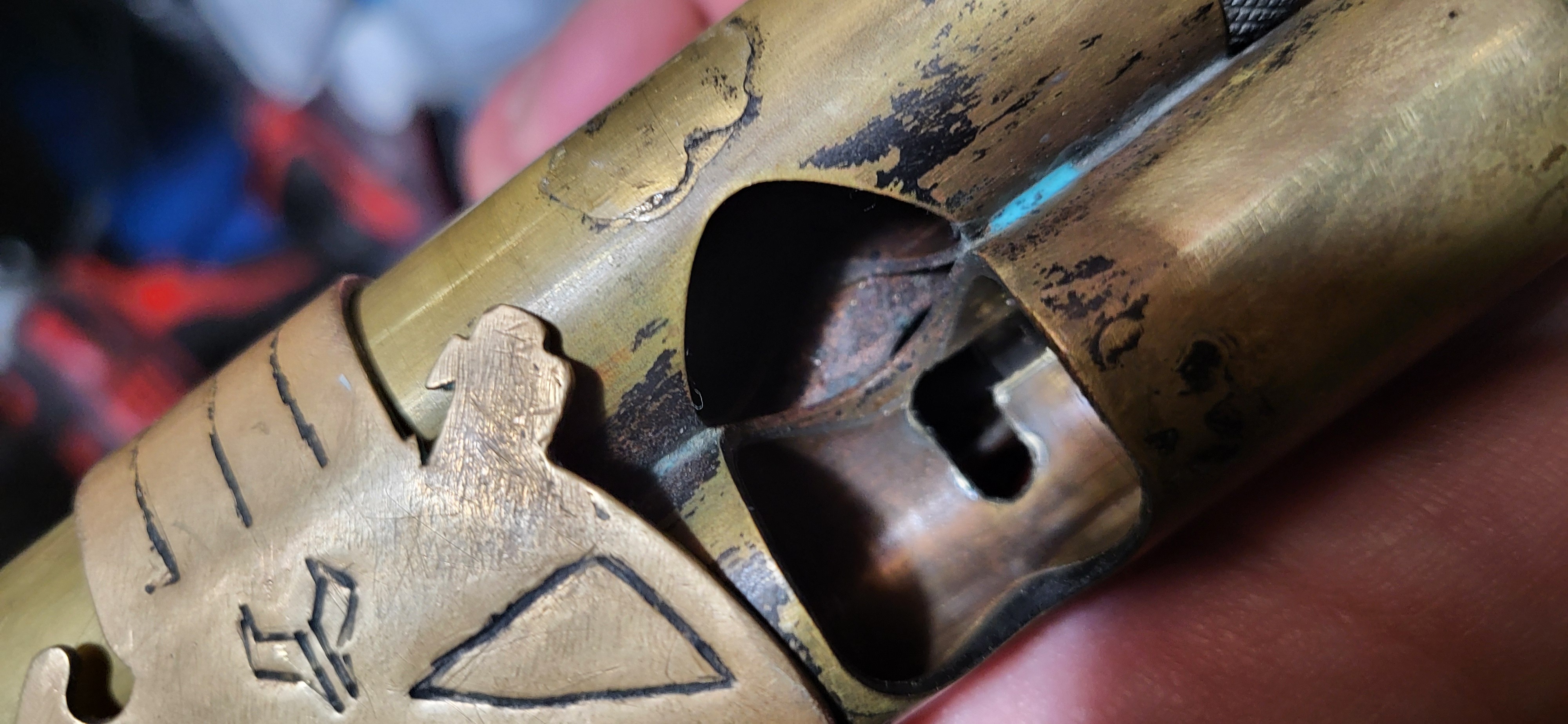

    I also figured out the punisher skull plate is not soldered down! I accidentally slid it forward messing around. Now I can slide forward allowing me to clean up the tubes beneath it.. it also gives me the opportunity to simply slide it forward and load single shot into it if I want... with the two open holes side by side, I am pretty certian a first strike round can be loaded..

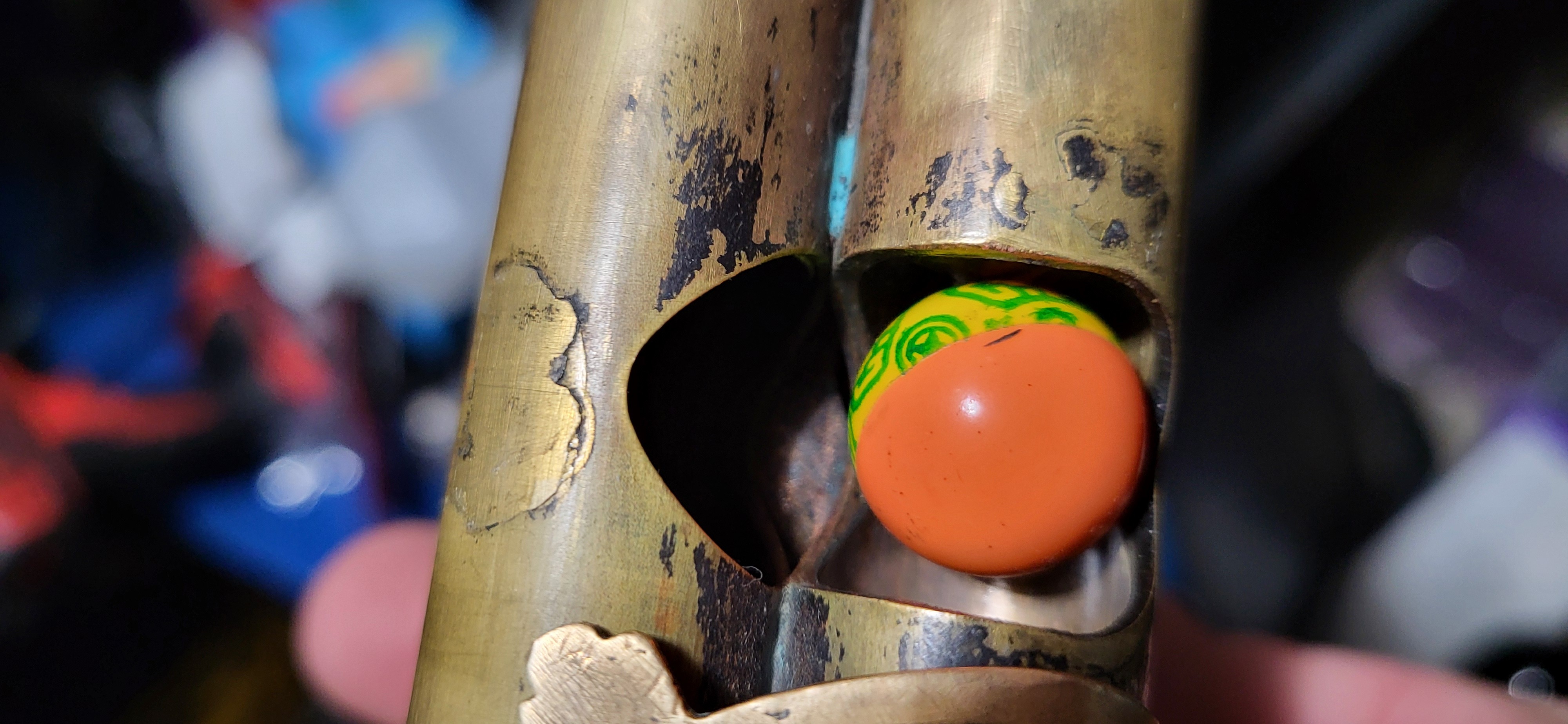

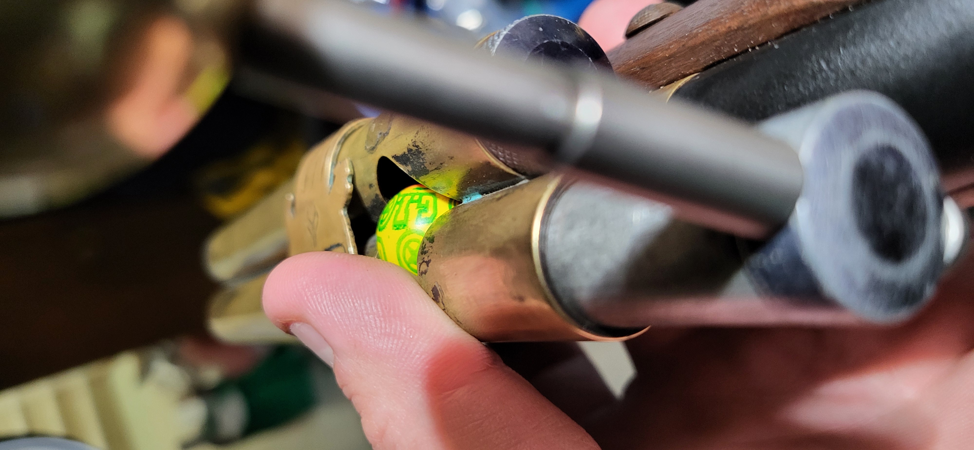

    I have had air on this beast a few days... yesterday I found 11 balls in a hopper from my last game, so I loaded this up. Rack my first shot.... no ball.. rack a second.. no ball. I pay attention to the feed, and I see the balls hitting the punisher plate and stopping before entering the barrel.
    I slid the plate, and was able to work paint into the barrel rocking and cocking but it was tough with nothing capturing the paint.
    Initially I assume I'll just file the " hump" down from the transition.. Until I looked in the breach
    The hump is the little bit of barrel meat I've left that stops the cocking lug on the bolt action... so that's out.
    I may have to pull the plate and figure some other hood out. Maybe ill take a look tomor
