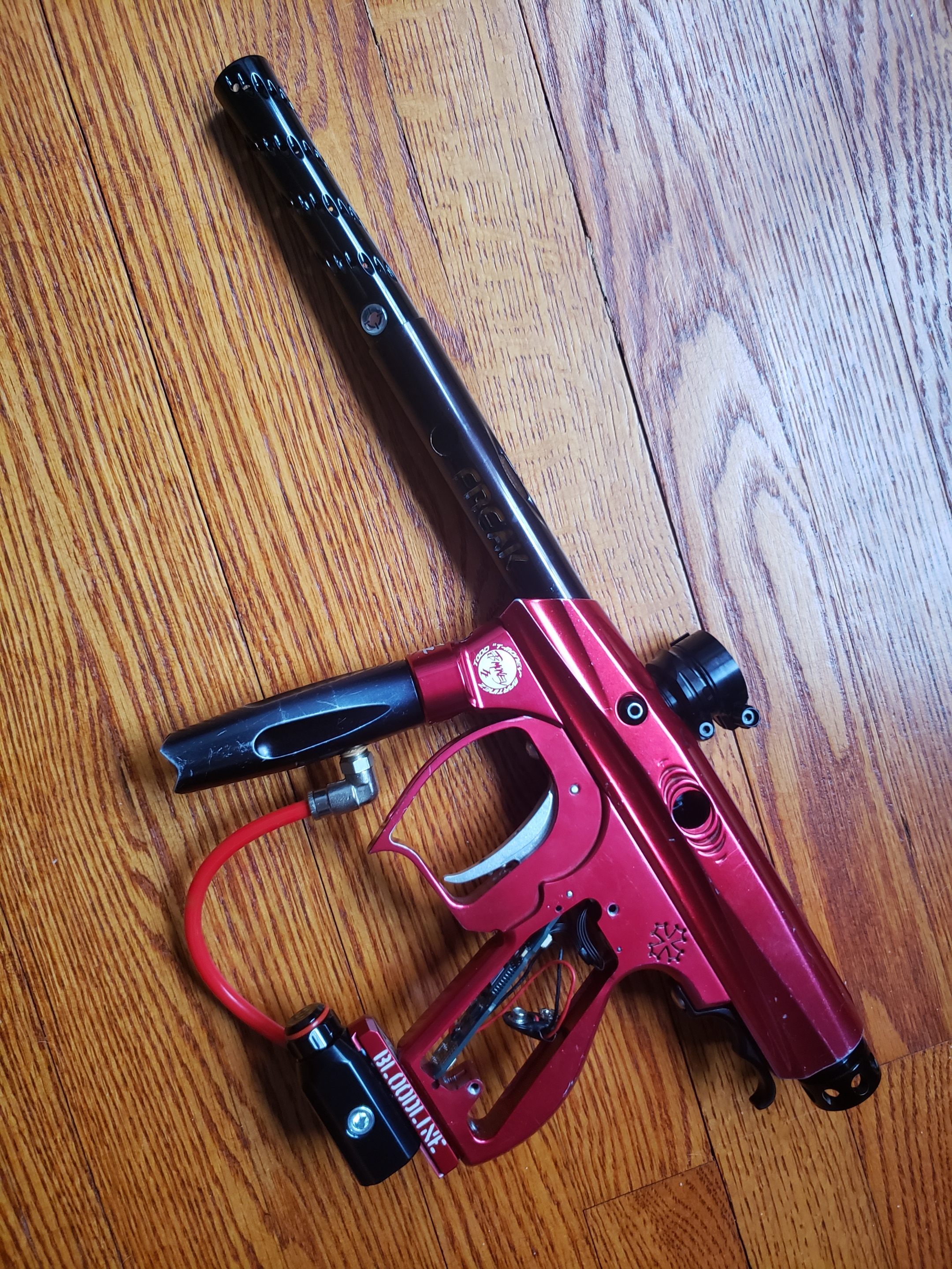

      Here is a pic of the gun. It has a regulator that will restrict the air going to the solenoid to 200 psi (or whatever I set it to).

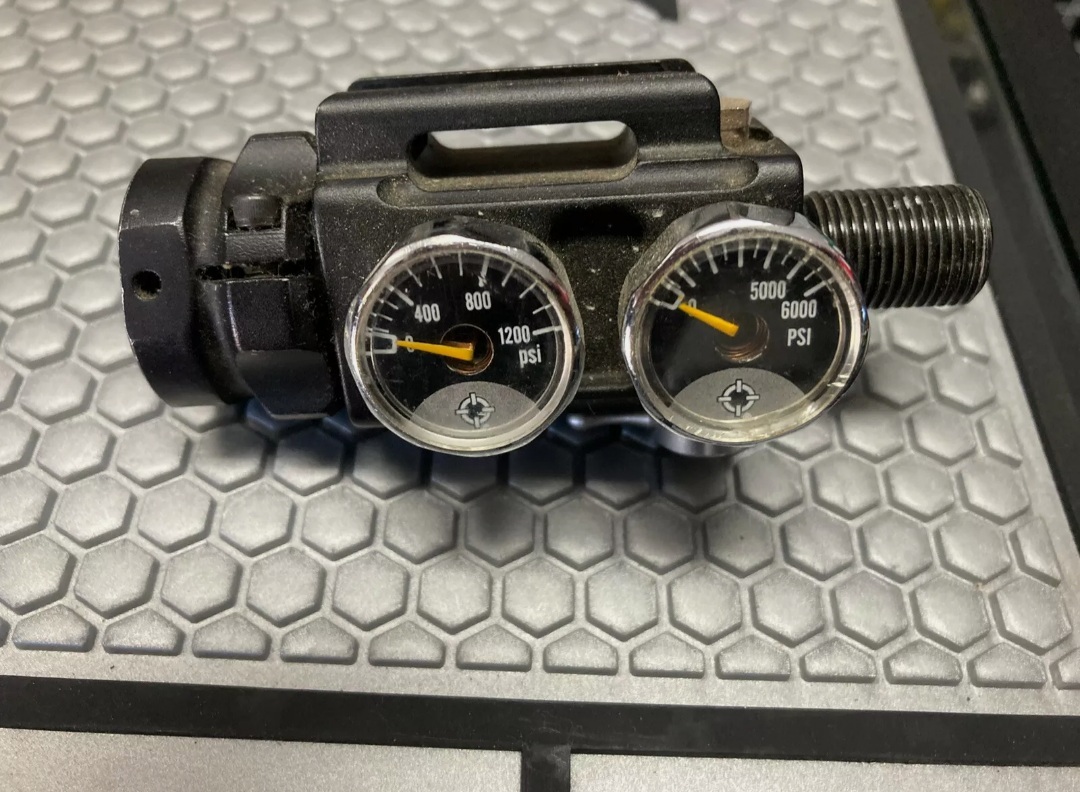

      The black Max-flo above regulates the tank output pressure.
      I know what I need to run the vertical reg at, to not blow the solenoid, but I dont know what to set my tank pressure to, since its adjustable.
