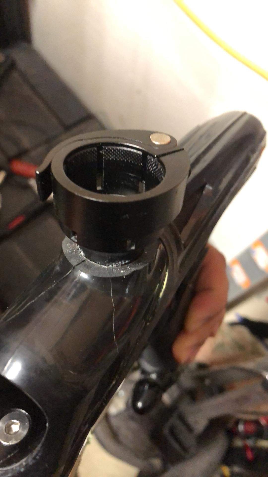

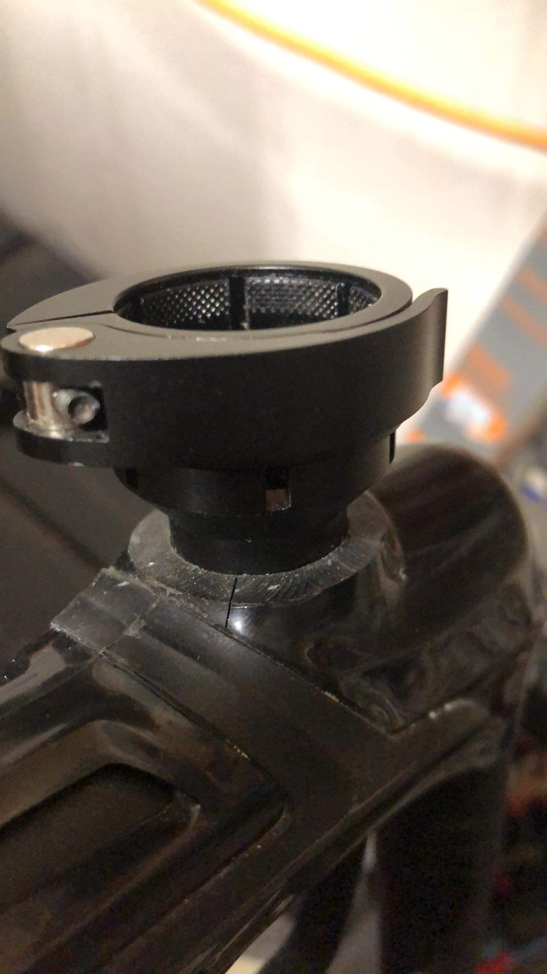

    Once upon a time the factory nub that a feedneck clamps onto broke off completely. The fact that it was in the chrono line at Decay of Nations was even more unfortunate. But, I brought several things to shoot that weekend, so no big deal.
    when I got home I milled off the remaining nub and threaded the plastic body for an Impluse threaded neck. It lasted quite a while. Then I stopped playing for a while. Last weekend I played for the first time in 3 or so years and with a full revvy the neck gave way and tilted, but fortunately didn’t fall out. Pocket hopper for the rest of the day to avoid as much weight as possible.
    Equally long ago, I got another Enemy (going to type it like that from now on so autocorrect can take a chill pill) and got a cool Shocktech body kit meant for an ion. The ion firing chamber is threaded, the Enemy is not. So I threaded it. I have an idea on a way to do this and keep the factory body, but I’m wondering if there ever was a metal body made for the Enemy. Bonus points if it was threaded for the typical SP neck threads.
    Heres the 3 cracks in the factory plastic body:

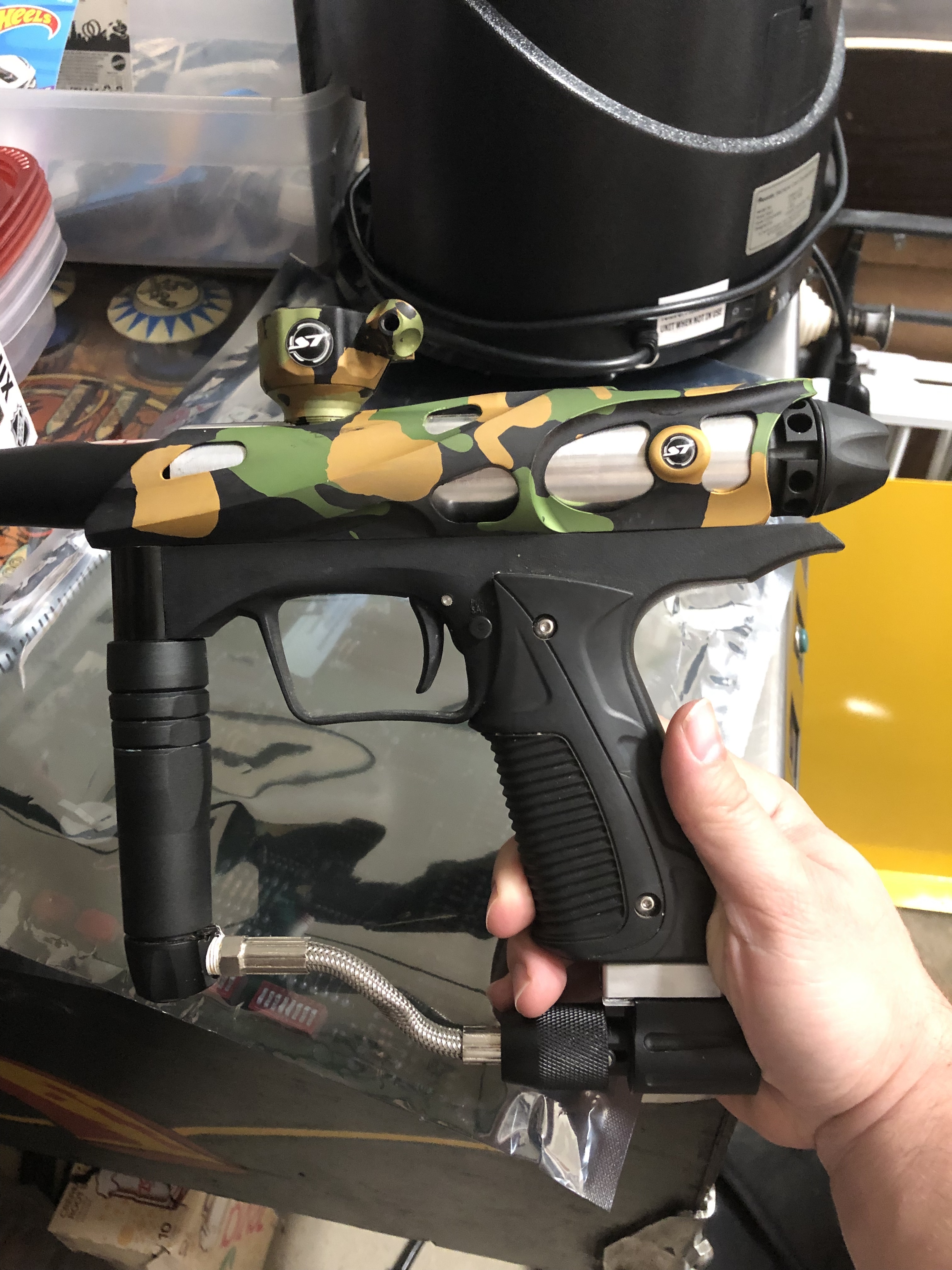

    I don't think so, but I had Super Stanchy Customs create a Franken-gun for me out of a Shocktech camo Ion body/firing can and eNMey trigger frame, vert ASA, internal guts. It worked pretty well. It popped up for sale here not that long ago which was a surprise, kind of forgot about it.

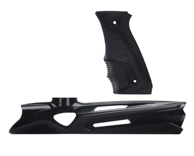

      Looks like the Extacy (not the way they spell it, JFC gog, have to make everything difficult?) has a plastic body kit with a threaded neck. But it also has triangular eye covers that the Enemy isn’t likely threaded for. I have no idea and don’t care enough to take one of mine apart to find out. Plastic body, not a long term solution IMO.
      https://www.ansgear.com/GoG_eXTCy_Co...itjetblack.htm
