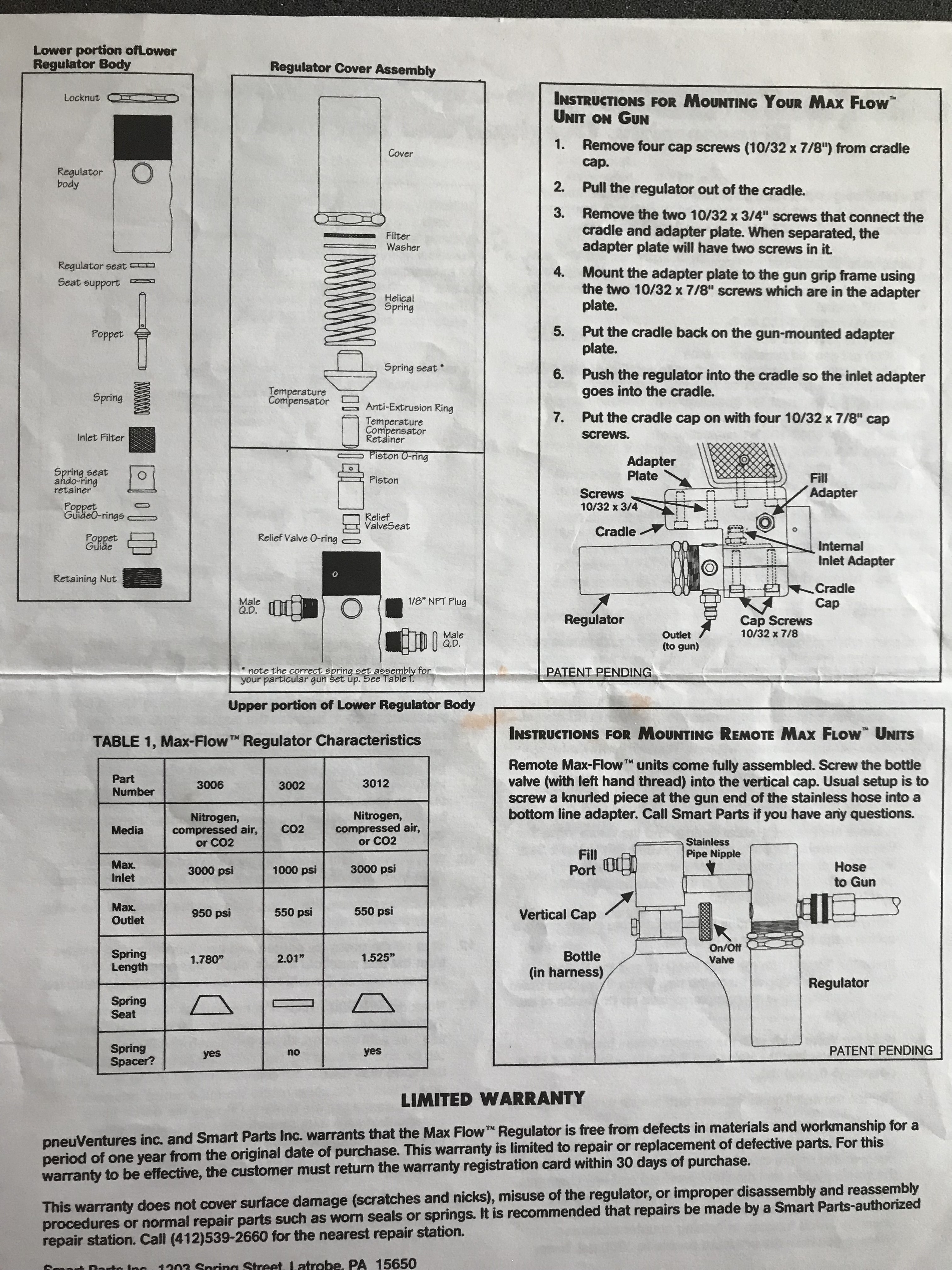

                  Is anyone familiar with what the oring size for the piston is on this model. It looks to either be an 011 or 012 but I can't tell. Also any idea of the one on the plastic sealing piece that goes in the piston?
                    This is what I can dig up. The original owner's manual I have does not state an oring size. It only states that the overhaul kit comes with them. I can get more pics of the remainder of the instructions if you need them.
                    Click image for larger version  Name:	IMG_4632.jpg Views:	0 Size:	2.50 MB ID:	294530
                      I'm fine with this thanks. I appreciate the offer. None of the manuals online are for this gen of MaxFlo. None of the Shocker manuals even had diagrams of it.
