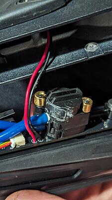

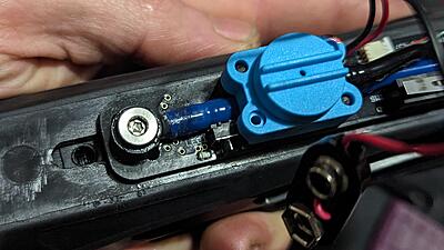

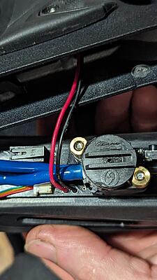

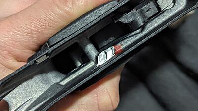

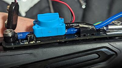

                    Update time: The solenoid worked great at first, used the marker one Sunday a month ago and it ran perfectly all day. Then two weeks ago I'm at the field going to chrono, and it starts leaking again. I have just completed my conversion to the Rize/Proto solenoid and it seems functional, will test it outside as soon as time permits.
                    Anyways, here's what I did:

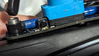

                    -Desoldered solenoid from it's little board and cleaned up the tabs, trimmed a little from the base of the solenoid and the edge of the cap next to the power switch for clearance. Installed with a 6x1.5mm o-ring around the tabs (for whatever reason the solenoid is not sealed underneath and relies on an o-ring sealing against the board) to provide a better seal on the Blackheart board because it isn't as smooth as the little board the solenoid came on.
                    -Rearranged the hoses, reusing the long blue hose to run to the air source (I used the new hose barb banjo because I had a small leak), had to trim about 3/32" off because solenoid is a little larger. Used the small black hose that came on the solenoid for the exhaust valve just as it was, connected to my QEV without trimming. Where I got creative was in cutting the banjo off the back of the original solenoid, and slipping a short section of the blue hose over the section of pipe with a lot of super glue, using the special primer for polyethylene. If this fails later on, I found a 10/32" threaded 1/8" hose barb to use in place of the banjo, which looks like it would work.

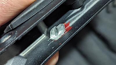

                    -Trimmed inside the frame to provide clearance for the solenoid. I could have trimmed the corner of the solenoid cap, but since strength was an issue, I decided a little bit of metal removed from the thick spot in the frame that obstructed the solenoid, was a better option. Unfortunately I was a bit hasty and initially cut a larger area than necessary because I did not take enough time for test fitting, but I'm sure it will be fine. You can see the shallower cut area was where I initially cut too far, after another test fit I realized I didn't need to remove so much. I used a Dremel with a high speed cutter burr.
                    This gallery has 5 photos.

                      Update to the update: Took the marker outside today and put half a hopper through it. Ran flawlessly. This weekend I should be able to give it a day of play. If it holds up long term, then it looks like I've found the solution to the cracked solenoid caps on these things.

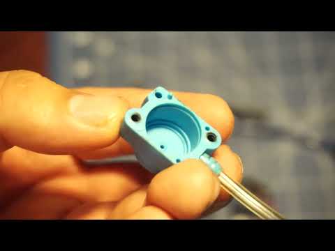

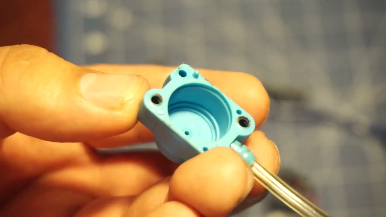

                      For posterity, there’s no need to remove the entire solenoid. Just trim off one ear and one of the nubs from a Rize solenoid cap and use the Rize screws to attach it. Easy peasy. Less chance of ruining the board or solenoid by (de)soldering, and there are no modifications to the frame. I purchased someone’s fried solenoid for $15 shipped, so the price and guilty feeling of potentially ruining a working part didn’t bother me in the least
                      Link to video is below. Not mine, but I followed his directions and am happy with the result so far.
