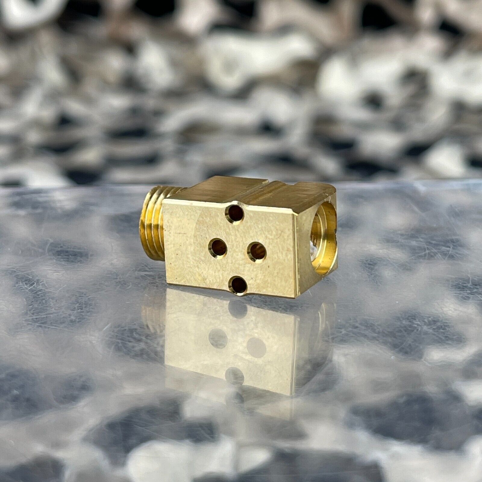

            On another note, though - has anyone tried using a GMEK 3-way instead of a smav? I've got a mech Ion on the brain and have never used a smav so I don't know if it could easily be replaced by something slightly more modern, with a lighter pull, or shorter pull. I assume the two ports on top of the gmek 3-way could be tapped for barbs or ptc fittings.

            The SMAV-3 is easy to use as it has barb fittings for hoses. I don't think the Gmek valve has threaded holes to put barbs in, so you'd have to make a custom manifold.
            Intimidator solenoids have threaded ports and a very short throw manual button on them, so I'm planning on using one I have lying around for an experimental build when I have the time to machine some parts.

              lhamilton1807 commented
              Right, that’s why I suggested they’d need to be tapped. I like your idea of Timmy noid. Looking forward to the results.
            • tyronejk
              tyronejk commented
              Ah yeah, sorry missed that. Also, I didn't realize the two holes near the edge of the block were just mounting holes and the two ports you mentioned were the middle holes, so plenty of space for tapping threads. That does seem like a pretty good option.

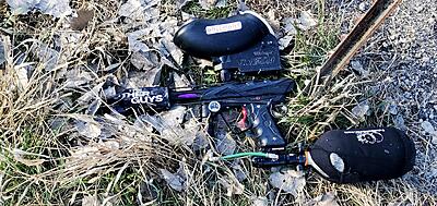

            I have converted my mech rifle into a pneumatic assisted "pump" it definitely makes it just a tad bit quieter when firing. I'll replace the 3 ways with 2 ways soon to free up the 3 ways for other projects.
