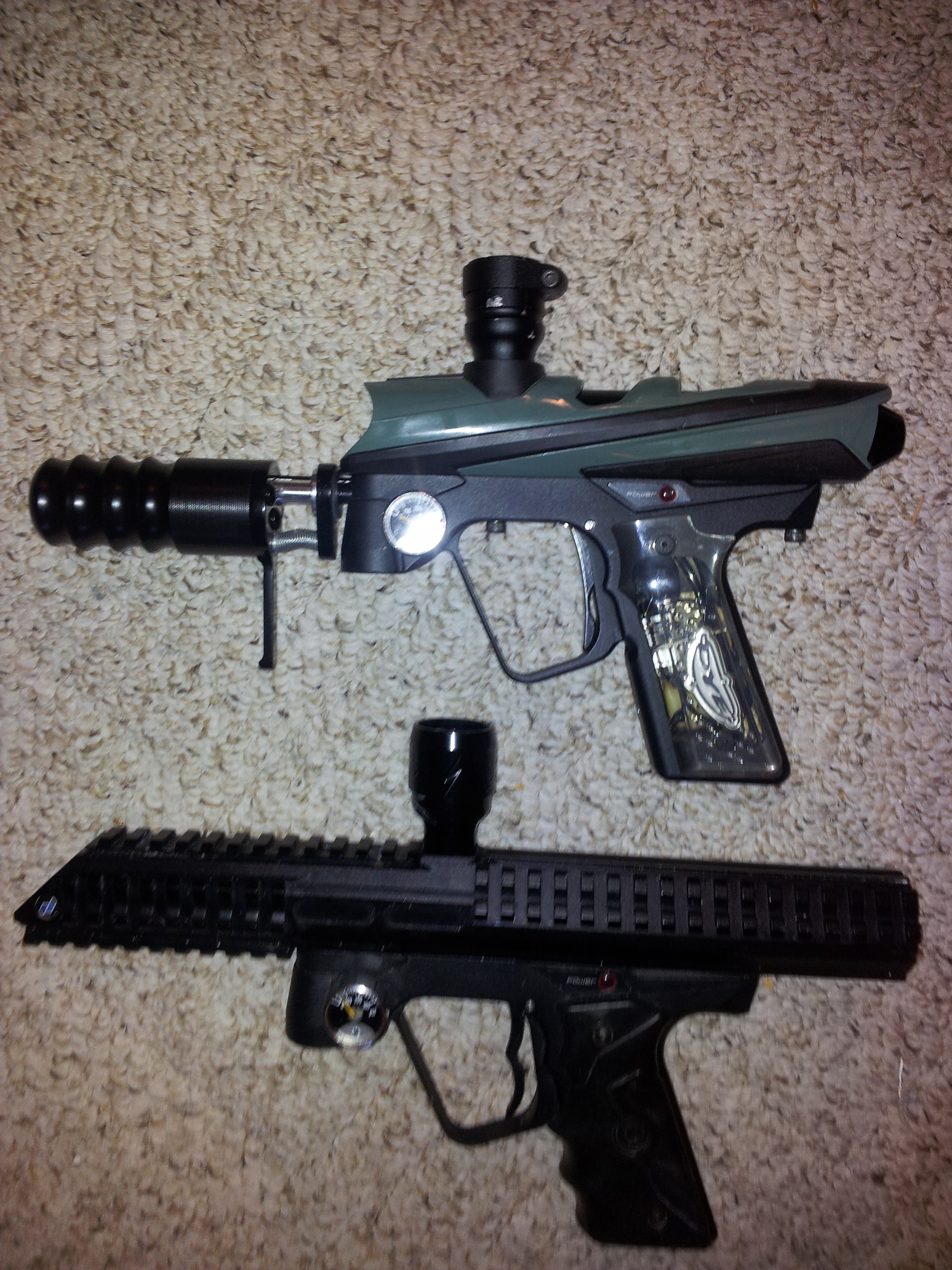

        I don't suppose there would be any way you could adapt your SMAV mount to work on an SP-1, is there?
        • ChoSanJuan
          ChoSanJuan commented
          Maaaaaan, we talked about this on Reddit. Lol! I'm prepping for WCPL along with life stuff. I planned on starting in on it after I got back. 😉
        • lhamilton1807
          lhamilton1807 commented
          I have a SP-1 with a leaky valve cap that’s ripe for a mech conversion. Would be interested in seeing a smav mount for it.

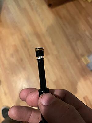

        Machined my bolt for the dual o ring, just have to get on making the smav mount. Incredibly helpful info here. 🫡

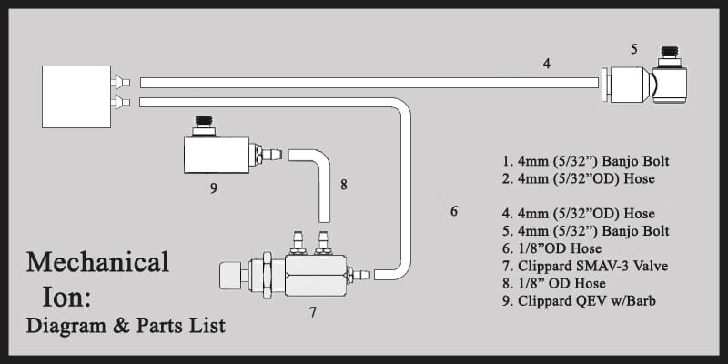

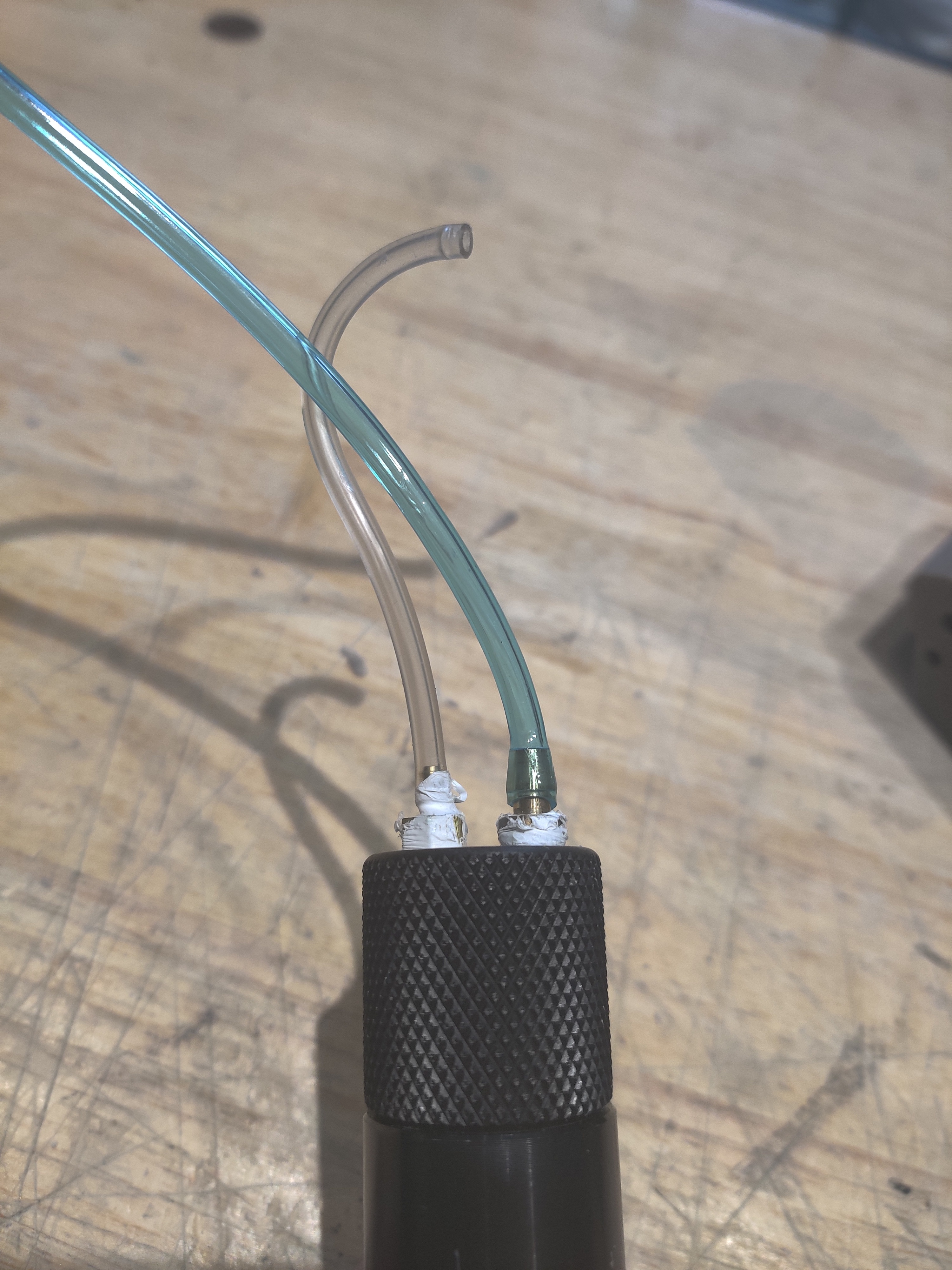

            Kind of a necro bump, but I've built a lot of specialized mech ion builds, so I thought I'd share one of the schematics I've used over the years. The basic difference is the elimination of the t fitting. This was for a custom magfed ion that just didn't have space to fit a t fitting, so I put the reg in the grip, used a thread protector and tapped it for two 10-32 fittings, and ran the air like this.
              Alexndl commented
              Nice, we need more pictures of the complete build!
            • Calvin
              Calvin commented
              Agreed. I have two mech Ions I am working on right now. I would love to see pics of the whole setup. Are you using a small form factor lpr for the reg? Must know more!

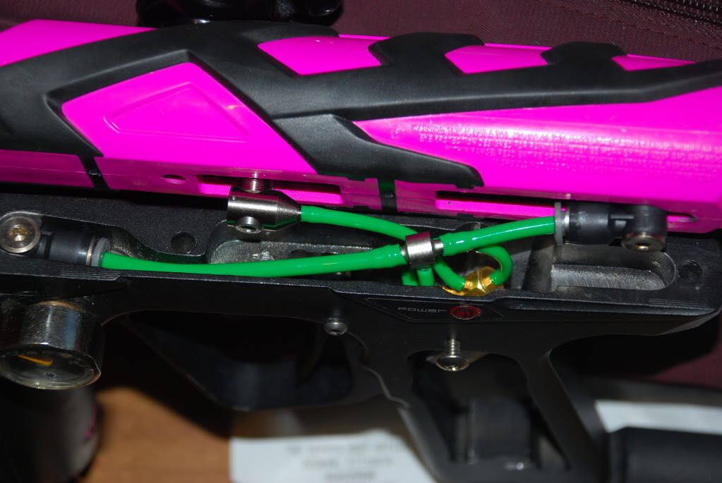

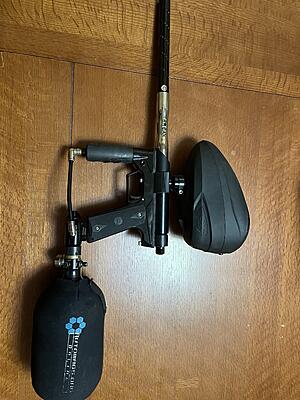

            ill leave this here
            some guy was doing pump kits on facebook long time ago don't no if they still do it or not but its mech too they were about $250 Canadian
            really shot pump stroke
