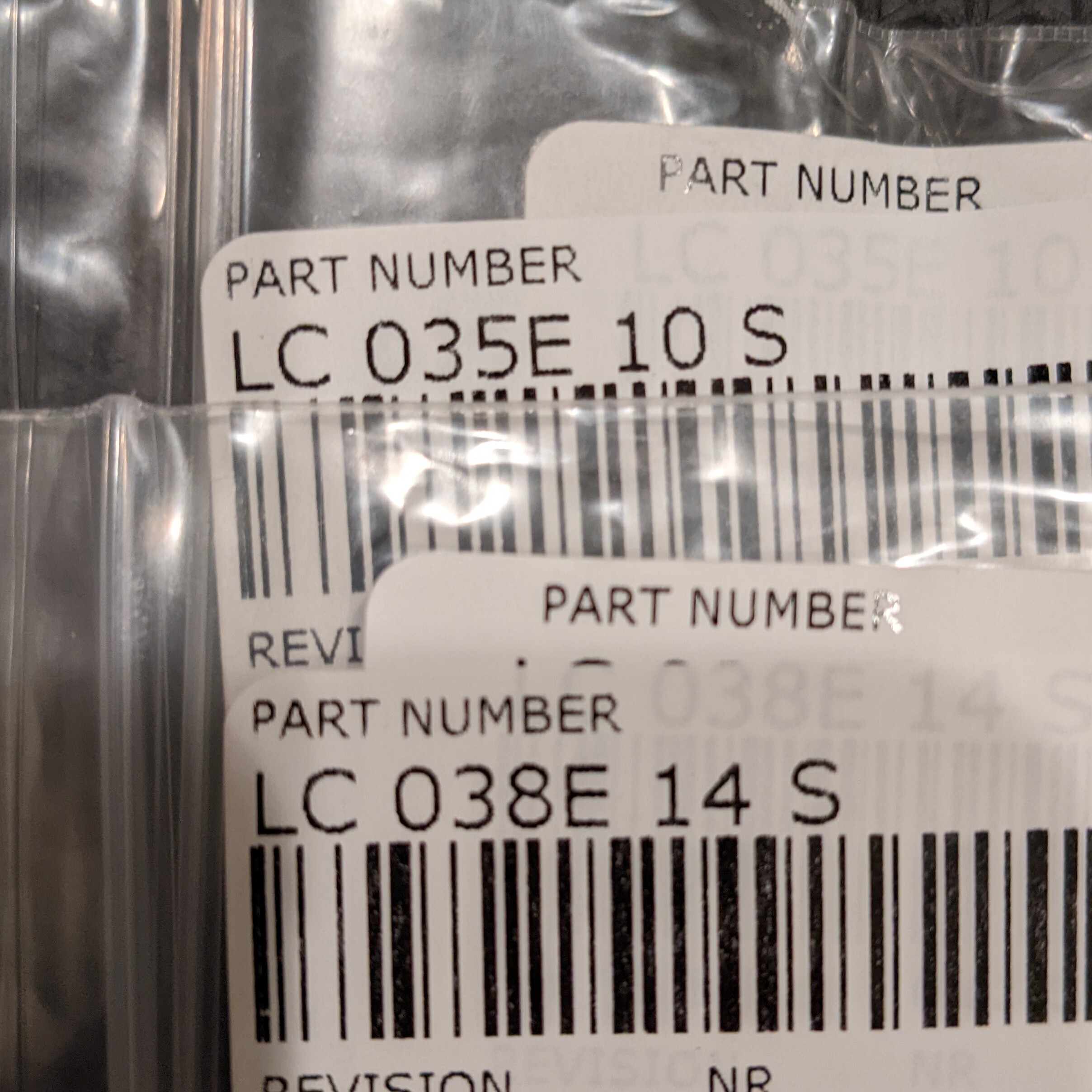

    I ordered some springs from Lee Spring for my STP. This combo is working for me for CO2. I saw velocities of 220-300+ fps with the adjuster.
    valve: LC 035E 10 S
    hammer: LC 038E 14 S
    ​​​​​​I wasn't able to get good velocities on HPA. Had a few shots at 275, but it was mostly more around 240-250 fps with the adjuster all the way out. Even tried a stronger hammer spring, but was getting about the same result. My tank output is only around 700 psi, so you might have better luck with a higher output tank.

        Where is a good place to send springs in to get replicated? I have a set in my STP that works well for 12g. Never tried HPA with it tho. I’m sure the springs will work fine with an input pressure of 800-825psi if they work with 12g.

              Ordered three of each. Ended up springing for the 316SS it was a $1 more had the same spec as the ones posted above. Lee Spring’s website is a nightmare to navigate super slow. There is a $20 handling charge and you get hit with shipping if you spend under $40. That’s why I purchased 3x spring sets free shipping and no $20 fee.
              I will post my results when I get them. They are only 45 min south of me so hopefully I get them quick. Not going to have them by the weekend unfortunately.
              Lee spring is pricy but if they get me in the 280fps range on 12g I will be stoked!
