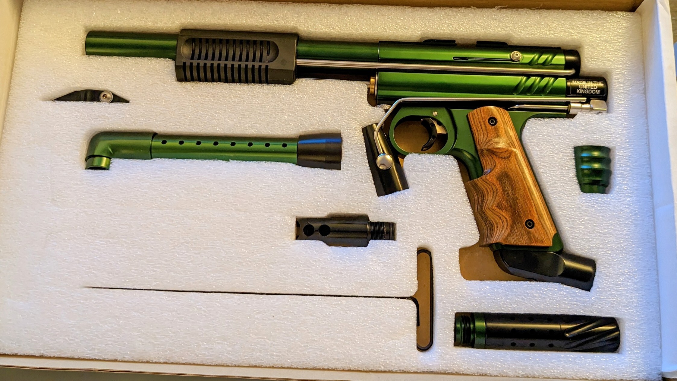

    First, I love/hate all of you for sharing where to get new Sterlings. A green stock class version arrived at my house yesterday. Took exactly 8 business days from clicking the buy button to the mailman getting the delivery signature.
    Now, I'll certainly run it sc sometimes, but mostly I'll run it as oc.
    My questions:
    1) how do I get a clamping feedneck on this thing? The vertical feed adapter uses the mounting screw as a retainer bar for either the stock feedneck or the stick feed. I didn't see any other feednecks listed on paintballshop.com's site.
    2) how do I get an on/off asa on here while still using the gas-thru tubing? I can run a bottomline via the vert adapter & use any ol' asa, but that's boring.
    Thanks, in advance!

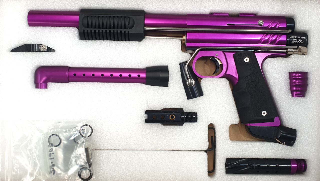

      Originally posted by superman
      Happen to have a pic of the feedneck portion? your referring to?
      The black block right under the barrel goes on the dovetail then you hold either the stick feed or feedneck on with the screw. You can see the grove in the feedneck.
      Red One
      • superman
        superman commented
        Should be fairly easy to make an adapter to plug in the black piece and still be empire spec. If that is what your looking for give me a shout.

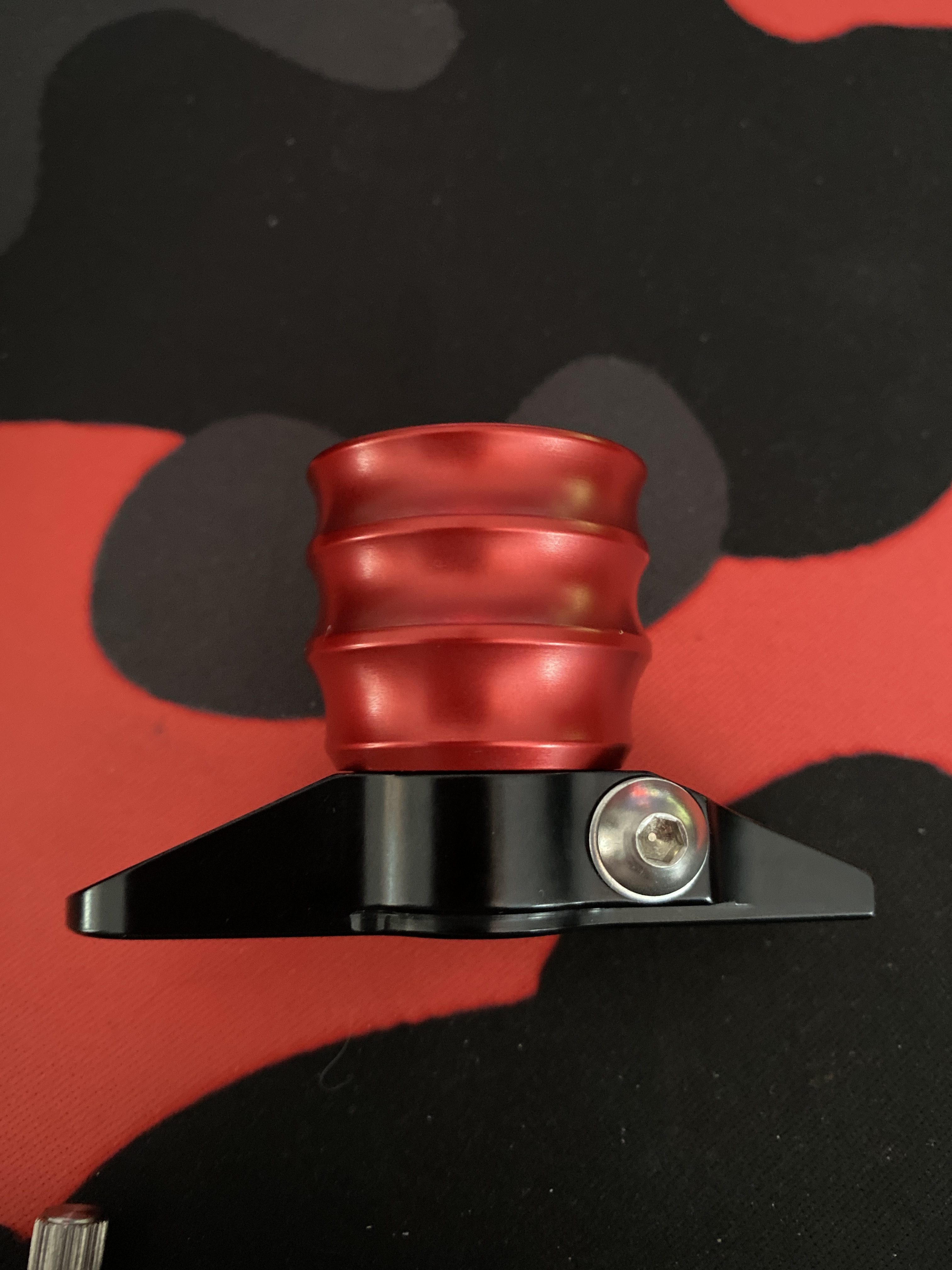

            Also it would be simple to turn the stock feedneck down to empire spec and throw an Inception clamping feedneck on it. I would do mine myself if I ever planned on running it open class.

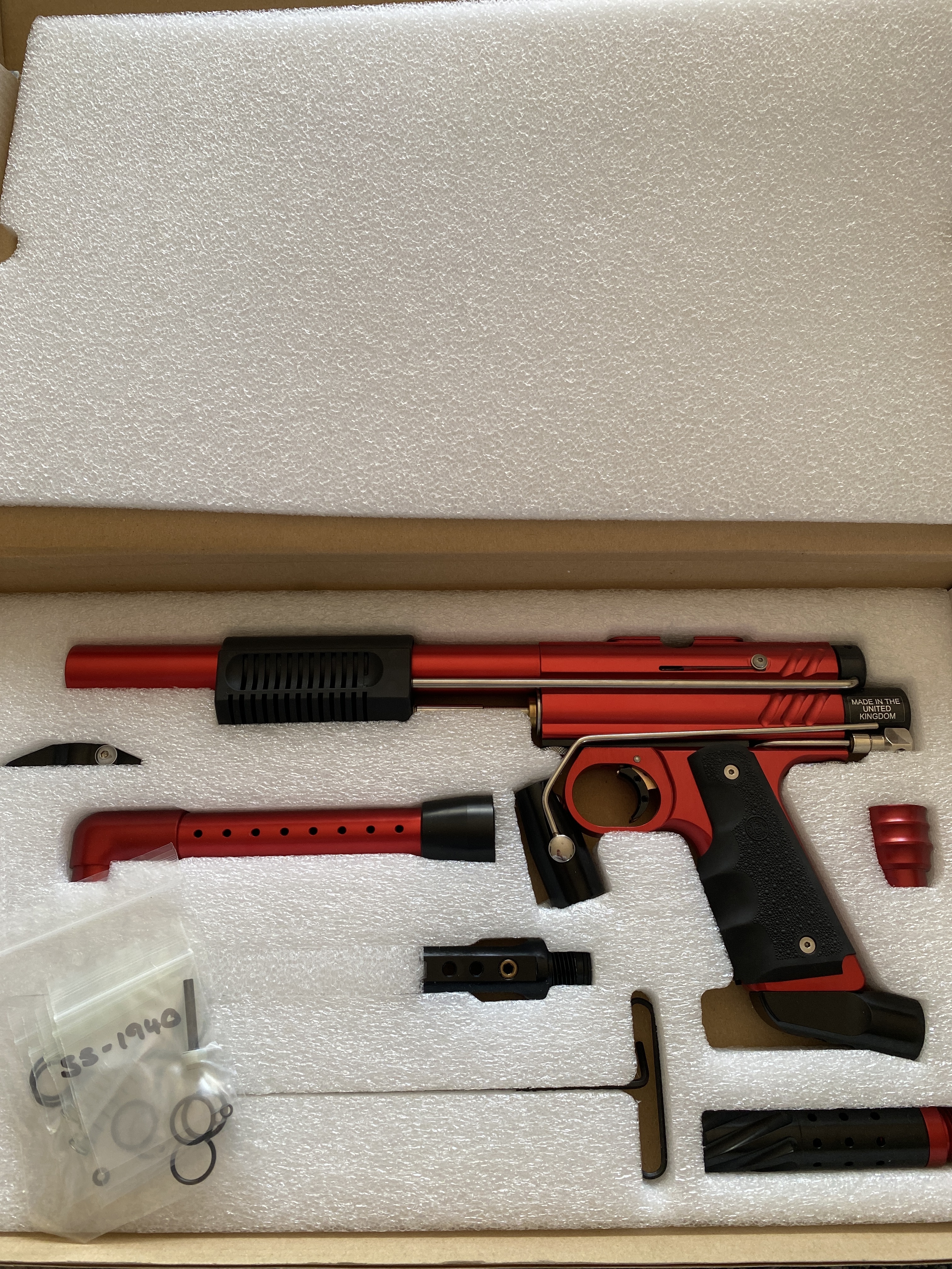

              Awesome! Did it come with the extra springs and o-rings normally, or did you have to requests spares?
              No it came with that

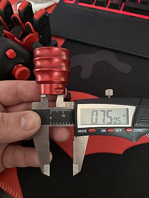

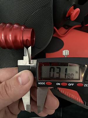

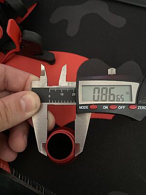

              I will measure mine today.
            • nerdcore
              nerdcore commented
              Thanks, Ducky. I don't have any calipers or anything else to measure with.
            I am sure i can punch a few of the feedneck adapters out if people are interested. Just need some dimensions.
ID:	388282 Click image for larger version

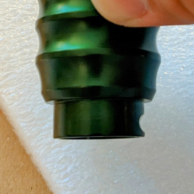

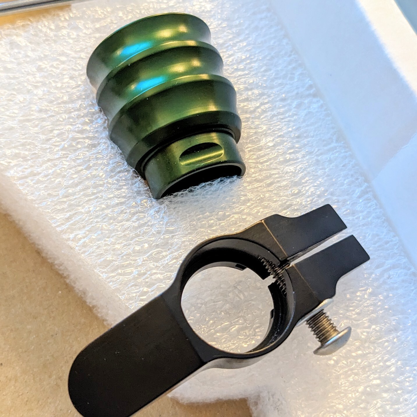

              All you need to do is get a generic clamping feed neck doesn't matter what threads as long as it's got a long enough neck to go down inside and grind a little divot in the side of it where the neck is so that it lines up with the screw ... I did that on my last one and it worked great
              • nerdcore
                nerdcore commented
                I might try that with a spare neck I have laying around. Not sure any of them are clamping but no harm in making some test necks.

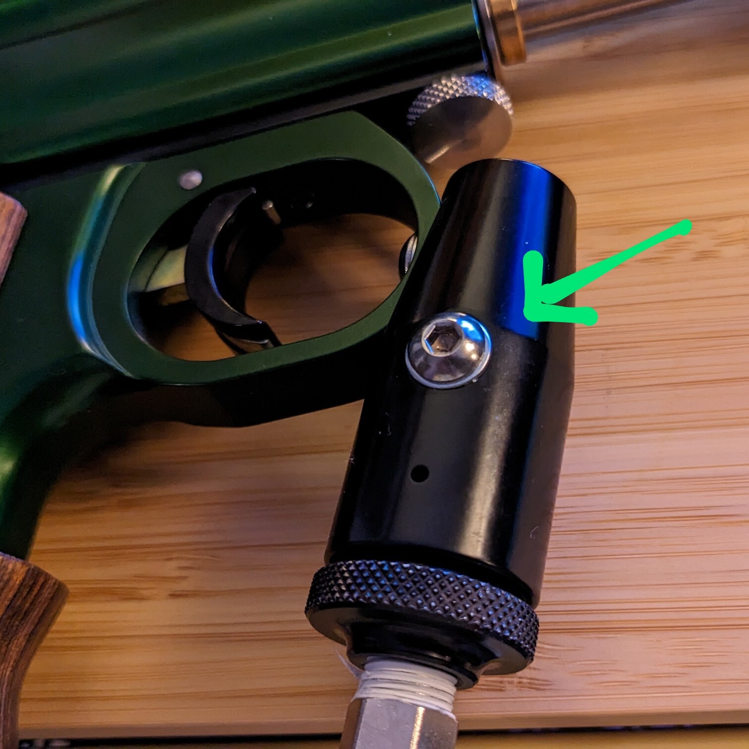

              So, what's everyone using as a return spring? Holding the pump handle forward is gonna get old.
              In other news, the screw on the vasa, the one that holds the gas-thru port welded to the hardline, NEEDS loctite or teflon tape or any sealant, because it screws directly into the port. Found that out tonight.
