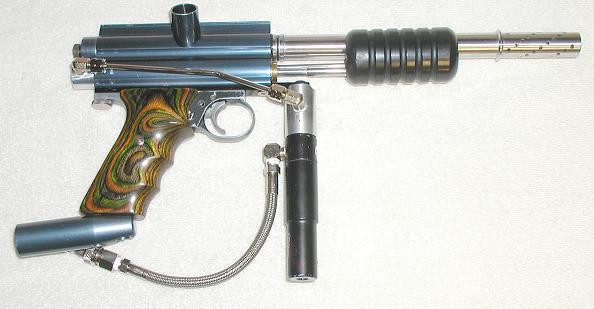

      I'll post a picture when I get home. Heck, I've got a spare Lada Sterling with the same spacing if someone needed to use it as a test bed. I recall the ancient pics that surfaced from La Frac? doing it 20 years ago on their half block Sterling.

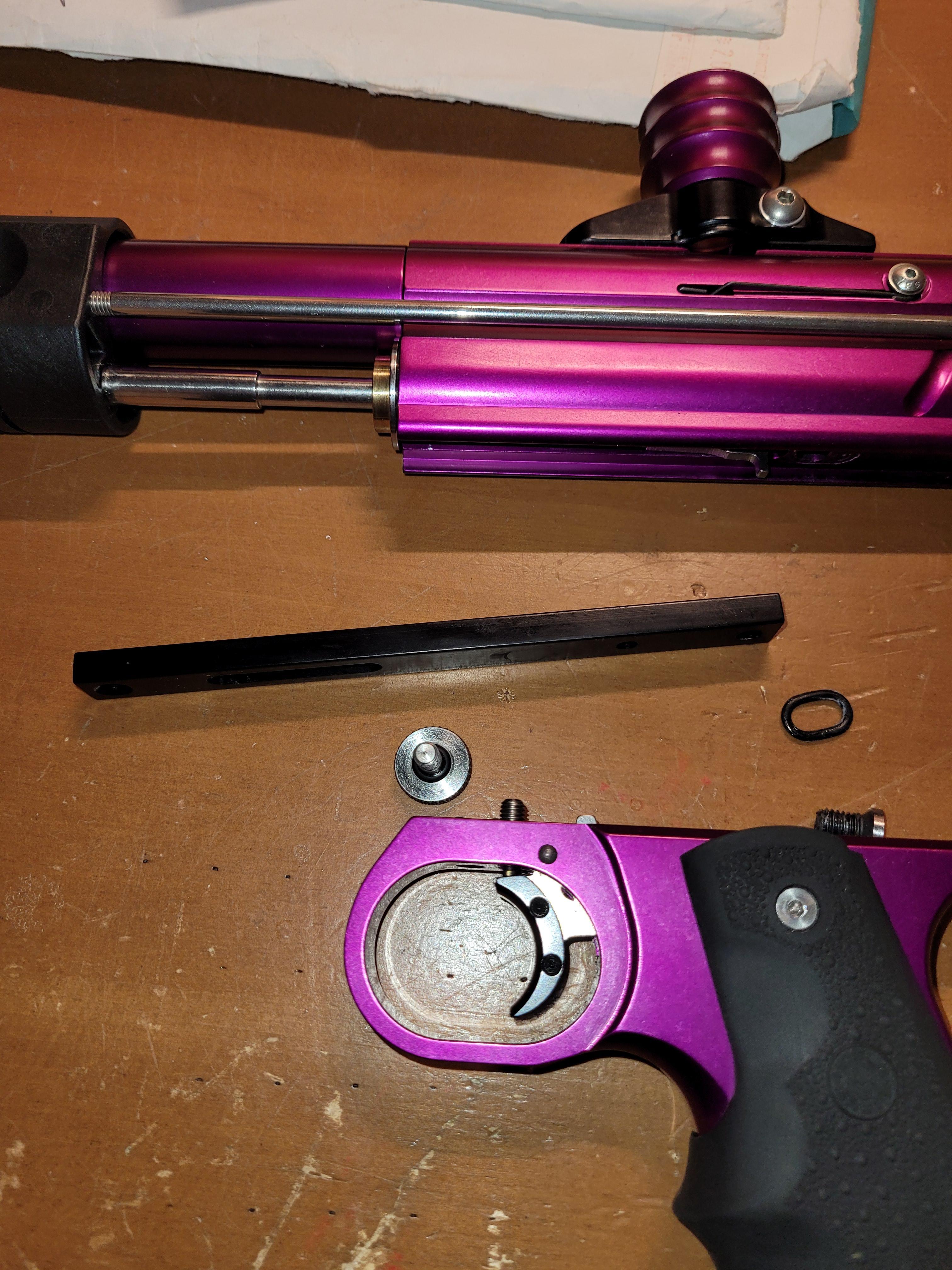

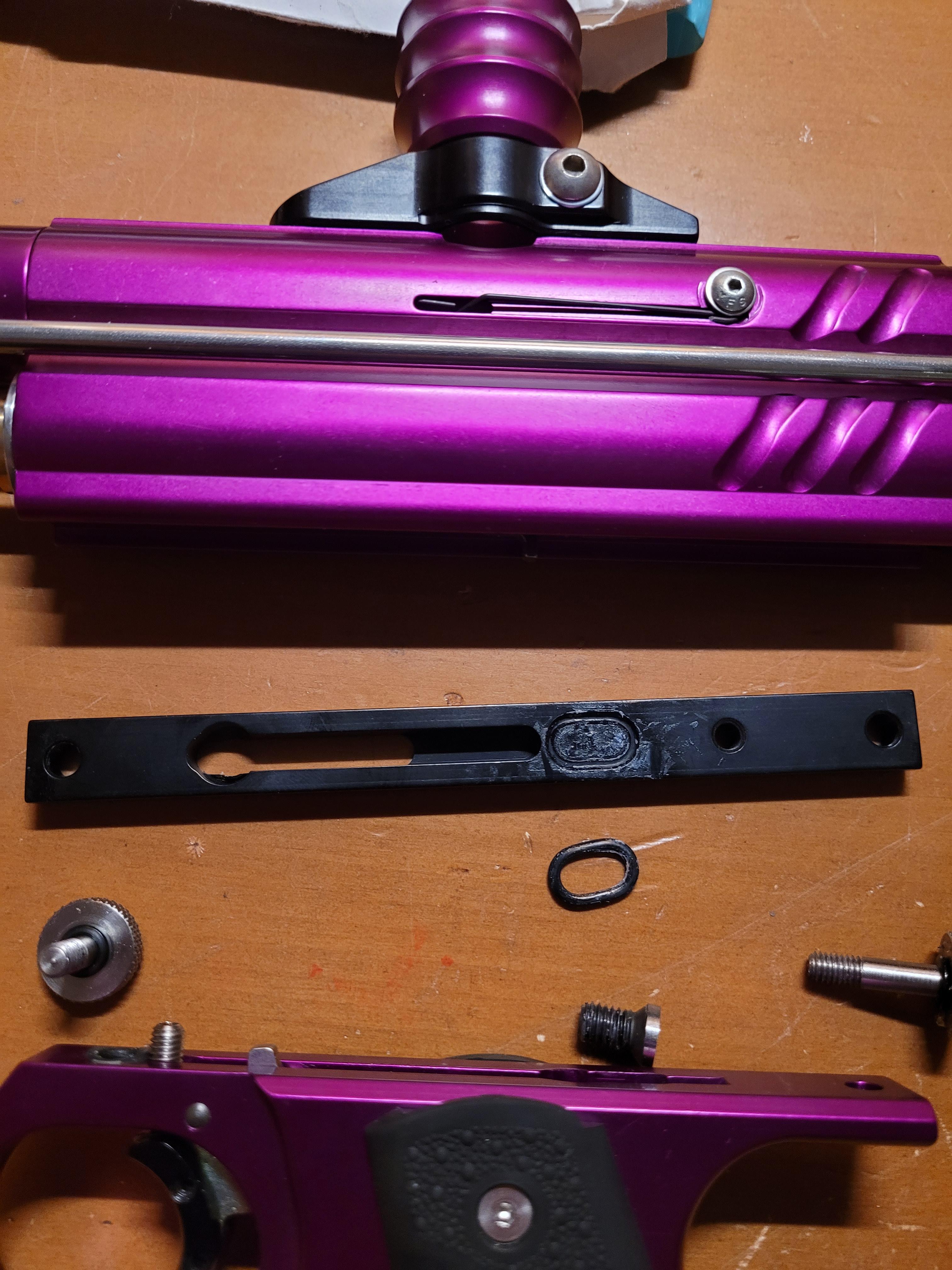

    The spacer. Looks like 3 holes (one at each end, one to hold the body screw, the 2nd one in the back is unused) a slot; and a half milled oval for an oring that plugs the bottom of the valve exhaust. Looks like this could be round as well as it's only function is to hold an oring. The hole is left from boring the body for the valve exhaust to vent up to the bolt. The bar is plenty strong and thick but might need a less corse thread to hold a vert asa like a mag dies.

      I'm in the process of milling a sorry excuse for an aluminum rail on my sorry excuse for a mill, to add a mag VA. No idea how one would fit an air line inside it, though, without some serious sorcery. Instrument tube down the edge, and use steel to make up for the loss of strength?

        Oh, no other mods needed. A rail that I could put a VA on would make me very happy.
      • flyweightnate
        flyweightnate commented
        Can you measure your rail very carefully, and send me details? Mine is a generation older. But, if you don't mind that the milling might be a bit rough, I could help you out.

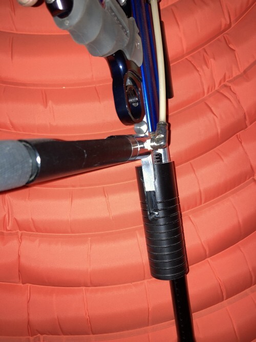

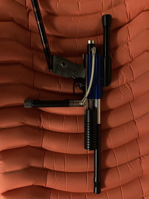

      I had a similar setup. I had two holes drilled int eh trigger frame to accept a Phantom vert ASA. Then I ran macro from a plug to the asa. I don't have a pic of that, but I do have one with a 12 gram adapter on it. Kind of like what you mentioned originally.
      https://photos.app.goo.gl/26RwGgzoAvmer3jN7
      • Spec
        Spec commented
        How secure feeling was the setup? Just wondering with phantom VA being flat attaching to a round trigger guard.
      • shooter311
        shooter311 commented
        They were able to use both holes on the Phantom asa, If I remember correctly I had to buy a longer screw for one of them. However, it was very sturdy.

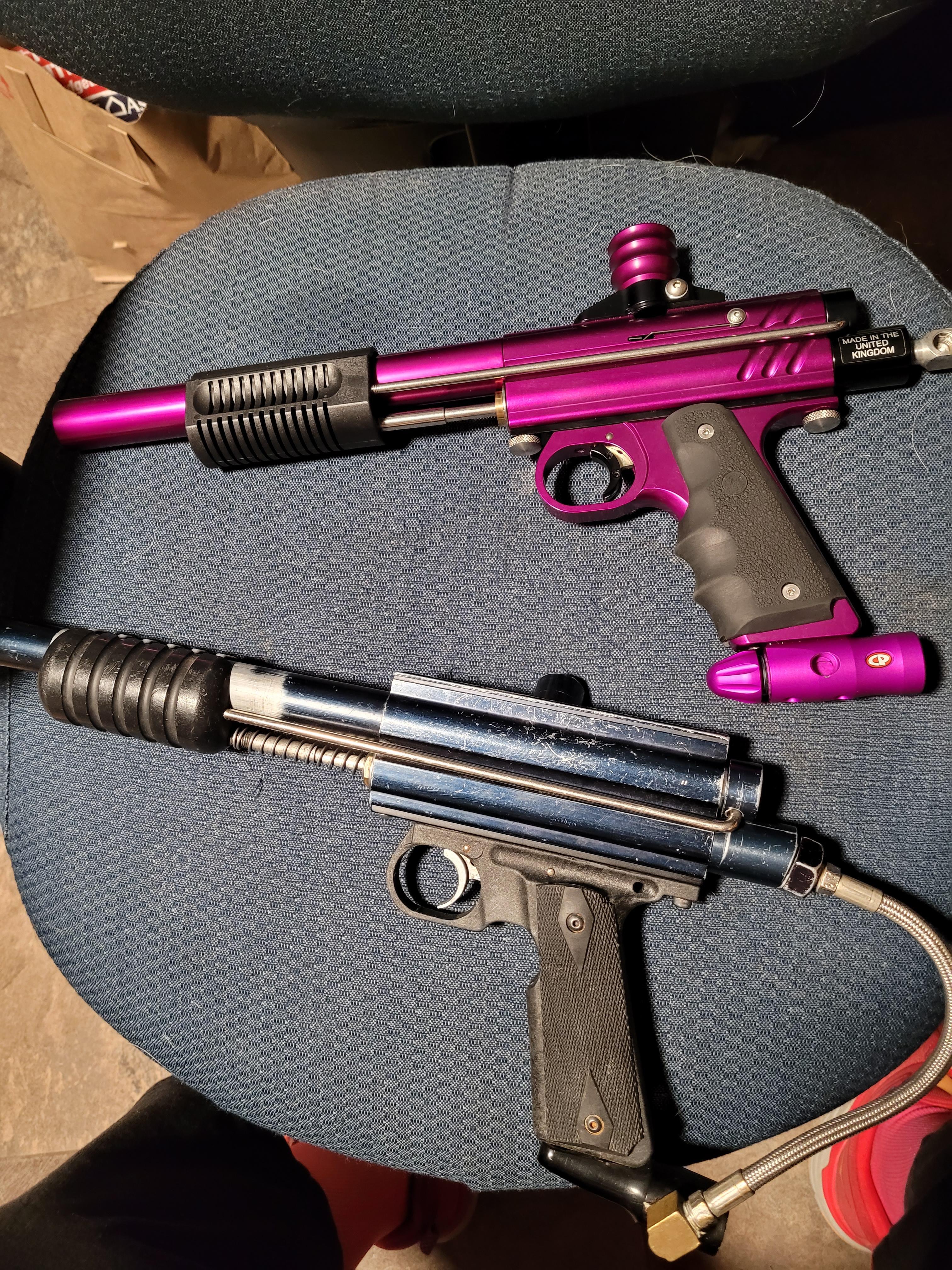

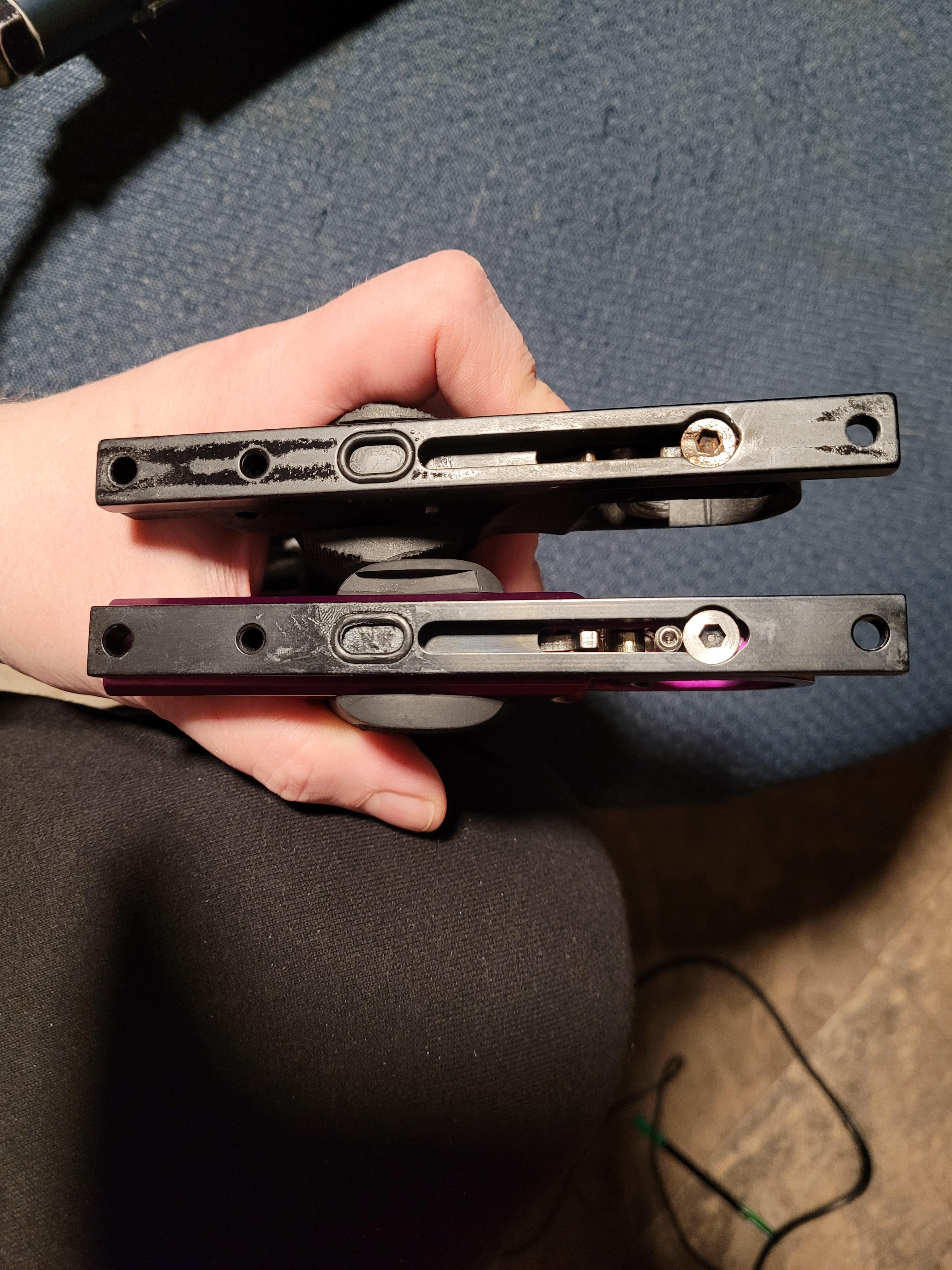

      I've searched high and low. No micrometer to be found. So next best thing. I pulled apart my old school Sterling and swapped the inserts. They are identical as far as I can tell and both markers worked fine with the swapped parts. So, if a 2nd extended insert is possible, I'd love to purchase it to play with and muddle on!

      • flyweightnate
        Very interesting.
        I'll see if I can whip up another - busy couple weeks - then get in touch if I feel like it's usable.

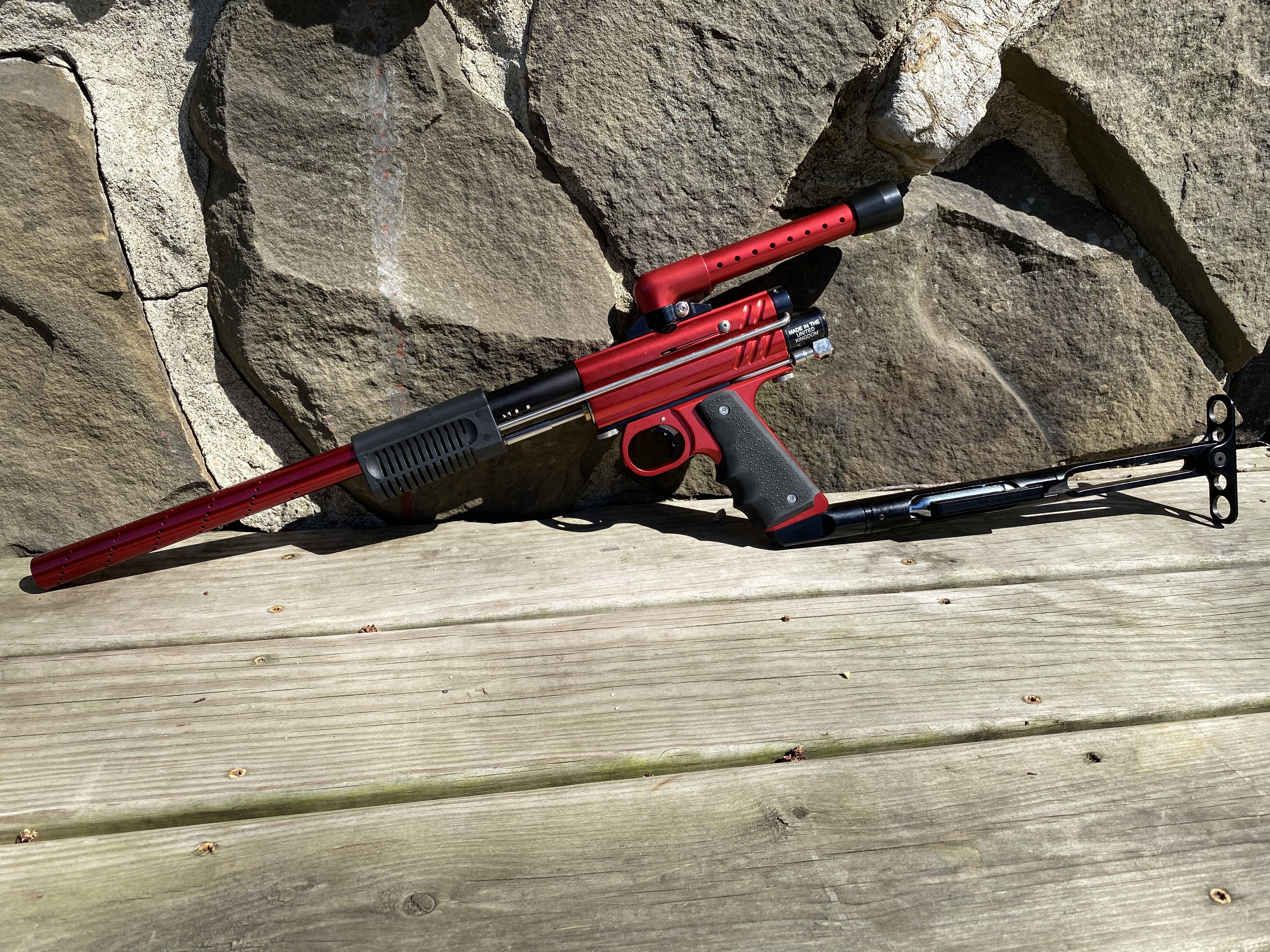

      This one had an extended rail... But it was a while back.....
      Walkers Current Feedback
      • flyweightnate
        Wow, I had one almost exactly like that. Square sided pump and original grips and barrel, though.
        What a looker!
      • Spec
        Spec commented
        That is a cracking setup. Very cool.

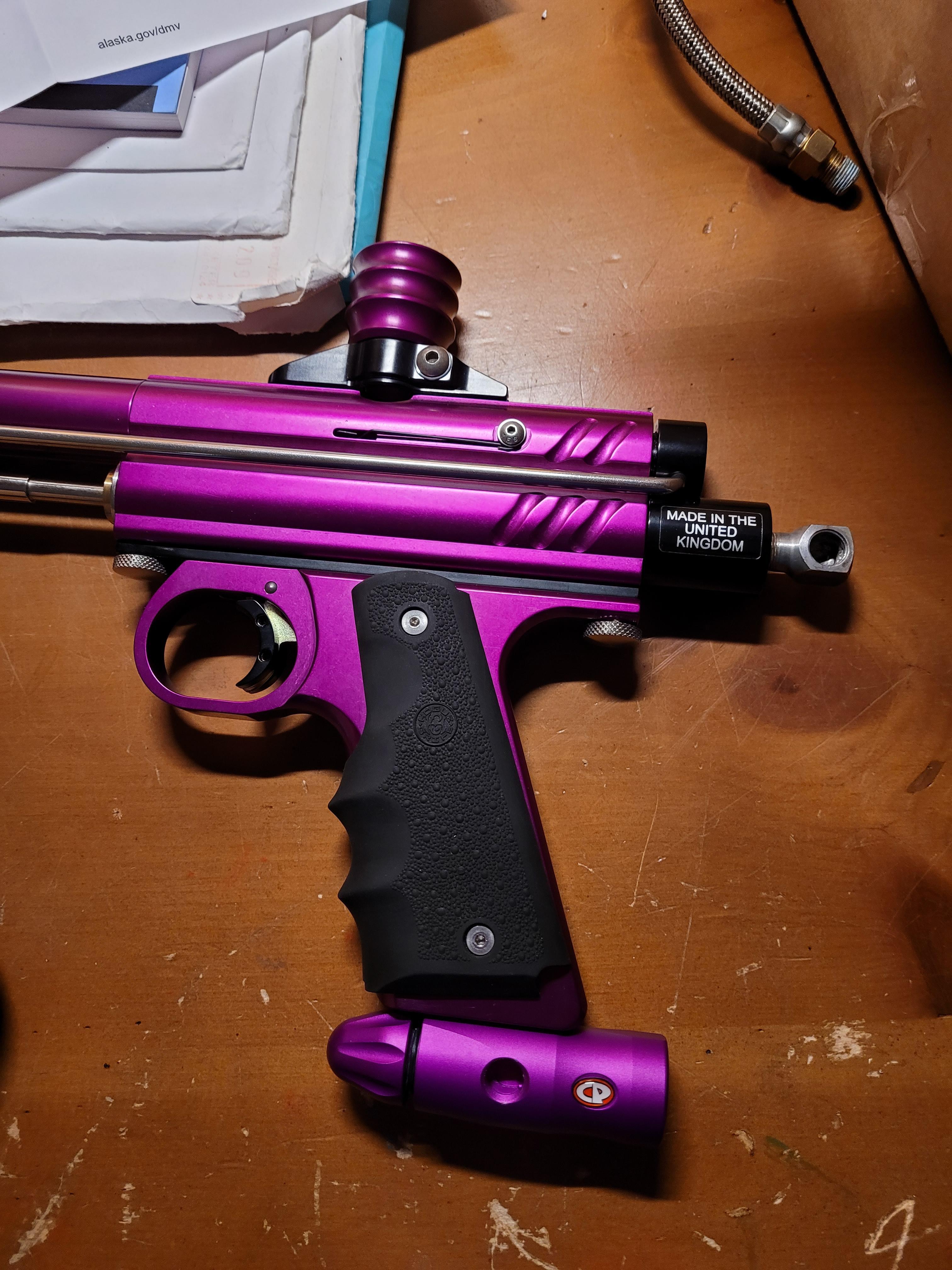

        I ended up extending my rail and using it for an underpump guide that keeps the pump sammiched in between the barrel and the rail. Added a AGD vert ASA and side tapped the valve. I didn't get the valve drilled as close to 90* as I would have liked but it works. While the slot in the pump handle looks bad in the pick, it's just a bit of grease.

          That's an interesting idea and cool way to support an under barrel pump. I just don't have tools capable of making a rail so I'm looking for options.
