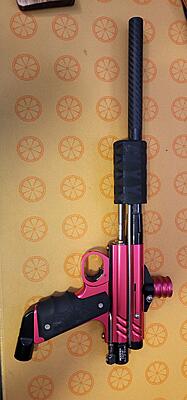

          I have used two different barrels and i have the same results. picked up a deadlywinds fibur x also using freak inserts and it breaks paint just the same as the stock barrel.

              I could beleive that the stock barrel could be bored off center for the freak, but the deadlywinds fibur x is very popular barrel and I'm having the same results when I use it. I doubt that the deadlywinds barrel would be bored off center.
              If I inspect the barrel and breach with a light I don't see any edges or anything protruding. It looks flush and continous.

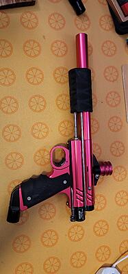

                    Here is a photodump, maybe someone smart will spot something that doesn't look right (other than the paint, lol)
                    This gallery has 11 photos.

                      Have you checked the feedneck and the stock feed?
                      Thru the years I have seen burrs or other machining problems that damaged paint before it hit the breech.

                        Where in the barrel are the breaks happening? Near the breach? A few inches into the barrel? It's got a wire detent in it, so check to see if that detent needs to be bent at all. If the detent is too far forward, it might be letting the paintball roll forward a bit too much. This would mean that the paintball above it is sitting too low, so the edge of the bolt smacks it on the forward pump stroke and cracks the shell, but not enough to cause a break in the breach. When the burst of air hits it, it starts to shoot then self destructs a few inches into the barrel because of the crack.
                        That's the first thing I'd check anyway.

                          This is an auto cocker style detent. The bolt pushes the ball past it when closing. It only prevents double feeds, not rollouts. So even if the detent was in the wrong position (which I doubt) the problem would only occur if he was a slow as hell pumper.
                          After thinking about it and reading other posts I think the paint is the main issue combined with too small of freaks. Even with this paint I think a stock barrel combined with tape or quality wedgits would fix the issue.

                            I think you are right Zeta, in the Sterling once a ball is loaded it sits in front of the bolt, beyond the detent and sites in a bore in the body behind the barrel. If you have too small a bore for the shape and size of the balls when the ball is fired it has to jump over that transition. This can quite easily cause balls to break. In general you want bore to increase as the bolt is fired and travels away from the bolt. The measurements on the paint has a huge amount of variation (you are shooting eggs not balls). This is why I like slight overbore and use of Wedgits or Freedummy detents (especially with the crappy paint that is normal now).
