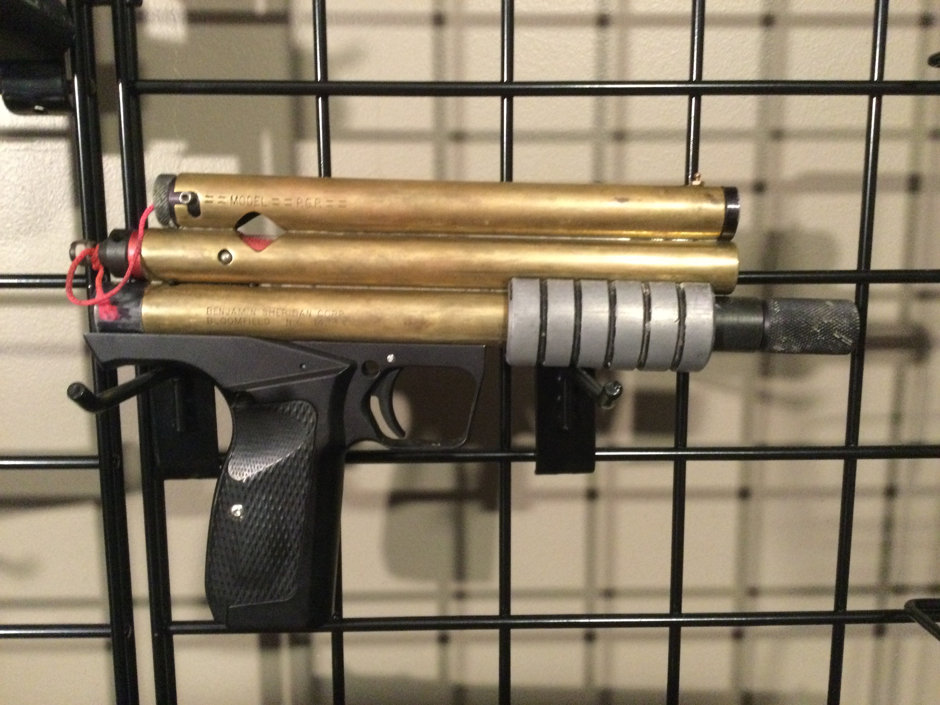

            First of all. Pimpimg out a cheap pos marker is what this is all about to me.
            I am the type of guy who puts CCM 86 grips on PGPs.

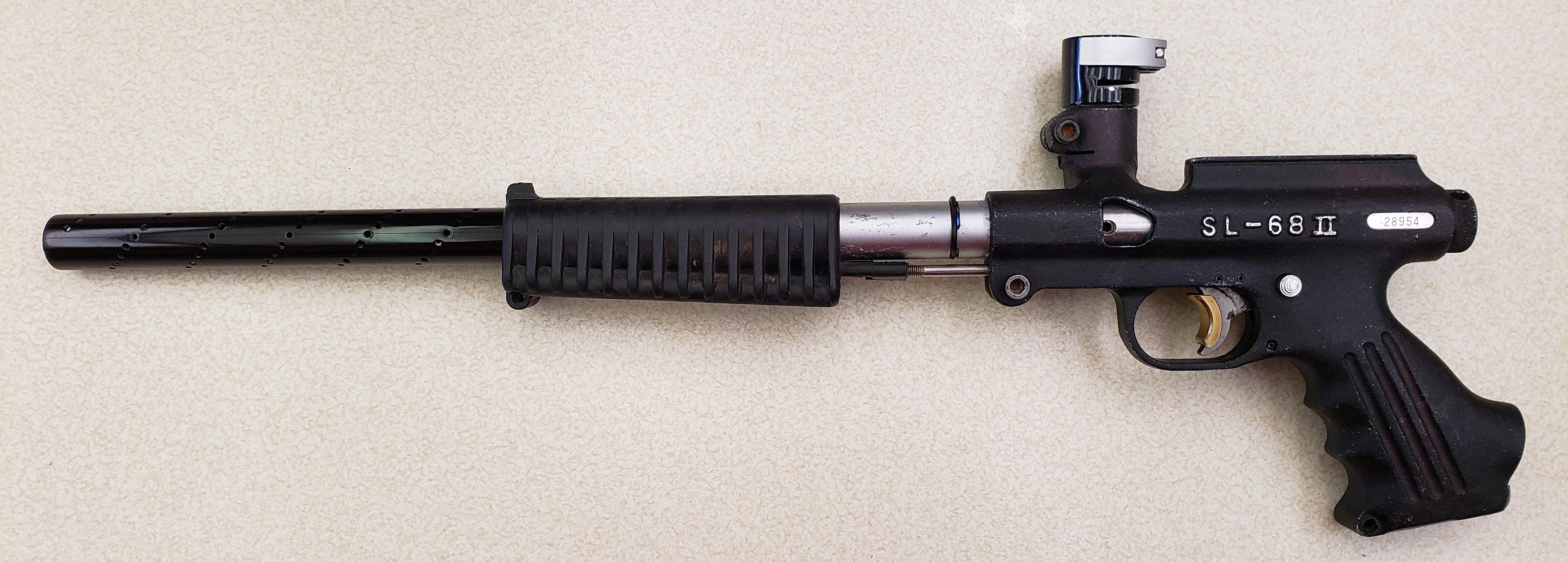

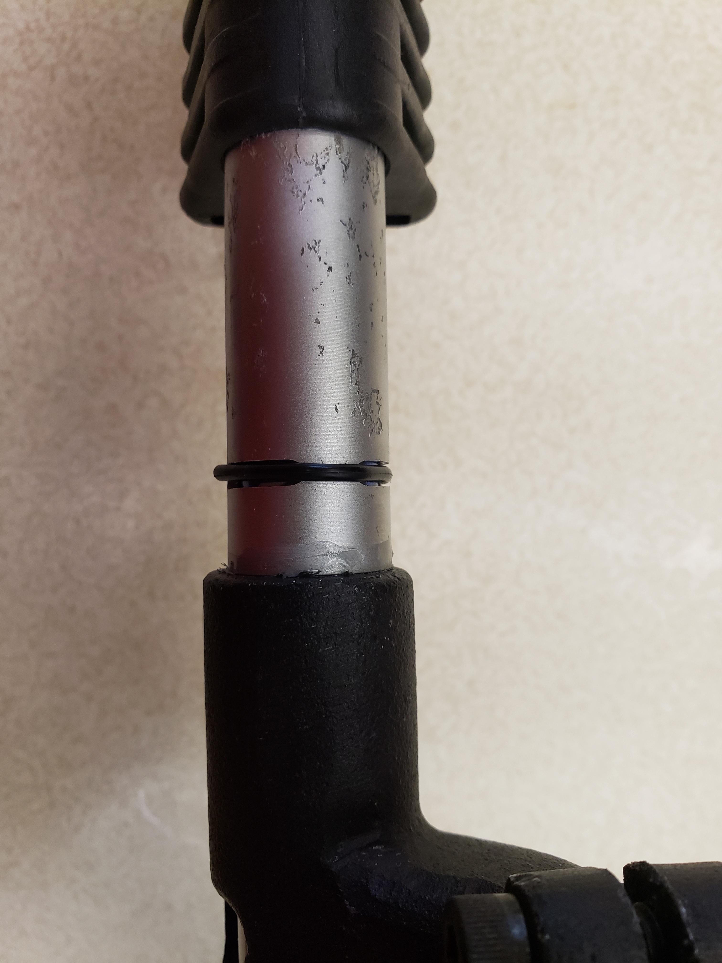

                I had an airsmith from the pre ransomed version of MCB freak bore and add 3 evenly spaced external oring grooves into a smart parts barrel that was turned down to fit my Sl68-ii (the oring locking method sounds similar to what you described in option 1). It works quite well for holding the freak inserts in place.
ID:	108396 Click image for larger version
                • Darknite667
                  Darknite667 commented
                  I don't. when I bought the barrel it was already turned down to fit the SL68-ii by a previous owner. I just had the freak bore modification done to it. Also if you end up trying this method of freak boring make sure that you recess the insert deep enough into the barrel to avoid having the front of the firing bolt catch the back of the freak insert and pull it out of the barrel into the breach. Food for thought.
                • Ironnerd
                  Ironnerd commented
                  I have been wanting to do something similar, but am concerned that barrel would become too weak. Any issues with cracking?
                • Darknite667
                  I haven't noticed any cracks in the barrel after the modification. Seems to be holding up well.
