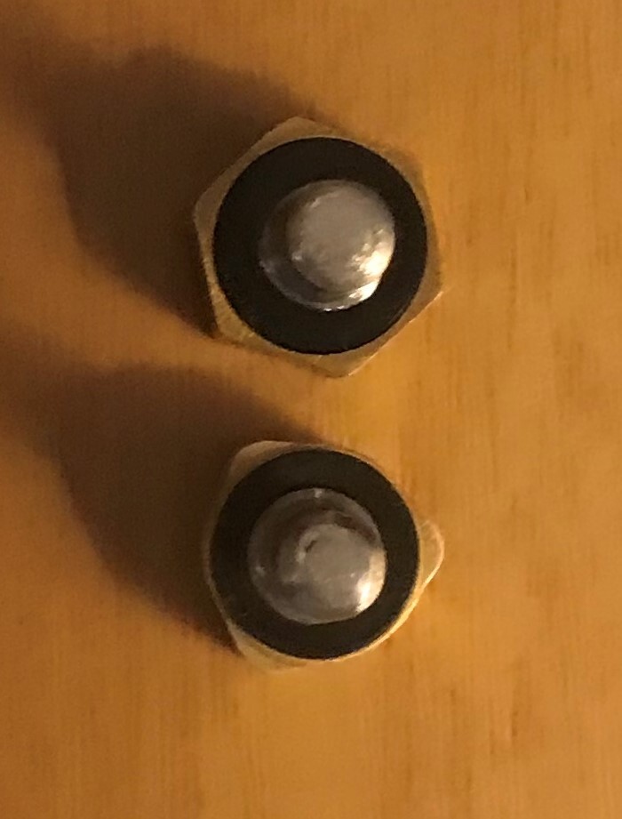

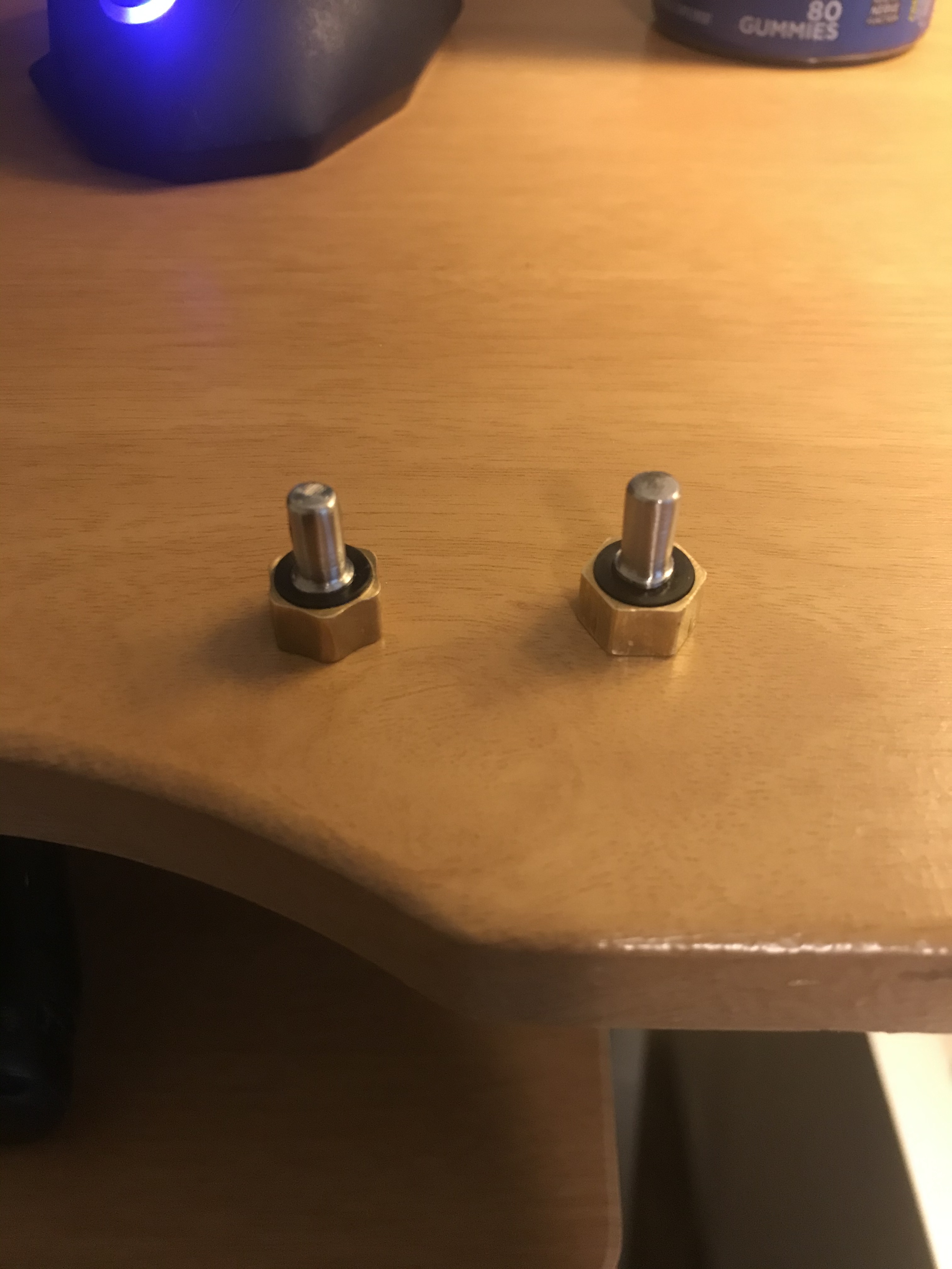

    I started with trying to increase the space inside of the valve. I got a hexagonal piece of brass, a stainless steel rod, and a few rubber seals from an A5 valve that I used to make smaller versions of the poppets that come with the SMG valve.
    I found some video of BretG showing off some of his modified valves so I tried to replicate that as much as possible, but I couldn't quite work his magic on it. I slightly rounded the corners then added fluting around all faces on the front poppet, and fluted two opposite faces on the rear poppet. When put back together the valve held air and cycled, but the paintball wouldn't even register on the chrono. Tank was outputting about 800 psi.
    IMG_1985.jpg​
    I tried completely removing three of the corners from the front poppet to get as much air flow forwards as possible. I should mention I was also trying different springs inside the valve, and at this point I was using a very light one. Put it back together and it held air and cycled at 800 psi HPA, but shot barely any further than before.
    Tried it on a CO2 bottle and it jumped all the way up to 250 fps consistently on the chrono: https://photos.app.goo.gl/4GRyUJcUELn9YHXN7
    I also tried an HPA bottle with a Ninja SHP reg with all three additional shims. This was the only time shots on HPA registered on the chrono, but still only at 140 fps.
    I am now at a loss as to how I move forward. Any suggestions? Only thing I thought of is swapping out the bolt spring with a slightly less worn one from a 68 Special I have laying around.

      Narrowing the stem of the front poppet can help.
      What does the front poppet hit? On a 68 Special the powertube needs to be modified for better flow, does an SMG have something similar?
      • Tominator
        Tominator commented
        I am running a weaker valve spring. Longer, too. I literally just saw that some have narrowed the front stem in these modifications, but do you know what the intended effect is? Is the idea just to make the front poppet lighter than the rear so it more easily opens up?
        Jordan commented
        I think narrowing the stem is to promote flow... later versions of the valve in the ProLites use thinner front stems.
