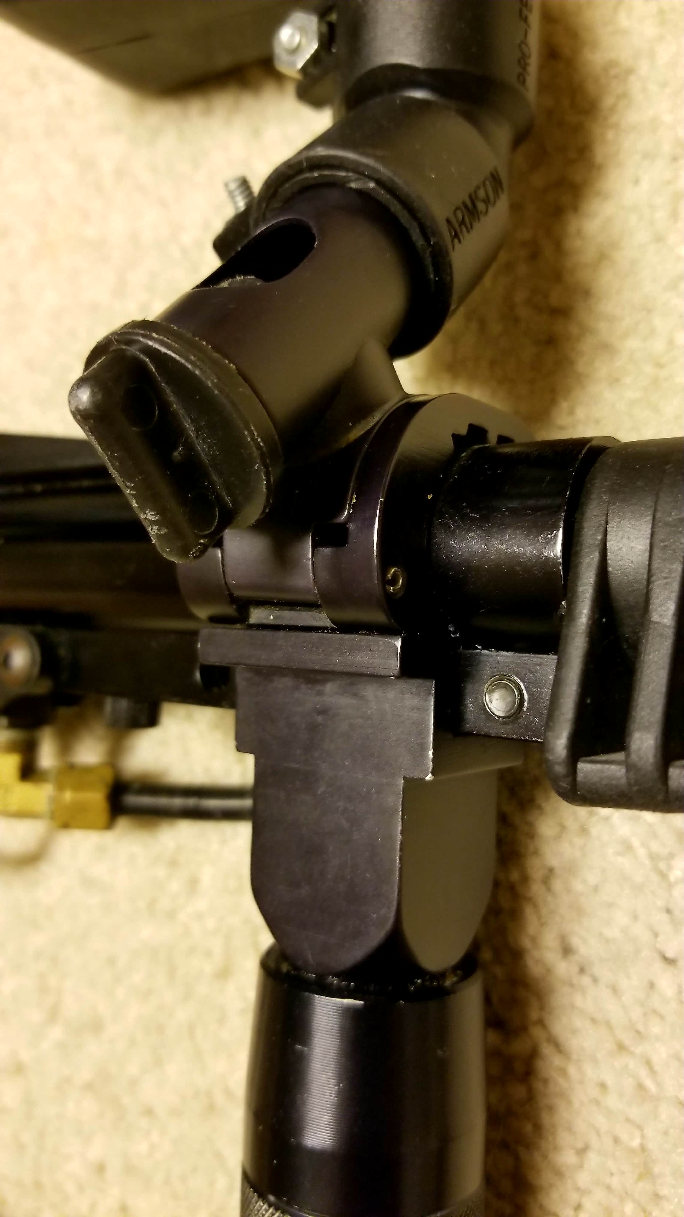

      Since it was mentioned by Myrkul and then Chappy dropped a pic of the part I thought I'd add some pics. Good luck finding one, but if you find one grab it.

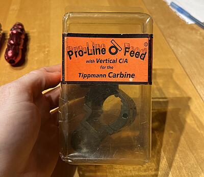

        Don't know if you noticed Drunkscriblerian but there is a Pro-Line powerfeed/vasa for sale on the board. https://www.mcarterbrown.com/forum/b...and-misc-parts

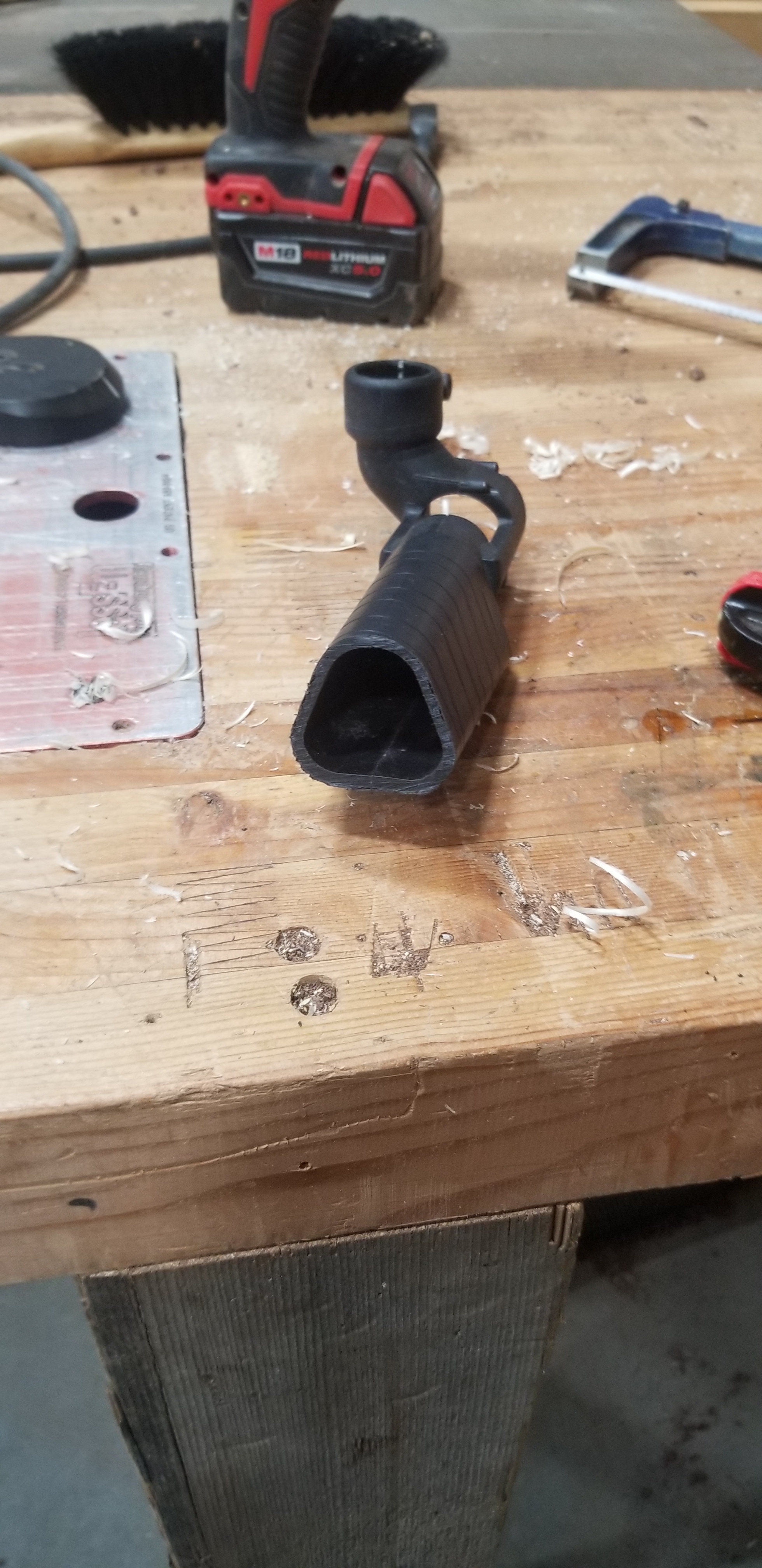

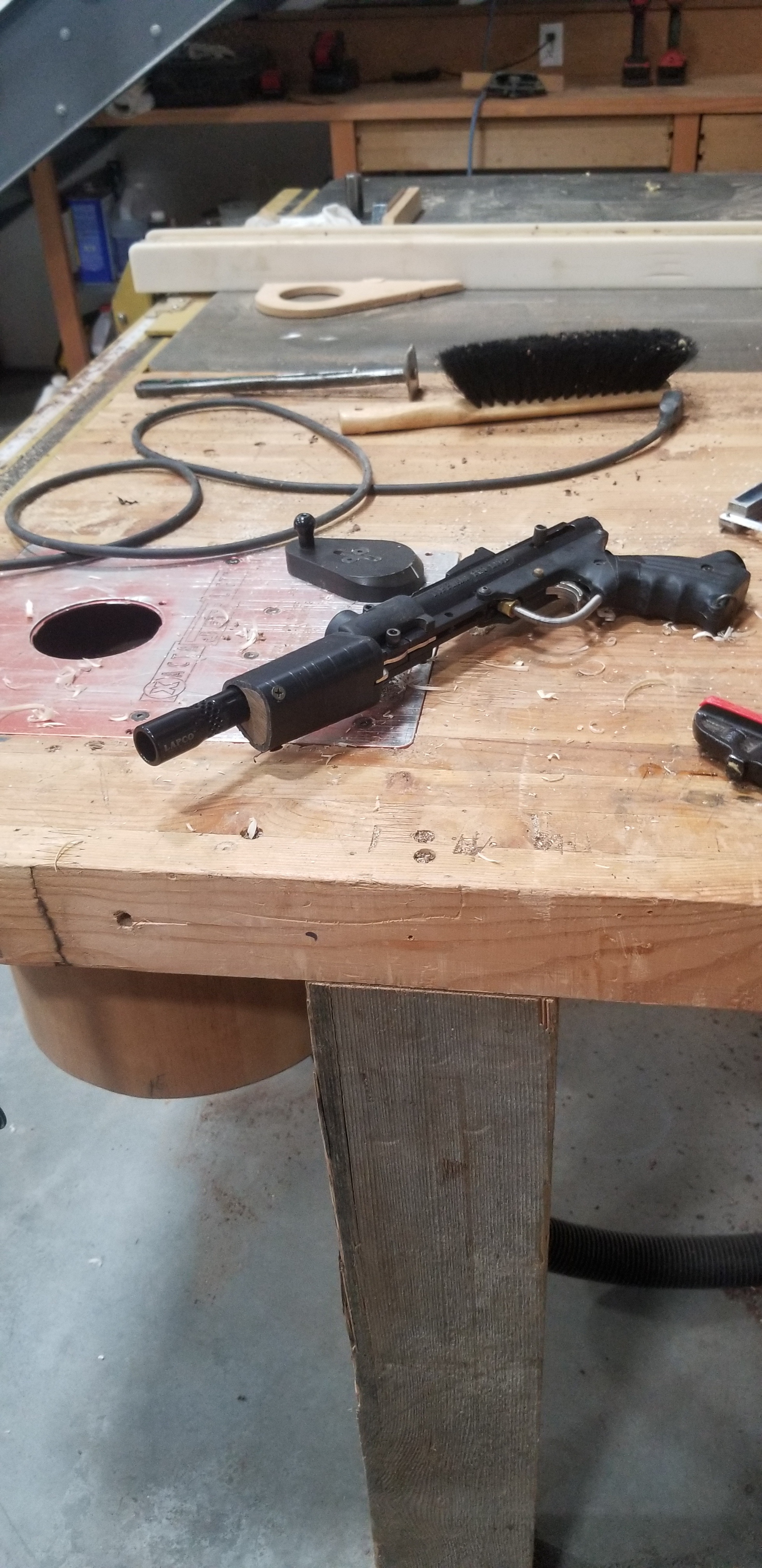

          The biggest problem I had with my Pro-Lite on the field was that it was too freaking long; between the basic design and that 18 1/2 inch SP barrel, it was like shouldering a Kentucky rifle. I sourced a shorter Tippmann threaded barrel, a nice 8 inch Lapco Bigshot. But that wouldn't thread thanks to interference from the fore-end. So I did the only sensible thing; I took a hacksaw to the fore-end.
          At that point the barrel screwed in fine but the front end obviously looked janky as hell. So my dad and I cut and milled a piece of oak, worked it into the front of the fore-end and screwed it in place. 20240121_132927.jpg The result was pretty redneck, but the balance was vastly improved when I put a tank on it. Oh, and it's loud as all hell now. Still, I'm happy with it.

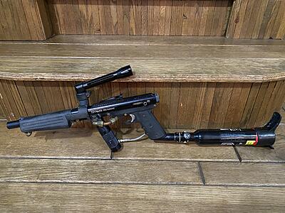

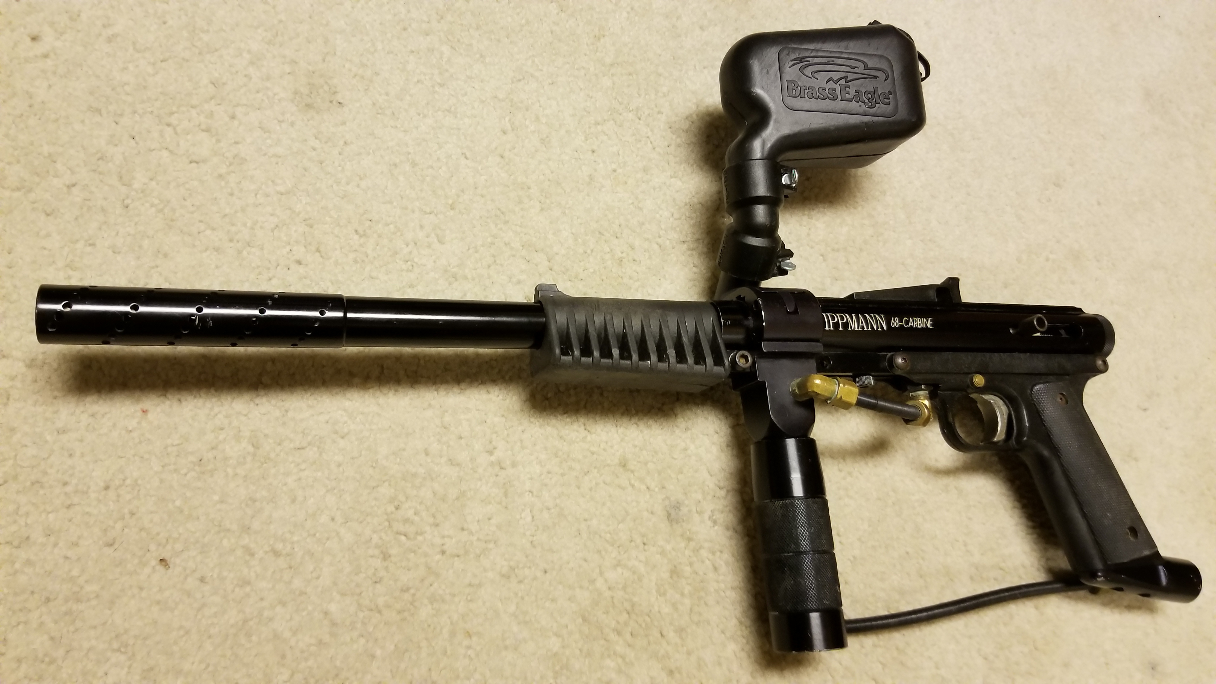

              Just another vote for the Pro-Carbine being the best gun Tippmann ever made. Here is mine. Also, if anyone needs the weird metric seal for the brass gasline adapter on either a 68 Carbine or pro-carbine, just let me know. Minimum order size was like 100 and I only needed like 5 or 6....
              Just pm me your shipping information and let me know how many you want. Absolutely 100% free I am never going to need this many of them.
