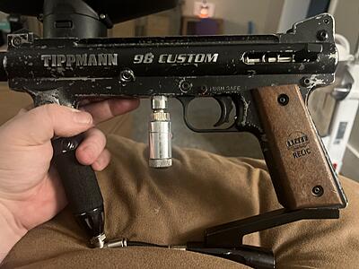

    I’m getting close to finishing up a very cool 98c build and I decided I wanted to drill and tap the vertical feed for a volumizer. I picked up a pretty cool and vintage AC low pressure reg I plan on gutting. I was thinking though, how many threads could I possible get when tapping the VF? Im concerned about stability. Should I put the volumizer straight in to the VF or buy a fitting and put the fitting in the VF and then the volumizer in to the fitting?

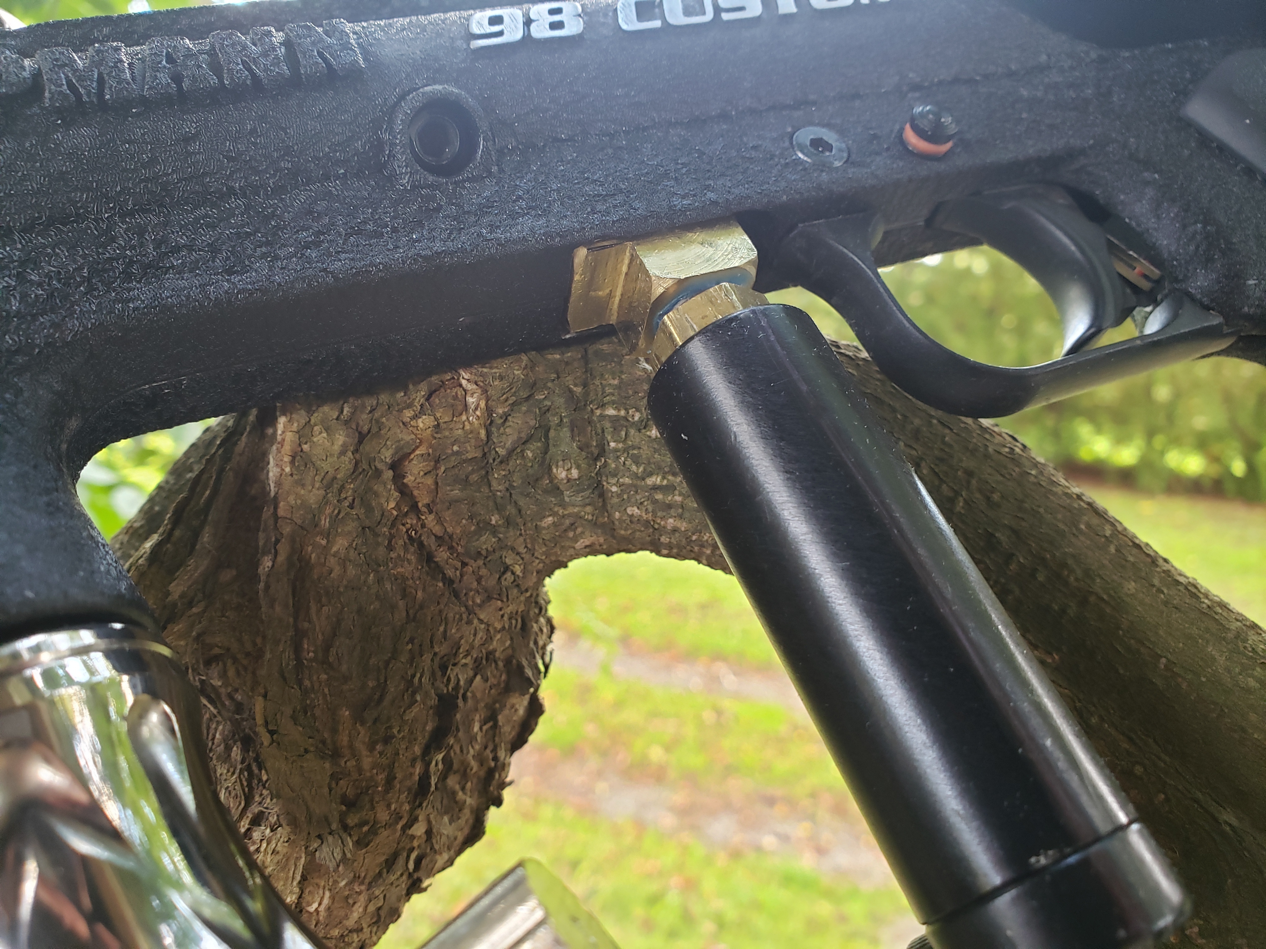

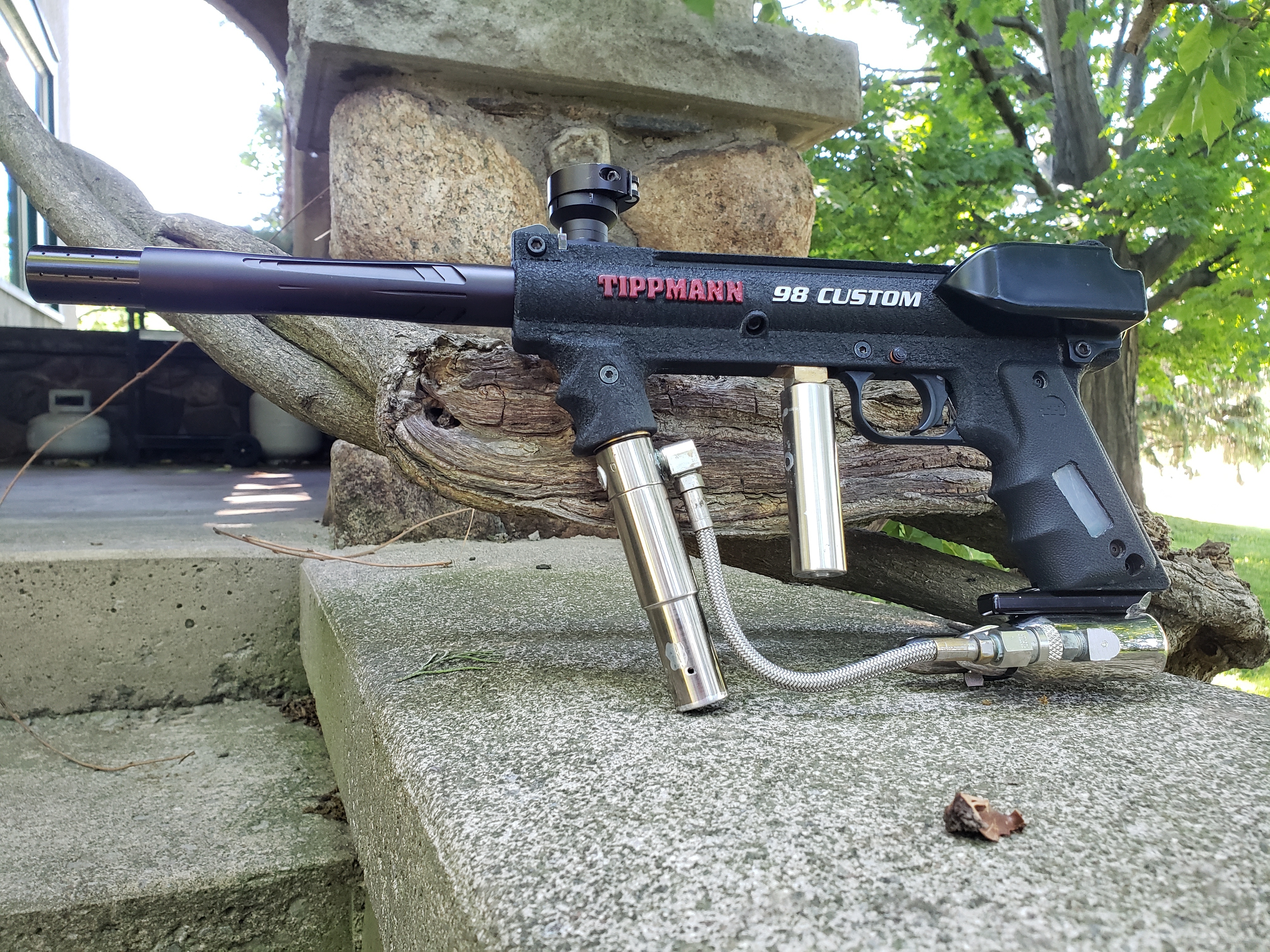

            I used a "Tee" fitting like this one:
            Anderson Metals Brass Pipe Fitting, Barstock Street Tee, 1/8" Female Pipe x 1/8" Male Pipe x 1/8" Female Pipe https://a.co/d/800xLFT
            I de-soldered the vertical adapter pipe from the 90° fitting already on the VA, threaded the pipe for 1/8"-npt, and red Loctite'd it into a female port on the tee fitting, then threaded the assembly into the valve like normal. I ran a gutted LPR off the bottom port of the Tee.
            I don't have any pictures of the process but I do have a shot of the finished product.
            And then the last picture I have before I sold it:

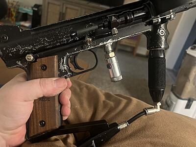

                Got the job done! I ended up cutting it with a metal saw instead of desoldering it. I also used a 1/8th stainless steel street tee I found on EBay, a metal drill bit and a dremel to hollow out the lpr, and JB weld cold weld worked great to seal it all up
