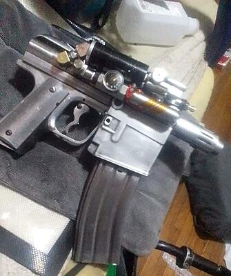

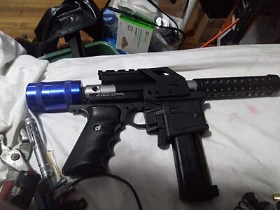

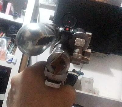

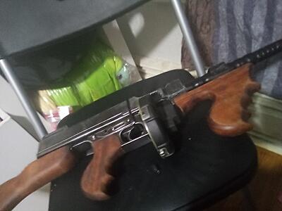

            I take automag valves and put them into different guns mostly metal replica guns I gut out insides and put automag valves inside or I just took guts of a fn303 which is is based on automag valve with a drum and I put inside of a Tommy gun replica I call it a TommyKaye gun after automag inventor.
            I'm working on a M3 grease gun now I've made lots of different magfed automags too though some that use tipx magazine. Automag valve is perfect size to fit in most guns. I use high end replica guns made in Spain by company named denix most are between 150 and 250 bucks so not cheap but very very realistic all scale size. They sold not ment to fire just cock and dry fires bolt I remove that shit and put as much of automag mag inside as I can. It takes alot of grinding sometimes but not to hard if have the tools. I started making just magfed automags then started making real magazine work as paintball mags and that's what brought name to doing replicas. The first and second photos of magfed automag is experimental less lethal I build with a heated dump expansion that heats co2 up increasing psi out put to as much as 2000psi making shoot .6875 steel ball bearings very hard over100 joules
