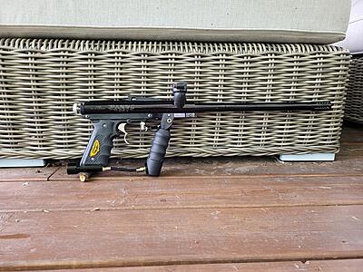

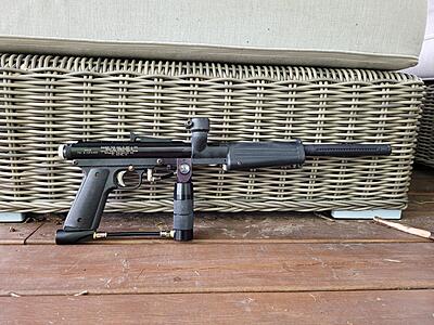

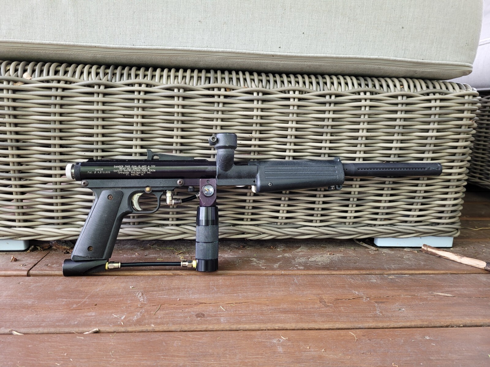

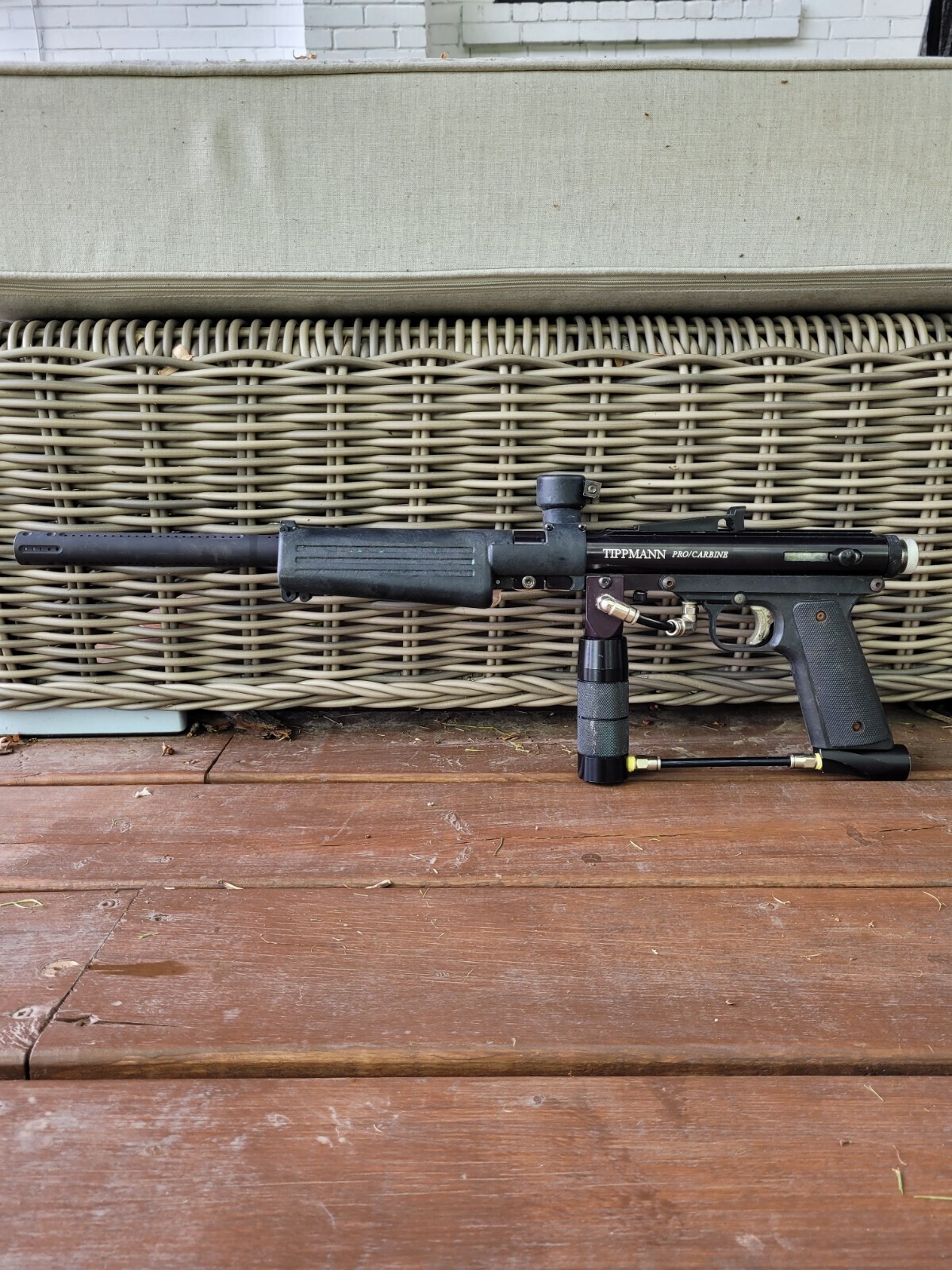

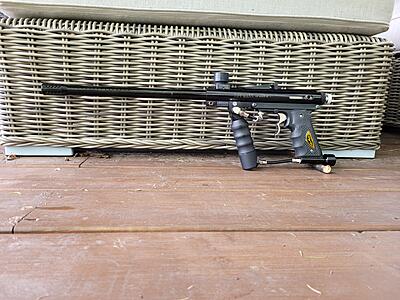

            I'll add another hot take.
            You could loan your pal a run of the mill, dime a dozen , plain jane A5 ..... or you could let your buddy rock an upped Carbine or Pro Carbine !!
            Here are a couple examples I put together to my preferences
            Click image for larger version  Name:	image_32625.jpg Views:	3 Size:	559.9 KB ID:	582477 Click image for larger version  Name:	image_32626.jpg Views:	4 Size:	548.9 KB ID:	582478
