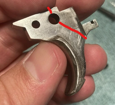

    remembering what i remember about these.. i had an idea looking at this pic
    if you were feeling creative with a drill press. you could drill and tap (for grubscrews) at about these angles to create an adjustable pull...Click image for larger version
    if memory serves, the required amount of trigger pull to function vs the amount given, if off by quite a lot.. there's a ton of post travel i recall
      BrickHaus commented
      Shrink tube on that pin also shortens pull easily.
    • glaman5266
      glaman5266 commented
      Ooooh, I like the heat shrink tube idea! Might have to try that before attempting any drilling/tapping.
    • Tracker
      Tracker commented
      shrink tube would also work, I would recommend doubling the thickness on the bottom of the pin (like shrink-wrap a shim on the bottom side of the pin), i a i accomplished a short term version with a strip of electric tape inside the hole (a long time time ago), i found that a piece thats long enough to be one layer on top for pre travel and 2 layers for post travel was a big improvement and didn't impede the function of anything
