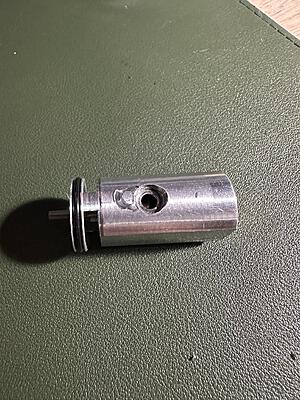

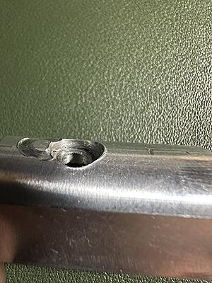

        Ok -- I FINALLY got this thing back from the field tech and took it apart. They ended up keeping my replacement O-rings that I left for them, so I have to buy another set.
        Looking at the actual valve body though... I'm wondering if the leak isn't caused by this "chip" in the valve seat. Looks like someone missed the valve when screwing in the air line. Do y'all think this would cause the leak, or should the valve seat o-ring be enough to stop this? I'm new to the valve-repair world so I have no idea.
        • Chappy
          Chappy commented
          Although it looks like there is enough of the lip left to seal, I’d say this is likely your issue. What does the top of the reduction fitting look like?

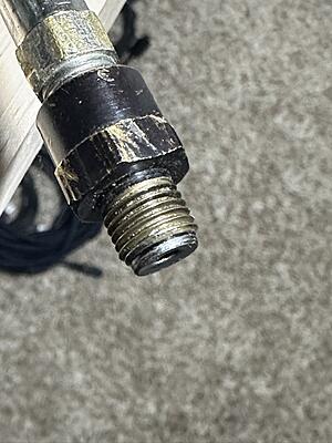

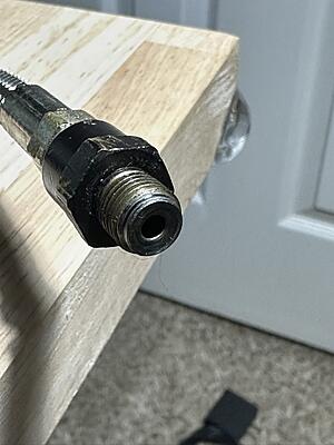

        Here are some photos of the reduction fitting tip as well
        • Chappy
          Overmoderator
          • 1308
          The reduction fitting end should be shaped like a nipple. I think that is your problem, that looks very flat. I’m guessing you could replace the reduction fitting and it should seal in that valve body.
