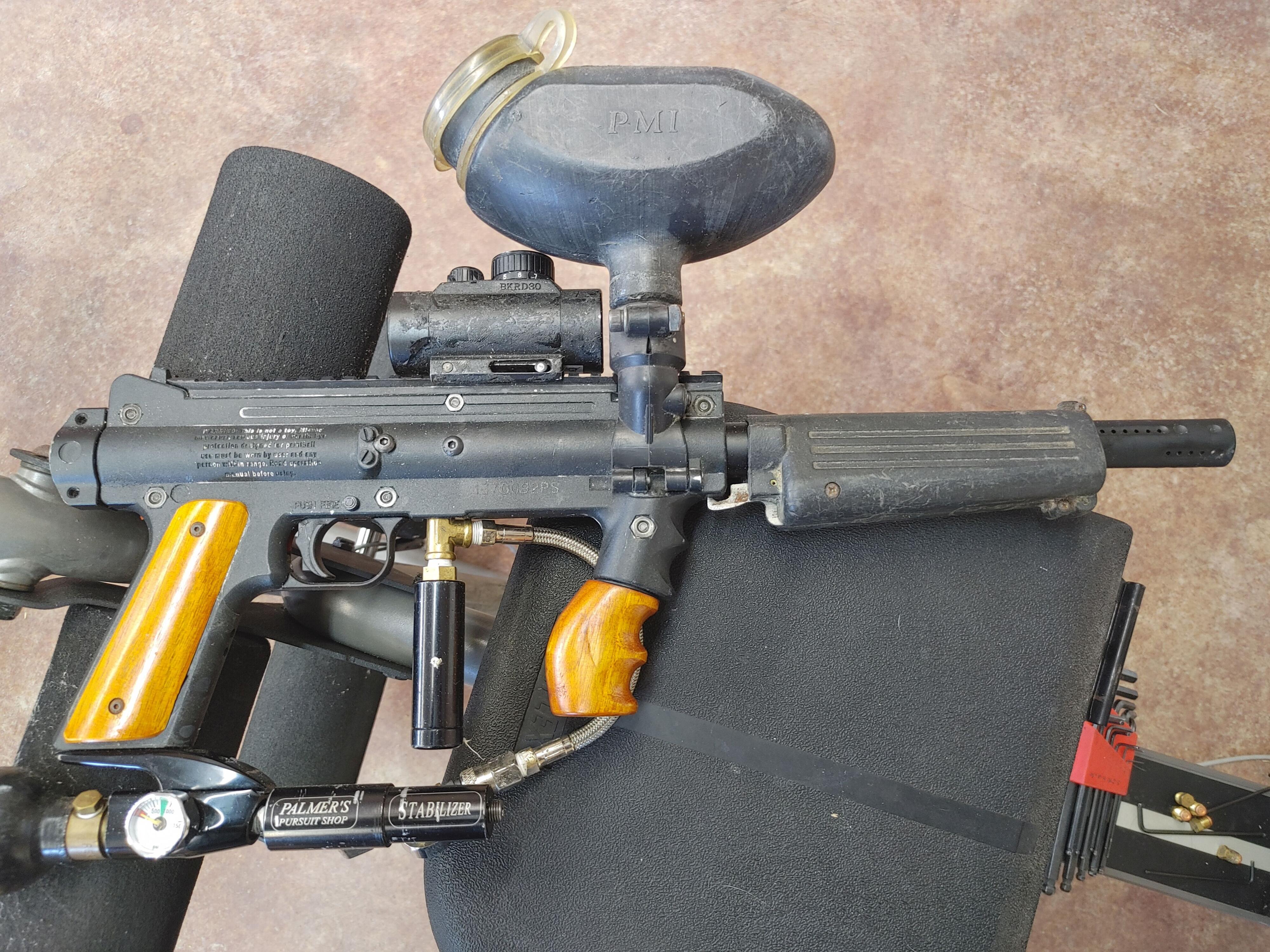

          In prep for the '21 paintball season I had my franken-98 out for cleaning and chrono this morning. It came in at 270-280 FPS with about 400 PSI input pressure on HPA and the lightest (blue) spring turned all the way in.
          I posted about the build on the old site, but just a reminder of mods / features:
          1. Palmer's reg (HP springs)
          2. RVA
          3. Spring kit
          4. polished shells
          5. DIY lightened hammer
          6. TechT light valve spring (actually cut a few coils off)
          7. DIY volumizer (gutted and jb welded LPR)
          8. TechT Trigger Pin Kit
          Don't think I'm missing anything there. I don't believe I have opened up the valve flutes, though I do remember toying with a valve...maybe in my other 98? I know I messed one up and had to chuck it.

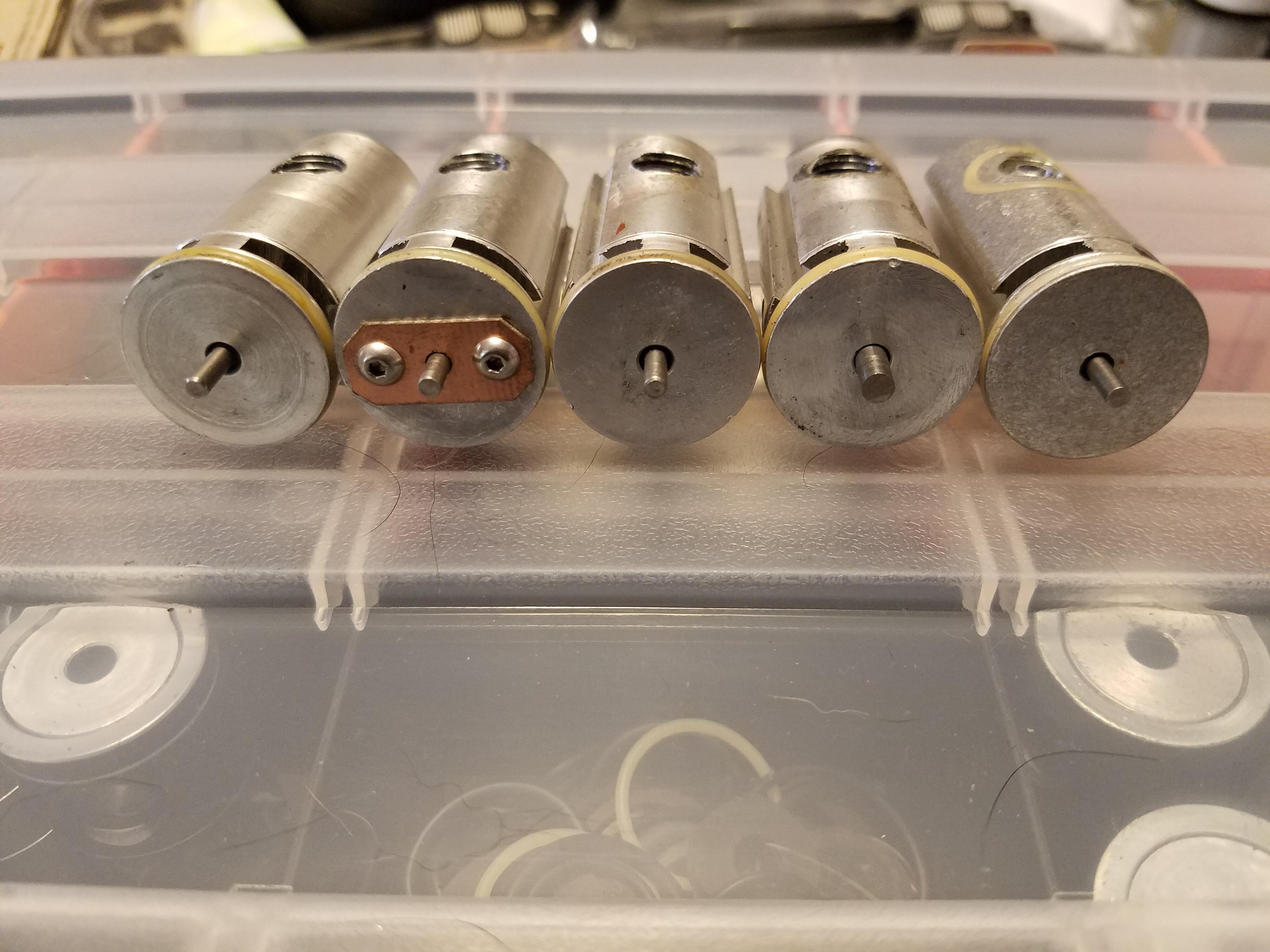

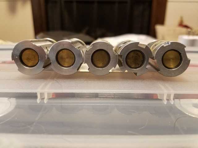

          The valve pin hole and the flutes on the valve of the LP valve are different. Here's a pic, I downloaded from here I believe, before the death of the old board:
          To be honest, I don't remember which is which.
          Anyways you can DIY this. Because this is a balanced valve, I'd highly recommend that you lighten the hammer, lighten the valve spring, install a reg, and install an RVA (and preferably spring kit) - or don't do anything at all. You need to lower the magnitude on both sides of the balanced valve equation to be able to lower pressure.
