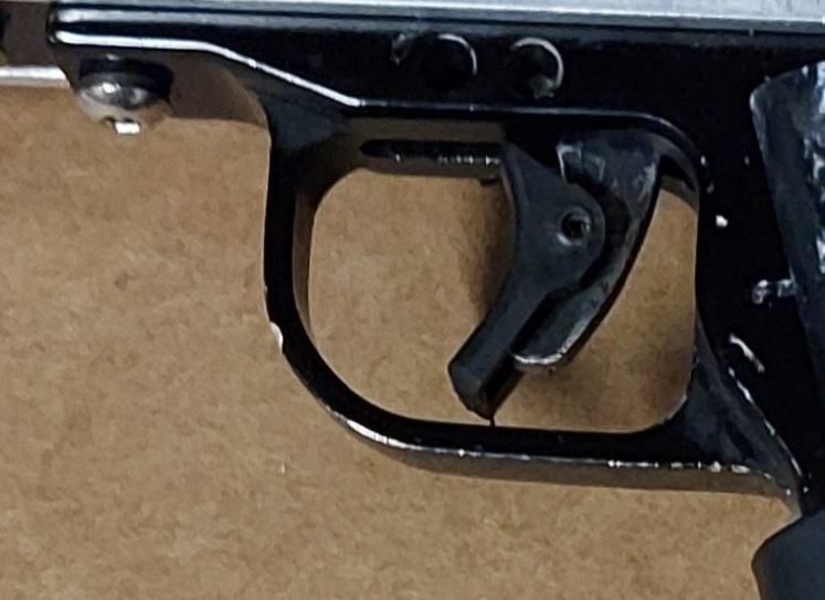

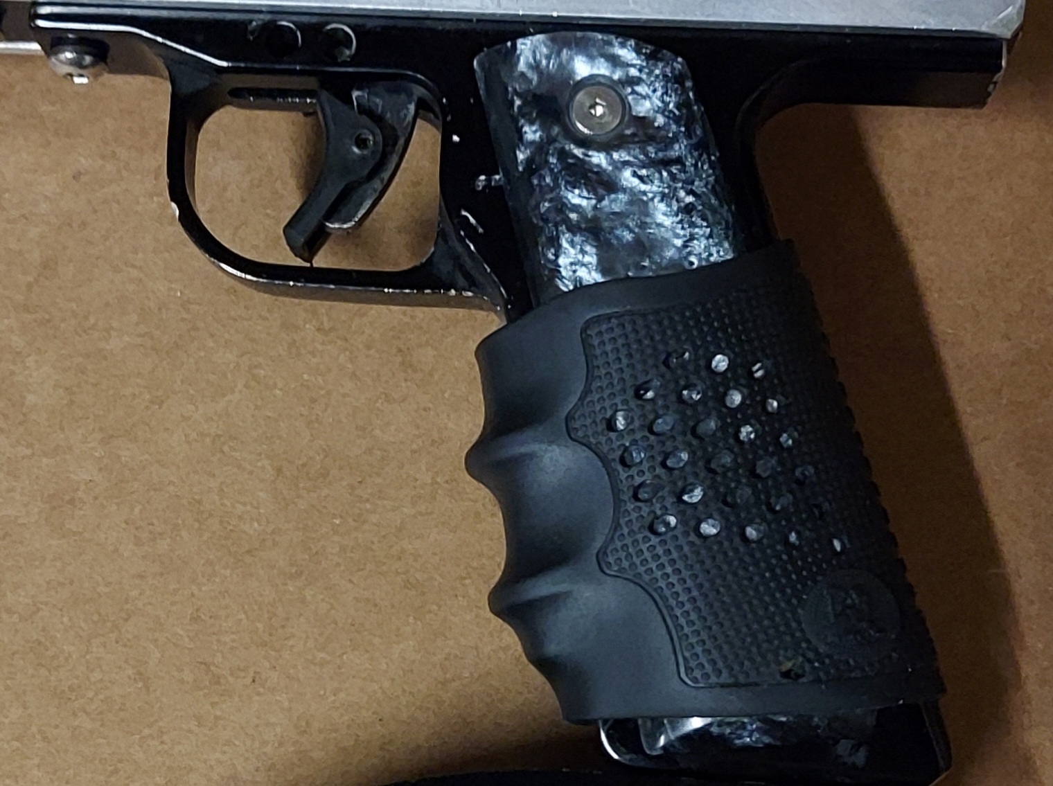

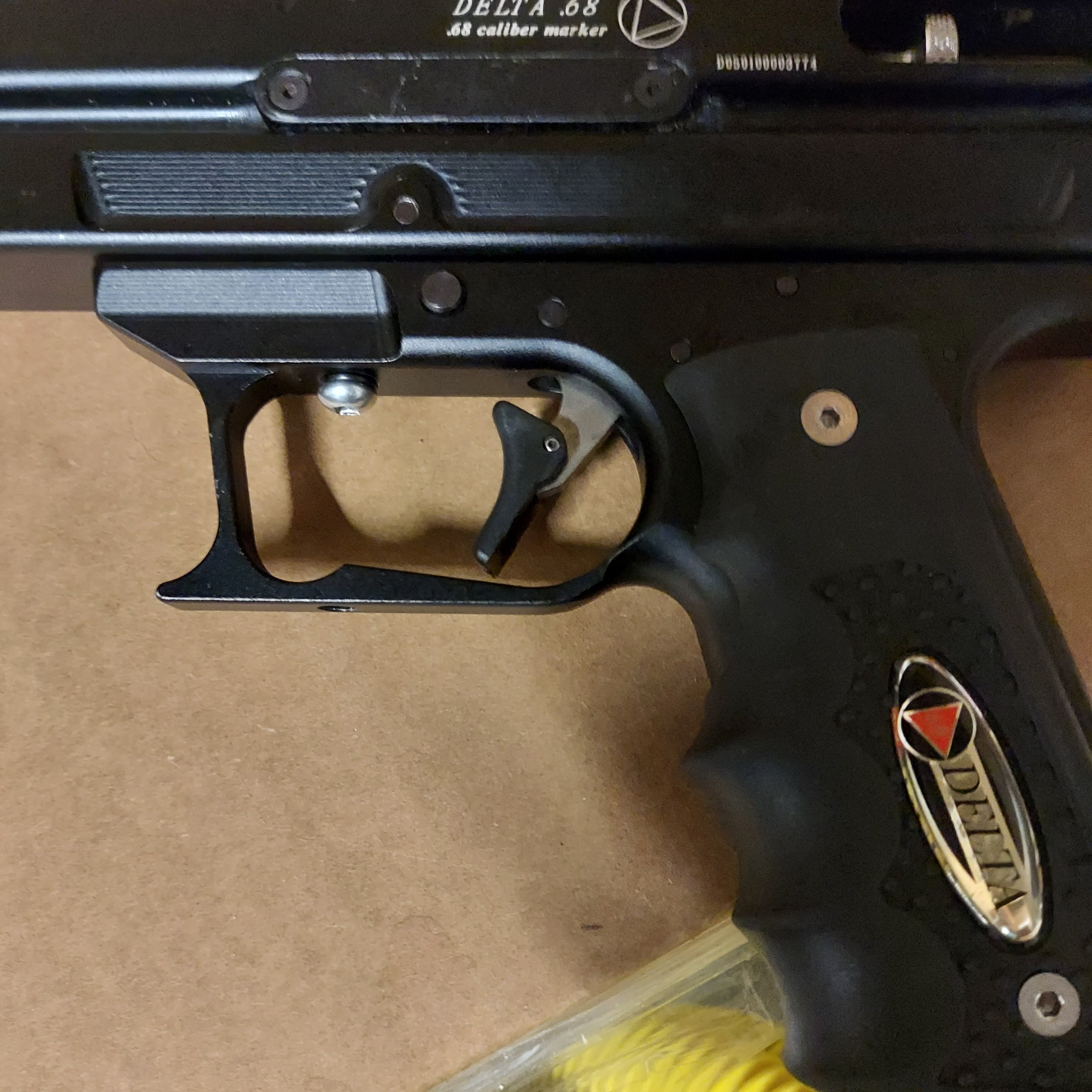

    If you have an old PT Xtreme, PT Enforcer, or Delta 68 and you've been wanting a trigger shoe on your VM here's a simple mod you can do yourself to make the PT trigger shoe fit the VM securely. Take the trigger shoe off the PT frame by screwing the screw that holds it on, drill a hole through your VMs trigger big enough for that screw to fit through, and install it in place. If you have a stainless trigger VM it's not as easy to drill through as the later black triggers are and if you have a black trigger one you need to grind the sides of the trigger down enough to remove the so called built in trigger shoe they come with.
    The result is a very wide comfortable trigger.
    Couple this with a Shocker frame and it makes for any extremely comfortable set up
