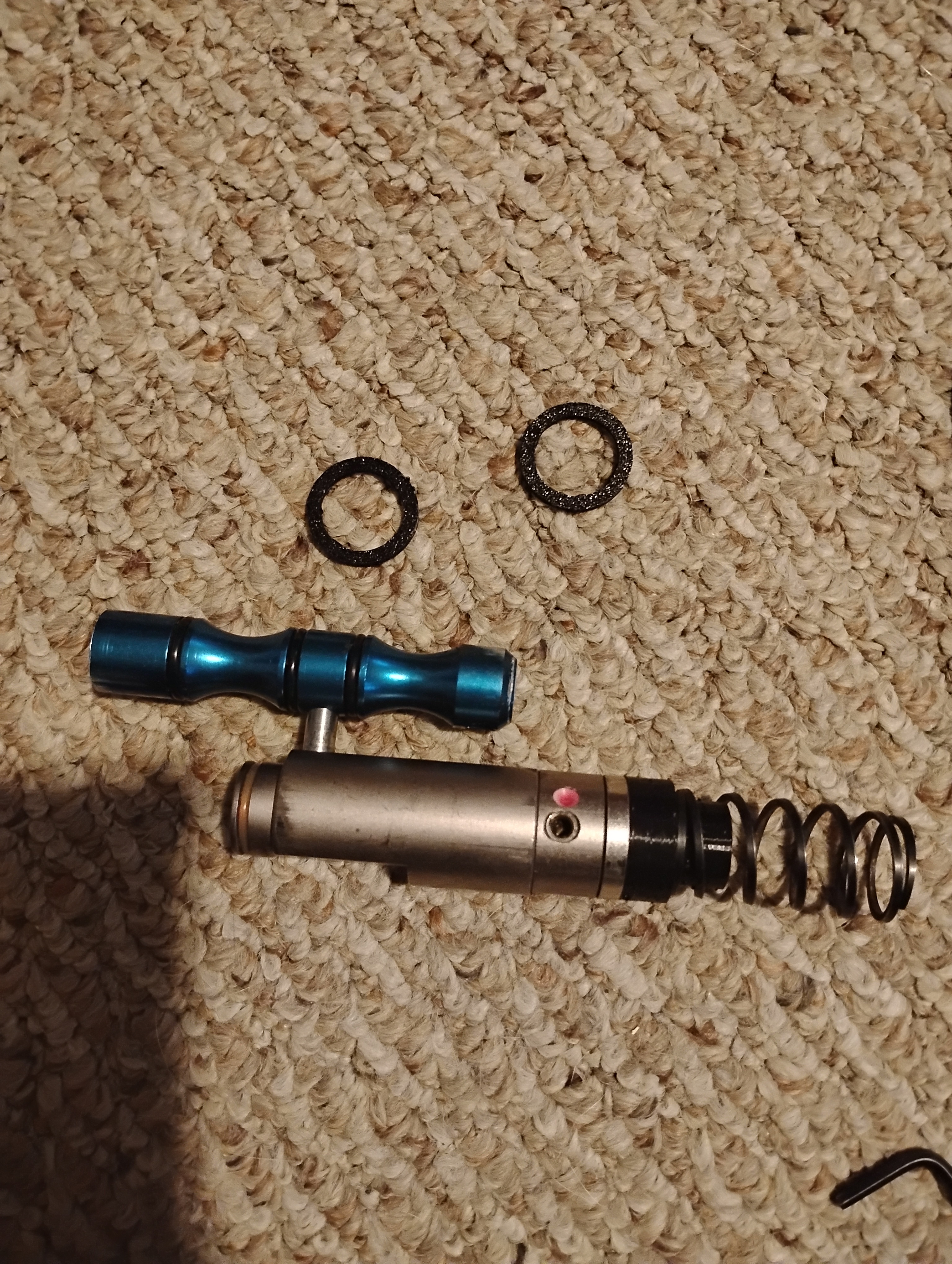

                      So I printed up.a few automag spring conversion.pieces today. Took me some back and forth to get enough preload on the spring so it wasn't tapping the valve pin every shot. I ended up making the bumper with 10mm of shoulder for the spring to ride and a few 2mm spacers just to fine tune later. I think it's shooting a little hot but without a crono I am only guessing. Kick is much lower but still there. I only had one extra agd spring too so I can't fit it to both guns yet. Should have grabbed a few from Bacci when I ordered but I wasn't thinking about it.
                      On a side note my detent solutions for using the cyclone boot are not turning out so well. They either work too well and hold the ball in the wrong position or they keep getting caught behind the bolt itself and jamming. The tinkering continues.

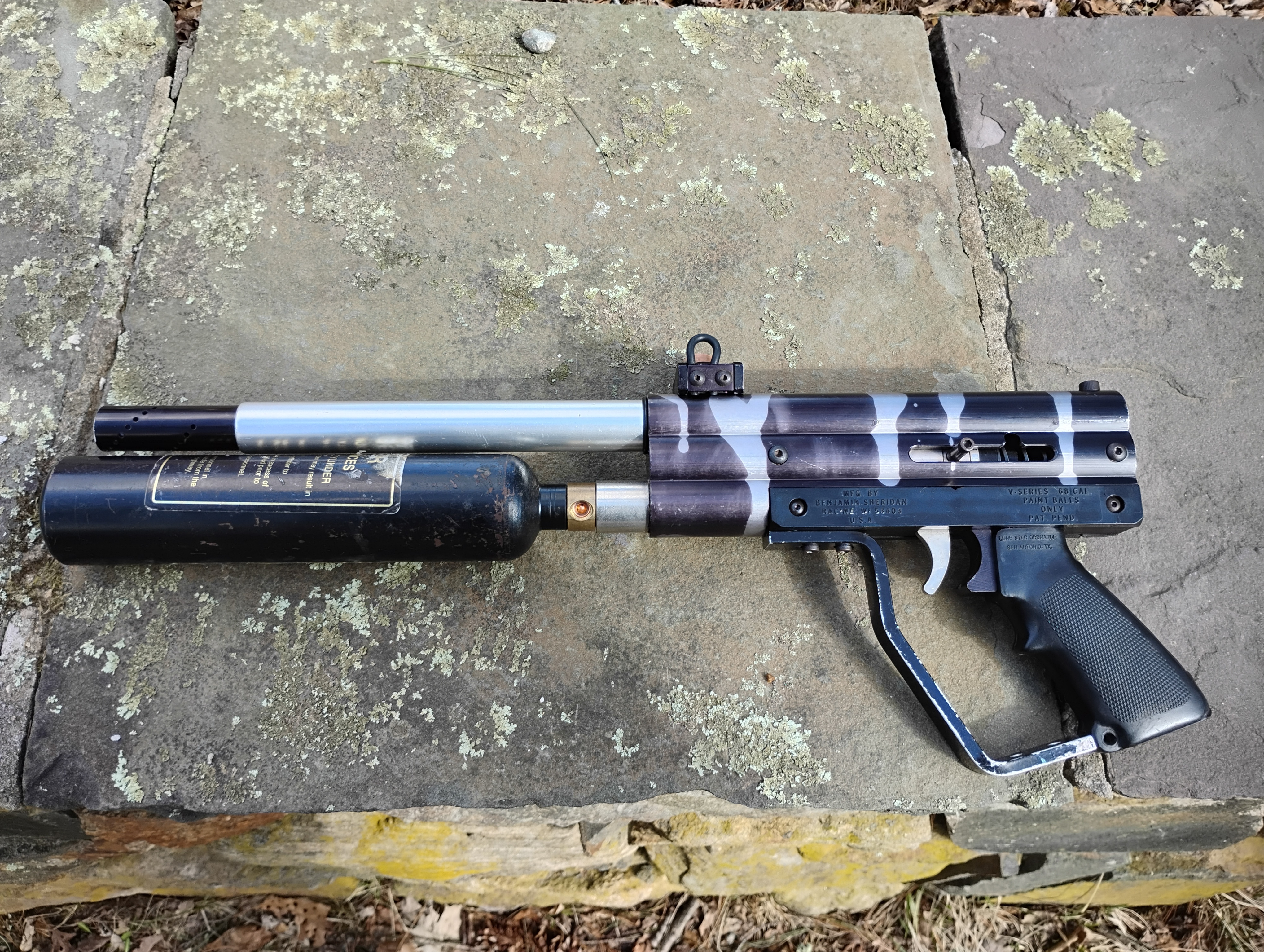

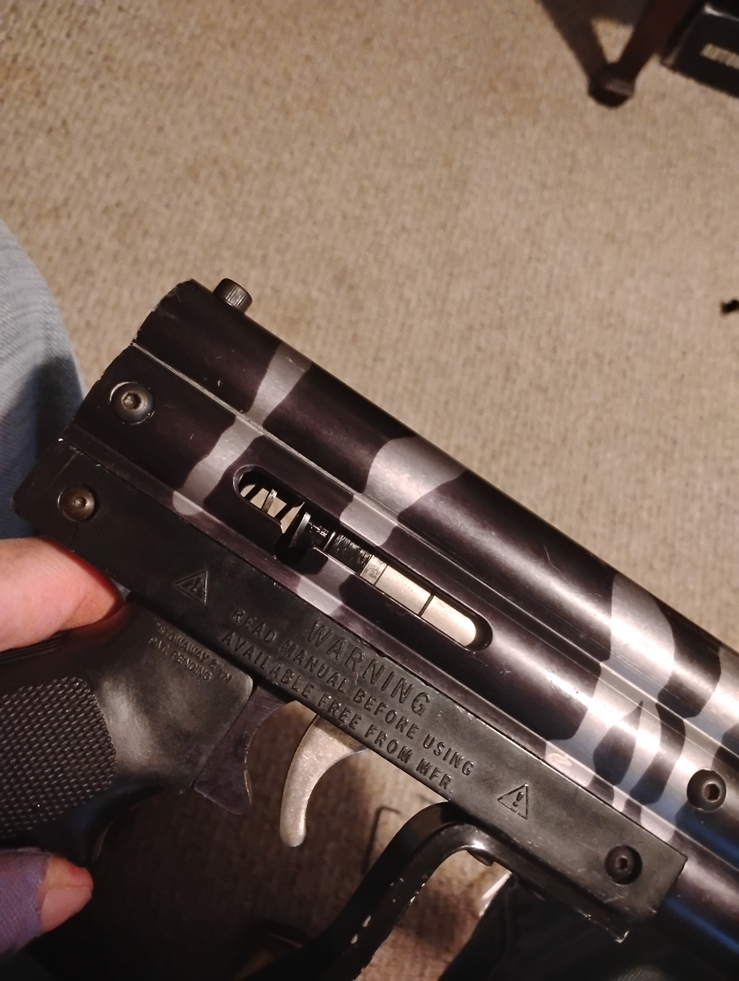

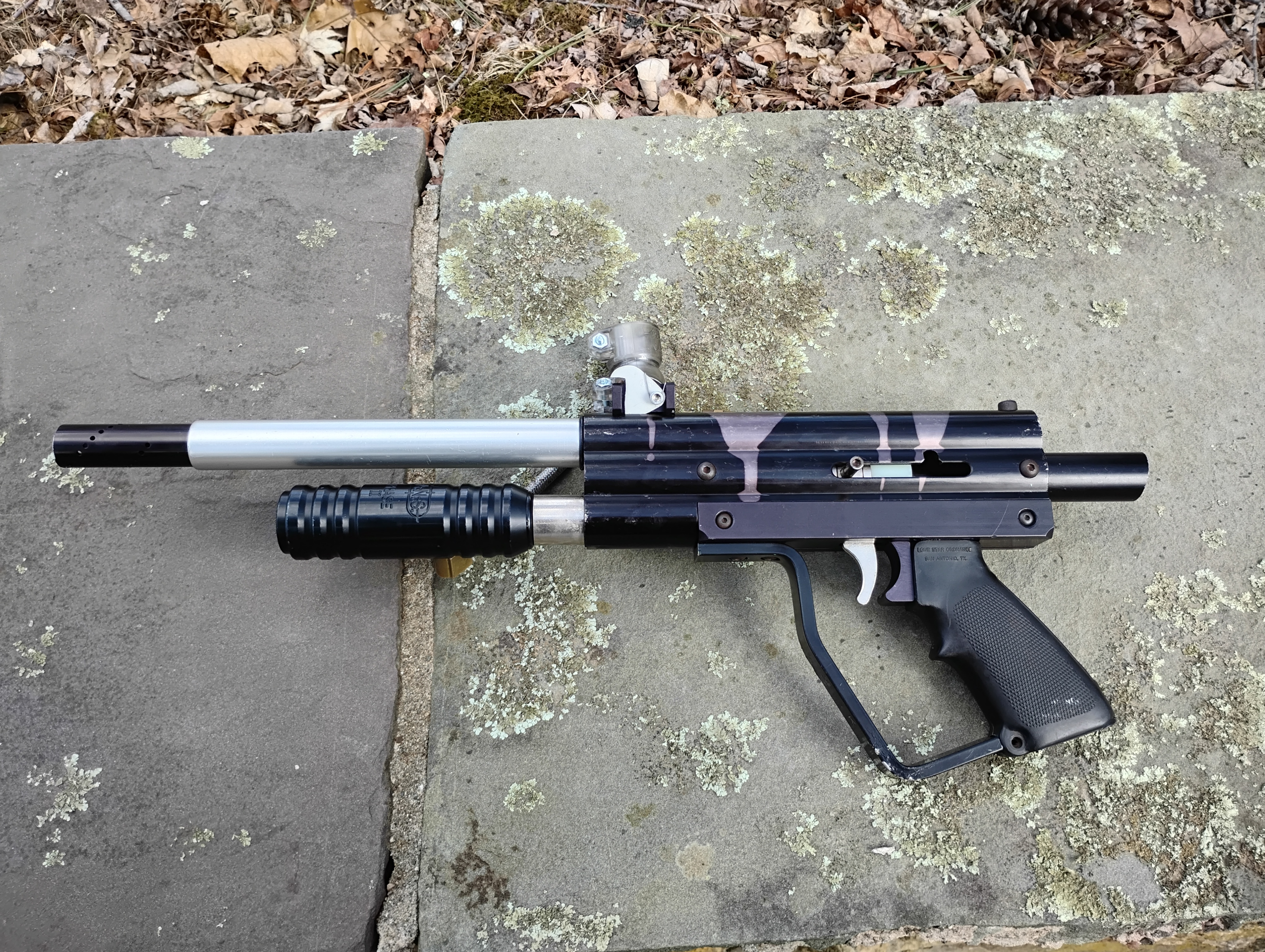

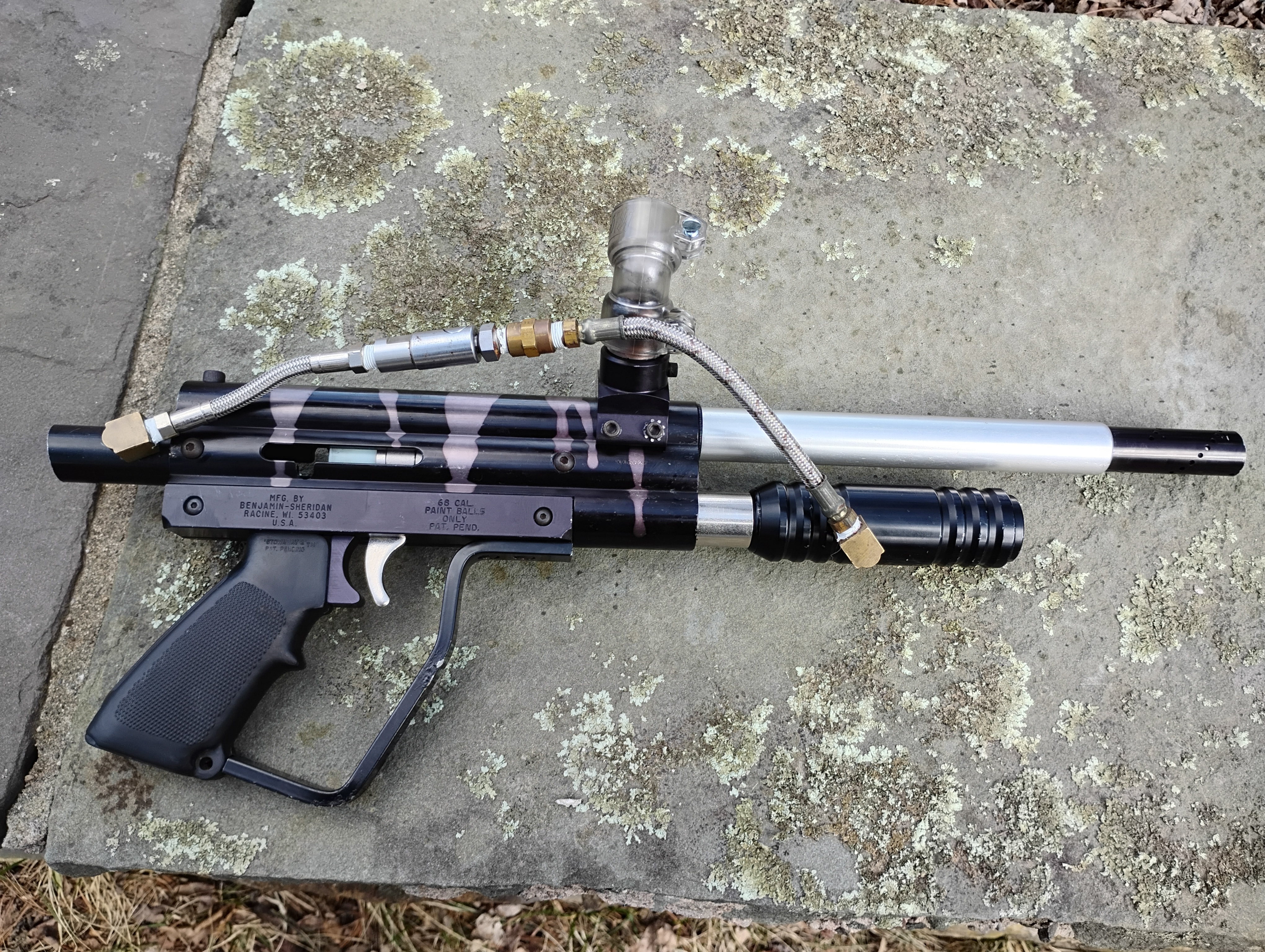

                        So one gun is more or less done. I believe they refer to it as the terrorist style. I had to rebuild the and phase 2 expansion chamber a couple times before I got it right so I blew most of my air. It fired well enough while leaking though. I didn't do the automag spring conversion on it yet because I want to see what it's like to shot before and after. Bacci hooked me up with a bunch of old agd springs so I can make as many kits as I need to now until I find the perfect set up. At least with the back bottle setup I can run it on 20oz CO2 if the Hpa doesn't work.
                        Second guns is working ok for now. I've managed to collect a bunch of older 9 and 7oz CO2 tanks so I can run the front bottle setup with some degree of confidence now. I will have to use one of my pod spots on the belt to carry extra CO2 tanks. I don't think I will get tons of shots per tank.
