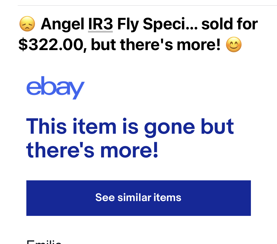

              Speaking of which, I was outbid on this IR3 earlier tonight, wound up fetching $320+
              https://www.ebay.com/itm/15502131563...mis&media=COPY

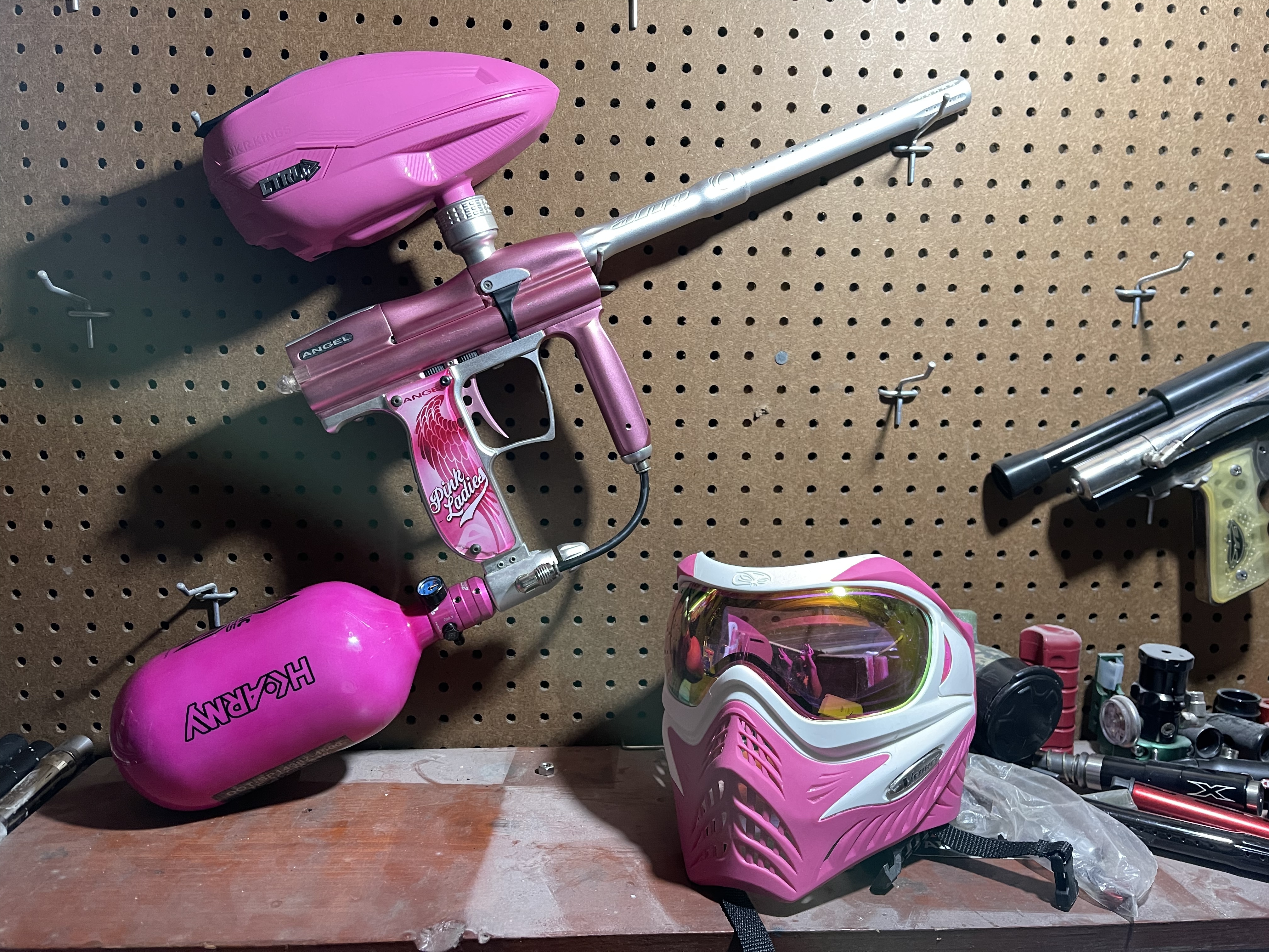

                        Originally posted by Riot
                        Enoch board solves the battery issue. Love my Speed’s.
                        Ayyyyyyyy! Those are the grips I designed for you. They look great on the marker!
                        • Riot
                          Riot commented
                          Not me, I bought the marker as it sits! Nice grips though!
                        • eljimmy
                          eljimmy commented
                          Ah ok. I'm a graphic designer and was hired to design the grip graphics. Thanks by the way! Glad you like them.
