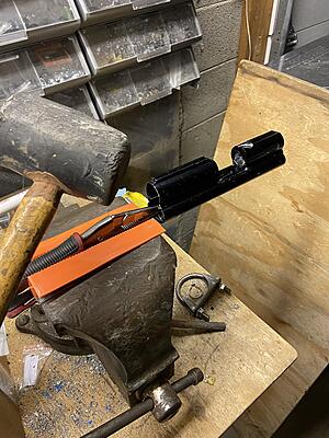

              And then in 1 extreme case had to use a war hammer. This was on an Angel that must have slept in a puddle for 20 years.

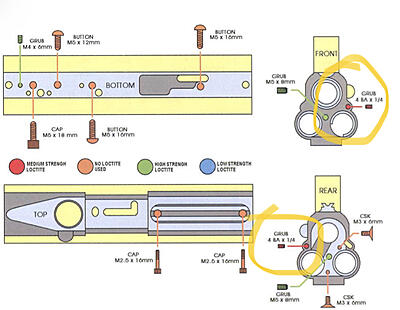

                  The breech rod down the driver’s side is 2 rods. The front one pulls out the front and the rear out the back. After removing the 2 set screws circles below.

                    Wait, the end of the rod has an M2 female thread in it used to pull it out?? What an unnecessarily difficult design when the rod could have just been drilled all the way through...
