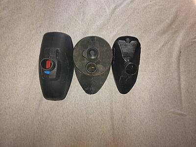

          Originally posted by un2xs
          For anybody who actually knows, what are the differences between these two hoppers besides size?
          The Dust Devil is slightly wider but shorter length wise than a mini pals. Picture has a JOLO in there too. The V mech looks massive. I haven't seen one but it looks like a full size hopper and all of these are minis. A full wind on the v mech won't get you through a full hopper, the DT1 will. The V holds 160 I think where as a stock DT1 holds like 50-60.
          The actual mechanisms in both are different. The DT1 is damn near silent, from the videos I've seen of the V it sounds super loud and can popcorn. The Dust devil uses a feed tray kinda similar to a Z2, at least in an abstract way. The V mech uses an auger. Also the DT1 is wound Clockwise, where as the V is wound counter clockwise.
          The V has an indicator for how much you've wound it. The Dust devil does not. It's not a big deal though, at least IMHO. The Dust devil needs some extra grip on the knob, so I took a wood burning tip and stippled it. It's kinda a PITA to wind in a low profile feedneck, and won't fit on some where the collar can't rotate.
          Also the knob on the dust devil has some kind of disconnect gear for the knob, so It doesn't spin when you shoot it. The V has its little handle twirling in your face.
