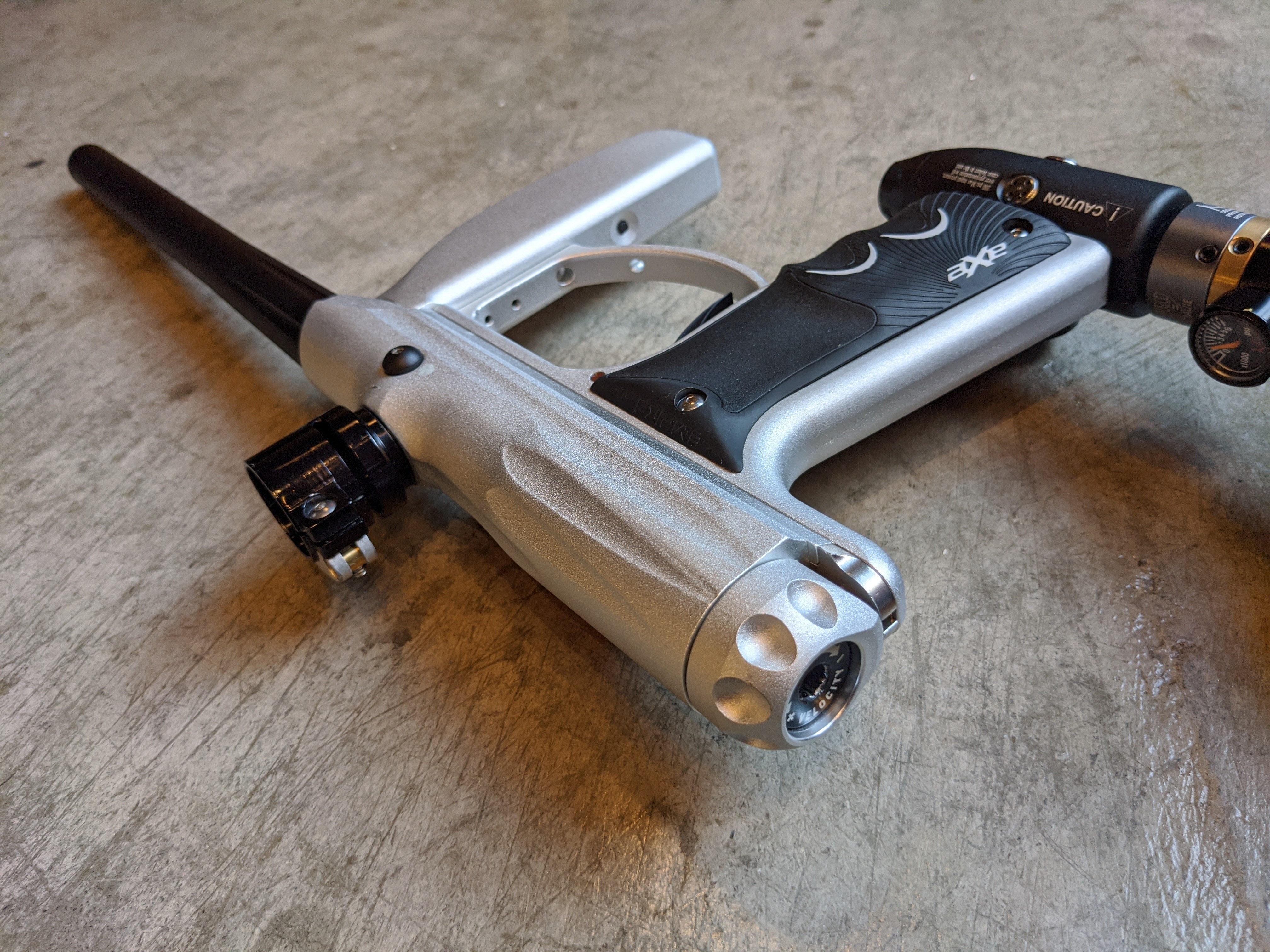

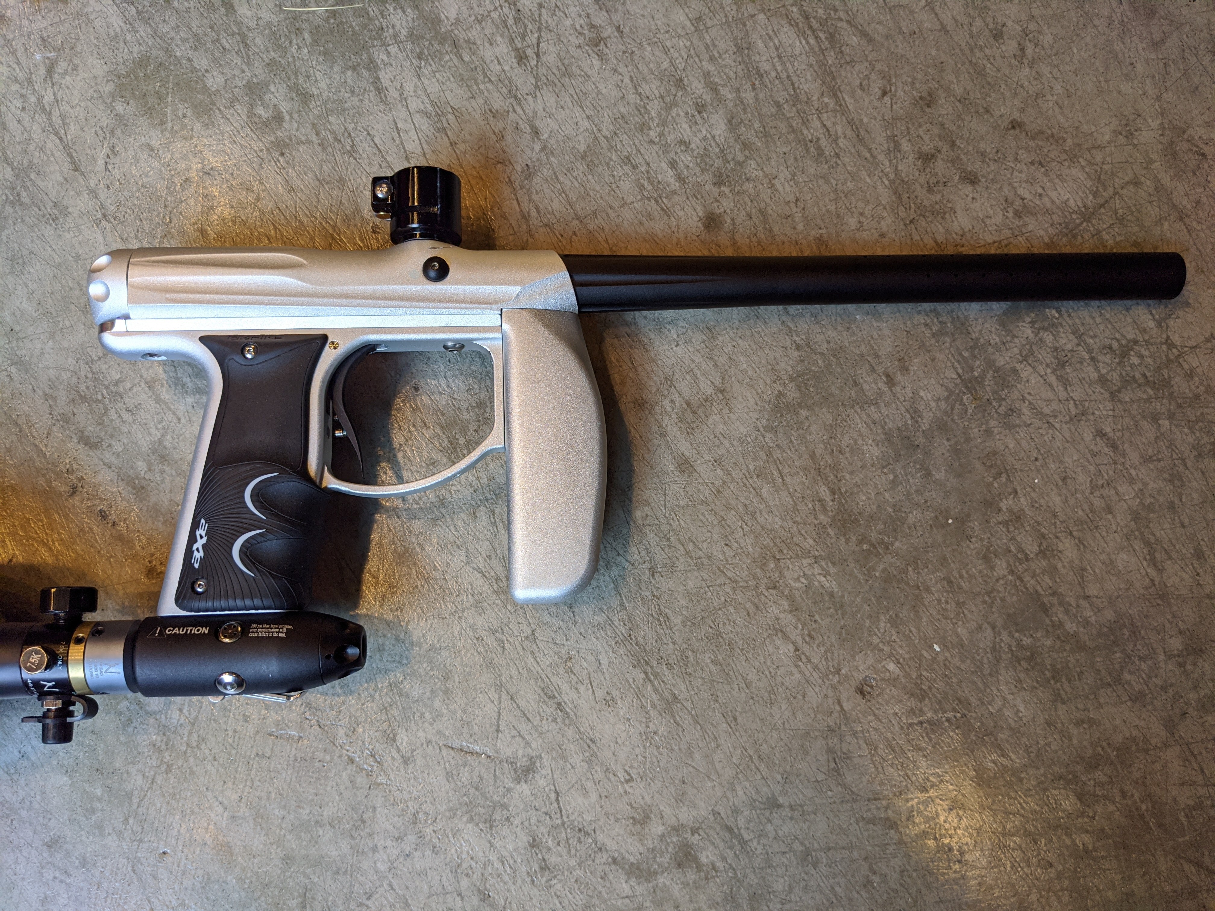

                Took a while to scrub off the paint stripper but after a few scrubs and a nice soapy bath...
                This... Is cleaning up way nicer than I expected.
                Looks to be factory clear/silver anodized and it has held up really well.
                What do we think - Stock rebuild or think about a fun anno? Either way I'll get it rebuilt first to factory and mechanically dialed in.

                    Rebuild coming along well so far.
                    Started with a new capacitor on the Shockwave board for good measure.
                    All new seals, new poppet tip, and will probably swap out a few of the screws that had one to many ugga-duggas when tightening.

                      All cleaned up, assembled and tested. It rips!
                      With small reballs in the big bore factory barrel chrono string was:
                      292
                      286
                      289
                      285
                      291
                      289
                      Pretty darn good!

                          Man that has a sleek cleanness to it. I would say just leave as-is and enjoy! But you could also go pretty crazy with anno, whatever floats that boat of yours ;-)

                              I have way too many invert mini's, and this is my first AXE. has a nice feel to it, though its got some weight. Anyone have a Inception FLE body for sale?
                              Tempted to anno it bright orange, and laser "RENTAL" on the side
