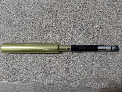

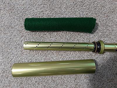

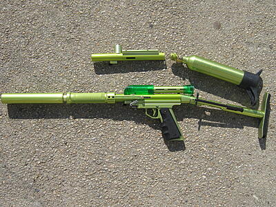

        I used a Smart Parts All American and a "silencer" for airsoft. Someone on here was selling the tube and threaded end caps(dont ask me who,all info was lost in the crash). I drilled the caps for the barrel tip. the front has an o-ring glued inside so ti doesn't scratch the barrel, the back of the cap has a plastic sleeve glued in and teflon screws to tighten it to the barrel.
        the outer tube threads off if you need to clean the barrel with water.

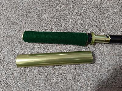

          With the all American freak tip it is easy to cover this https://iisports.com/products/tac-5-...12428634521661 to work just need some longer set screws and a little bit electric tape
          for the foam around the barrel I chose a washable air filter that I cut to fit
