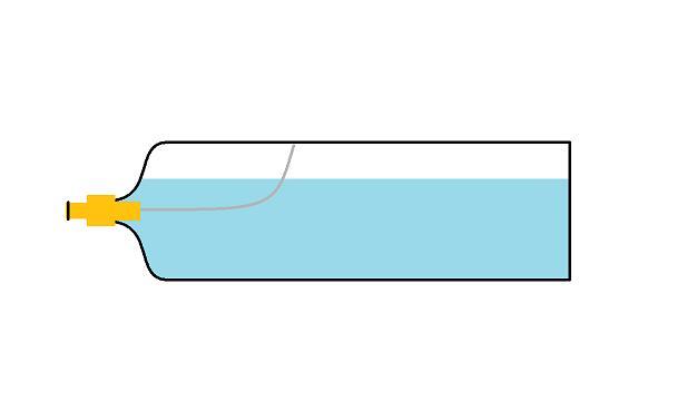

        First, the anti-syphon tube MUST be bent. A simple straight tube does, well, nothing. The picture below should make it obvious why. Screw valve into the gun it's going on, bend tube upwards, install tank to valve. If the gun it's being install on has an angled down tank you'll want to bend the tube so the end is closer to the valve. Once the valve it torqued down good and tight mark the tank or valve with some paint so you know which way is up if you go to use it on a different gun. You should be able to unscrew a tank from the gun's asa about a half turn or so and still have ti seal to position the tube in the proper orientation.
