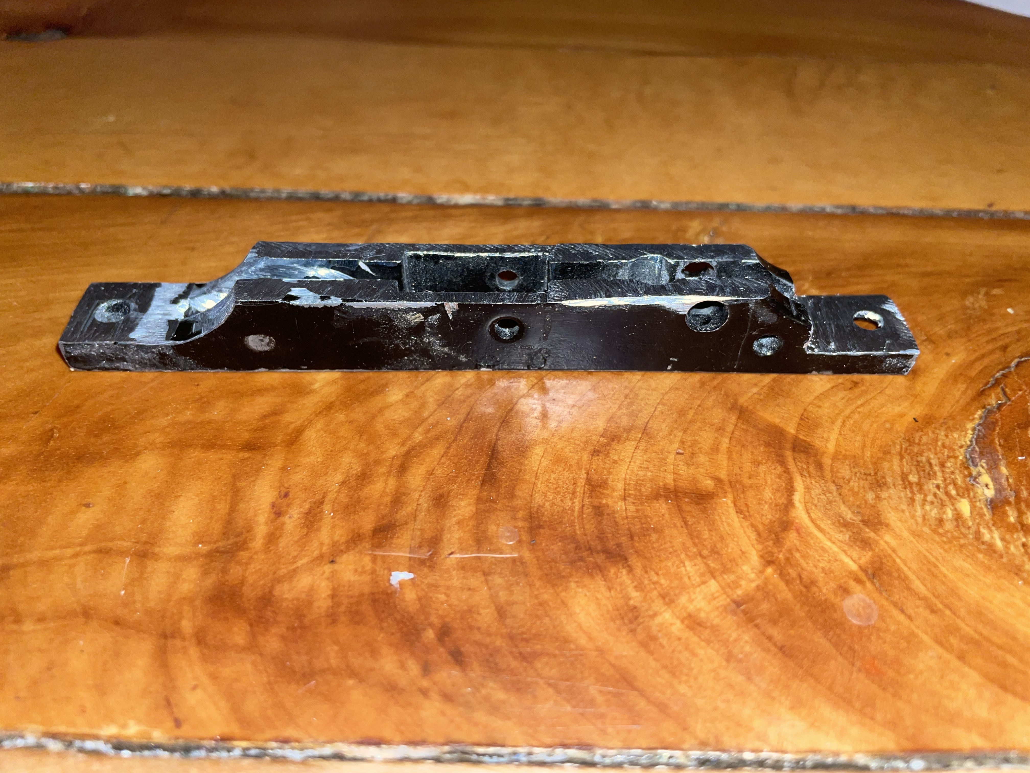

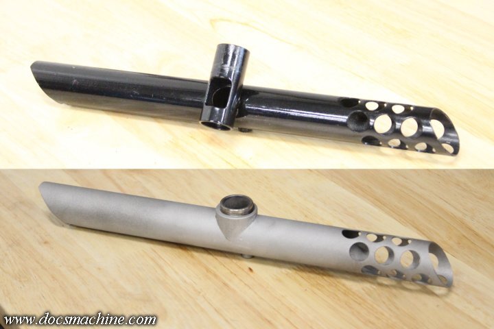

              Customer wanted a copy of an oh Pawlak mag rail. Think it came out well considering i just had pics to go from.

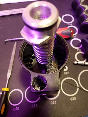

                Today, Im trying to break the edges in my OG Havocs HPR bore. Im hoping to get this bad boy reliable.
                  BrickHaus commented
                  I think I got it. I am out of air to really test it, but I was able to make piston stroke considerably smoother when actuating by hand.
                  I've ran 3x 12ies through it. All three have cycled properly twice and didn't have enough juice to reset the trigger a third time, not a total acid test, but Im fairly optimistic.

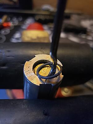

                This 98 is my best friend's cousin's shooter. It was given to me like 4 years ago to fix. He said no rush in my defense. 4 years ago, I noticed the power tube bolts were sheared off, and I never did much with it.
                Today its gonna get a full clean and hope it works after the fact.
                I think Ill add a second 98 to the box when I return it to the owner.
                • lhamilton1807
                  lhamilton1807 commented
                  Is that an aluminum power tube? I bought one of those years ago and decided to just take it out. The sound signature was just way too loud for my taste. And this is considering it was in a T98 in the first place…

                    I have one leaky T98 valve that needs new urethane rings. Gotta crack that bad boy open. I sure wish they had put C rings in those instead of the spring clip.
                    BrickHaus commented
                    I know, they are such a PITA. Its been years, so I kinda forgot about that part. This one seems to have had a flake of something that was stuck to the cup seal face. The urethane o rings may need a swap too, but Im not sure. I was just told it needed work. Ive been scraping loctite out of the valve for a bit, but I gotta do some house chores for the wife. Then Ill finish my 98 project today. ( at least clean, grease, and re assemble to see what o rings need replacing.) Im contemplating upgrading him to a metal power tube I have too.
                    Im also going to add a 2nd 98c to the box when I mail it to him.

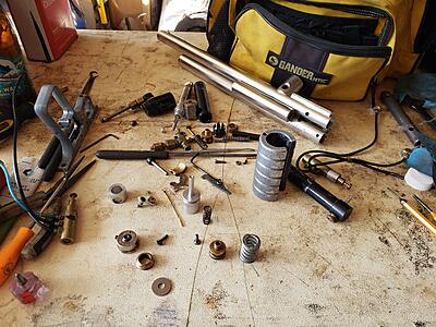

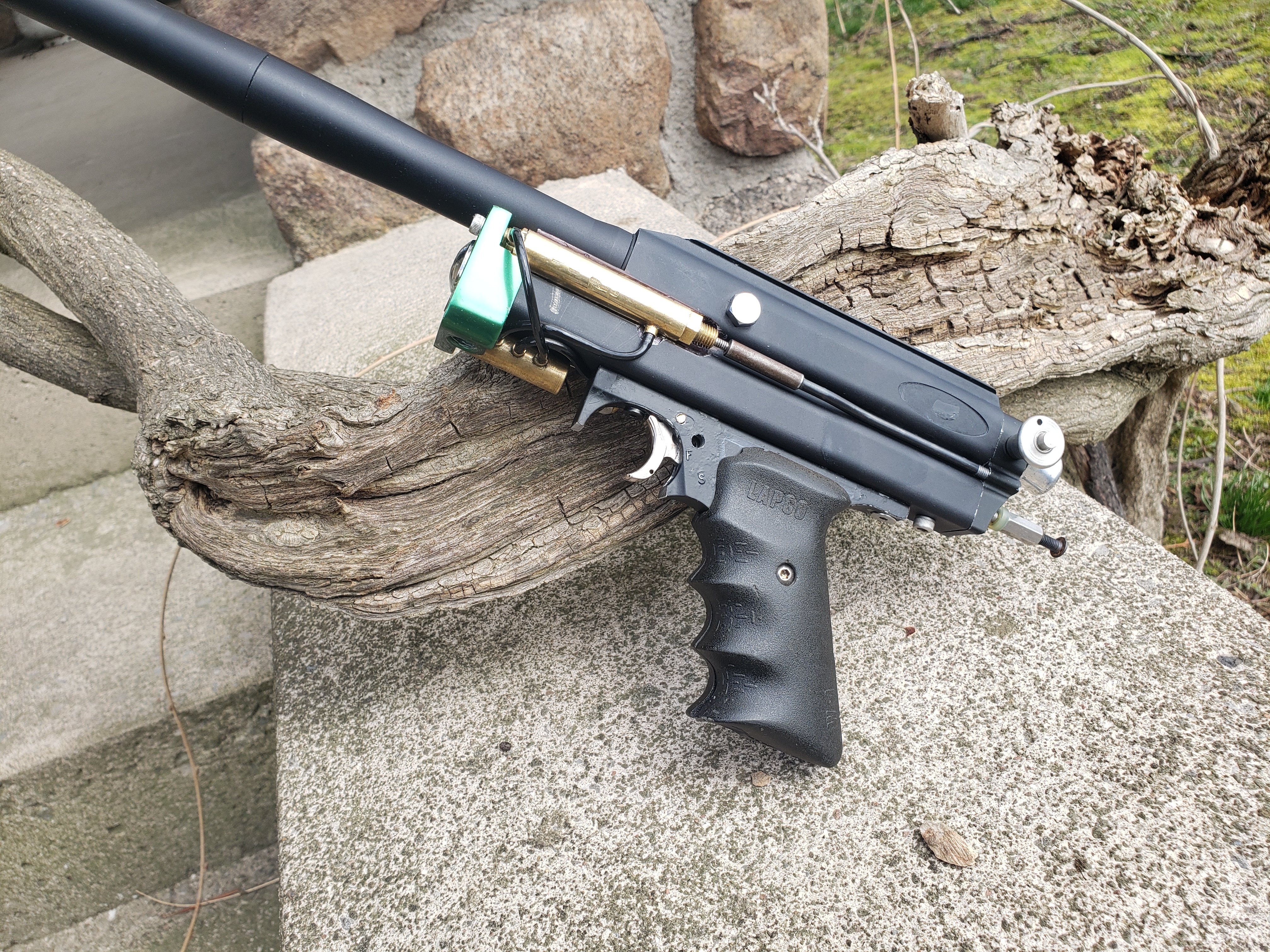

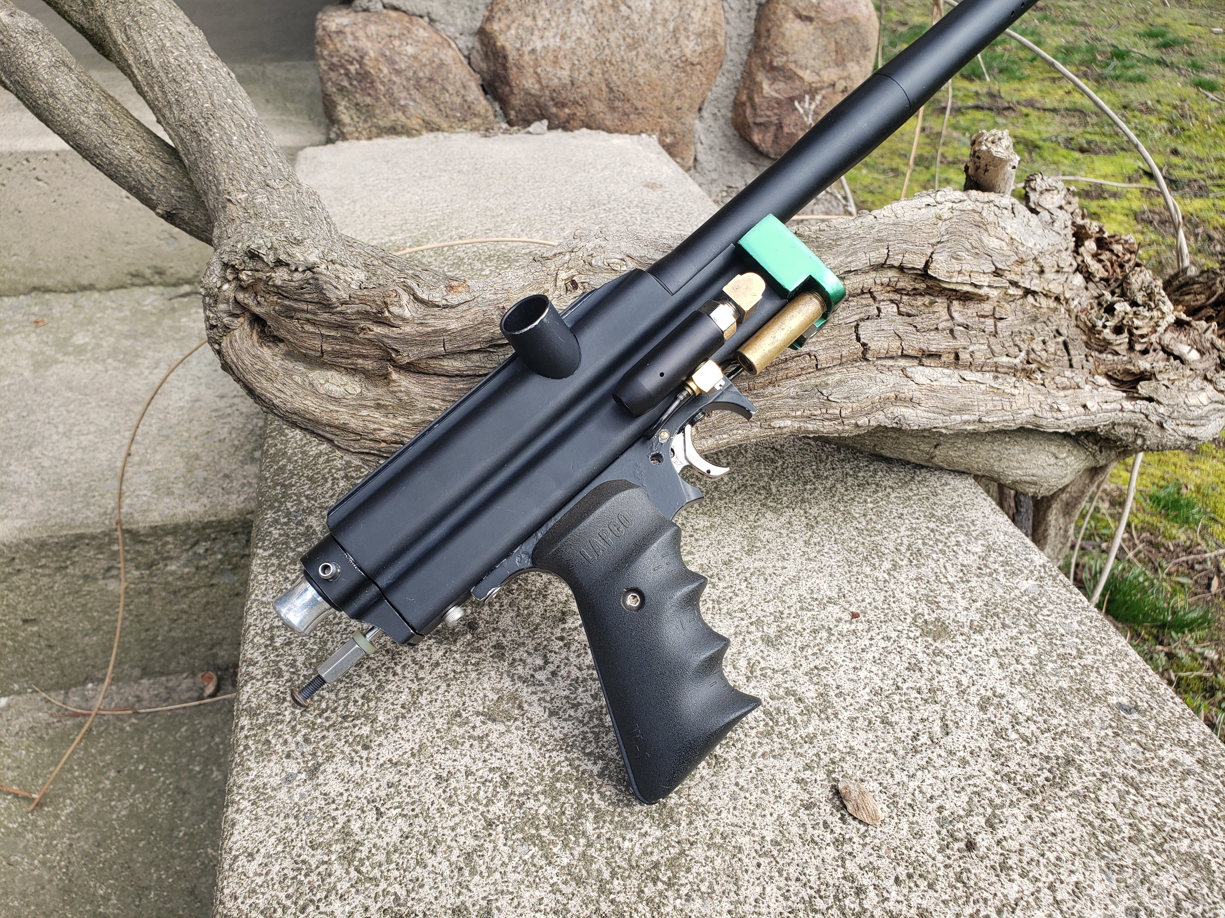

                  I started the homebrew PA Sniper I've always wanted - well, what I really want is a Brad Nestle SHO but I never see them for sale so this is the next best thing I guess.
                  I need to source a new frame and decide on what pump kit I'm going to chop up to fit. 🙂
                  • WORR13
                    WORR13 commented
                    ooo this is lookin cool already. hows the rear of the ram mount? floating?
                    Jordan commented
                    WORR13 I actually had to build a ram out of parts from two different ones.... there's a threaded nose on each end so I could reverse mount the ram using a stock front block.
                  • devilzcall
                    devilzcall commented
                    That's smart

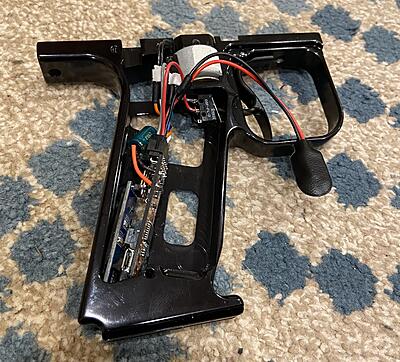

                  A frame came in the mail today so I jammed a solenoid, microswitch, and Morlock in there. Programmed it to match the Eblade’s fast mode. Still have some work left to do before it’s ready to bolt to an autococker.

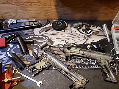

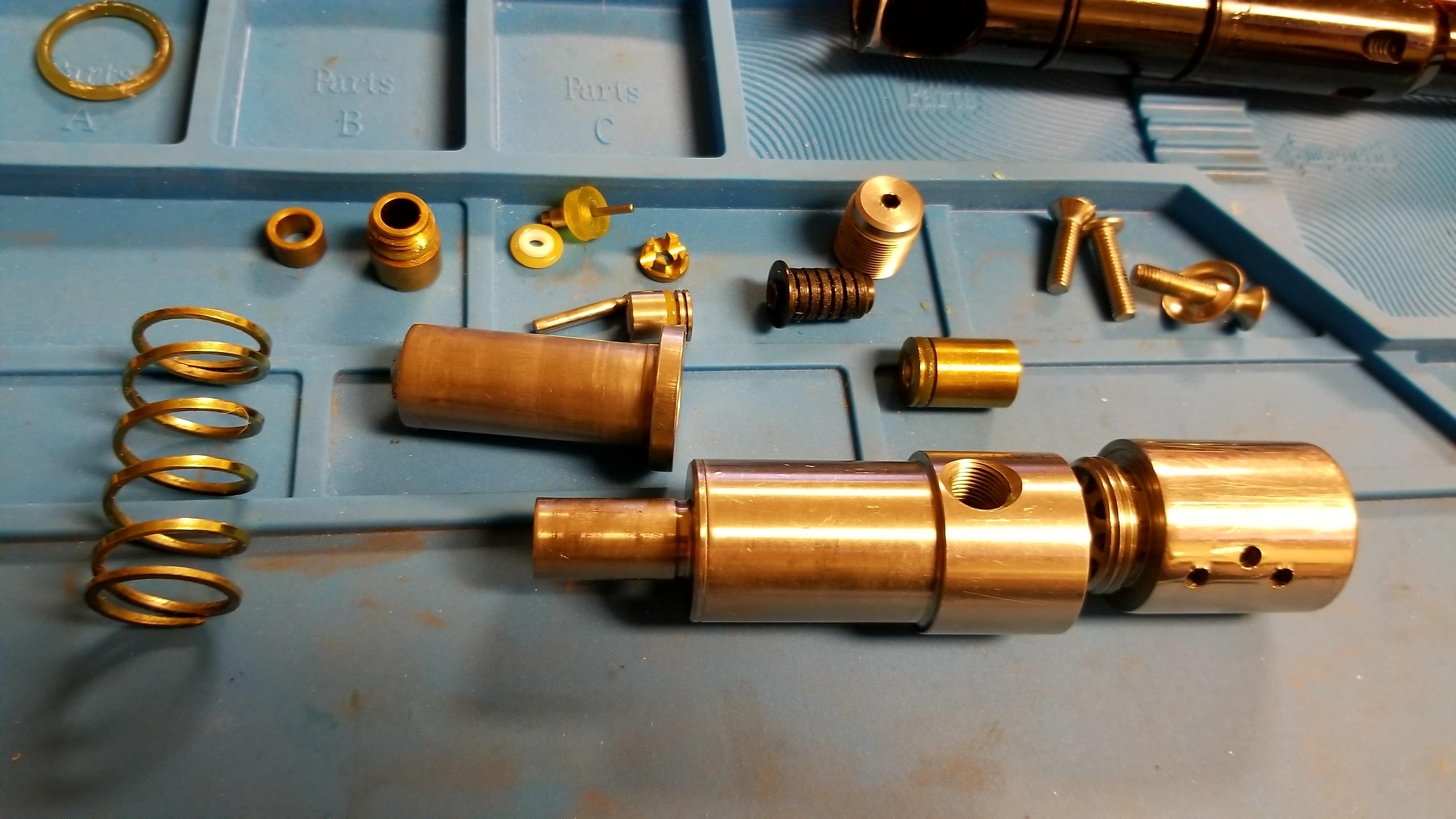

                      We didn't get this one live last night. Like many pps guns we disassembled and reassembled til we were too tired to work.
                      This was the stroker I got for cheap that changed hands 3 times in a few months. With the epoxied LPR body.
                      Early pps stroker job, P527. half of the lpr was pulled out when I got it so we didn't get to see how that went together. There was an extra sheridan valve in the mix so that was confusing.
                      I disassembled and cleaned everything while boomer finished my other stroker. It took time to chisel the epoxy, or super glue out to free the lpr body out. Then it all got a simple green bath in the ultrasonic cleaner.
                      There was stripped air lined what the ferrule soldered to the fitting on. There was random crap stacked in the tubed to seat the lpr, so I dont think Id have gotten it trying to put it all back.
                      Once boomer was done with my other stroker he said he would take over on this one. Thats when it was this pile of parts. We laughed about it.
                      There was a lot of weird stuff going from a relief in the hammer face (assuming to lower velocity band) to how the trigger assembly was built.
                      But at the end of the day we aired it up a few times and the lpr wouldn't shut off so we still have work to do.
                      We did however get it to hold air ( if you plugged the lpr output) so we dont need the epoxy anymore.
