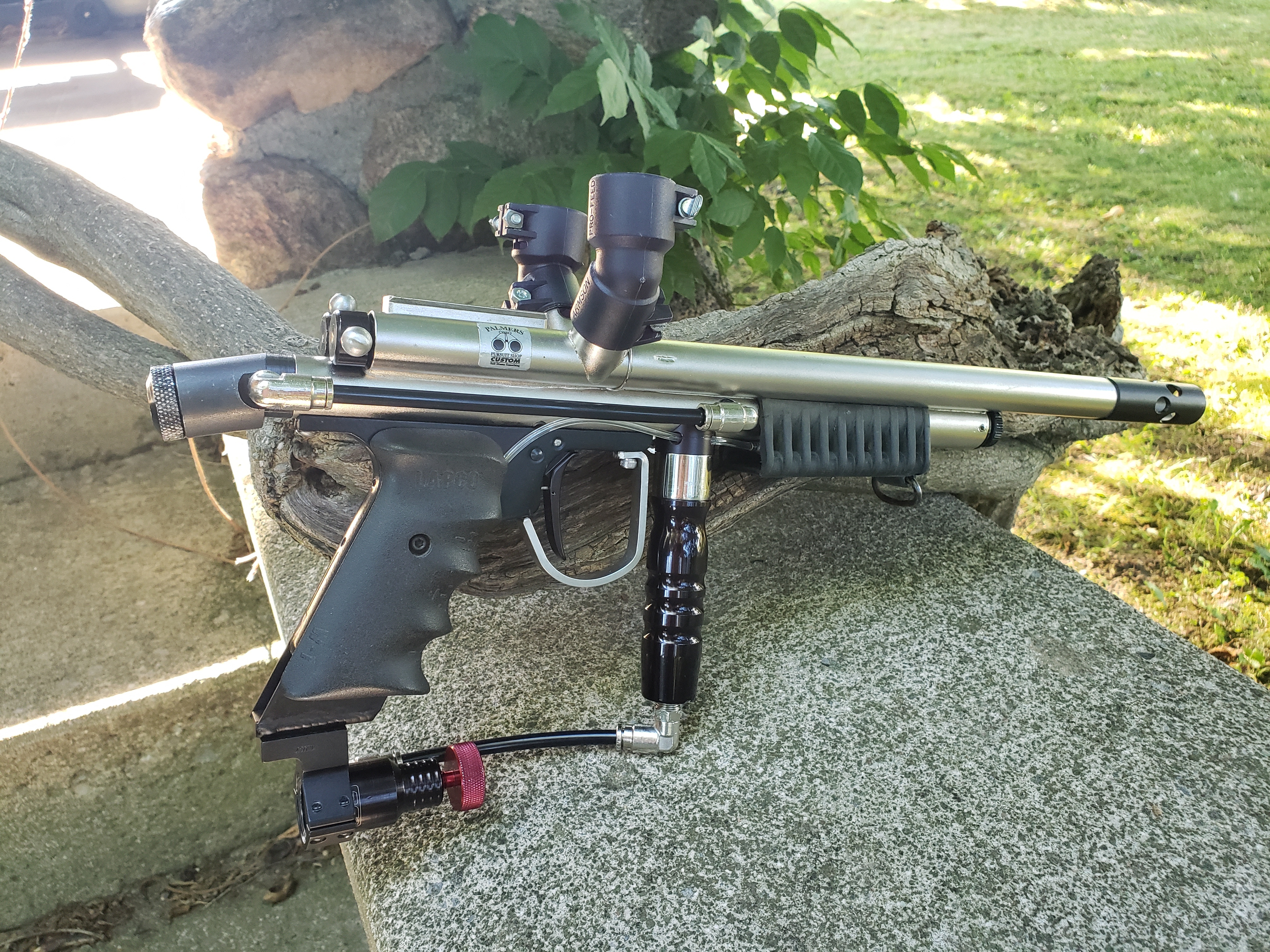

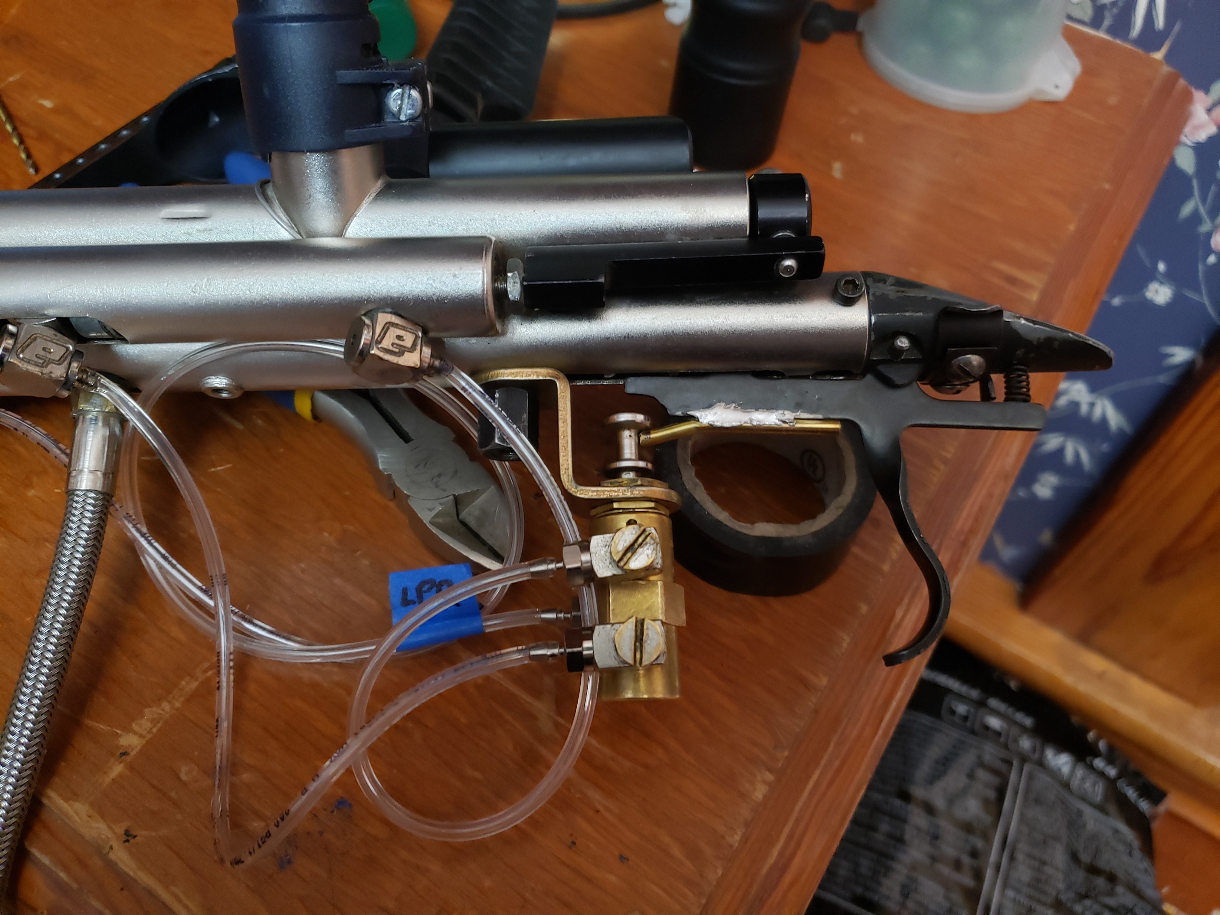

    Aaand I got excited after cutting the clearances into the pirate stock I'm putting the Nasty into, so I stole the 4way off my other Hurricane, did a quick-n-dirty mockup on the trigger, and hooked everything up. I only have 12 grams right now until I fill up my HPA tanks, but it works!
    Sure beats paying PPS $1200 to do the conversion. 🙂
      I. Am. Canadian. 🇨🇦
      • 3502
      #122
      And done... mostly. I still need a Eurogrip and ASA, I borrowed it off my other Hurc.

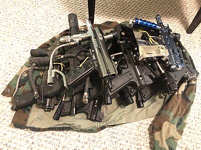

          1) Sell/get rid of the two complete Gen E Matrices, the mostly complete parts Matrix, and a pile of parts to free up space.
          2) Fine tune my second Black Magic Cocker.
          3) Fix some leaks and board issues in a couple of my shoebox Shockers.

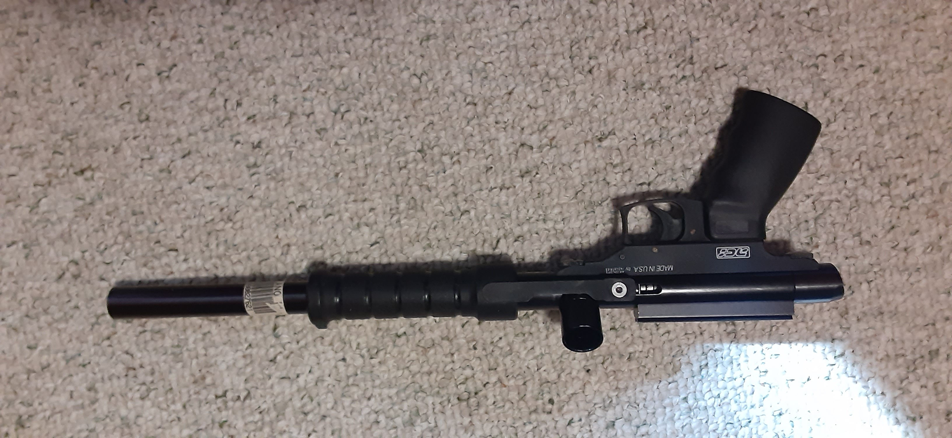

            I have been busy the last few weeks chipping away at some personal projects and stuff that will help me and BW grow some. I do have a few customer projects i need to tackle before i take more work on though.
            3D Printed Automag detents
            https://www.youtube.com/watch?v=o88tgJ_p7qc
            Figuring out how to get the cam part of my feedneck milling/ tslot milling done so i can do them on my cnc mill instead of manually.
            Feedneck modded this, and installed a stainless thread insert for the bevertail, assembled and tuned.
            Installed a stainless thread insert for the rear frame screw. Assembled and shot it for our pump group at least until the paint went to crap because of the weather.

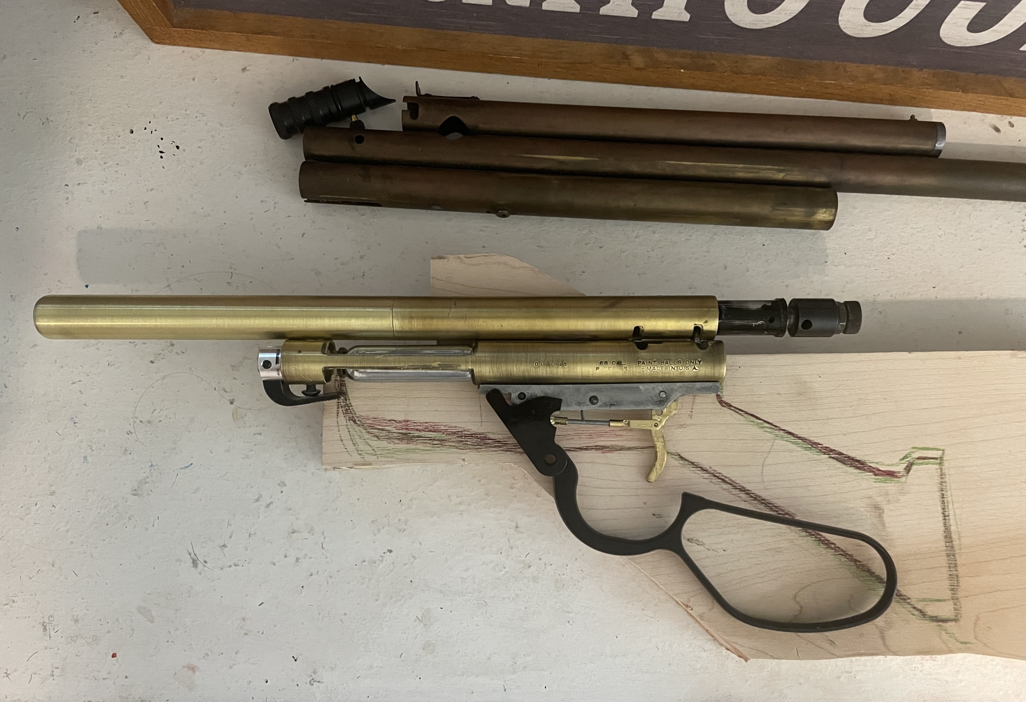

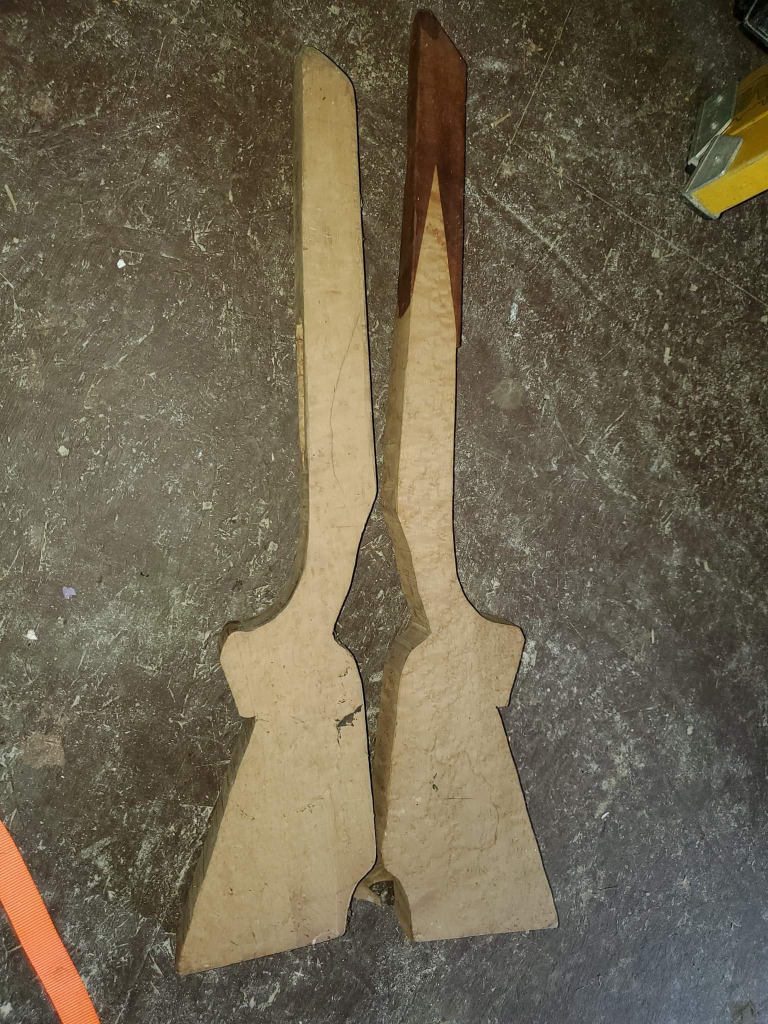

                    So my last project is off with the automag guru for tuning.
                    So my next project is wood working, I have 3 stocks to make. Not sure in what order. But one includes finishing up the stock on the right. Both are Birdseye maple. And I got them as you see them. No idea what they were originally planned to be used on. It needs some serious shaping and I've never done that before so this will be interesting.

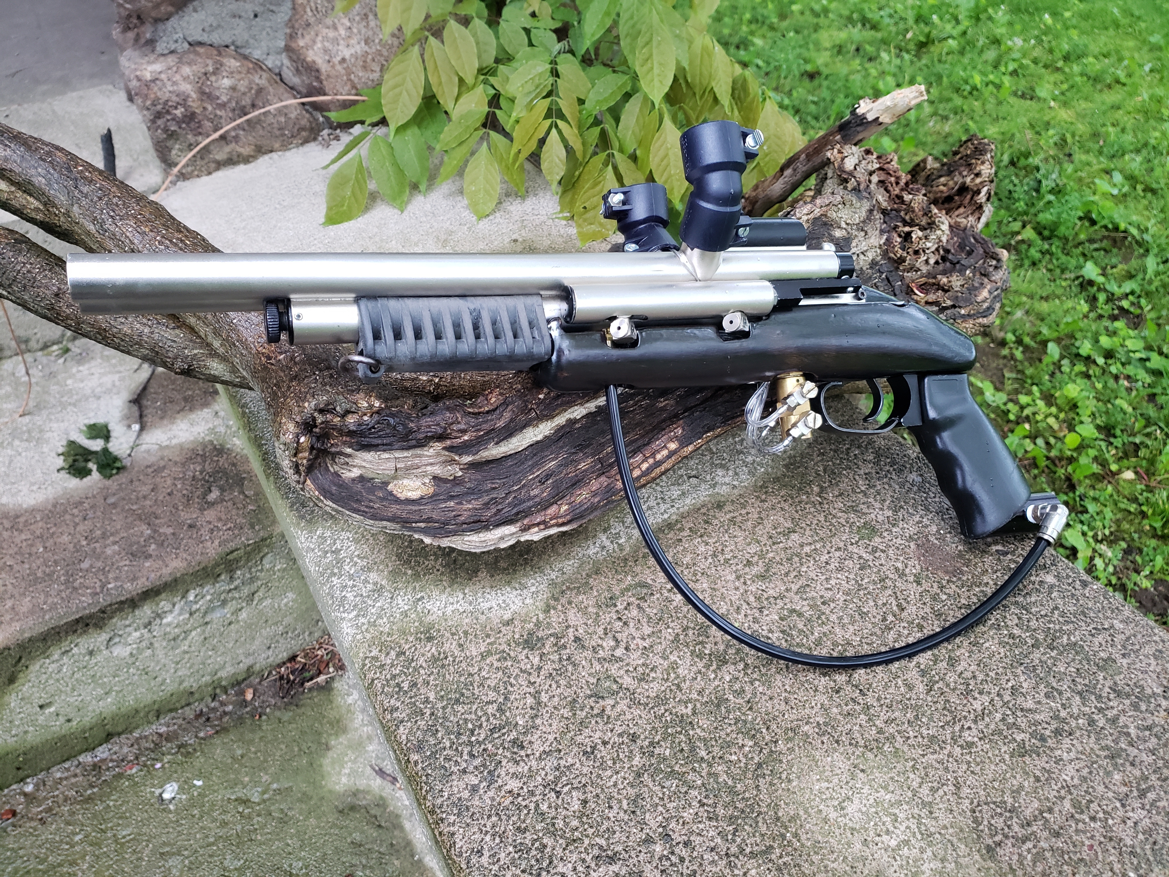

                      Dual bottle setup for my Nasty (for when I run it as a Typhoon). Modified a stock Sheridan backbottle ASA.... I think it was from a Walzmas build I did with Mar a few years ago.
                      Drilled/tapped for a velocity adjuster and drilled out the original 10-32 side tap to 1/8 npt for a macro elbow. Nastys already have a sidetapped valve body - something to with increasing the valve chamber size - so I popped a macro elbow in there as well.
                      I might go with a SS or aluminum hardline eventually.

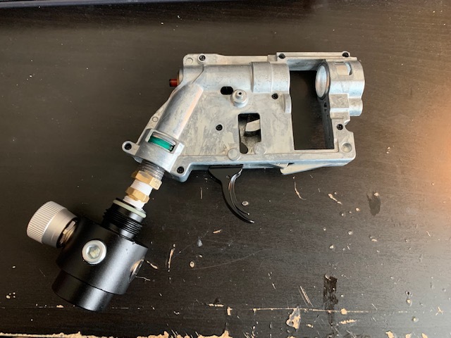

                          1) Bring old Palmer Hurricane to live (waiting on valve tool)
                          2) Bring Tippmann Factory F/A back to life (need to take apart the valve)
                          3) Devise fun and entertaining Walzmas tasks for upcoming giveaway.
                          4) Spring my Raven Nexion with VS2 valve (springs coming with valve tool).
