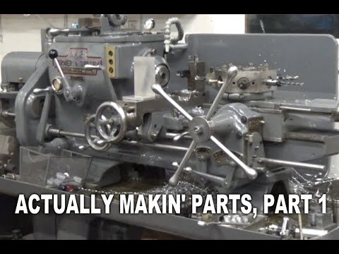

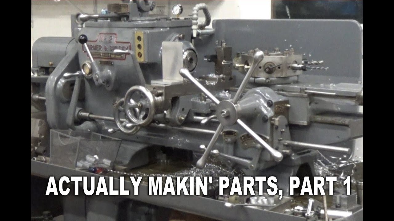

    So, Part One: After chopping a chunk of 1" bar to length with an Evolution style saw, each one was faced to length and drilled on the turret lathe:

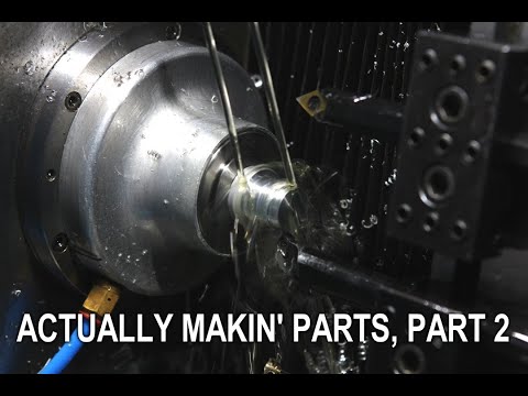

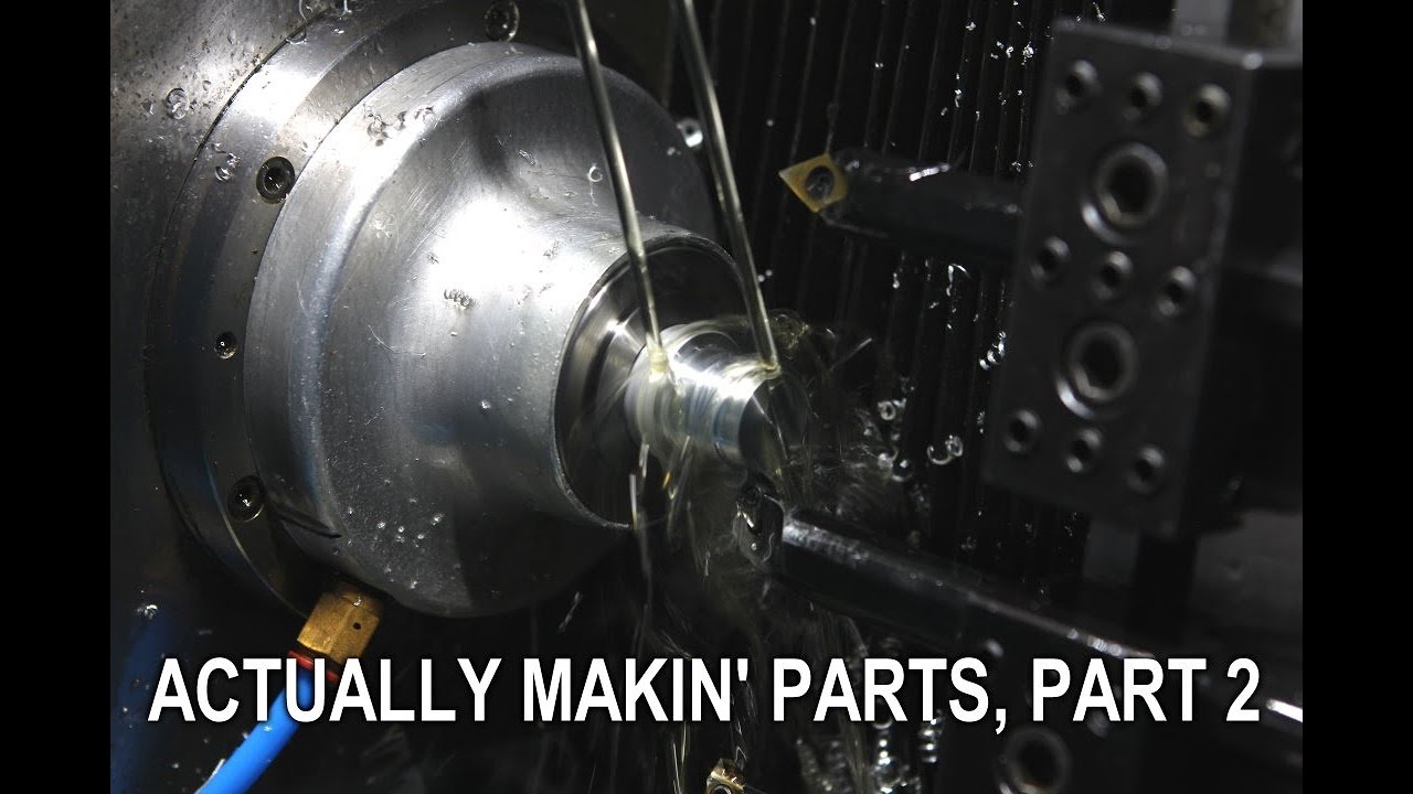

    Part Two, running each one through the CNC lathe. For those of you with more extensive G-code experience, don't laugh too hard- six weeks ago I couldn't have done any of that.

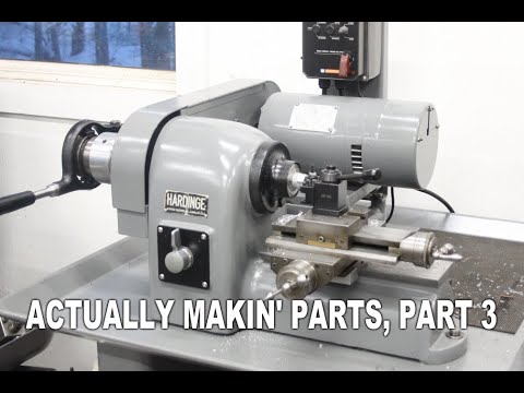

    And finally, Part Three, knurling each one, and chamfering the edges where the knurling rolled the metal over a bit.

            -In this case, by hand. CAD is another of my weak points. I've fooled around with Fusion 360, but am by no means an expert there. However, one thing this Omni has going for it, is the software is fairly simple- compared to the all-the-bells-and-whistles of a cutting edge OS like Centroid- and their user manual is excellent.
            2-axis lathe work is comparatively easy to code. The program for the part you just saw (my XL knob for the Phantom drop-out changers) is barely a page and a third of text, printed out.
