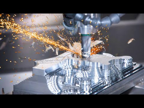

                    Not for the feint of heart:
                    • Siress
                      Siress commented
                      if it's going to be that kind of party... you know they're good when it's the security cam footage: https://www.youtube.com/watch?v=Qaulf8lipr0
                    • CrowsFeast
                      CrowsFeast commented
                      Look up friction stir welding. It's basically a controlled and prolonged tool crash!
                    • Meleager7
                      Meleager7 commented
                      I found that upsetting!
