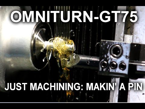

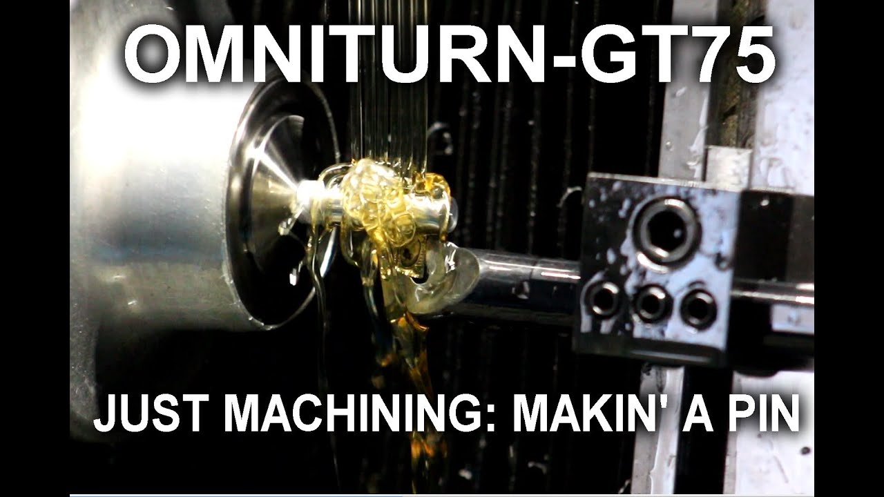

        Makin' a 'Cocker bolt pin, live and in color!
        (Well, part of it, anyway. )

          Curious as to why you didn't part the pin off in the same op.
        -Inexperience.
        No, really. The pin gets pretty small, and if I'm not very careful, can chatter or distort if I try to cut too much. Clearly, it can be done, as everybody makes pins like this, successfully. For the moment, I opted to turn these in stages, keeping as much support as I can for it.
        Once I have a better handle on speeds and feeds- I'm still very new to this whole CNC thing- yeah, the "right" way will be to turn the shank, including the detent groove, then most of the head, part off, and then have a bar feeder or bar puller (which I have but have not yet used) advance the bar the right amount, and then cut another one.Lather, rinse, repeat until the bar runs out.
        Still working up to that.
        Doc.
        Paintball in the Movies!
          XEMON commented
          What about having a part support/tail support comes in when you need it?
          Do you have a second CNC holder in there?

        [/quoWhat about having a part support/tail support comes in when you need it?
        -Well, the part itself precludes a tailstock, which requires a small hole to be drilled in the end of the part. And, the Omniturn lathe I have, doesn't have a tailstock anyway.
        As for a "second CNC holder", there are machines that have a second chuck, facing the first. And can use it to grab the machined end of a piece, so that the other end can be done.
        A cheap used one that fancy would probably start at $80K, and besides the expense, would be FAR too physically large and heavy to fit into my glorified 2-car garage.
        No, I'll get this sorted out, as I said I'm still quite new to the actual mechanics of using CNC, and it'll just take a little time, practice and experience.

          XEMON commented
          I can only imagine jumping into this size/level of CNC ...
          As a garage hobbyist it took me 4-5 years to figure out how to use my Emco compact 5 CNC (and I have not touched the automated tool changer yet ...)
          Keep up the work and keep trying and make program from scratch ... It only gets easier and faster 😁
