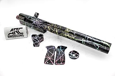

        #201
        Just got this approval photo from Arc. Can't wait to get it in and put together!

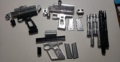

          I am so flipping excited for this... just waiting for the anodizer to do their thing and send me a bill for 1 billion dollars. The trio are getting the same ano.

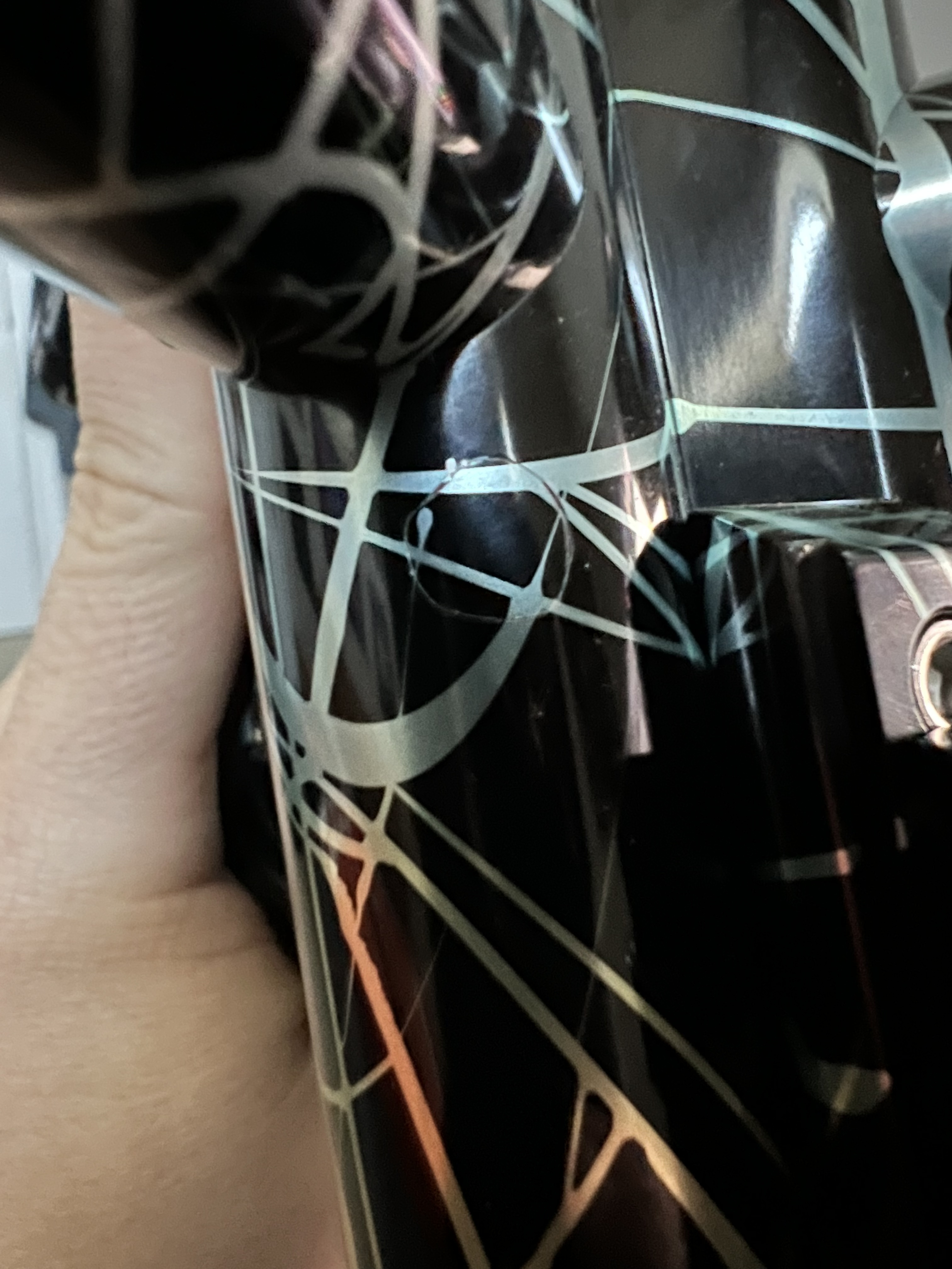

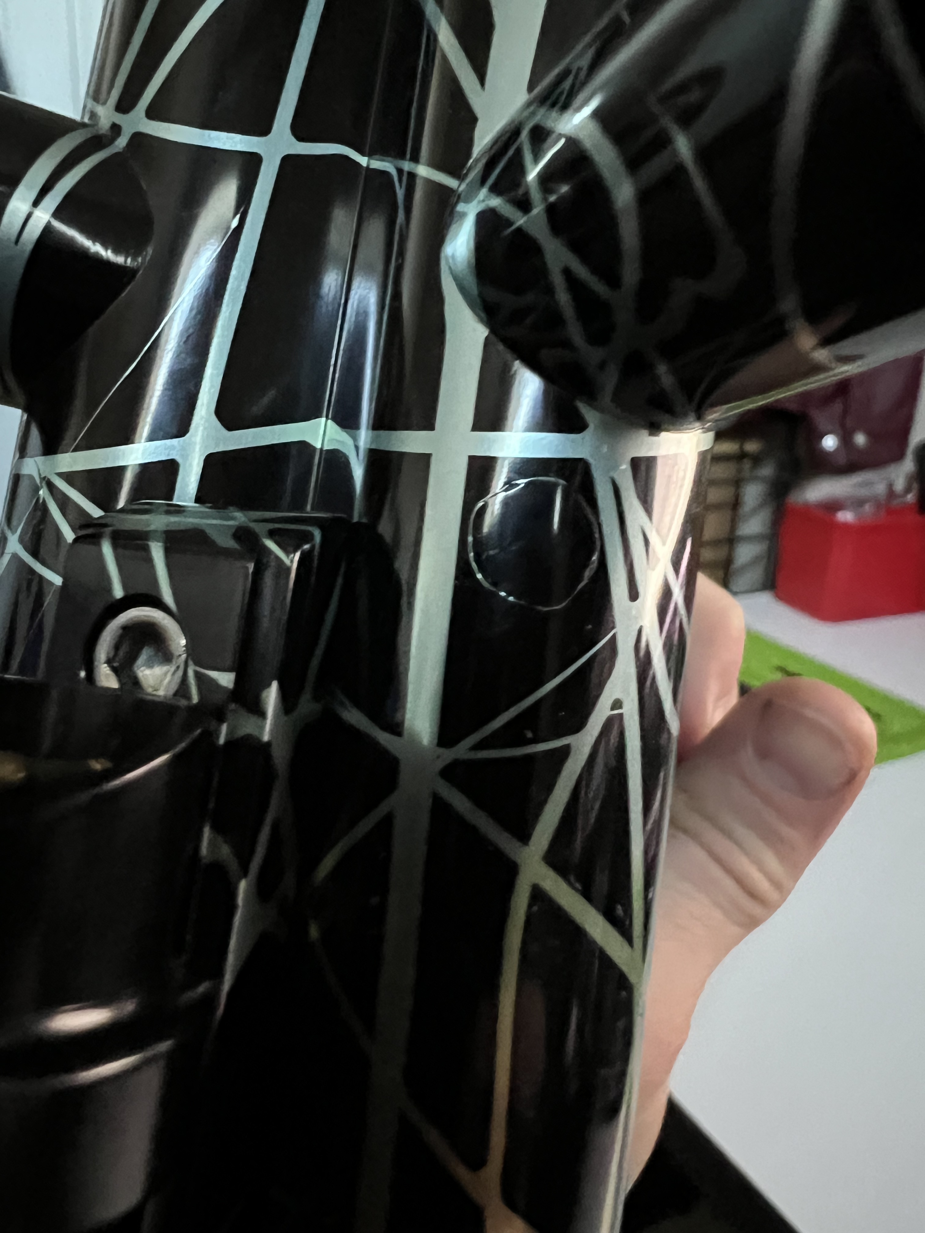

            #207
            Lt. head-shot I have to ask, any anno issues where Doc "plugged" the valve holes? I always wondered if mis-matched aluminum, even just the grain structure, would be visible.

              #208
              There are actually. It doesn’t bother me since the splash is very random, but there are some spots. Not 100% sure if it would show on everything, or maybe it was a polishing issue.

                #209
                -The "plugs" are the same 6061 as the rest of the body. Not the same "billet", of course, but very much the same alloy. You don't start getting coloration issues unless you use different alloys- the famous one being older 'Cocker vertical ASAs. Those I think were made from 2021, and due to the increased copper content, don't take the color the same way. (No issue with black, but gets more obvious with lighter colors.)
                I try to smooth them up as best as I can, but there will always be some trace visible. I will say on Headshot's, it looks to me like the polisher got WAY too aggressive with the buffer.
                The ports can't be easily drilled from underneath (and still have a valve retaining screw, which, with an 11/16" valve, is the only thing holding the valve in place) and if I TIG welded the holes shut, which I could easily do, the welding appears as a "stain" in the anno. Anyone who's ever owned a Blazer, especially one annoed a bright color, knows about the little 'cloud' stain where they TIGged the inner air passages closed after drilling.

                • zinger565
                  zinger565 commented
                  "and if I TIG welded the holes shut, which I could easily do, the welding appears as a "stain" in the anno."
                  Okay, that's what I've seen before, especially with eye-hole repairs. I figured if it's the same alloy it'd be nearly indecipherable.
                  Welding changes the density of the material making it take Ano differently even if it’s the same exact material. It’s why patched markers never come out perfect. You could take a piece of the same material tig it together re grain polish and just the heat will make it look different.
