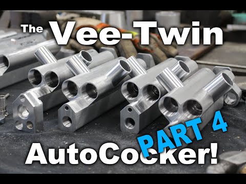

    And now, Part Four!
    And no worries, the actual build is of course way ahead of what the videos show. I'll have a proper photo update later this evening. I just have to make a few more valves, some more bolt pins, and finish the bolts.
    That doesn't mean all the guns are done, but more than half should be heading out this week. (I know I said that before, but this time I mean it! )
    Doc.

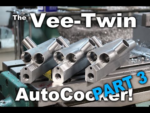

    And Part Three is up!
    Doc.
