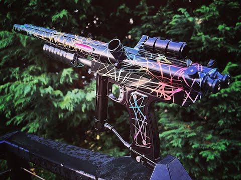

              I'm supposed to get approval pics from the anodizer tomorrow... excited over here.
                -Post pics if you can. I can't wait to see these things finished!

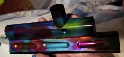

                  Got a preview from the anodizer. Looking forward to how it comes together in-person and in hi-res!
