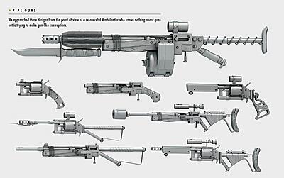

              I'd go with some kind of janky fall out pipe rifle, but that's just me
