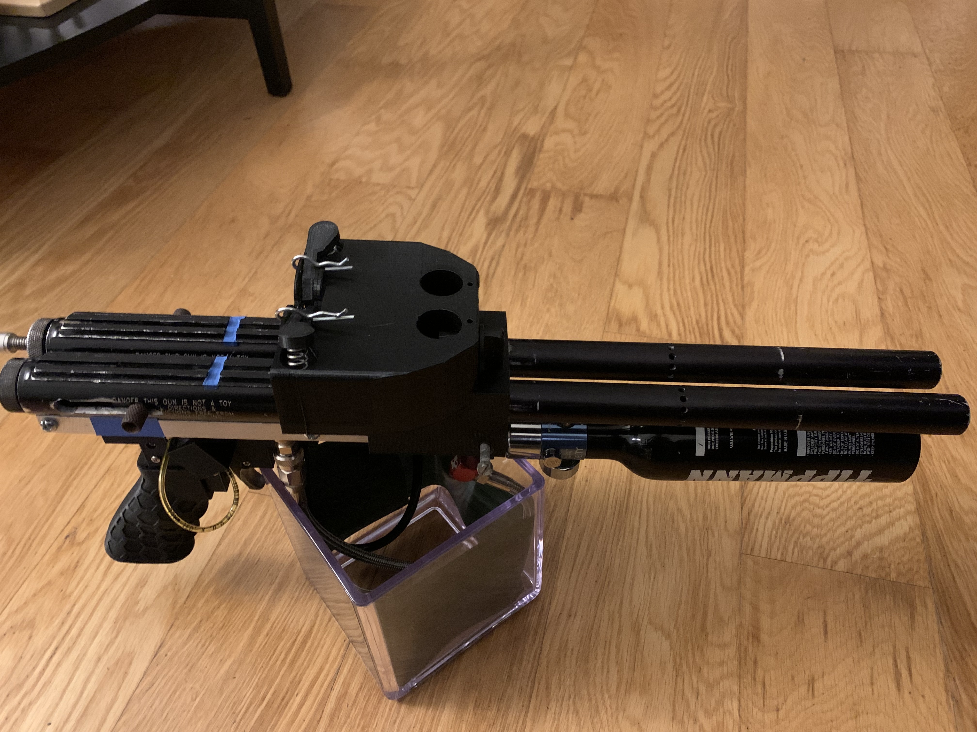

    Well if projects are allowed I'll throw my double pro/carbine project up here. Still in the works, dealing with some double firing issues and has temporary airlines.
    Has a 3d printed pneumatic trigger/grip assembly to solve the multiple sears problem.
