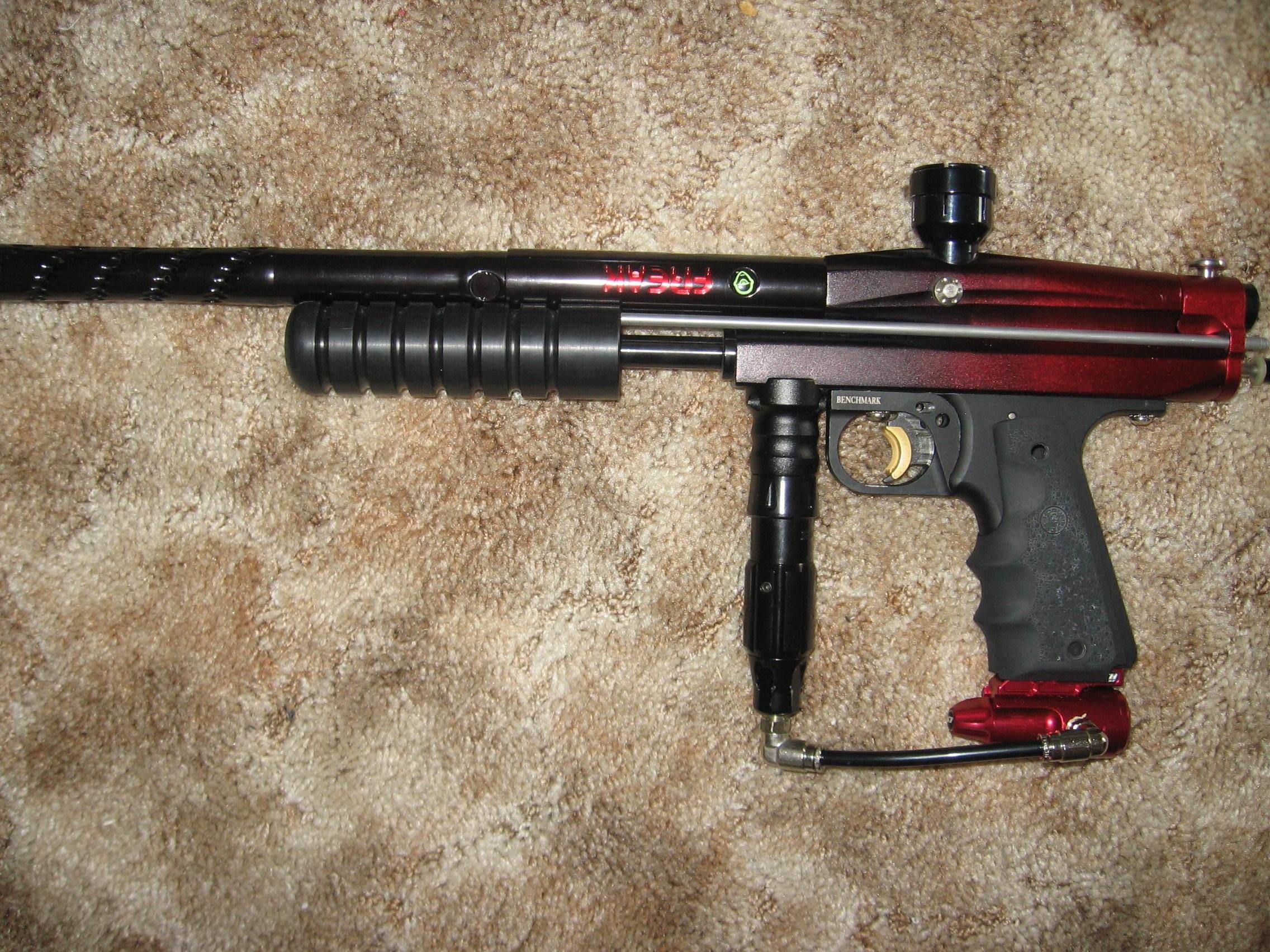

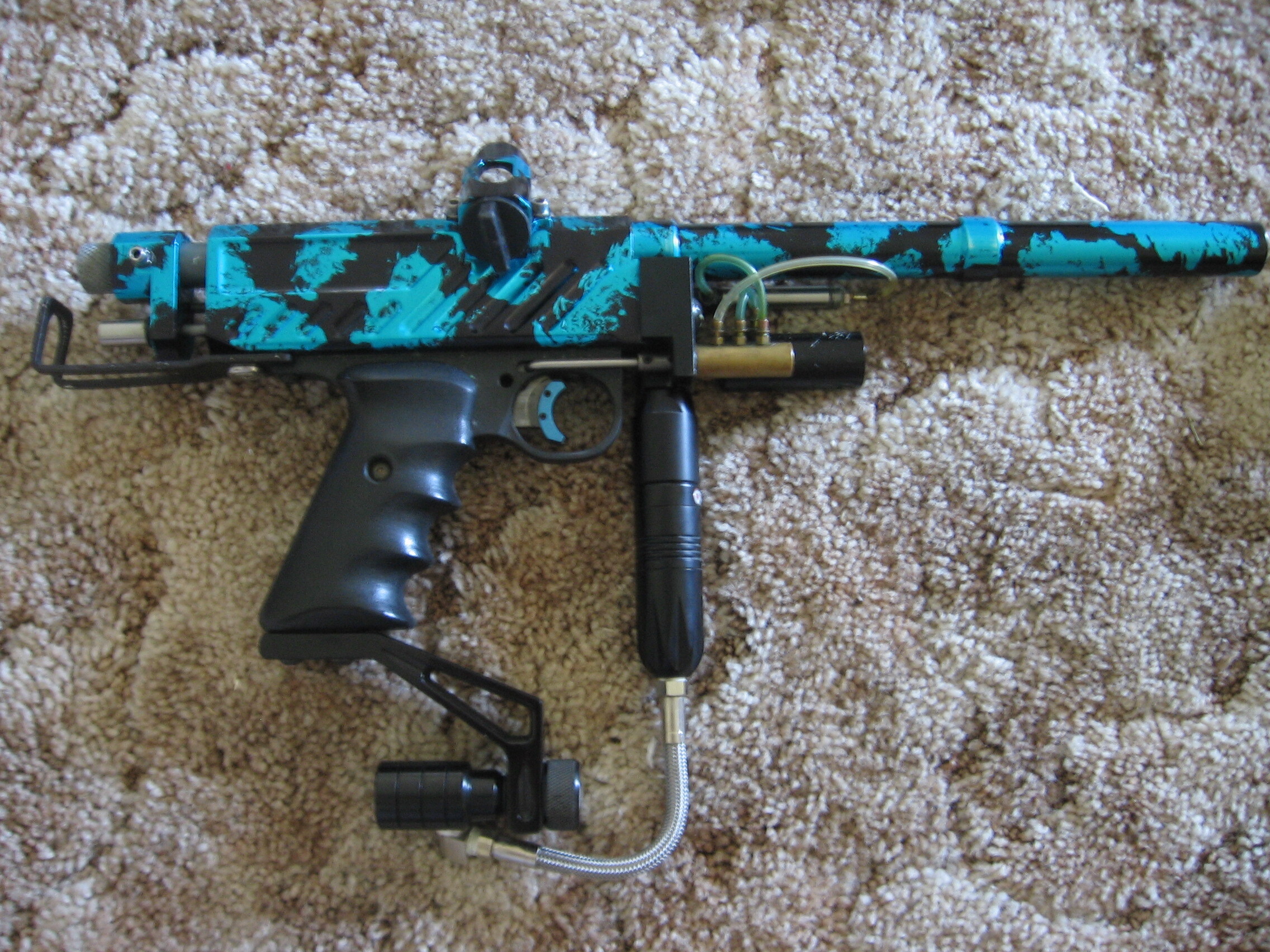

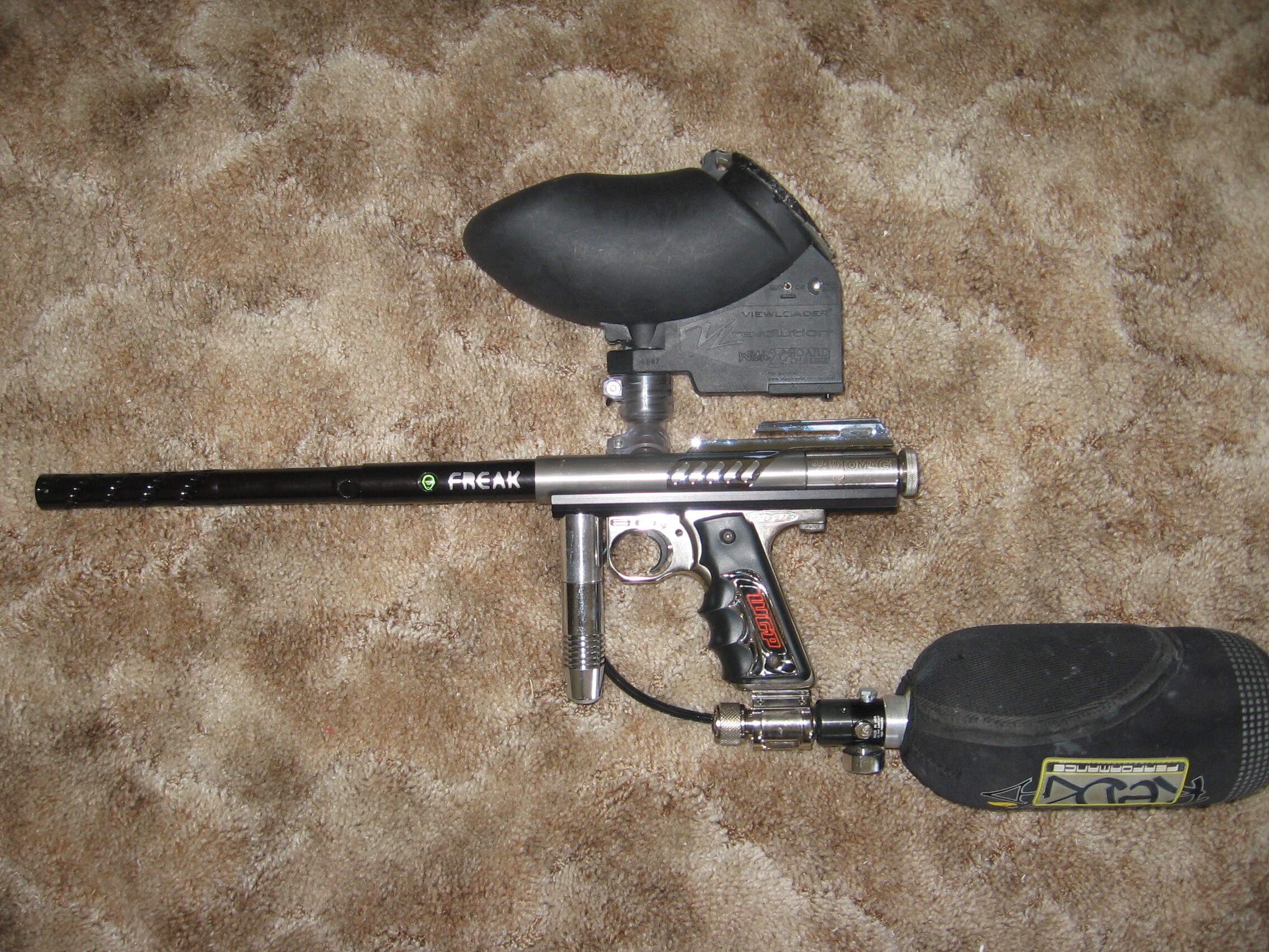

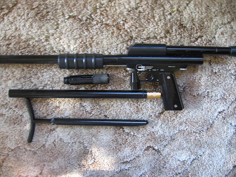

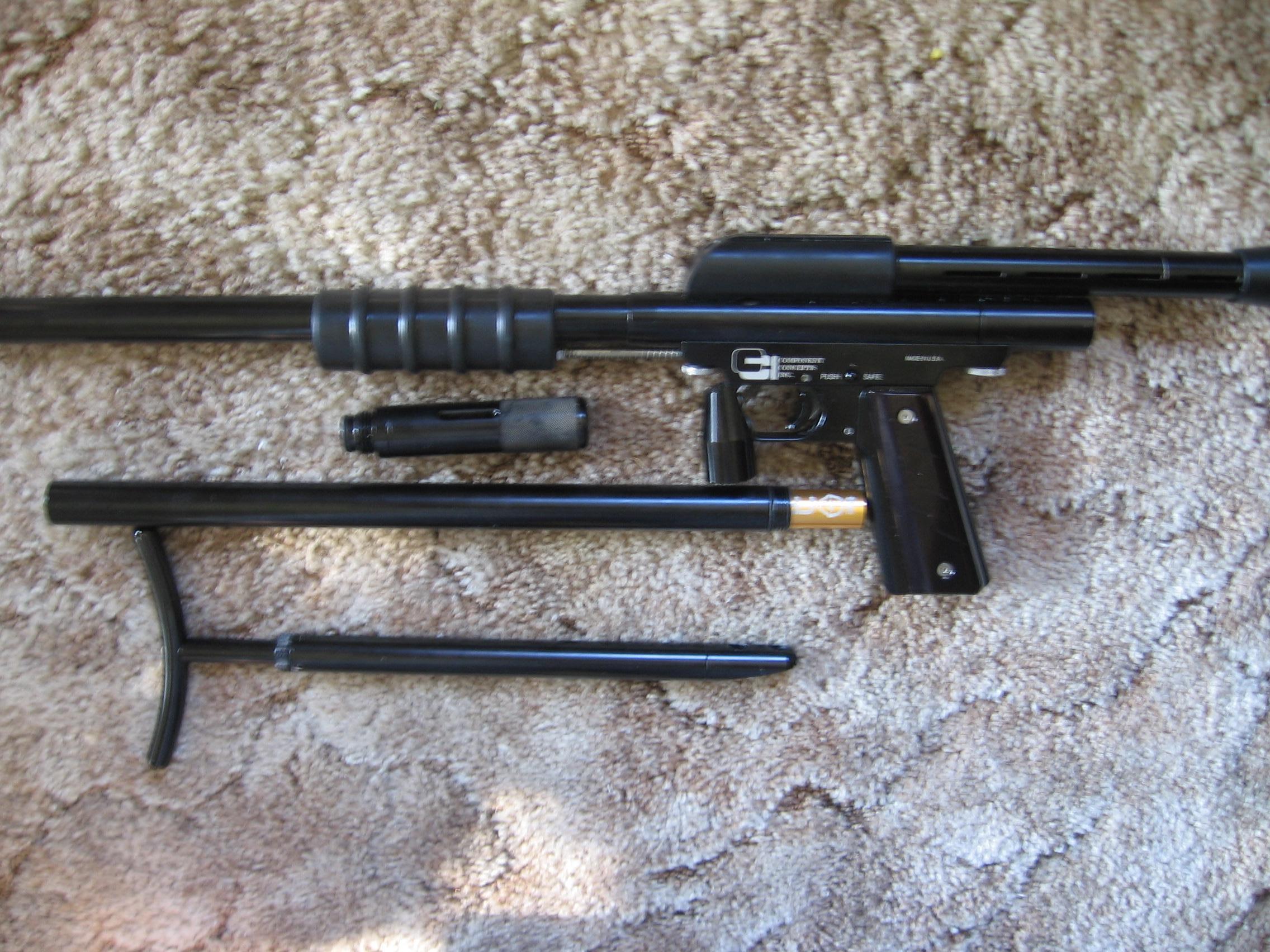

                      Hmm, should be a second box around here somewhere...
                      I seem to remember also owning gear, but with the time I used to spend on here, maybe it was just a pile of guns?
