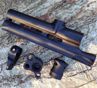

    So, who bought this one?
    -It is as-yet unclaimed, I was making it in large part as a test bed. I'll probably keep this one for myself, if anyone wants one, I can work up a quote, but really, we need to see if the thing will even work right, first.
    I assume this is going to have a similar hammer / spring / valve set-up as the Vee-Twin? Since you are trying to pump out double the air through a single valve?
    -The only thing different about the Vee-Twin valve is that it has two ports, due to the angle of the barrels. The Evil will use stock 'Cocker valves- in this particular case, I'll be using an off-the-shelf 11/16" Inception. (And have a fistful of Inception poppets to make the VT valves in the same configuration.)
    One idea I've been playing with for the various doubles, is to bump the valve all the way up to 3/4". That'll require a custom hammer, too, but I figure since this thing needs so much air, a bigger valve chamber, a larger poppet and port, and a bigger/heavier hammer, would all help making full field speeds without needing huge pressures or mongo springs.
    Unfortunately, I can't 'convert' any of the existing bodies, as they're already drilled. Simply reaming them out would make the bottom of the body just that much thinner, and as any 'Cocker owner knows, that rear grip frame screw already tends to be a little weak. So to do it right, the centerline has to be raised, to leave the bottom the same thickness.
    So I figure once I get this lot done, and assuming the Evil works (IE, there isn't a dramatic difference in velocity between the barrels) I'll make another one as a test, with a 3/4" valve.
    Doc.

            Okay, a fresh update, now with comments!
            As I said earlier, possibly in the other thread, a big chunk of the reason for this build was as a test bed. I'll be using the more modern 11/16" valves for these, and that requires different machining. I figured it'd be a smart move to do it on a piece that's NOT a paid-for customer part.
            So, since I was getting to the valve-bore work on the Vees, I took a moment to try the milling in this body, to establish, among other things, the depths and bore sizes.
            First, I popped the threaded grip-frame holes, then located and popped the valve-retaining/air passage hole and tapped it.
            Then, the moment we've all been waiting for, finish-reaming the bottom tube out to size, and determining where there should be a "shoulder" for the valve to seat against.
            Some bodies don't have a shoulder, but I figured that'd be handy for assembly. Anyway, after just one additional cut-and-try, I had it spot-on, and a dimension I can use for the Vee bodies.
            Now, this vertical one is agonizingly close to being finished. It only needs a bit more millwork, maybe fab a couple bolts, and then a quick run through my junk bins to throw some workable parts at it. I could have it working (however well it's going to work ) by Friday if I had to.
            But I have WAY too much on my plates right now, and several other customer who have been waiting patiently, so I need to switch focus to other things for a bit.
            In the meantime, have a very bad mockup, using whatever junk was in a nearby parts bin.
            And, if you're curious what it's like sighting down it...
            We'll be back to this as soon as we can!
            Doc.

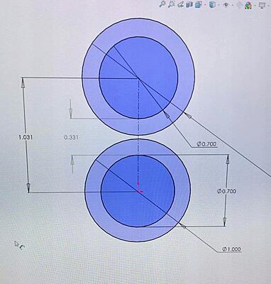

                            Doc - use all of your powers to make a single center feed over under work correctly. Make some ridiculous ass detents or something. DOOO ITTT
                              • 4341
                              #29
                              It wouldn't be easy..... Here's what your up against.
                              ​​​​​​.331...... Basically a half a ball bore gap

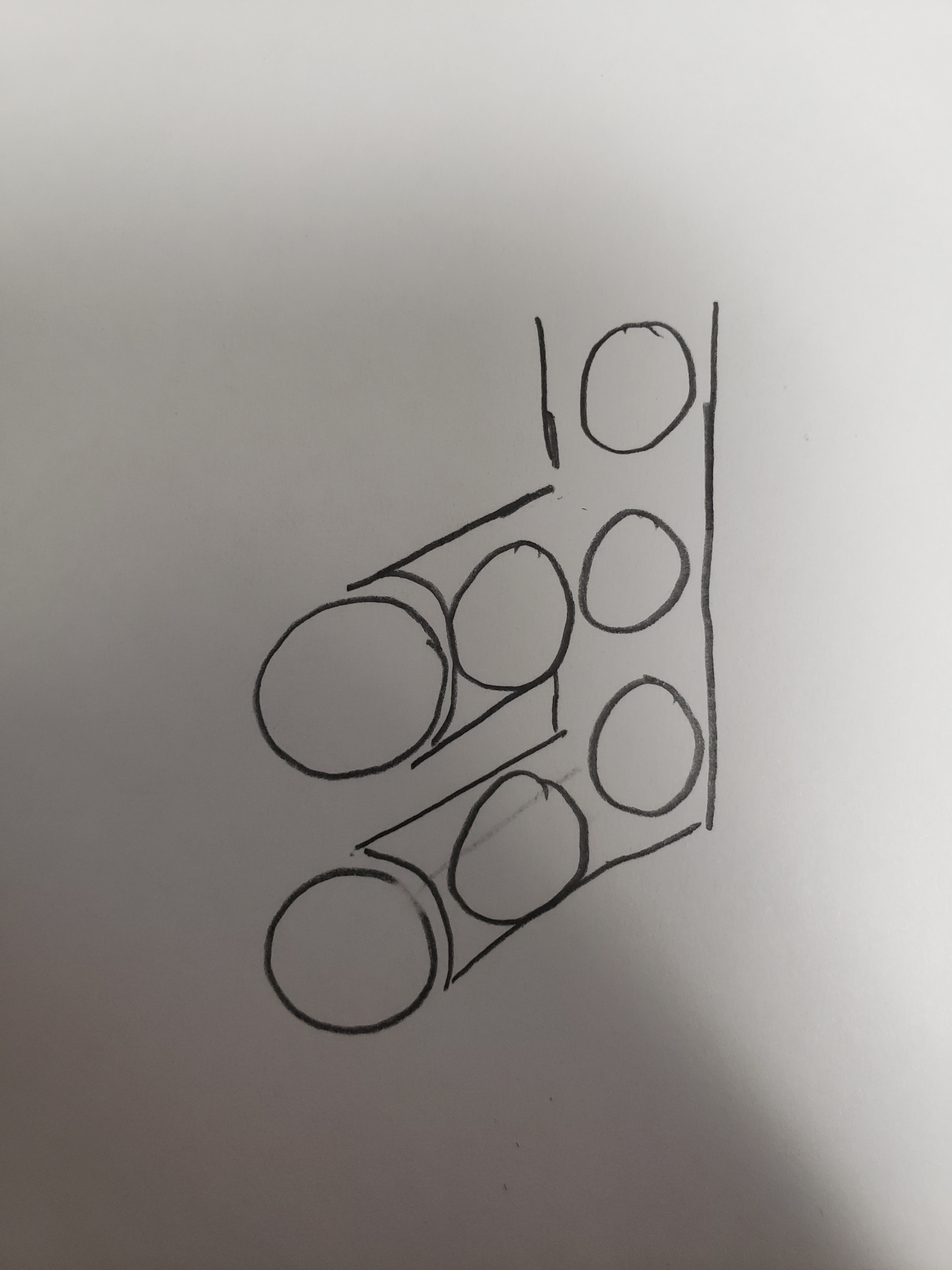

                                #30
                                What about a pair of right-feeds, stacked on top of eachother, connected to a single vertical "stack".
                                You'd have to make the distances perfect so they dont jam in the split on the way down though. May have to adjust the angles too. Idk, just an idea that popped into my head.
                                  Ecapnation commented
                                  That's a jam waiting to happen
                                  Alexndl commented
                                  Could add paddle feed system like the Evil guns to prevent jam?
                                  That would be "simple"... lol
