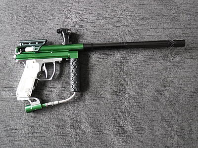

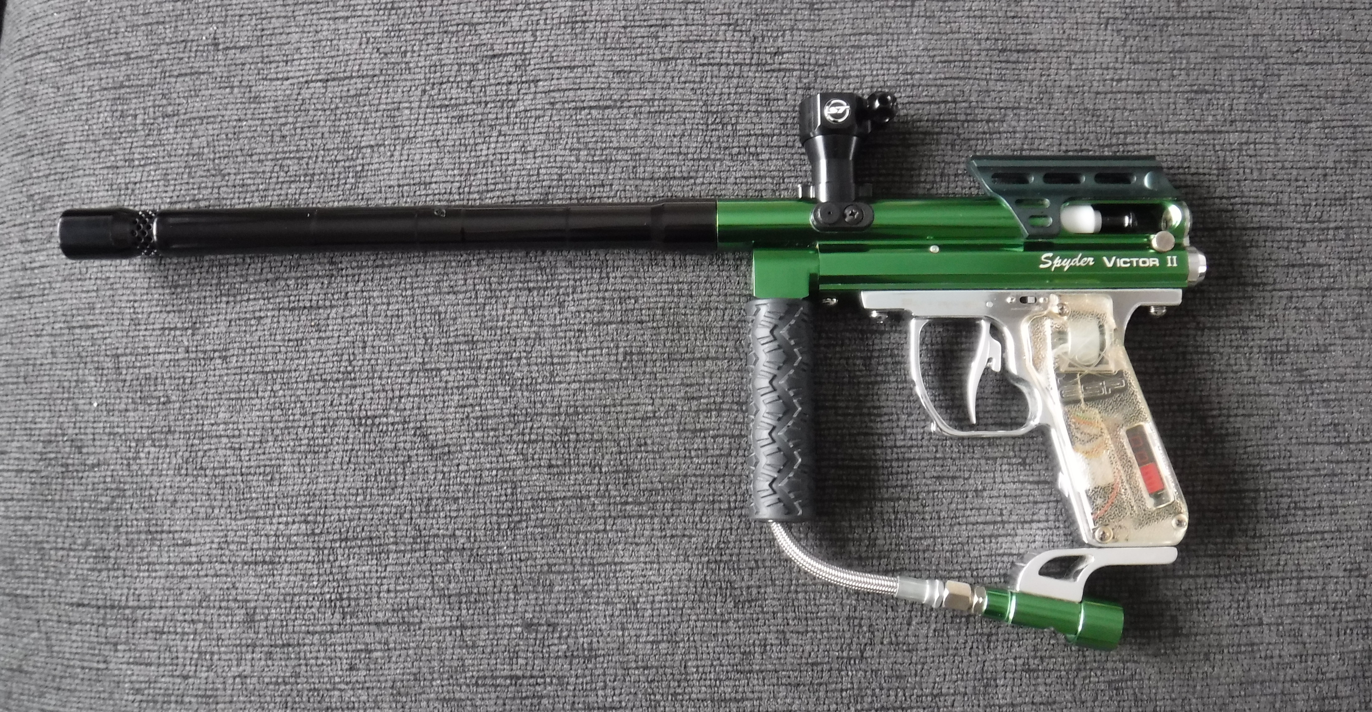

                Here is the first gun I'll be testing with a liquid setup....got rid of the volumizer, and capped off the front. Still not sure if I need to try to further reduce volume in the chamber in front of the valve .
                What I will change is the springs. I have some spring kits from ansgear stuck in Canada customs in Vancouver , BC for 13 days and counting....all for a tiny packet of springs. Incredible!
                My plan is to use the heaviest valve spring, to limit the amount of liquid co2 that will flash into gas in the valve. I'll start with a light mainspring and tune from there.
                This gun has a shocktech oringless supafly bolt, and I hope the effect is delicious co2 clouds bursting from all parts of the gun when fired !
                With its electro sear tripper frame, this Spyder might be the only example of an electro-liquid paintball gun in existence (at least until this new trend in paintball takes off! )

                  minty fresh Victor with good mods right out the gate. Most people that bought these would go right to the rattle can or cammo duct tape but the clamping feed neck, trigger, and barrel were some of the best things you could do to it. very nice place to start IMO.
                  • Meleager7
                    Meleager7 commented
                    Thanks man, yeah, i'm starting to really dig this little spyder ! it's light, it points well and i was fortunate to still be able to find those new old stock parts!

                  I got my springs in finally (it took 1 month from Cali to Ontario, Canada), a warrior main and valve spring kit.
                  https://www.ansgear.com/Warrior_Pain...cspringkit.htm
                  Installed the gold valve spring ( stiffest) and the black main spring (weakest).
                  It cycles fine on a regular co2 tank, with the rva backed all the way out.
                  I just need to get my Siphon tank filled, then I can chrono with some paint and see where its at!
