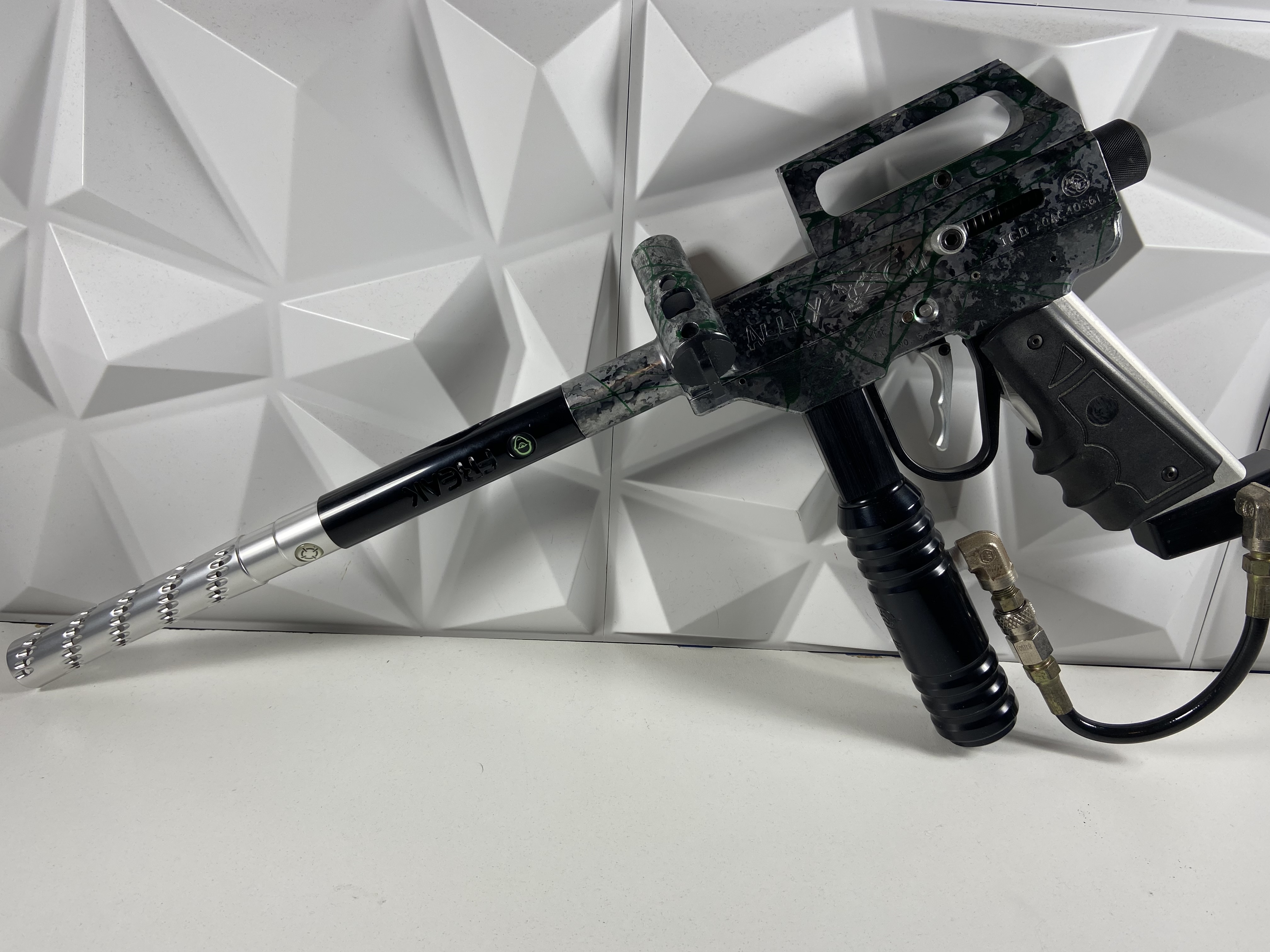

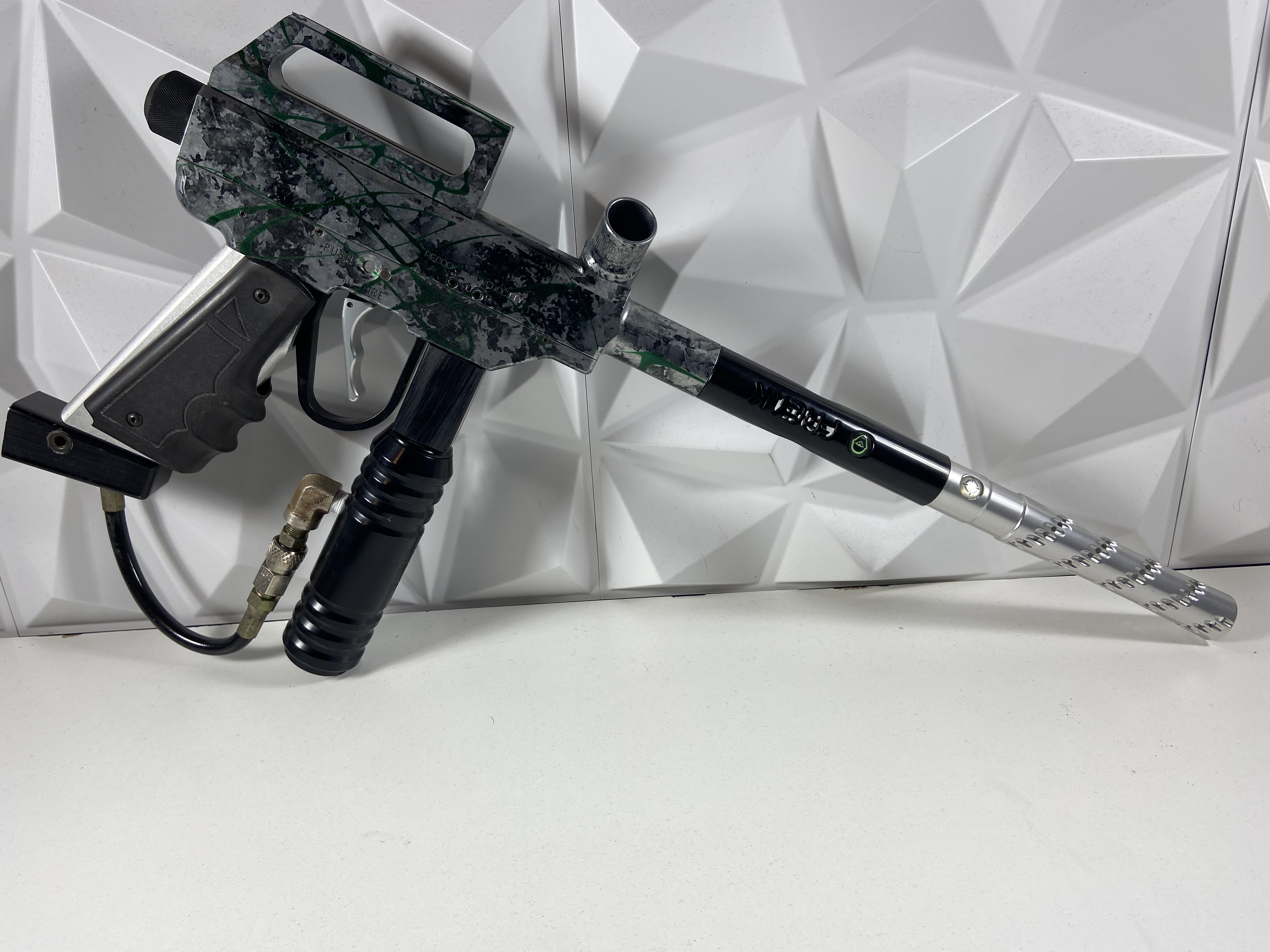

        Will an ICD Alleycat Deluxe "go liquid" ?
        Yes. Yes, it will.
        With not very much tuning, I have the Alleycat shooting stable around 280fps with these settings:
        - Recock Set Screw - Turned all the way in
        - Velocity Set Screw - Turned all the way out, flush with the 'cat body
        - RVA - approx. 2.5 turns in
        - Freak barrel with .682 insert
        I had this marker out a couple weekends ago, in 4-5 Degree Celsius weather and velocity was consistent the whole time I used it.
        The efficiency was acceptable in my view as well, I wish I had counted pods exactly, but I was able to get several games in before I ran out of liquid on my 20oz Siphon tank.
        For liquid use, I did need to remove the ANS expansion chamber you see in the pics, and I just ran the air line directly into the vertical asa for the shortest gas path.
        Anyhow, I was very impressed how well this 'cat handled liquid co2 !

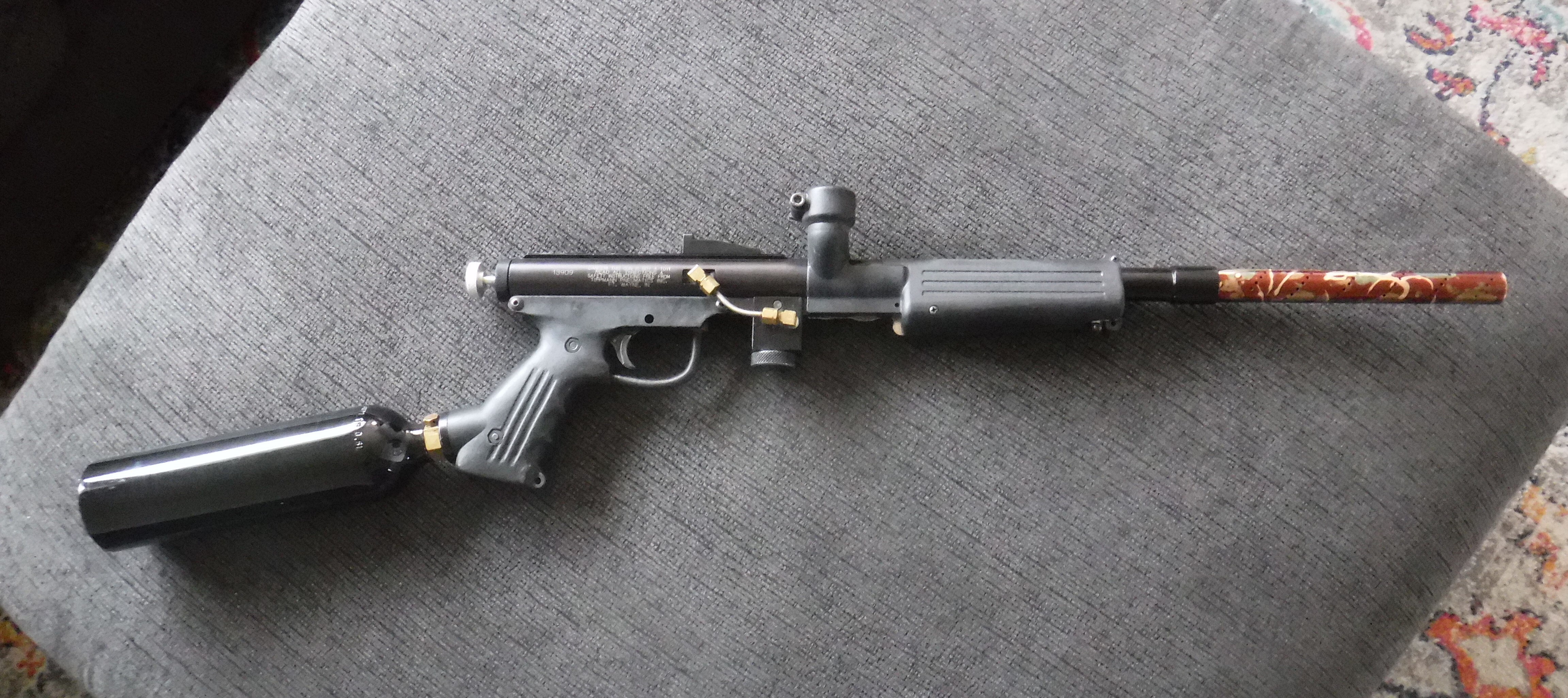

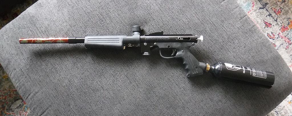

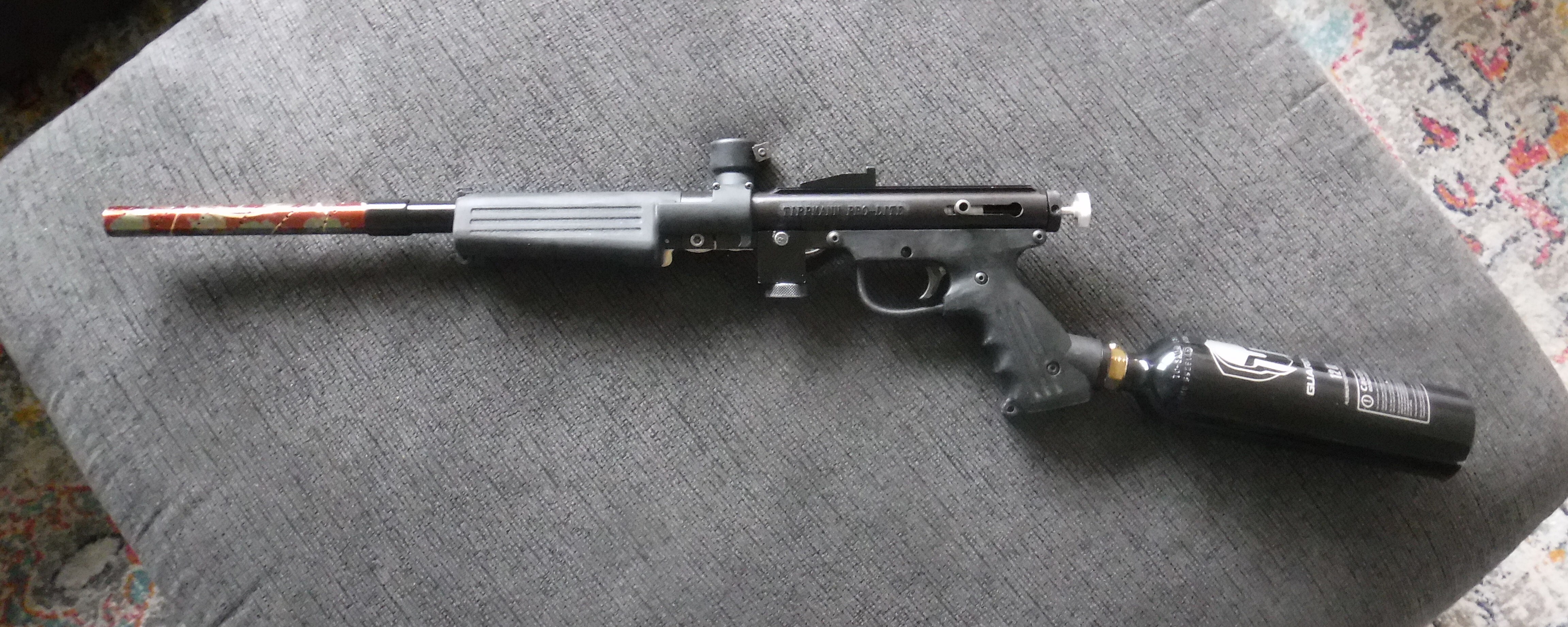

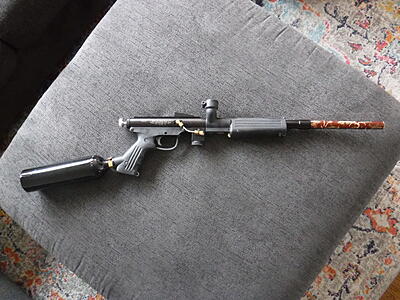

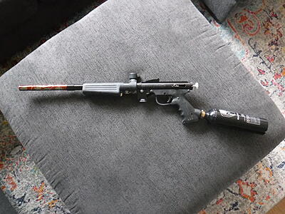

          Next gun on the Liquid List ...... the Tippmann Mini-Lite !
          Will the Tippmann Mini-Lite run on liquid co2 ?
          Yes. Yes it will.........but with horrible efficiency !!!!
          I ran this mini lite on the same cold day at Combat Pursuit in Pickering , Ontario Canada in 4-5 Degree Celsius weather. I set the gun up as you see in the pics , plugging the vert ASA and running a back bottle Siphon Tank.
          On a side note, with a back bottle tank installed, and a 16" All American barrel, it is not lost on me the irony this Tippy is referred to as the "mini lite" !!
          Tuning wise I have the velocity limiter grub screw basically turned all the way in , and the Taso RVA turned out 3-4 more turns than you see in the pics.
          Chrono'ing was still pretty consistent , even though I had terrible paint to work with, very small stuff and horribly misshapen with multiple flat spots on each ball. and the 16" AA, which is probably a bore size of .691 - .693 ......I was still getting enough shots in a row approaching 280 FPS , I was happy enough.
          This next part is not entirely scientific , as my guess is I had about 14 oz co2 ( probably less) left in a 20 oz Siphon tank when I took the Mini Lite out on the field.
          I'll have to pay closer attention next time, and I will come back here eventually to update my claims, but I think I only got 300 shots off before I ran out of liquid and the mini lite would not re-cock. I had enough gaseous co2 to manually recock the gun, and play a bit longer like it was a pump gun.
          In actual gameplay, as fun as it still was to play with this Musket from the 16th Century , I couldn't hit the side of a barn door with this thing!
          First off, I was completely blinded by each shot ! Alexndl said he could see me on the field shooting , and the co2 cloud bursts where shooting like 3-4 feet in front of the gun.
          Combine being blinded, with the awfully small misshapen paint , the huge bored barrel , and the dark shelled paint I could barely see downfield, my inaccuracy was comical ! I remember having one rental Newb who kept his head up over the bunker and just stayed there in my sights, and I could not hit this guy for the life of me! It was like he had a bloody force field around him!
          I still have some tweaking room to work on the Efficiency for next time. Maybe a TechT iFit adapter with a small insert, and find a weaker mainspring, or cut the existing one a bit, so I can back out that velocity screw more.
          All in all, a fun experiment !
          Click image for larger version  Name:	minilite1.jpg Views:	0 Size:	1.85 MB ID:	342953
          Click image for larger version  Name:	minilite2.jpg Views:	0 Size:	2.18 MB ID:	342954
